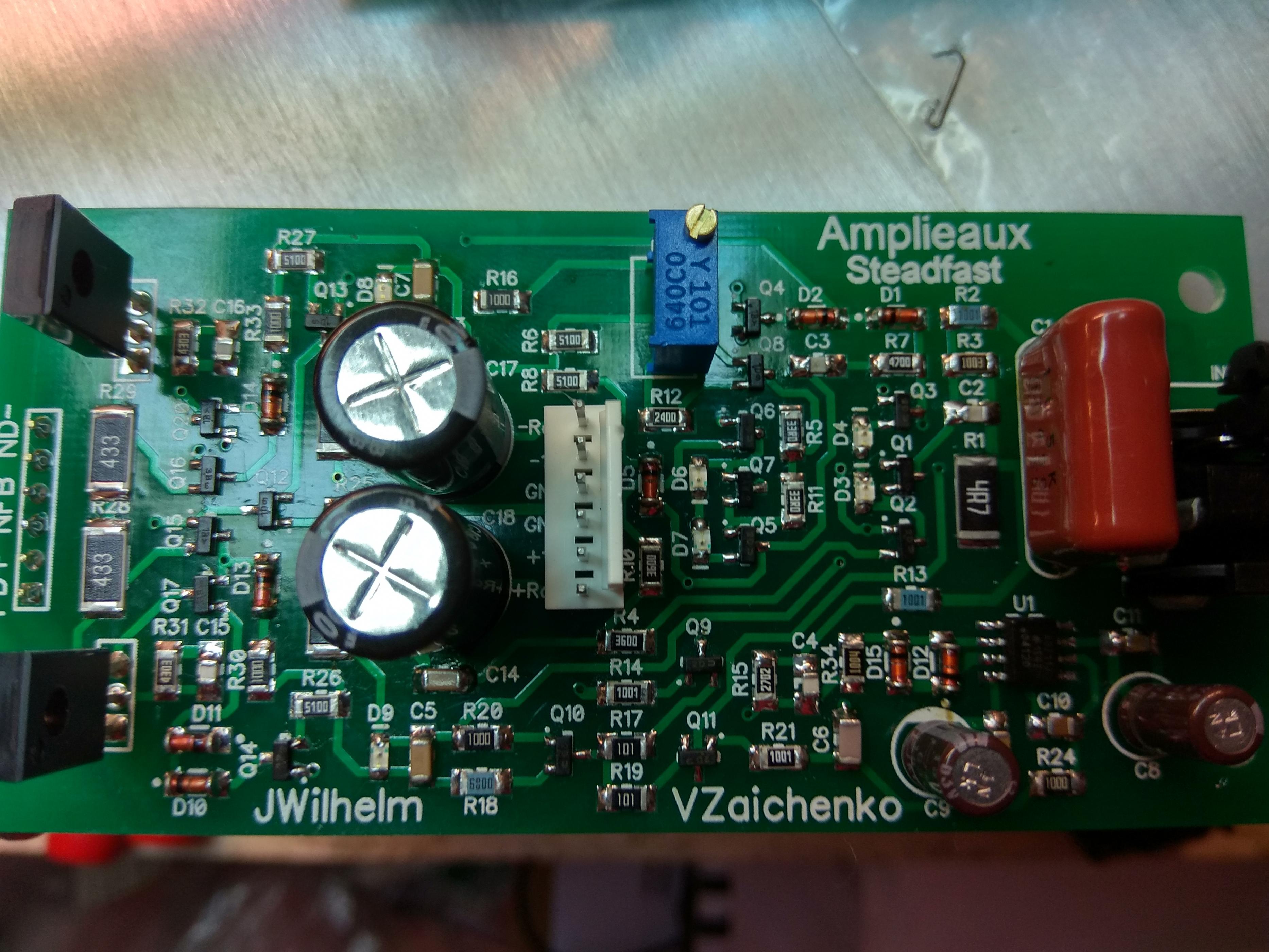

It's running nicely now. I did some quick scope tests with +/- 56V rails with teh X4-JFET input and an 8 ohm dummy load. I gave it a short audition too, sounds great, very punchy bass! Dead silent with no signal as always.
Pictures are 1k sine at clipping, 1k square waves, 50k square waves at 100k sine.
Next I need to put together a chassis with proper cooling so I can done some proper high power testing and stereo audition.
Jeff, these are very good ones. Clean clipping, precise 1KHz square, nicely rounded corners at 50KHz. Exactly as expected. X4-jfet does a great job driving the monster. X4 are the great front-ends, somewhat underappreciated by the community, I think 😀
This is not a criticism but a question? Why stick with BJT on the output as opposed to Jfet or Mosfet? Still learning... Cheers
Power jfets are not available these days. MOSFETs - ok, a separate story, we have some good OPS configurations, using them.
However, NS OPS's non-switching mechanism requires a rather precise tuning, based on Vbe (p-n junction voltage drop), inherent in bjt output devices. The non-switching mechanism also requires a rather accurate temperature compensation, designed and fine-tuned for bjt outputs in our case.
So - why not? 🙂 RET-technology bjts are very good output devices.
