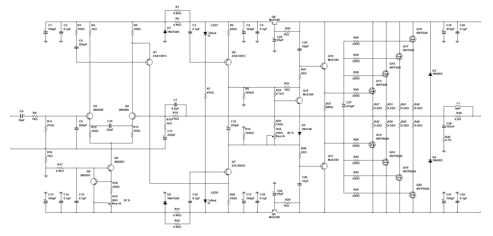

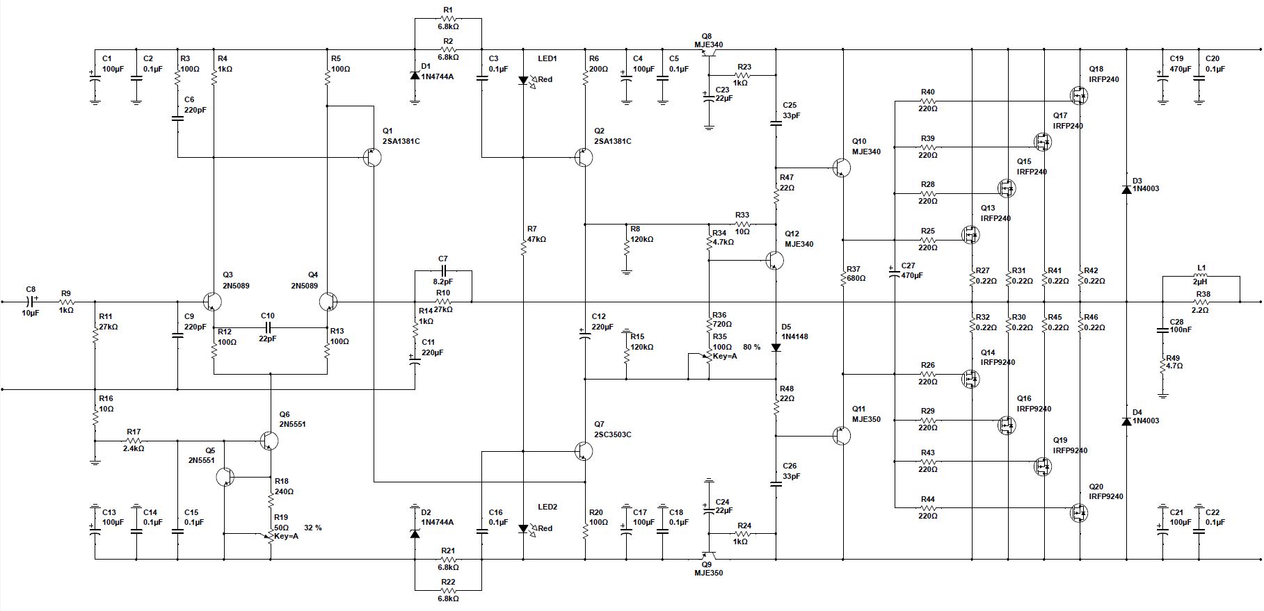

So, in order to have a full amplifier, you need to connect a front-end (giving you all the voltage gain) to a unity gain buffer (giving you all the current gain). One of the good options (EF + HexFETs) is shown in the attachment. With +/-70-75V rails it will give you up to 250W of high-quality power at 8 ohm load.
The other one - mini Slew - is shown earlier in this thread. 100% BJT one will also work perfectly - original Slewmaster by Ostripper is a good example. If you use some other EF3-based BJT output section - just make sure an additional pole, appearing in this case, is properly addressed in order to avoid overall stability issues.

That schematic might turn into a complete single board amplifier channel.
Post303
Can you add identifiers where crossing traces are linked? To differentiate from crossing traces that are not linked !
Andrew, I hope, this one looks better.
Jeff - it's from Multisim, presenting it even worth than Diptrace does
Yes, it can be a good single-board amplifier
Valery

Does the schematic get easier to view if you print it to a pdf with Foxit? It does a nice job on Diptrace schematics.
That's what I did - printed to PDF, enlarged and made a screenshot
