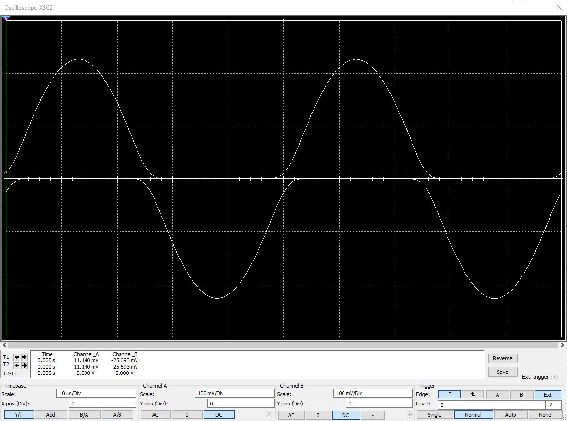

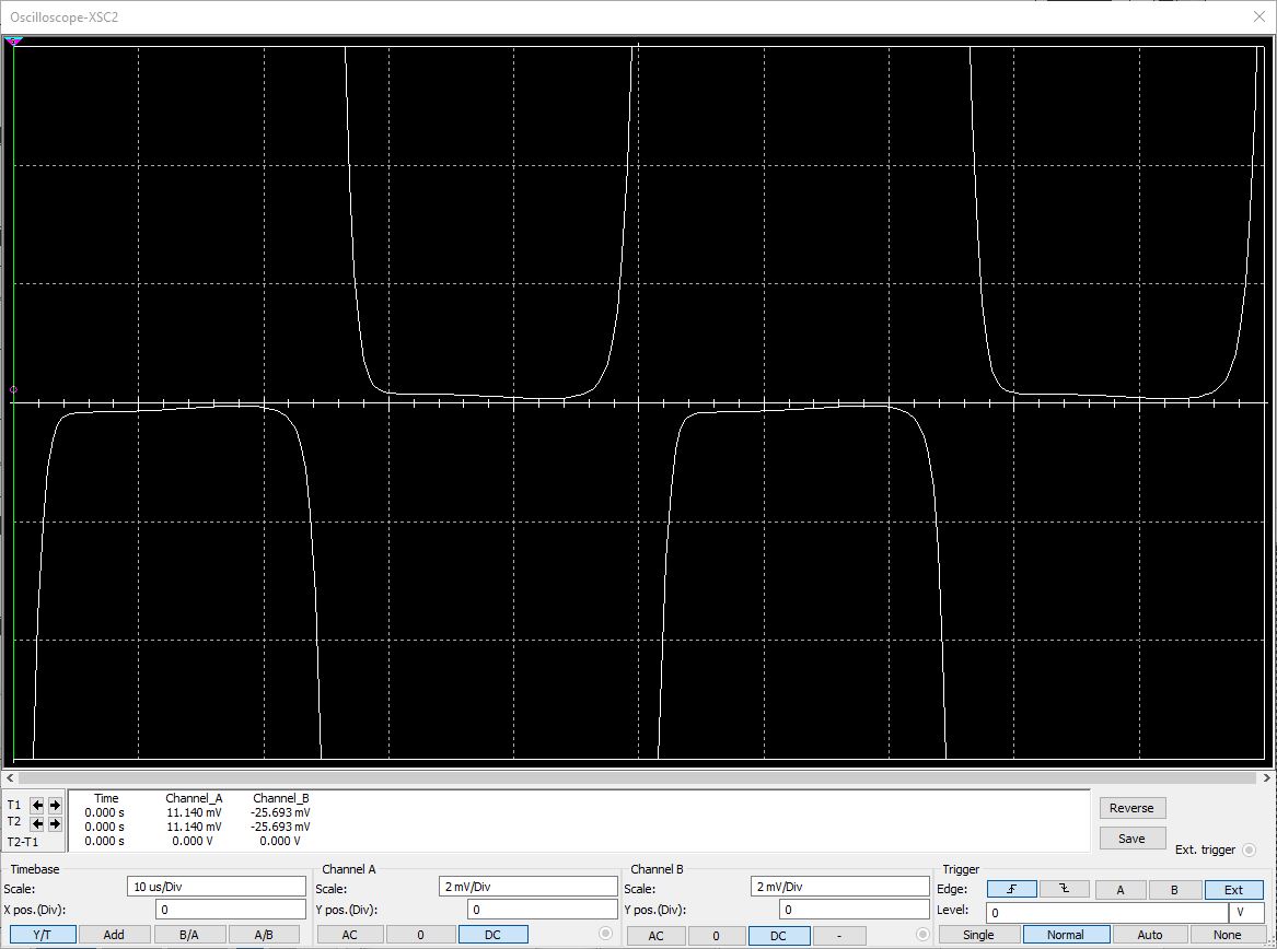

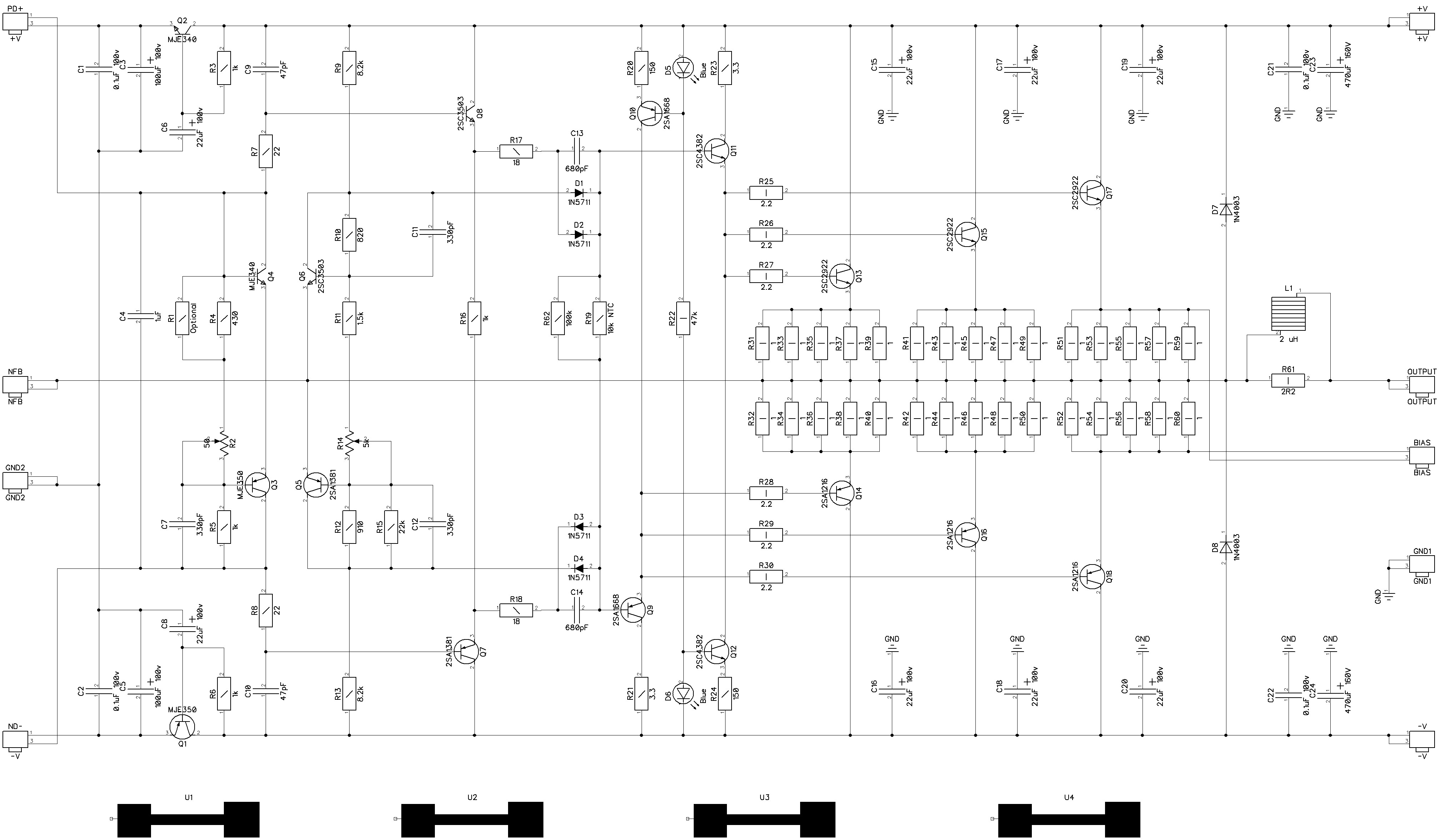

Hi Guys,
Is there more information about the Non-switching Class A driver stage OPS? I'm trying to get it finished but I can seem to find the schematic.
Thanks, Terry
Hi Terry, schematic is in the post #144.
Valery
Valery ,
can you try to explain how the non switching circuit works... Do you have any device voltage/current plots over the 0 crossing line.. What is the Idle current?.
Hi Michael,
The principle is very simple yet efficient.
The first Vbe spreader, on the left (Q3, Q4) sets the quiescent current at no signal conditions - as usual.
The second Vbe spreader (Q5, Q6) - sets the minimal bias, making sure the collector current of the inactive shoulder comes close to zero, but never touches it, preventing the output transistors from closing completely.
Then, there is a diode clamp (D1-D4) - that's the mechanism, making this bias limiting happen. It is important to use rather fast devices in both the second spreader and the clamp to ensure smooth operation (no artifacts) at the higher end of the audio bandwidth.
The pictures below show the voltages at the emitter resistors of the output pair, equivalent to the collector current curves (left - full picture, right - close-to-zero area closeup). You can see, it comes close to zero, but never crosses it (in the normal push-pull EF it always does). You can also see, the limiting is rather soft - no sharp corners - which is also good to have.
I have received the PCBs and starting soldering one channel - we'll see it live soon Although, Terry can do it quicker, as usual
Valery
Q3 serves temperature dependent VBE? but Q5 does not? Or both are thermally coupled?
Q3-Q6 are all placed on the main heatsink, under the board, in particular positions.
