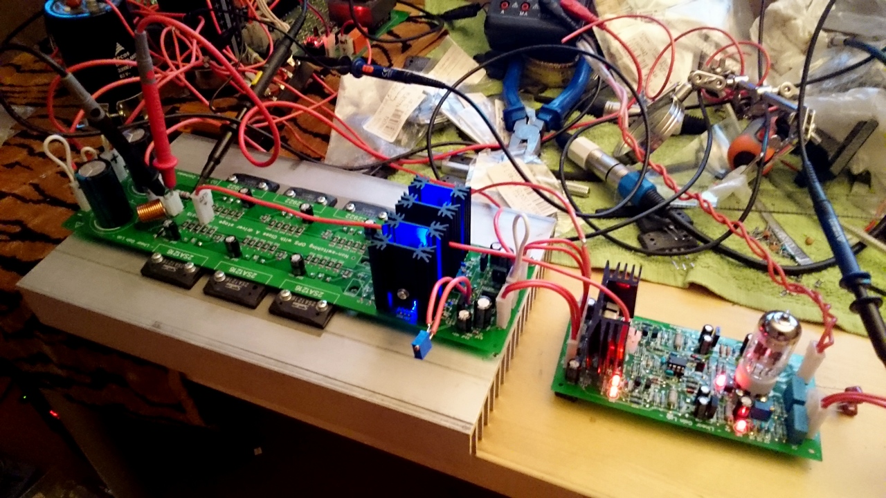

Hi All, first power-on of the non-switching OPS went well. It is under-biased so far, but it works ok in general. Hope, tomorrow I will have time to bias it properly and test the clamping mechanism.

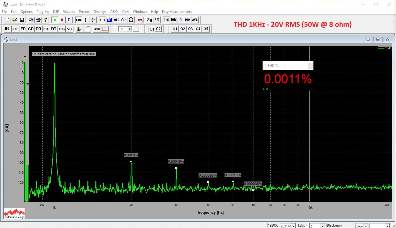

Briefly tested with proper bias, one pair of output devices and briefly set bias clamping (in combination with TubSuMo front-end, adapted to +/-50V rails).
THD does not exceed 0.002% at 1KHz and 0.004% at 20KHz (20V RMS @ 8 ohm = 50W).
Wait, tomorrow I will publish the method of setting up the 2-nd spreader the right way.

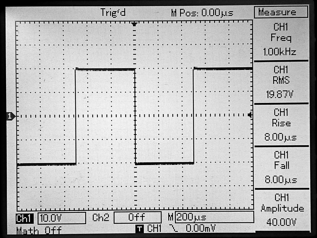

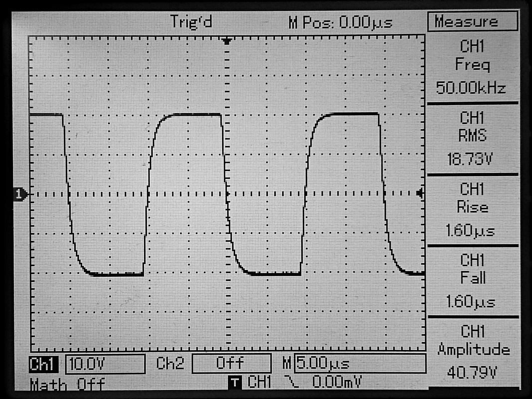

Full scale test!
Delicious 😎

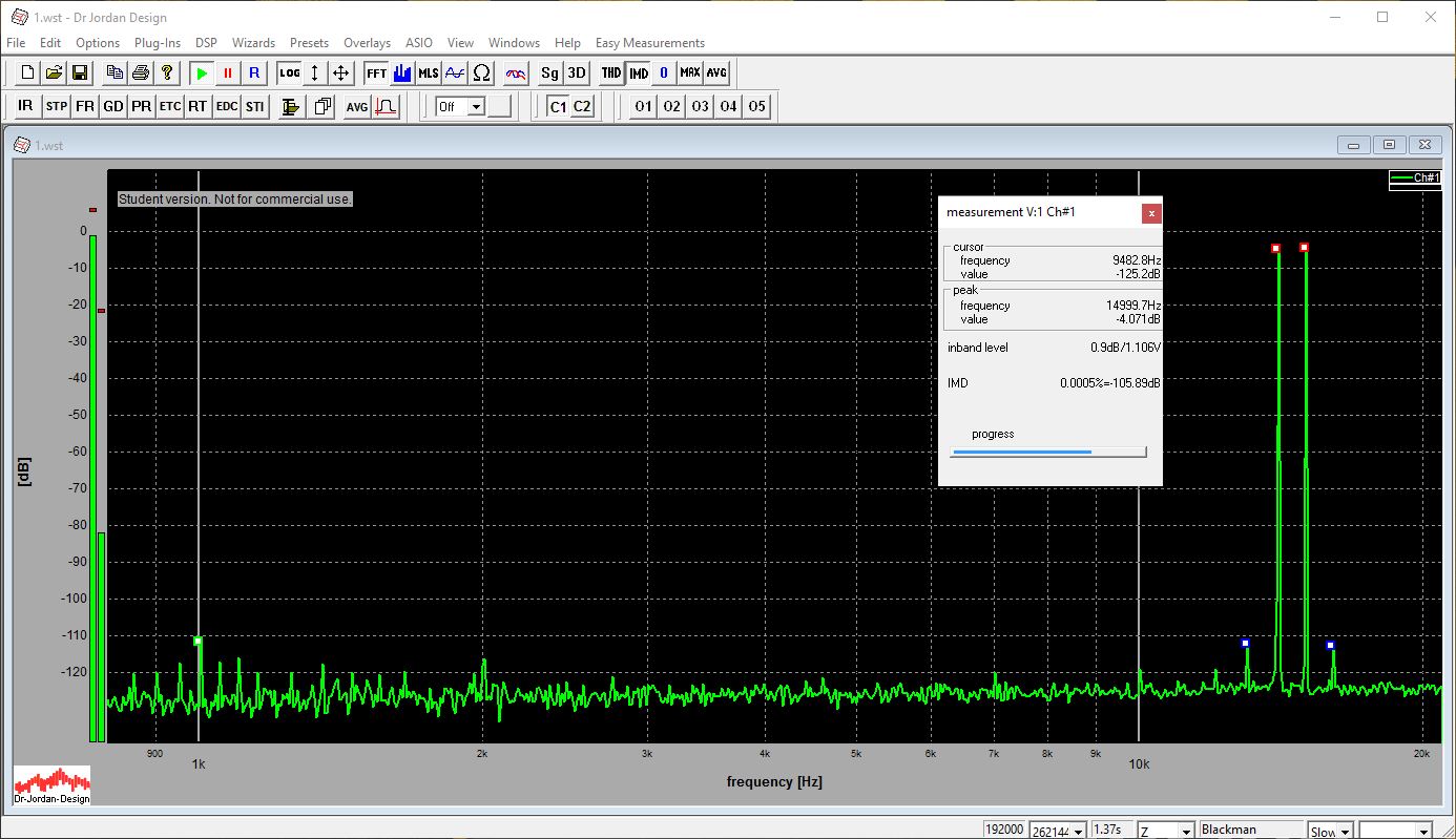

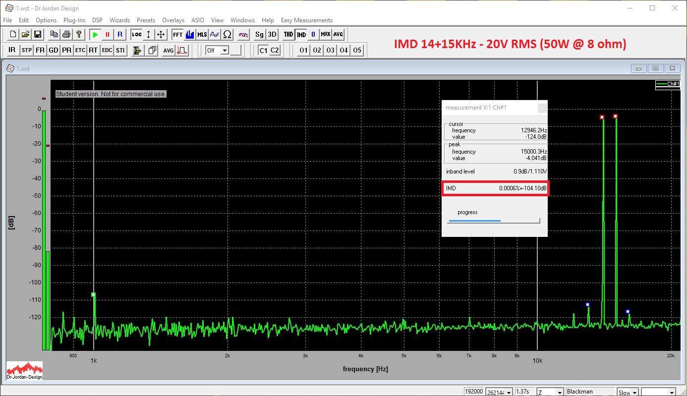

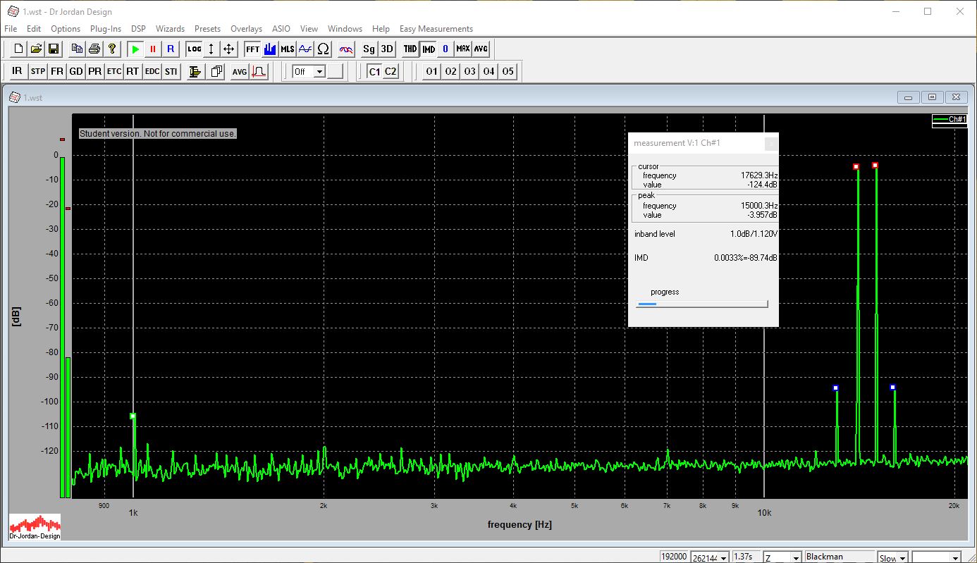

Tested and measured in combination with TubSuMo front-end, adapted to +/-50V rails (got this PSU on my test bench now).
Bode, spectrums at 50W @ 8 ohm (see the IMD one!), squares, clipping.
Distortion is pretty damn low even at the higher end of the audio range.
Next post - some useful instructions for building and setting it up the right way.

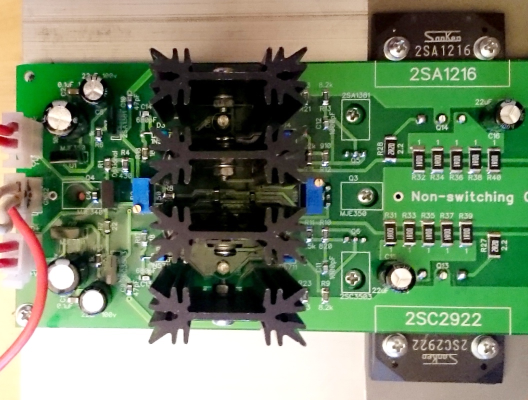

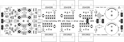

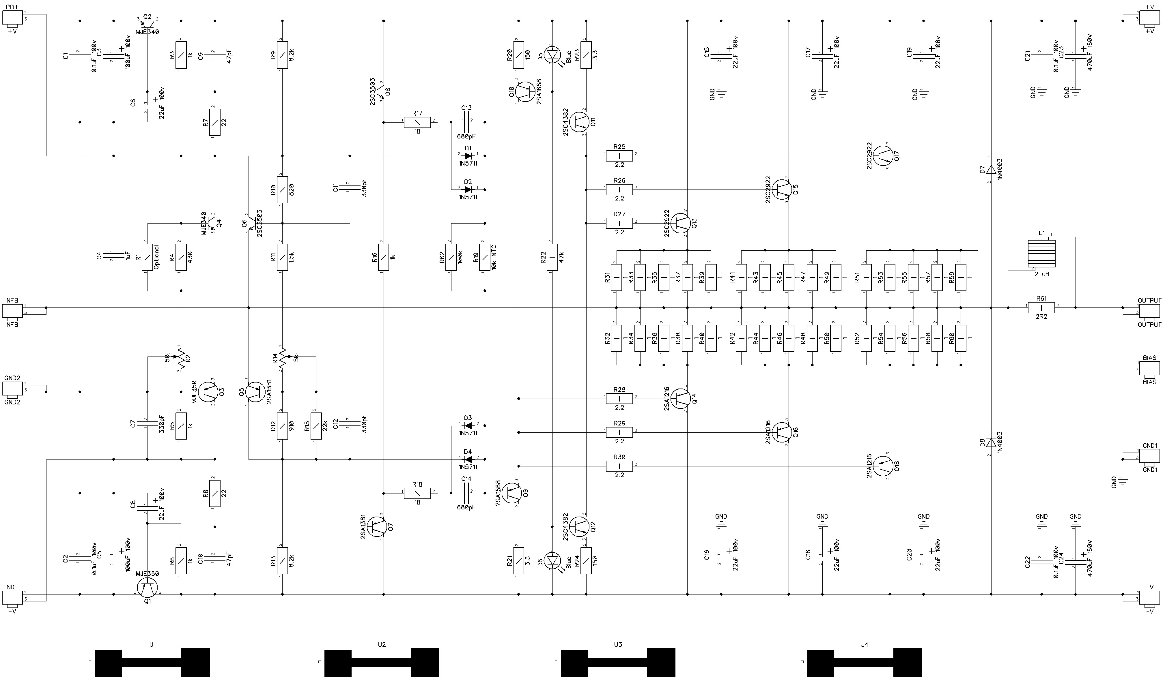

Building instructions
Q4 (npn in the 1-st spreader) - don't put it on a heatsink under the board. Put it vertically at the top of the board (mind the pinout, base is always marked with square plate).
R1, marked "Optional" - put 2.7k there (good for 8mA TubSuMo VAS).
R19 - NTC under the board - put it close to the board (1-2 mm from the board), it does not need to touch the heatsink, measuring the ambient air temperature.
See the trimmers orientation on the photo - R2 (on the left), trimming screw is at the bottom, R14 (on the right), screw is at the top.
Before you power it on:
1) Set the bias trimmer (R2) all the way counter-clockwise (maximum value);
2) Set the clamping trimmer (R14) in the middle position (or a bit counter-clockwise from the middle).
3) Connect the milli-voltmeter to the "BIAS" plug (200mV scale or so).
Make sure, everything is connected properly, you did not forget to connect NFB.
Power On. Now:
1) See the voltage on the milli-voltmeter, must be couple of millivilts. Rotate R2 trimmer clockwise slowly and carefully - voltage will increase, set it to 30-35 mV. Let it warm-up (10-15 minutes) and adjust again.
2) The dummy load (say, 8 ohm) is in place, send the input signal (1KHz), so that you have some 10V RMS sine at the output and leave it this way.
3) Note the voltage at your milli-voltmeter. Now start rotating the other trimmer (R14) clockwise carefully - watch the voltage at your milli-voltmeter. As soon as it starts growing a bit (plus 5 millivolts or so) - stop and leave it this way. Your clamping spreader is set to the optimum position.
Once again - you set the bias (R2) with no signal, but you set the clamping spreader with the signal constantly on.
That's it - the board setup is done.

TubSuMo amendments
Here are the TubSuMo front-end amendments.
First of all - those need to be changed in any case for stability improvements:
1) R27-R31 - see the values on the schematic attached;
2) C18 - increase to 15pF (lead compensation).
Now, if you want to run it from +/-50V rails (instead of the original +/-70V):
1) R6 = R11 = 10K;
2) You can also remove D8, D9 zeners - they will not work properly anyway at this lower voltage.
That's it. Enjoy 😀

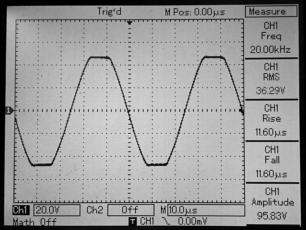

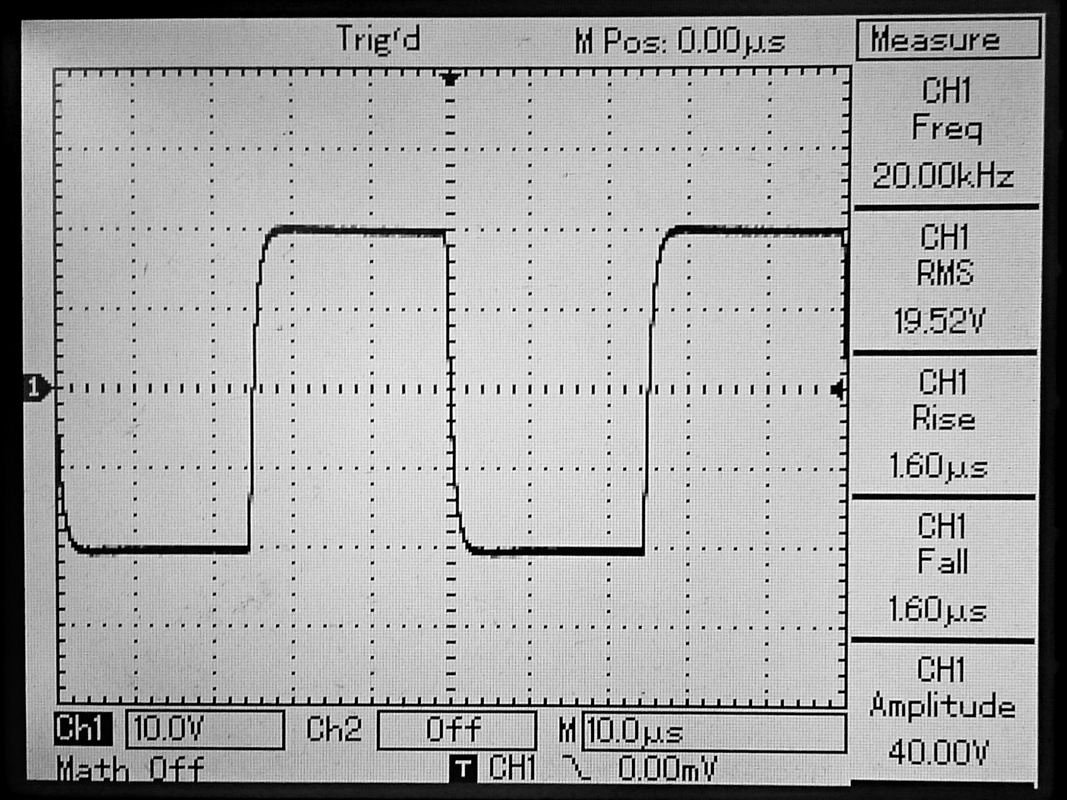

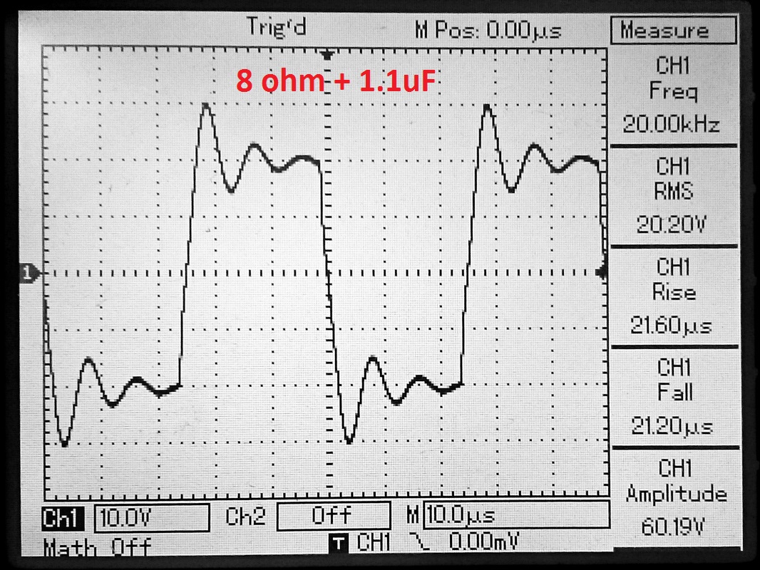

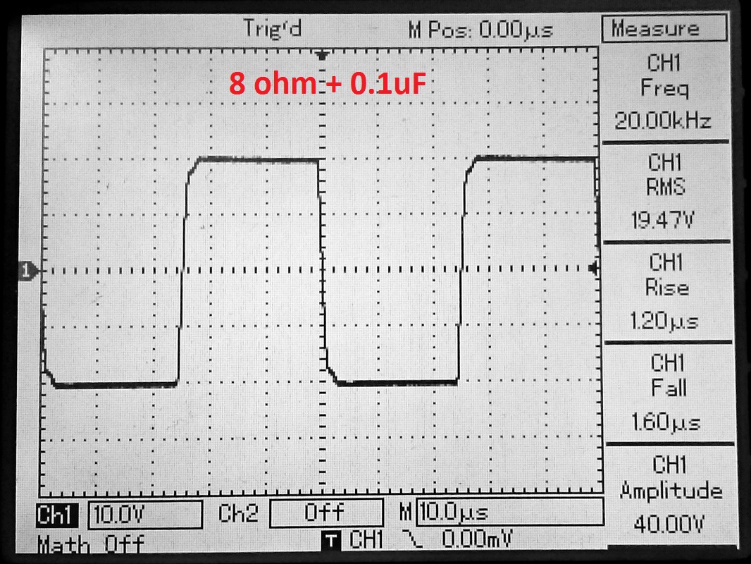

Hi, how it works on capacitive load (as example: square signal 20 kHz to 8 om+2,2 uF)?🙂
OK, tested with 0.1uF and with 1.1uF - the ones I've got in hand right now 🙄

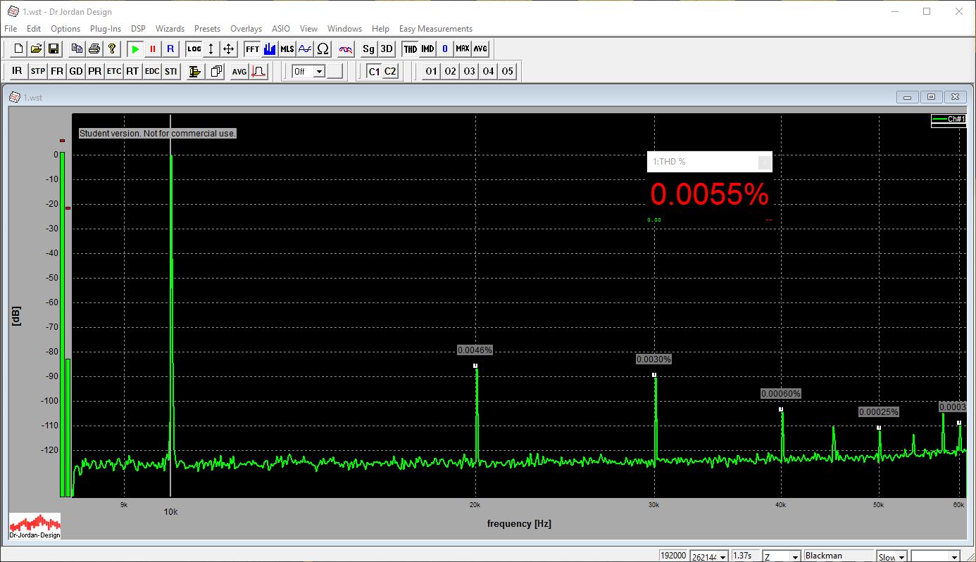

Hi Valery!
wow!
but how about the tests lets say 1-5W 1kHz at resistive vs real speakers load?
Once you told you will make it...
Good AMP.😉🙂🙂🙂😀
You asked for the spectrums with capacitive load 😉
Same 50W output power.

Hi Valery!
wow!

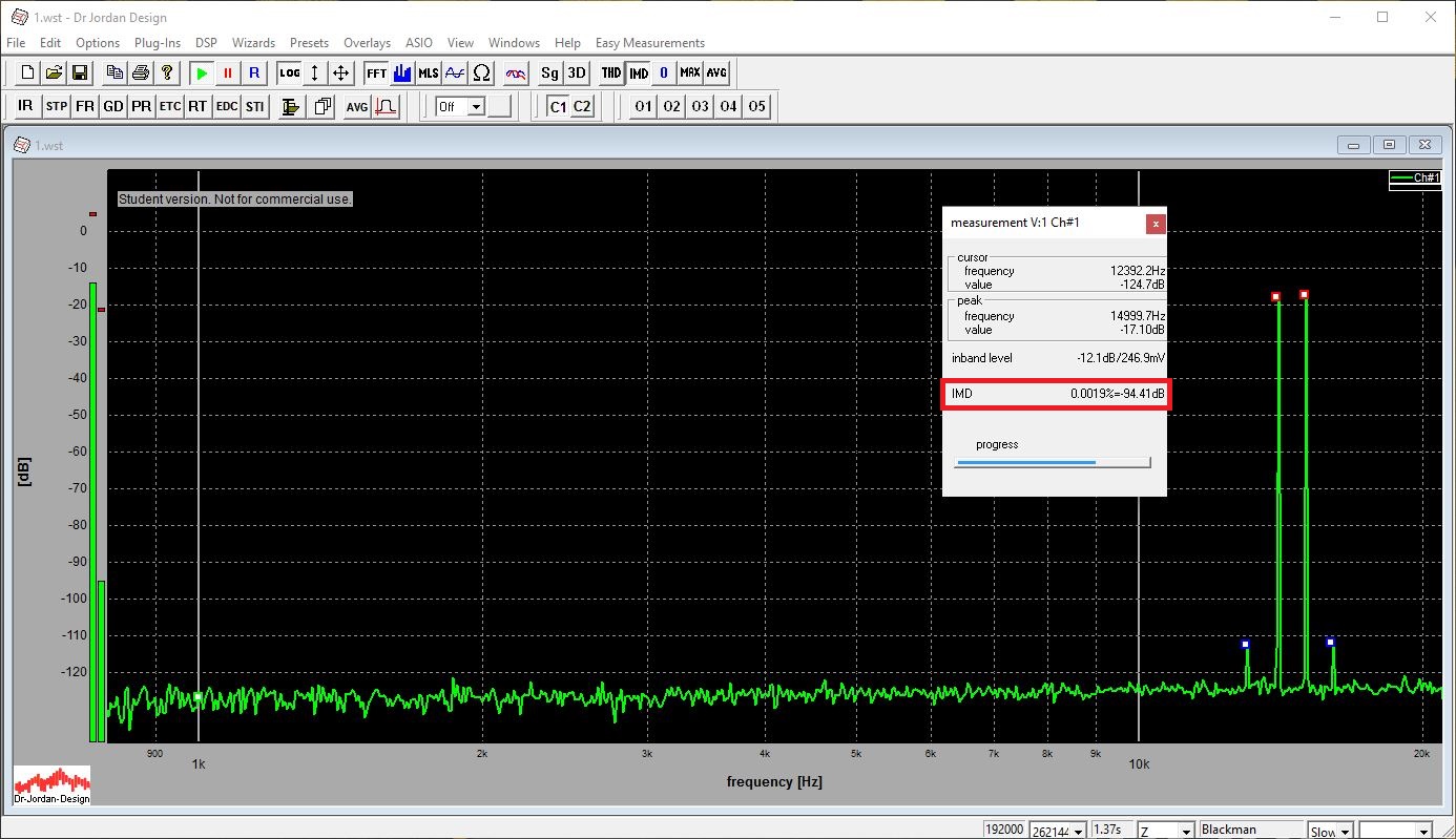

Hi Pawel,
Thanks for reminding me 😀
Here are THD and IMD measurements for 2W @ 8 ohm.
