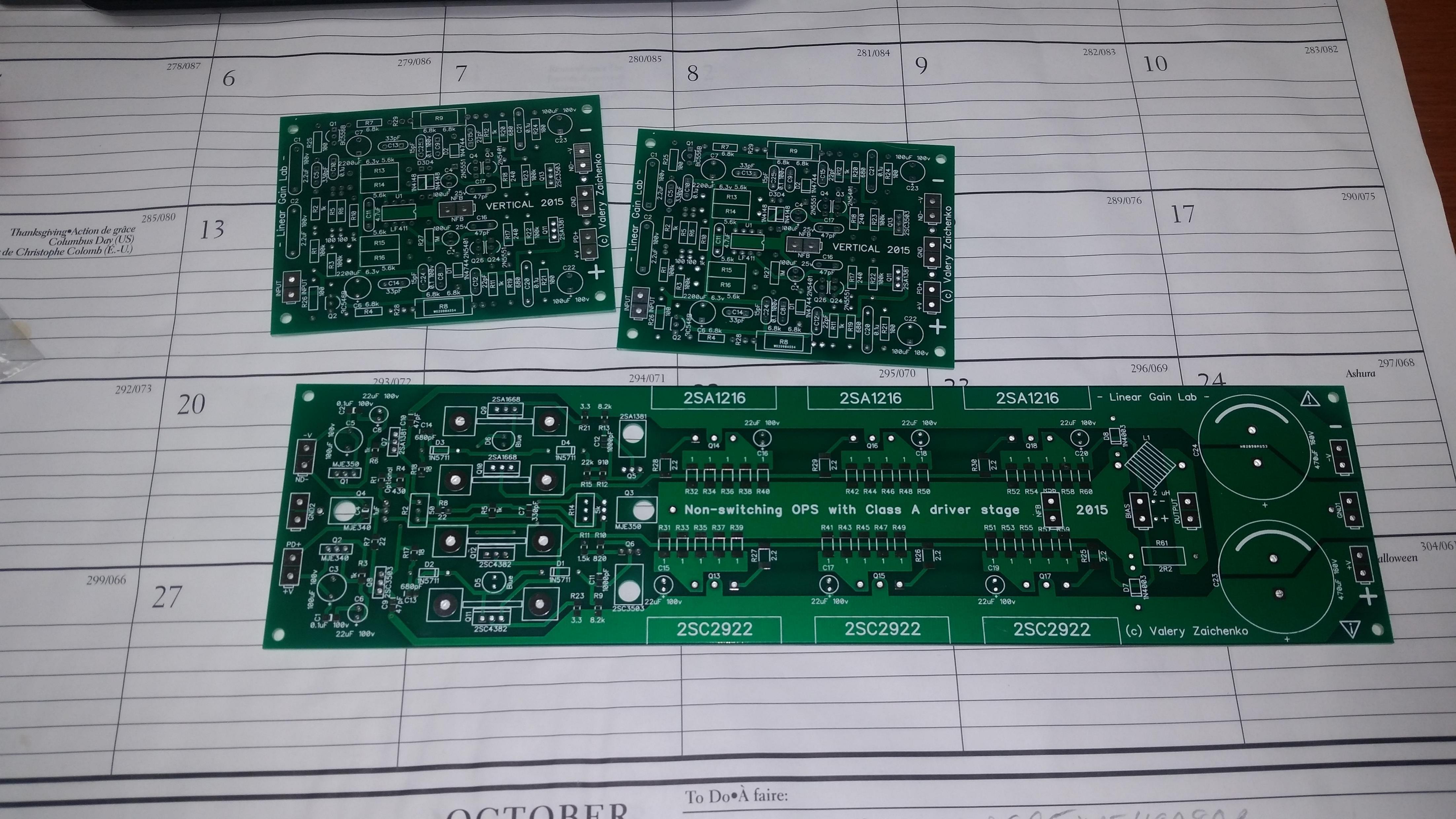

I don't have any 18R resistors in stock for R17 and R18 on the output boards. Will I be able to correct the increased current flow of 15R resistors when doing bias adjustments?
Hi Jeff, 15R is going to be ok.
Please don't forget to use 150pF as C9, C10.
Thanks. I'm missing a few other values of resistors as well, so I need to wait to finish this.😡

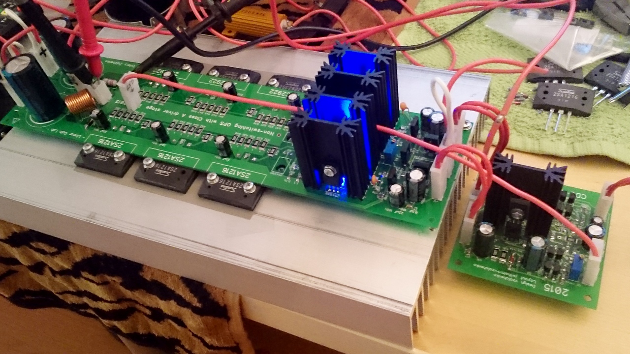

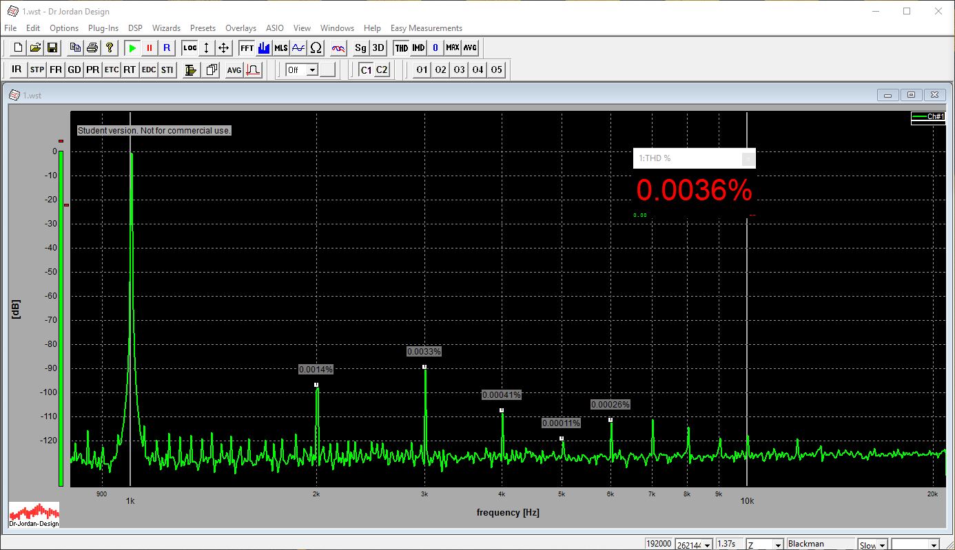

VERTICAL IPS + Non-switching OPS

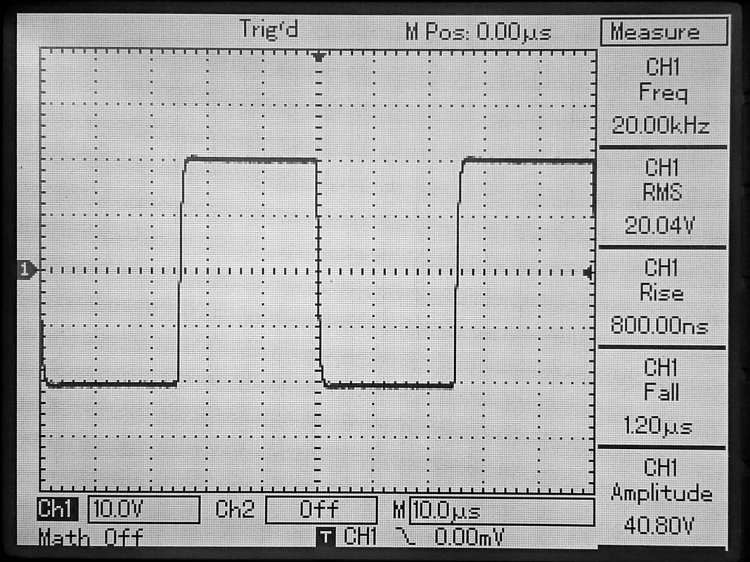

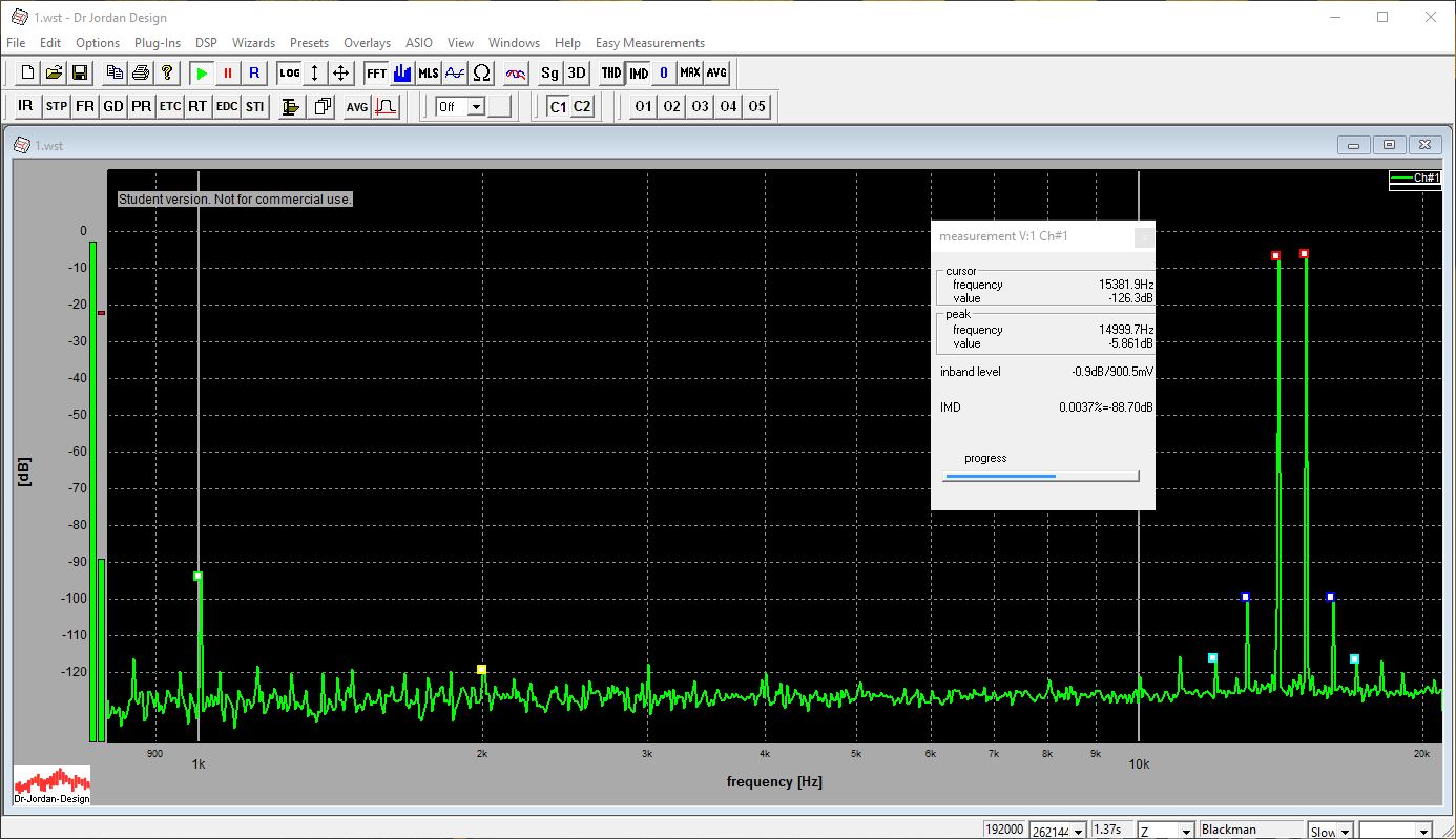

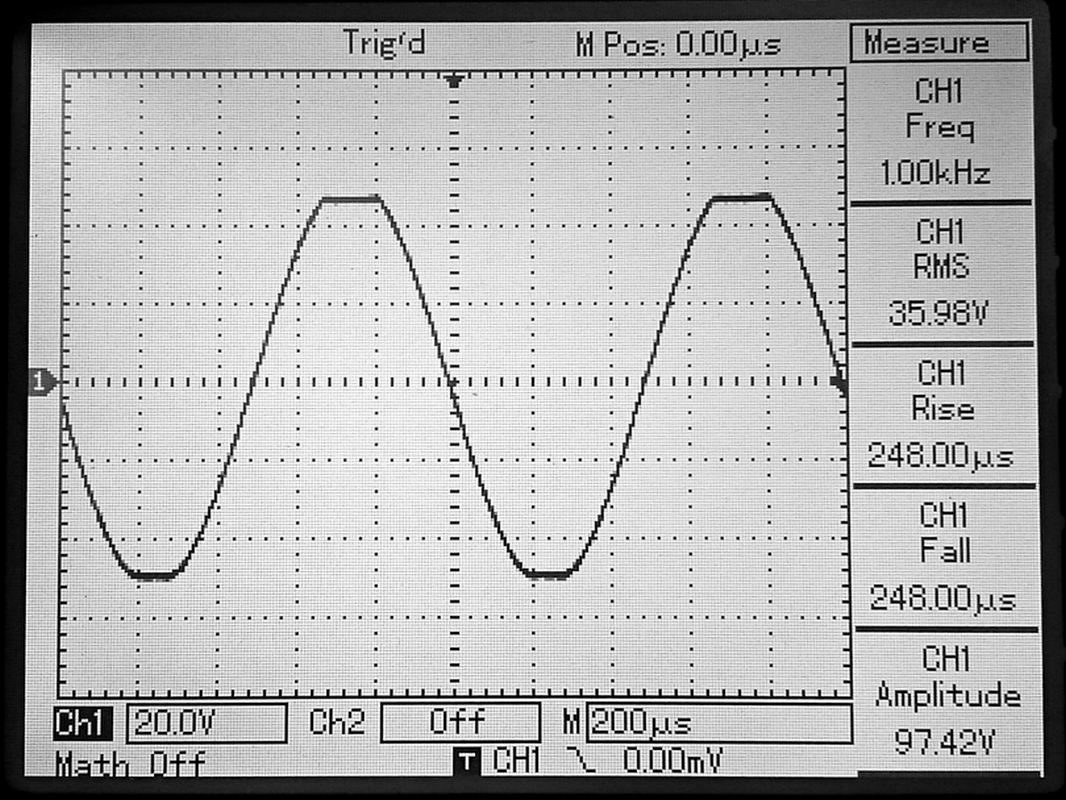

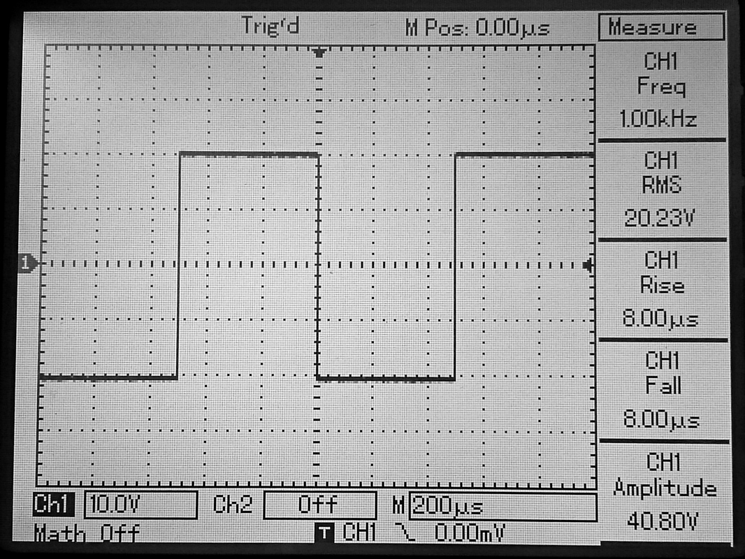

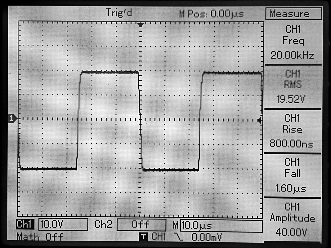

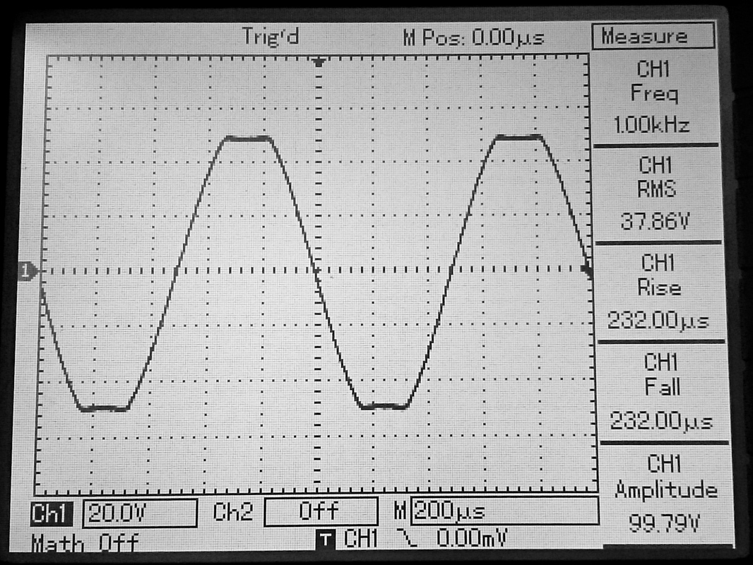

Tested and measured Vertical IPS (CFA) with non-switching OPS.
Spectrums are 50W @ 8 ohm, square waves are 40V p-p, clipping is close to the rails (100V p-p).
Measured slew rate is around 100V/uS. Not bad 😎
I will publish minor updates to the Vertical soon.

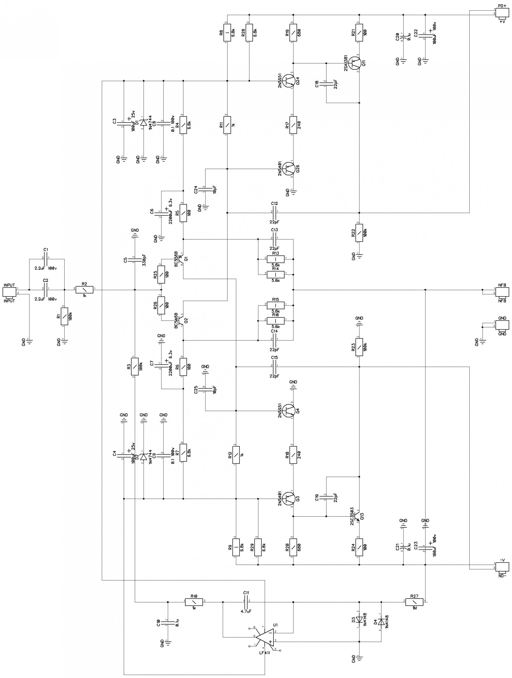

Hi
had set up a thermal simulation , am confused..which transistor actually senses the heatsink temp?
Hi
Hi, on the schematic in post #348:
http://www.diyaudio.com/forums/soli...e-old-ideas-1970s-ips-ops-35.html#post4554894
the one sensing for bias setting Is Q3.
Q4, Q5 are also on the heatsink, adjusting the clamping voltage.

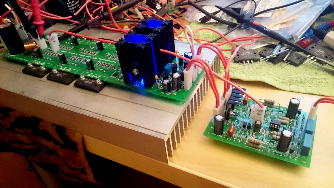

VERTICAL IPS - final schematic
Removed the caps in parallel with R17, R18.
R19, R20 value is slightly increased to match the current settings of the non-switching OPS. Jeff - these values will be good for your "bundle".
Also note C18, C19 - they were added earlier but they are not on the first version of the PCB. I keep them under the board for now - see the photo.

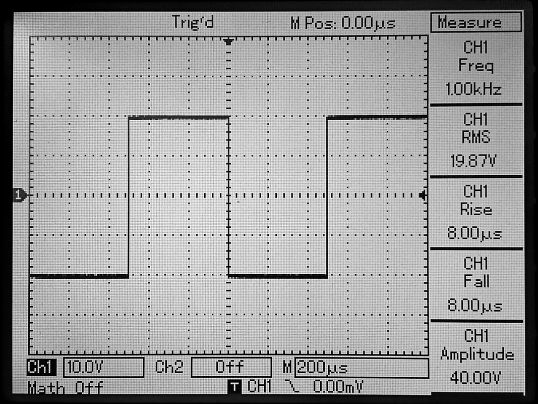

CDC-VFA-CCS + Non-switching OPS

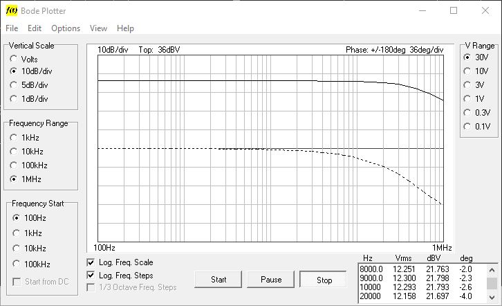

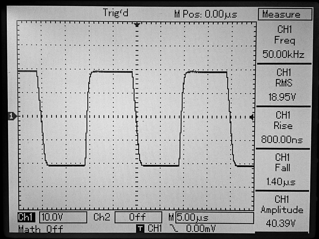

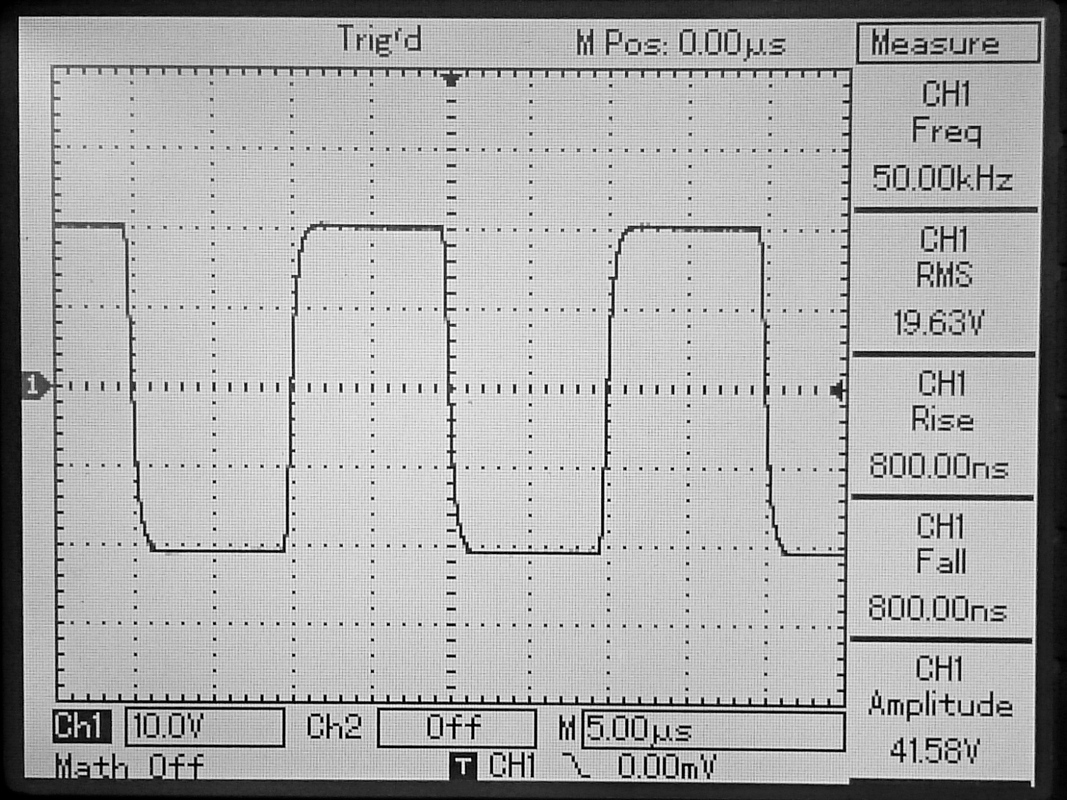

Live measurements for the tiny VFA front-end. This is actually a CFA-fast VFA.
Slew rate and clipping are slightly asymmetric due to the single-ended VAS topology, however the overall performance is excellent. Note the great phase response on the bode plot.
As usual, the spectrums are taken at 50W @ 8 ohm load, square waves are 40V p-p. Power rails are +/-50V (+/-2).
