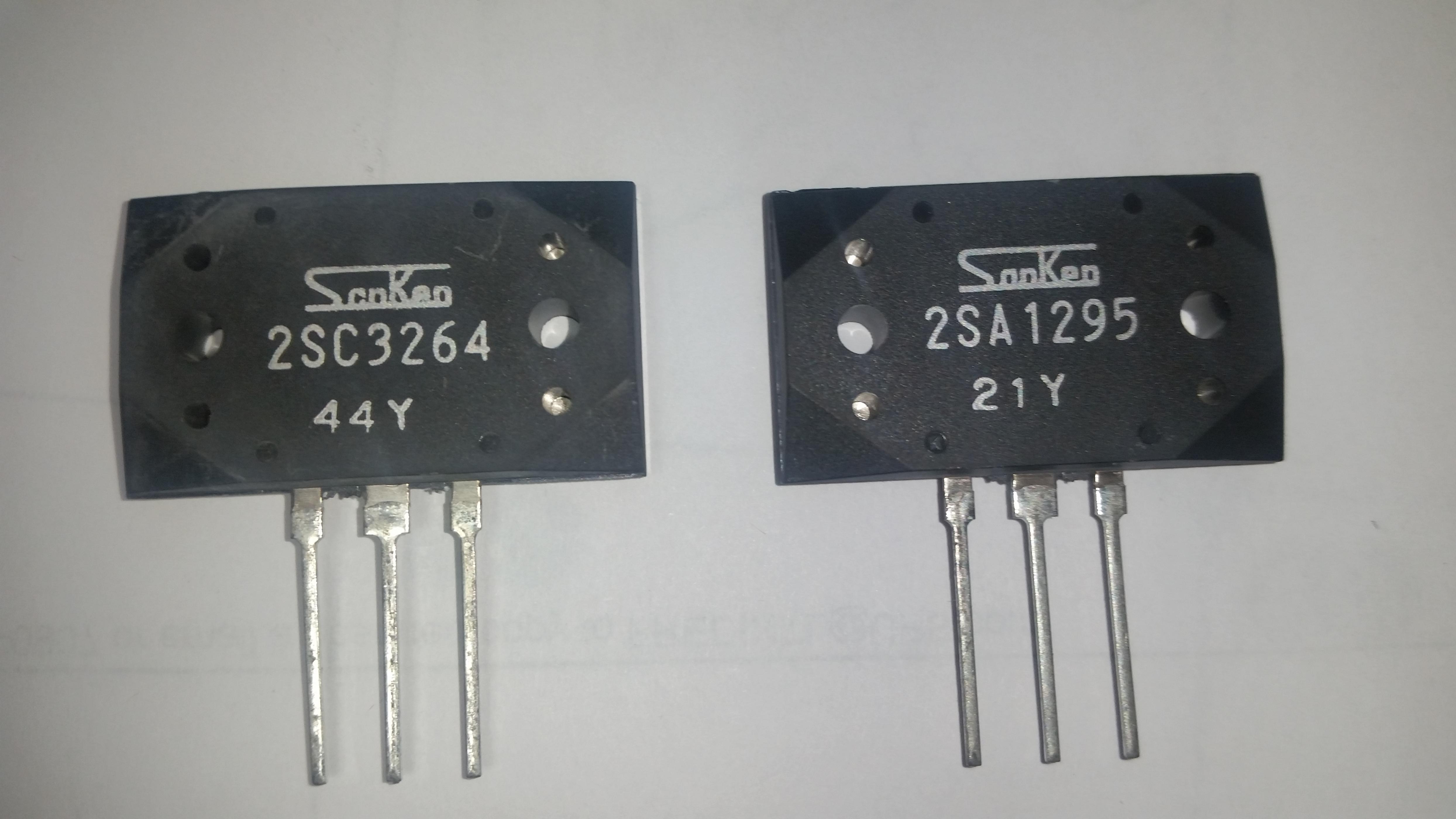

Hi Jeff,Here's couple I torture/tested to death.

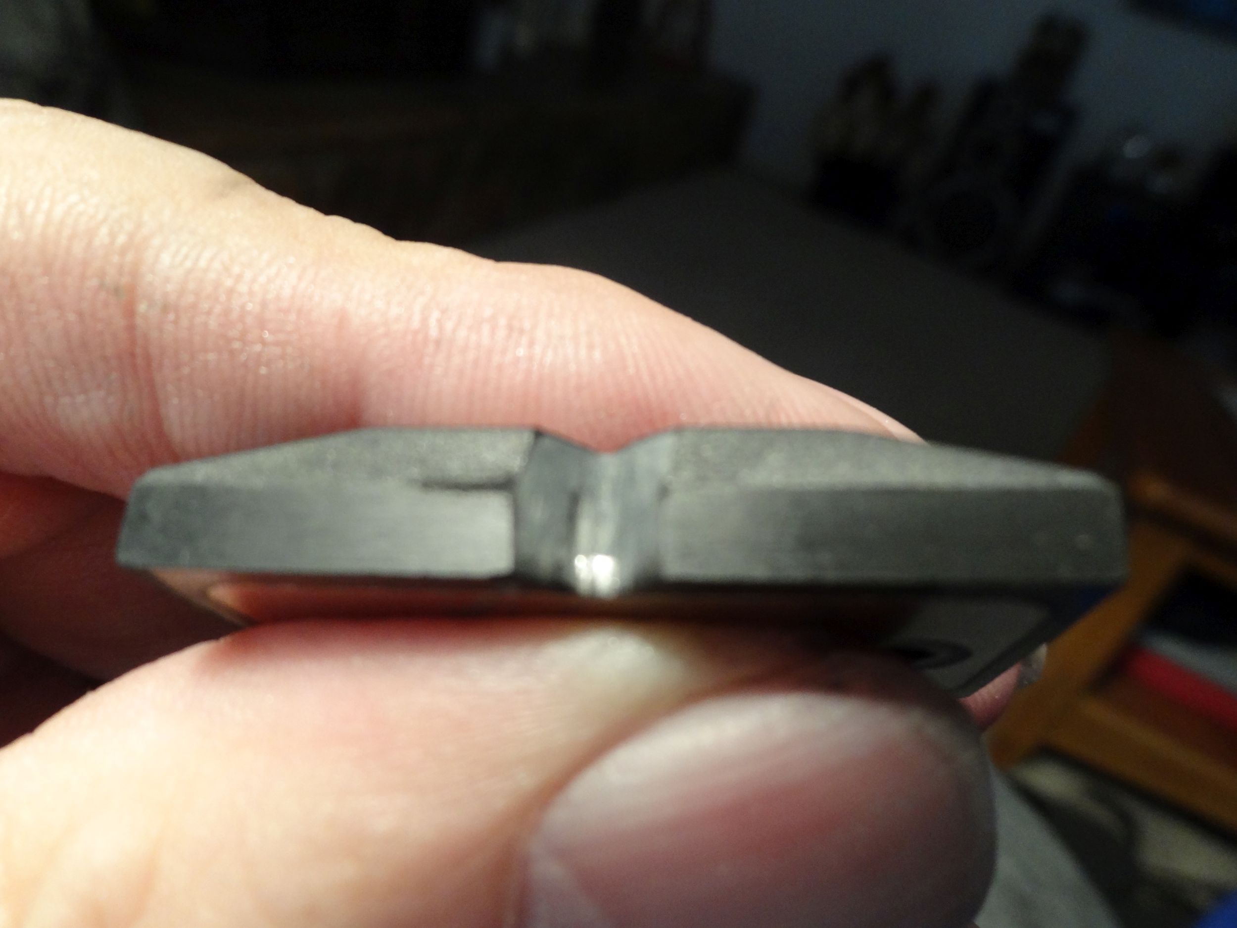

If you look at your broken devices, your will see that the smaller plate runs all the way to the top of the larger plate. The pictures I was shown indicated if a small notch was filed at the top of the transistor so that the plates were exposed, a real sanken will reveal both plates and a fake will not. If you can confirm that I would appreciate it. I suppose it wouldn't hurt anything for me to try the ones I have. I can't return them now anyway.

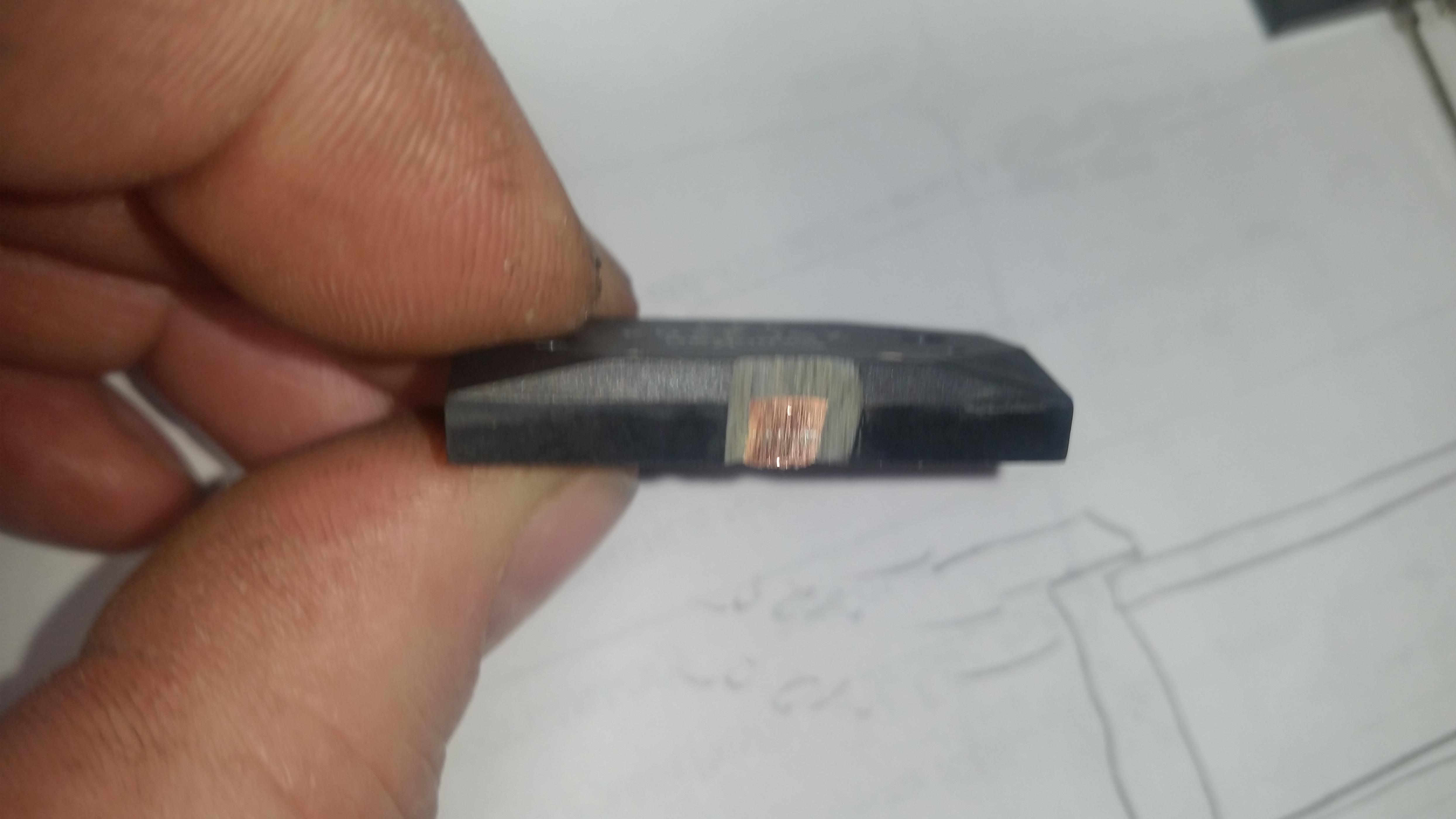

I ground the top on one. You can see two layers of metal backing. It's tough to see in the picture, but there's a parting line down the middle of the copper.
Sanken devices always come with mica thermal pads. This is another sign of real devices.

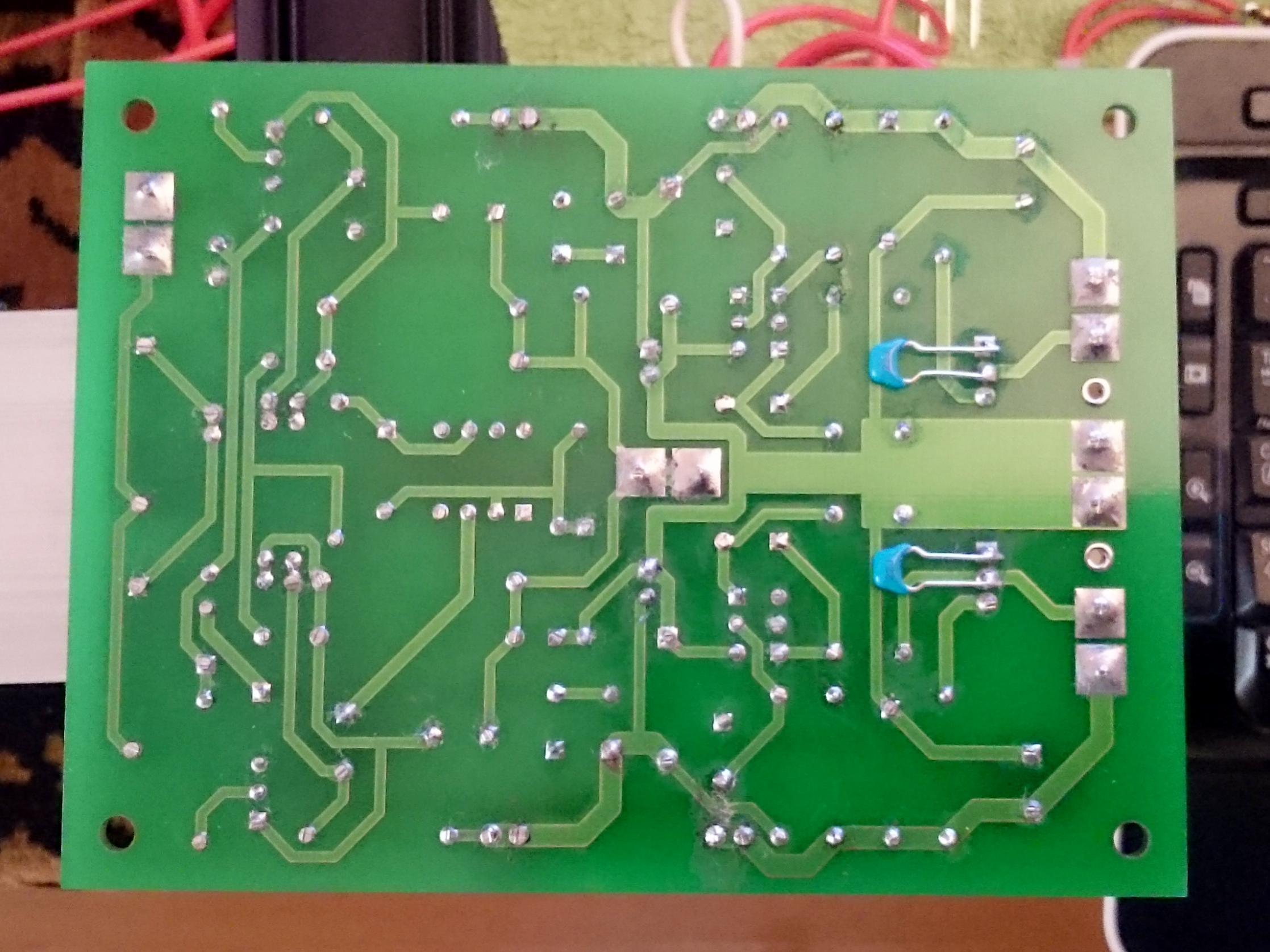

Cool! Just in case - download the latest version of the building and setting up instructions PDF here:
NON-SWITCHING OPS
Also, don't forget to place 2 caps (22pF) under the board on TO-126 devices (VERTICAL) - you've got the 1-st version of the PCB, where they were missing.
