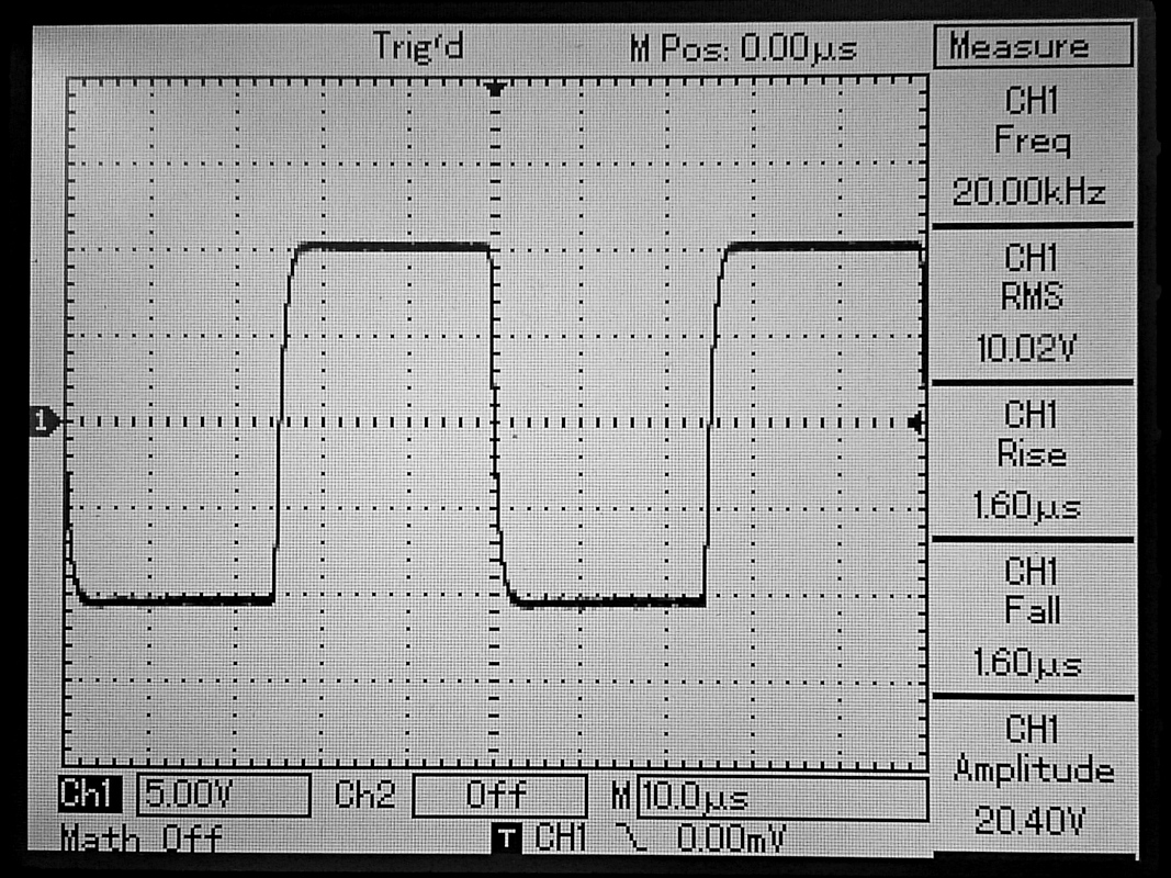

OK, tested with 0.1uF and with 1.1uF - the ones I've got in hand right now :rolleyes:
Just to clarify this point - previous measurements with capacitice load were taken right at the capacitor, behind the coil.
Here are the oscilloscope photos, taken right at the cap (1.1uF in parallel with 8 ohm load) and then the one, taken at the same time right at the amplifier output (before the coil 1.5-2uH). This is TubSuMo IPS + Non-switching OPS :cool:

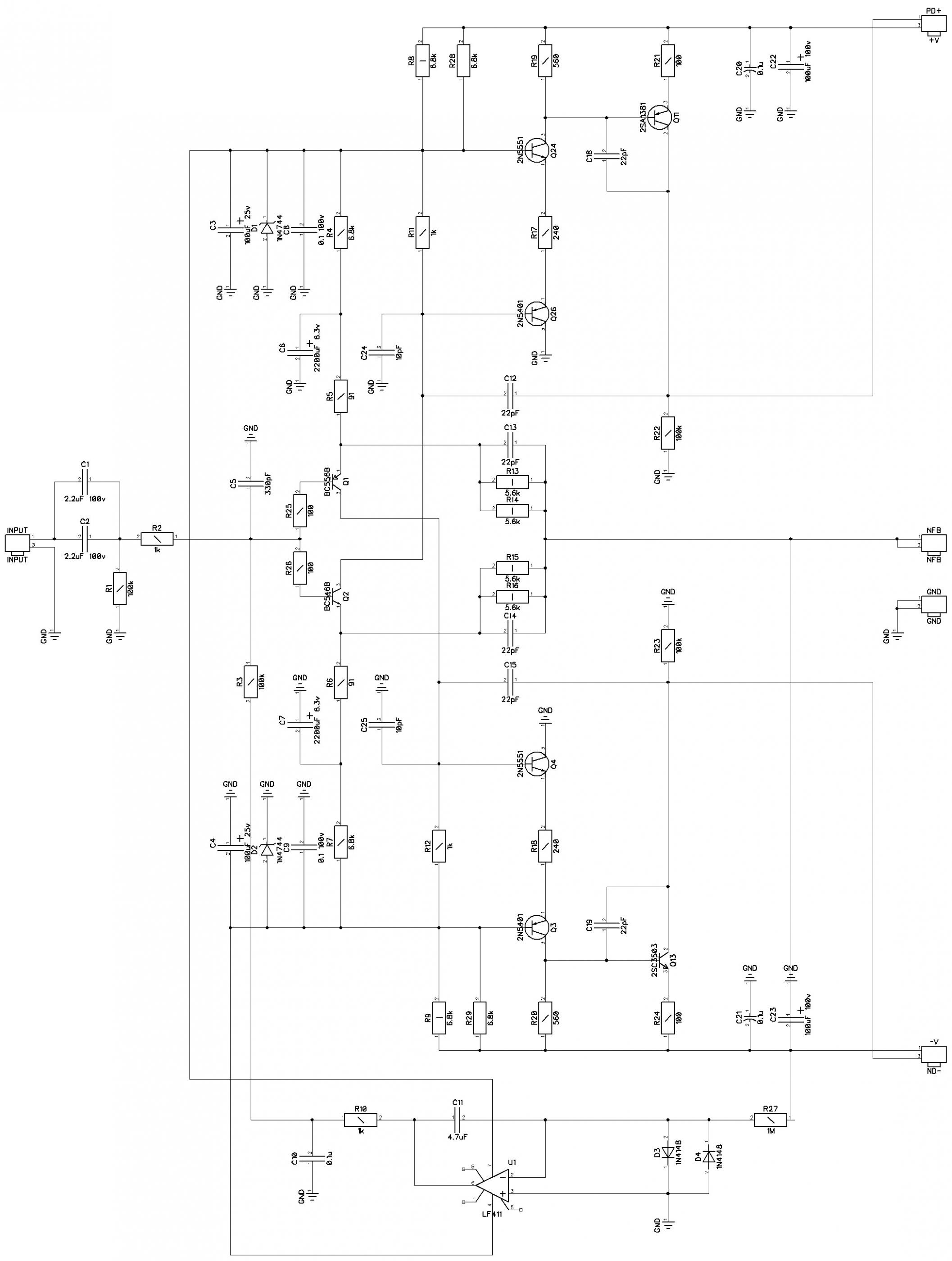

VERTICAL IPS + NS-OPS
Tested and measured Vertical IPS (CFA) with non-switching OPS.
Spectrums are 50W @ 8 ohm, square waves are 40V p-p, clipping is close to the rails (100V p-p).

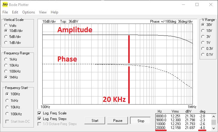

Measured slew rate is around 100V/uS. Not bad :cool:
I will publish minor updates to the Vertical soon.

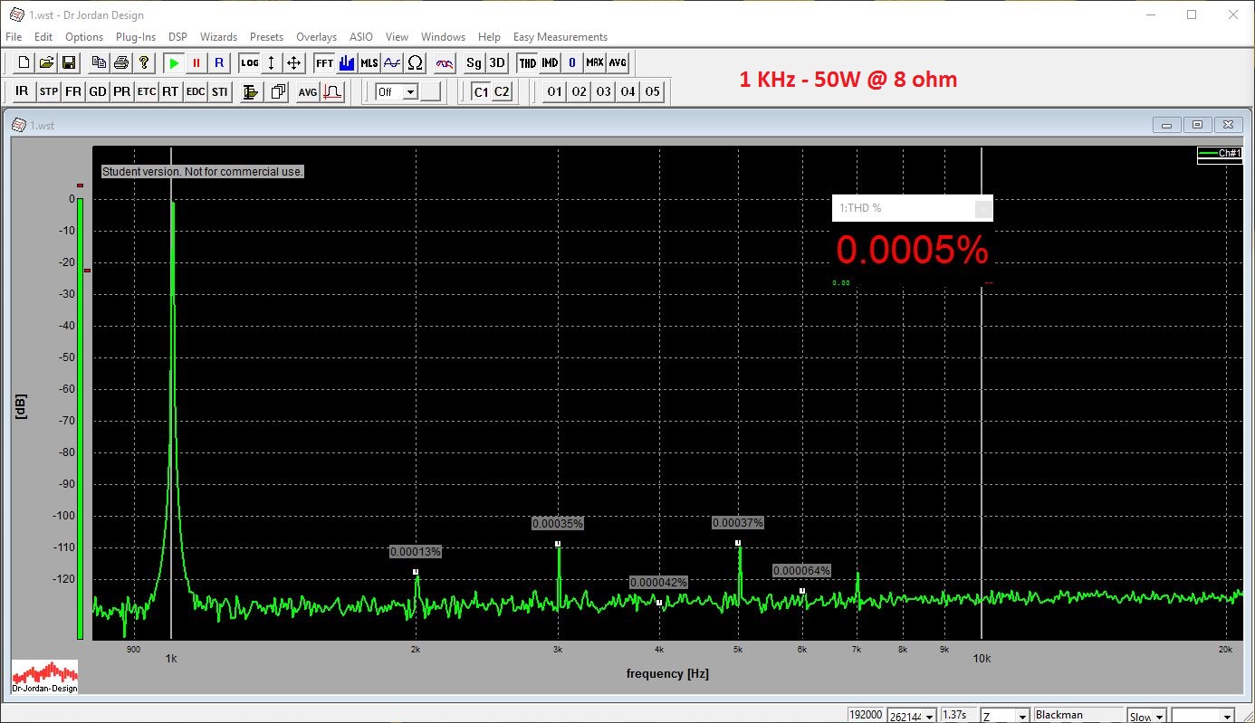

Virtual Zero (distortion) amplifier :p

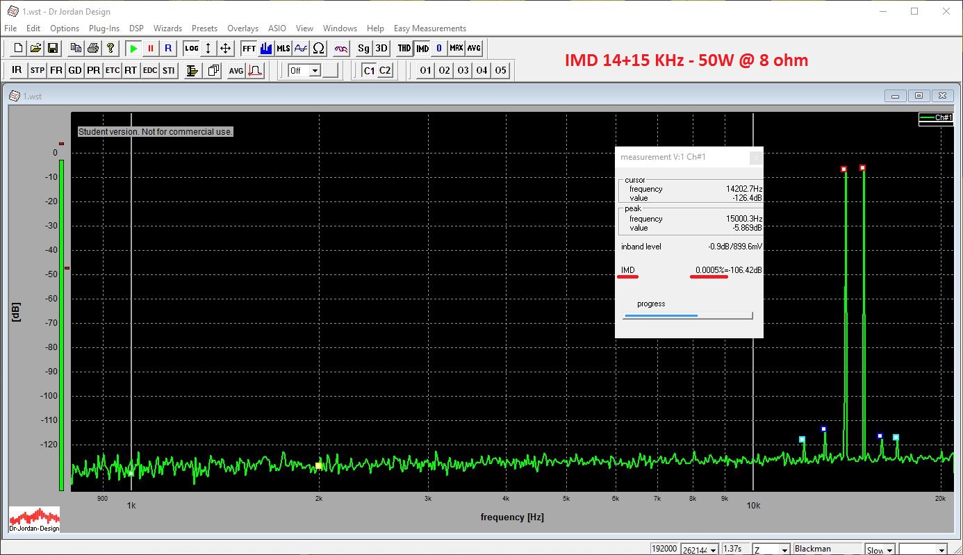

After some minor corrections in VERTICAL IPS and certain tune-up of NS-OPS, amazing results are observed. See the spectrums... I did not believe what I see initially, so I have checked everything a few times, measured with some other front-ends, then with this one again. It's what it is. Measured at 50W @ 8 ohm dummy load (20V RMS) with +/-52V rails.
Sounds delicious, at least in my environment. Jeff - you've got to try and see (hear) ;) Terry, you were also somewhere close as I remember... Bimo - this is also a good candidate for your experiments :rolleyes:
Very, very cool one :cool:
Valery
Valery

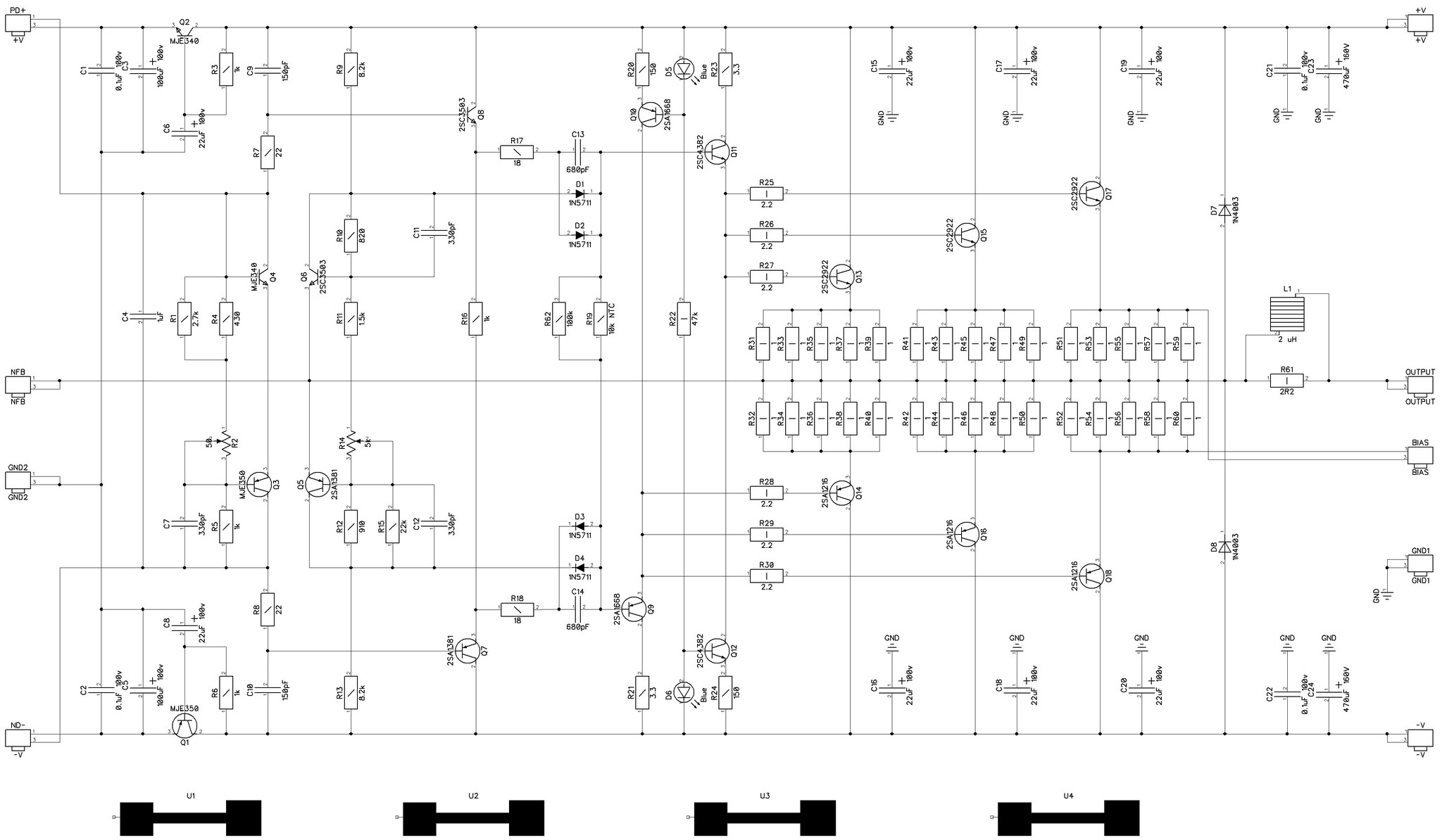

Can you make pdf file for this IPS?
I still do not understand clearly how your OPS work. Can you or someone compare this OPS with EF3 OPS with same IPS?
Congrats Valery, a really great job!
I would be intrested in a small descreption on both IPS/OPS as well if possible.
Do you notice something special in the sound? Or is it "just" good and that's all? :)

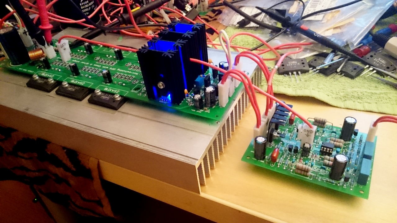

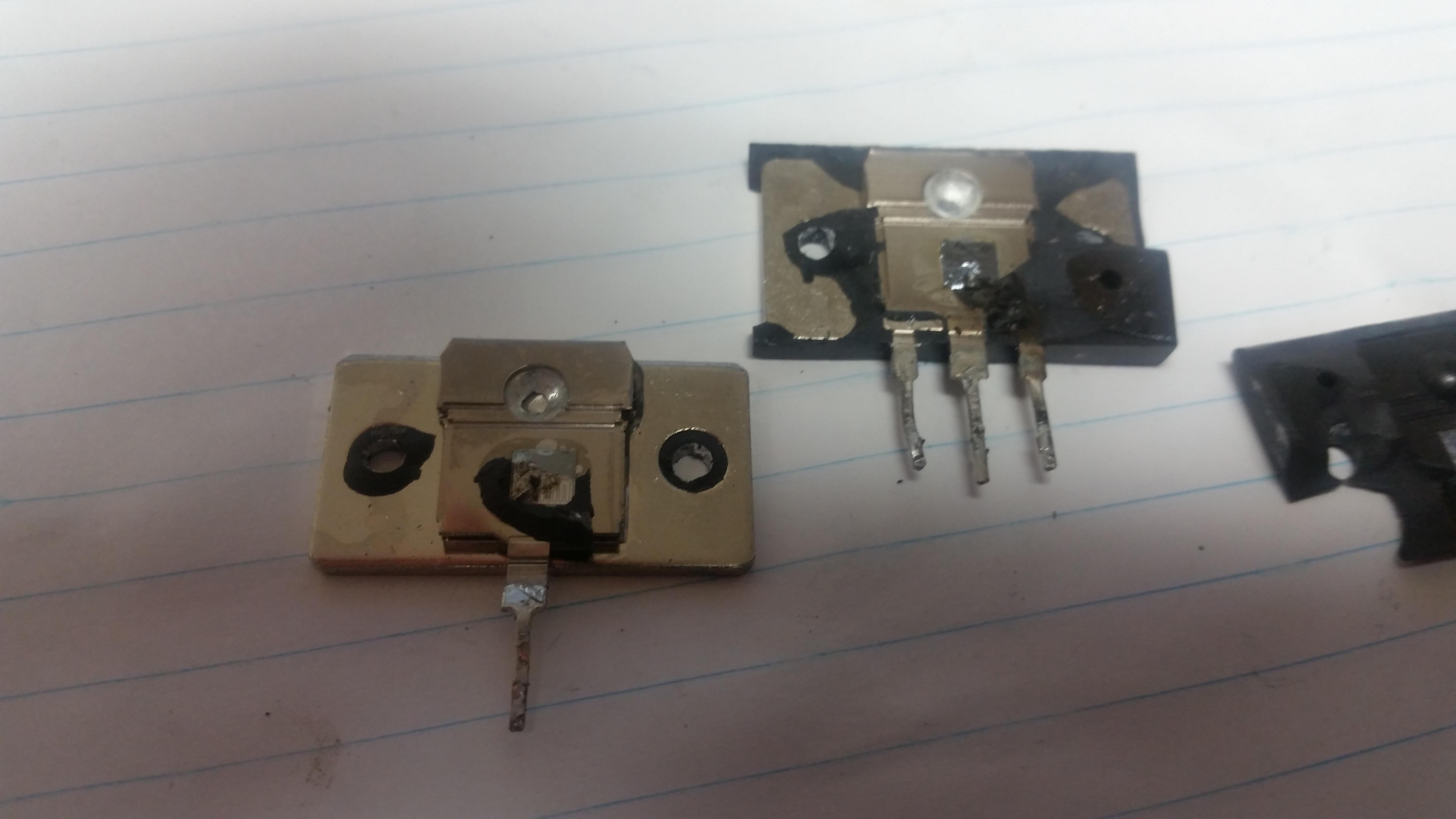

Hi Valery,
I had it all mounted and ready to fire. While waiting for you to get a chance to set yours up I did some reading about the outputs. Newark was out of them when I got ready to order so I bought some from an ebay seller who swore they were genuine. I read you could check them by filing the top edge and exposing the double die. A single die meant they are fakes. Guess what mine had. :( I pulled them to send back but the shipping was half the cost so I just chalked it up to bad judgement. When I can get some real ones I 'll get it mounted again. Meanwhile, could you post the asbuilt for both vertical and the NS OPS?
Thanks, Terry
Hi Valery,
Thanks, Terry
The Sankens are single die, just larger. There is a TO247 inside the MT-200 plastic. Digikey is a Sanken dealer too.

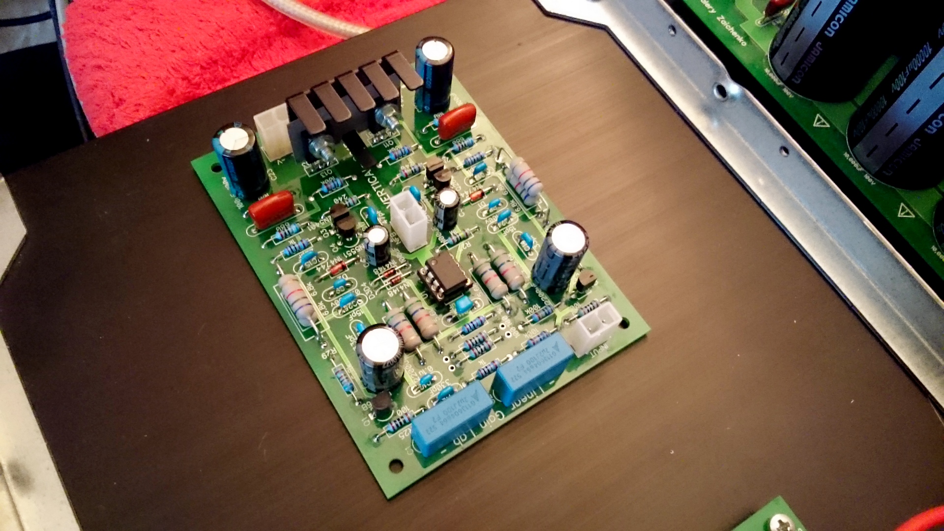

Hi Terry,
Here are the schematics, exactly "as built":
http://www.diyaudio.com/forums/soli...e-old-ideas-1970s-ips-ops-41.html#post4578177
Hope you will find the good Sankens. If not - NJW3281/1302 will work as well, providing slightly lower current capability.
Valery

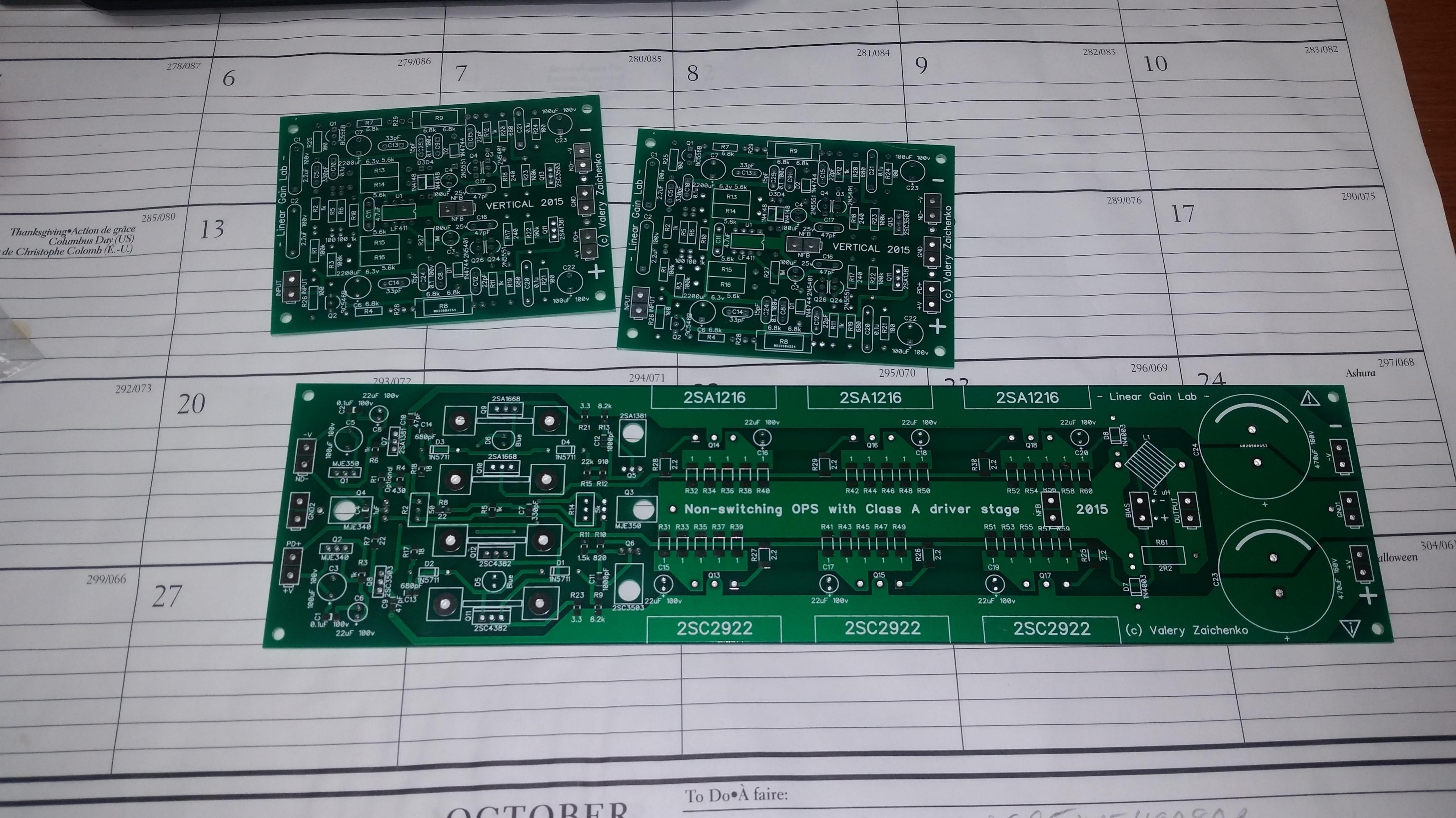

As soon as I finish with the protection boards that Jeff has helped me with the NS OPS/Vertical IPS look like something I would like to try. Any chance of getting the manufacturing files. Would sanken 2sa1295/2sc3264 be suitable output devices...I have some on hand.
Thanks as always,
Evan
PS. I still have your TubSuMo in my system...best for me so far.
