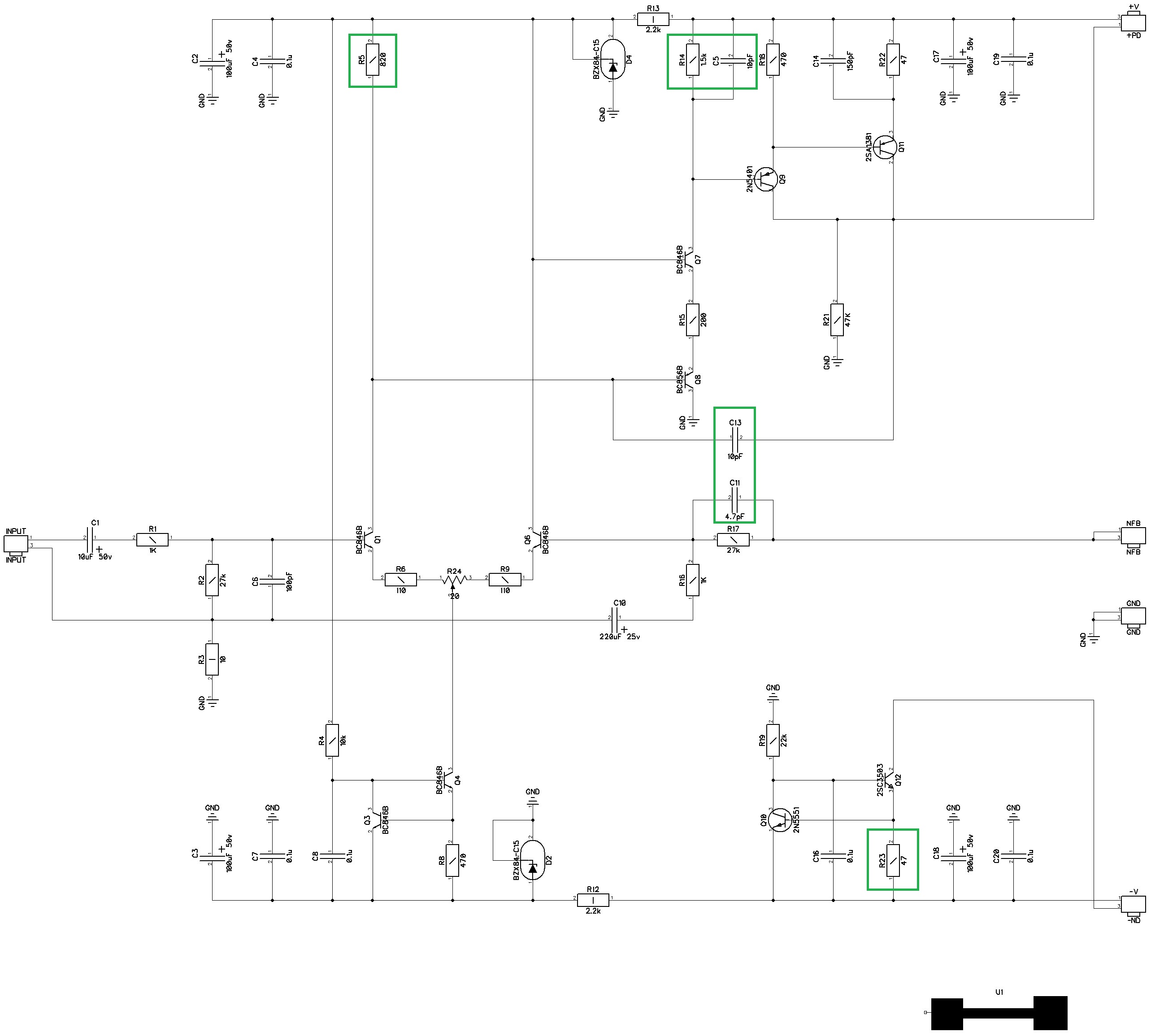

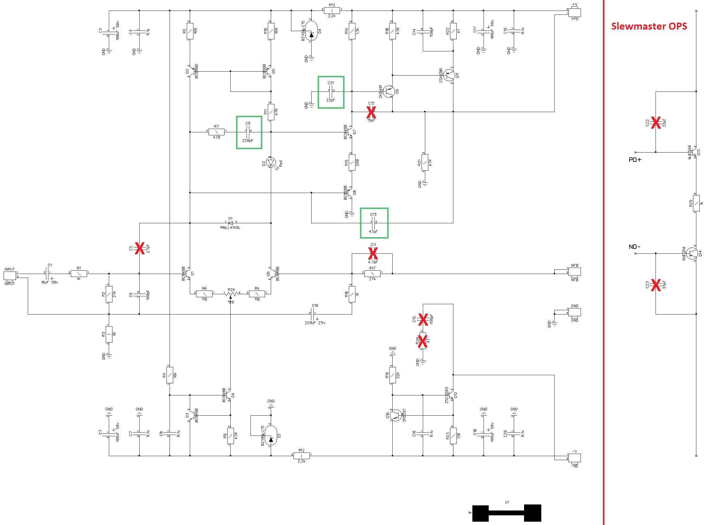

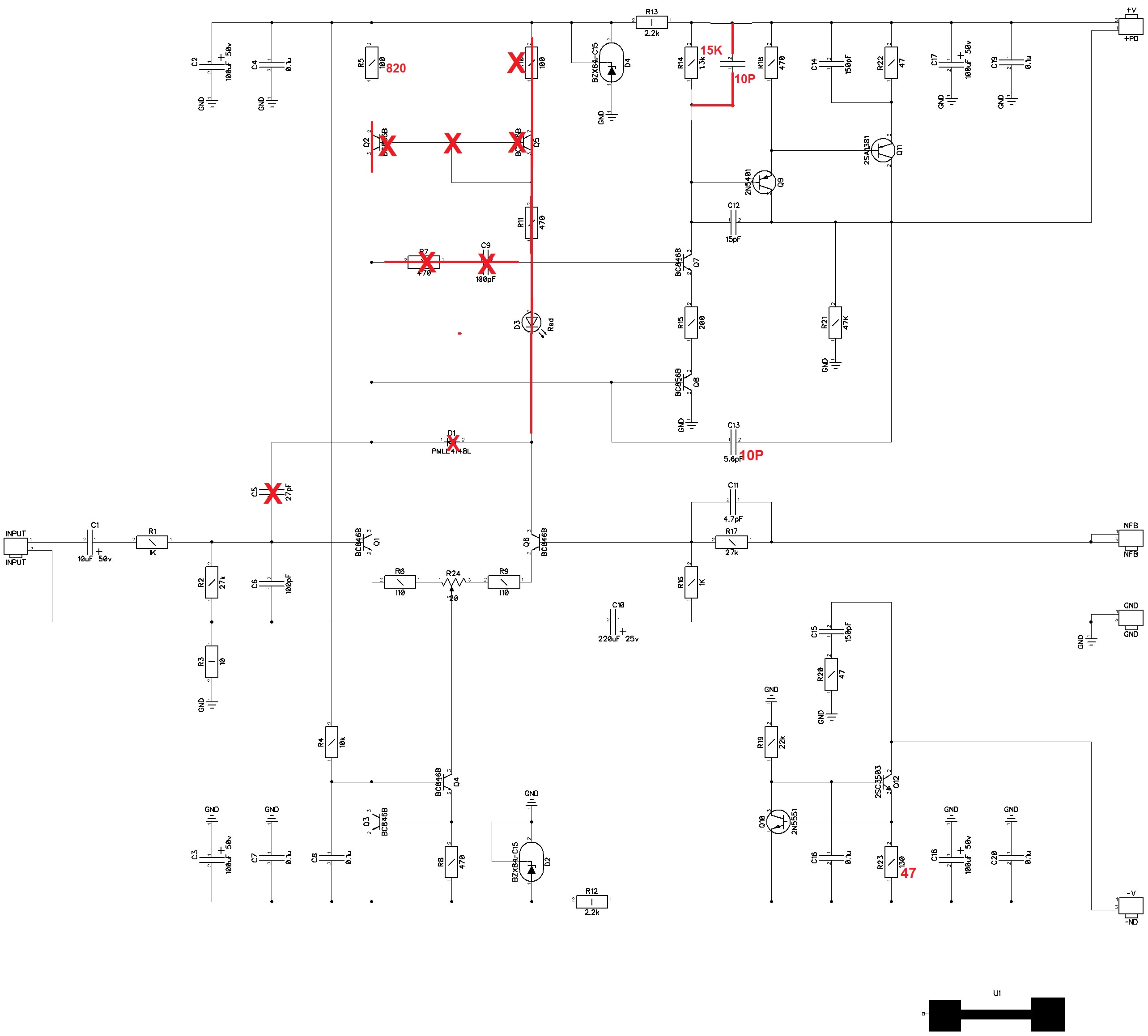

Hi Terry,
I did some modelling particularly with Slewmaster OPS - it noticeably changes the open loop response. So I have come up with certain compensation scheme re-design (removing, changing and adding some caps) - see attached. It is actually simpler, but providing more control over the system.
The ones that are changed, as well as the one that is added (C21), are marked by the green boxes. The ones removed - by the red X signs.
Please note - it is also recommended to raise the legs of the shunting caps at the input of Slewmaster board - see the right side of the picture.
Please proceed with care (bulb tester, but full rails voltage).
Valery

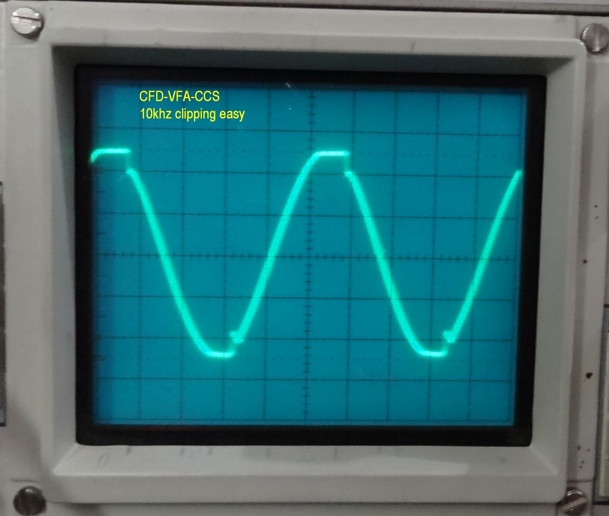

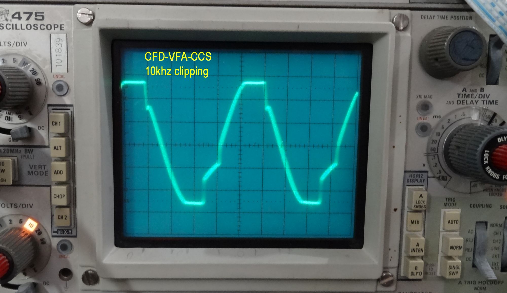

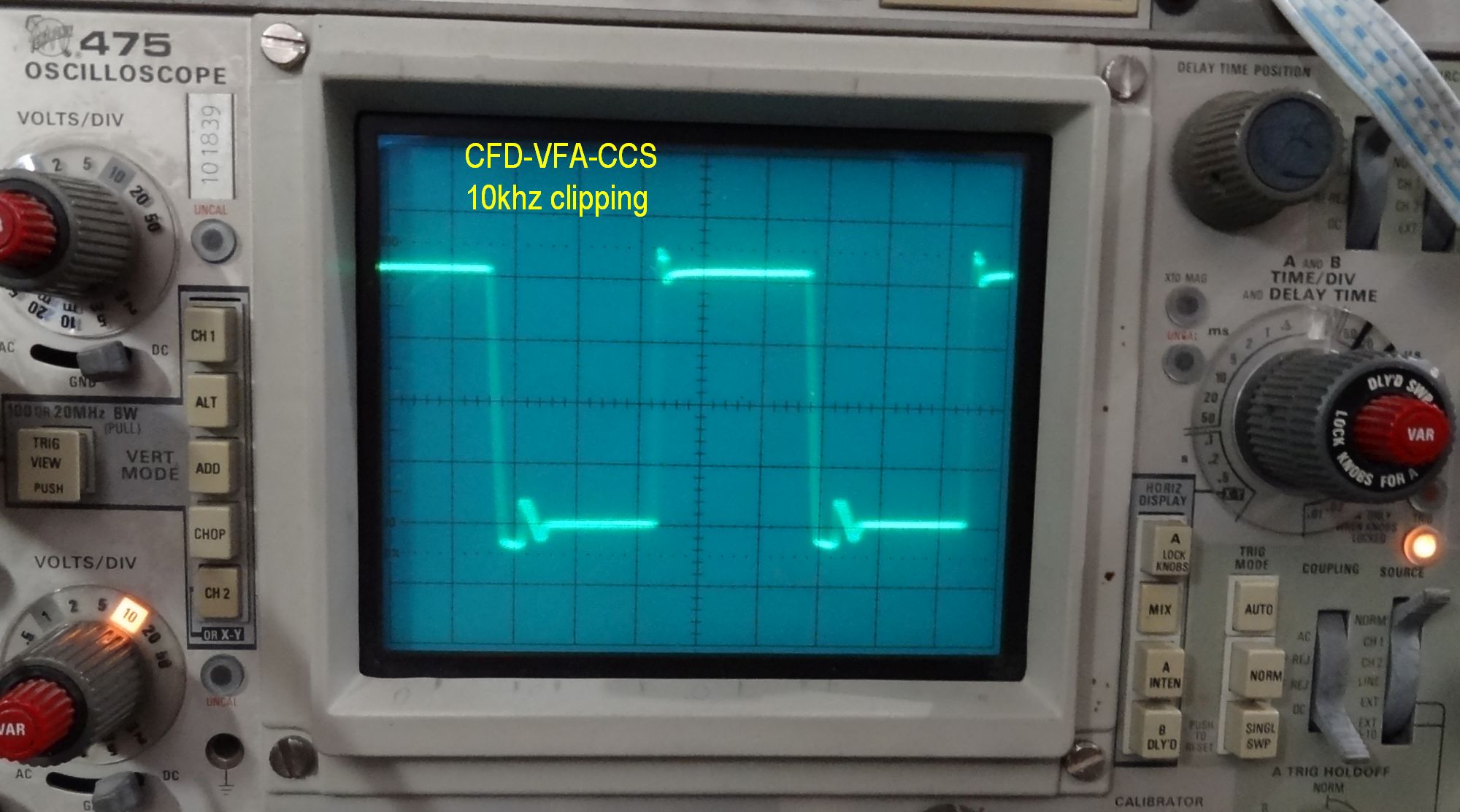

Hi Valery,
I made the changes you suggested and I don't see a lot of change. I am not using the Slewmaster OPS right now, I'm using the Tubsumo OPS. There is no load attached.

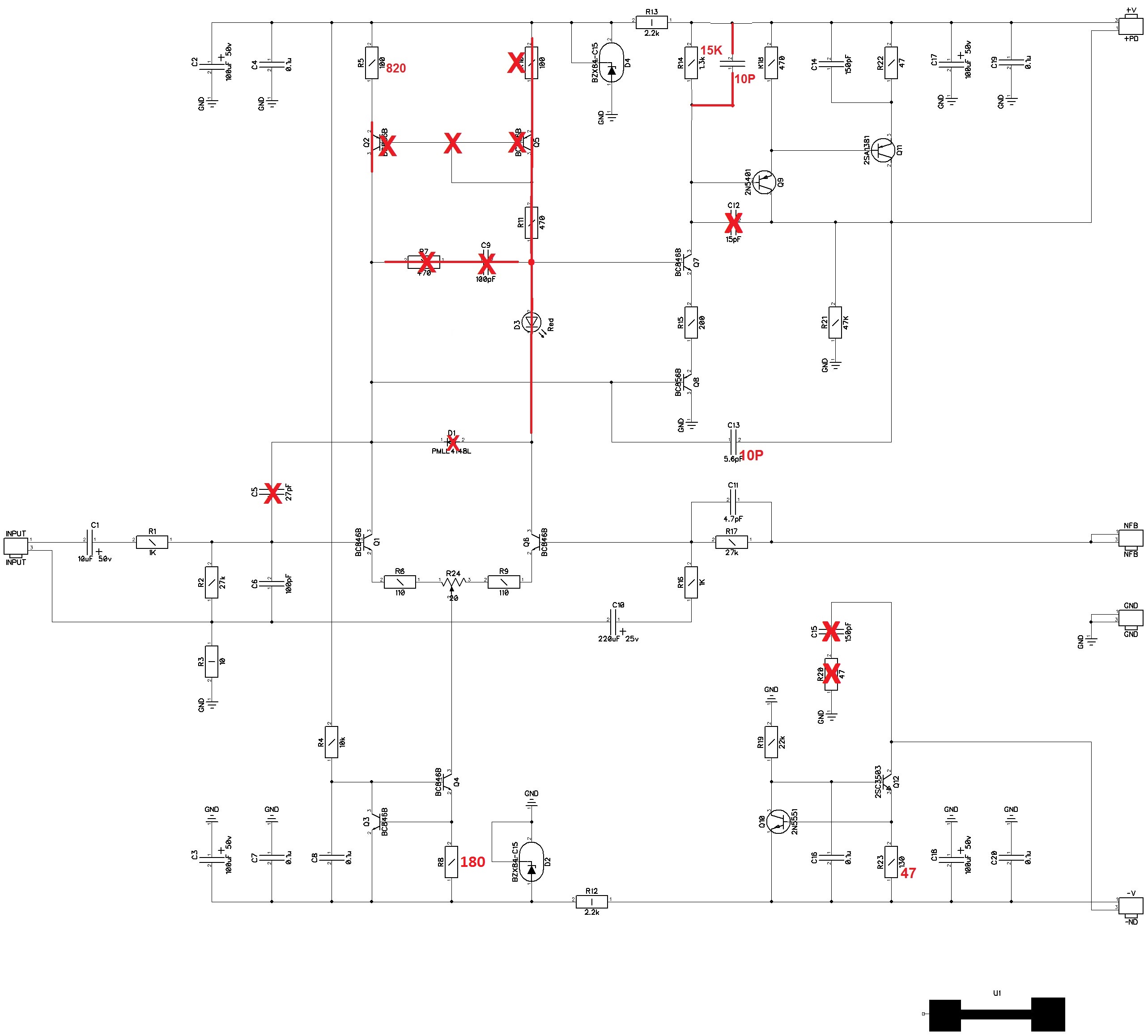

Hi Terry,
Did a lot of in-depth research and modelling. It appears that the cascoded differential circuit does not cooperate with the LTP's current mirror well, so I did significant simplification of that part of IPS.
Sorry for all this trouble, but you provide a lot of help as I cannot test anything myself at the moment. Good thing - still no trace cutting required 🙂
Attached schematic - what the circuit should look like now. Some parts are removed and jumpered. Can you try this variant with TubSuMo OPS please.
Please note - for TubSuMo, higher VAS current is recommended - 15mA, so R23 = 47R for that purpose. TO-126's will run a bit warmer.
Let me know if more explanation is needed.
Valery

Attached is a revised schematic as I see it. Let me know if I missed anything.
Thanks, Terry
Couple of other things - C12, C15, R20 are not required as well.
Also, R8 should be 180R - my mistake (copy/paste again!), it was not too significant when the mirror was there, but now it's much more important for LTP balance.
Valery

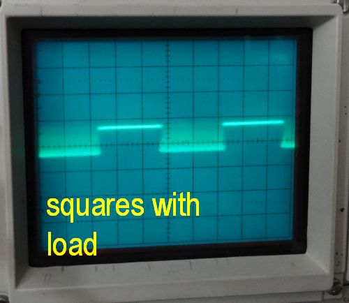

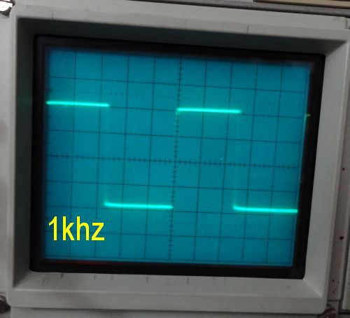

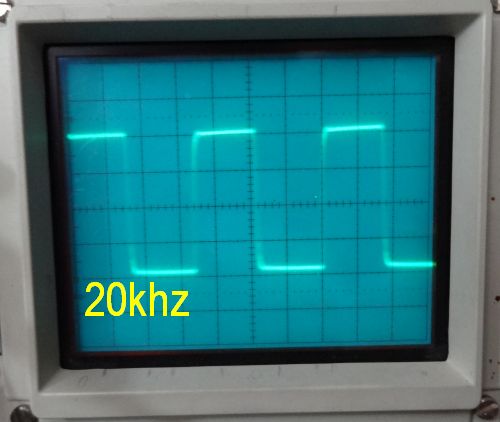

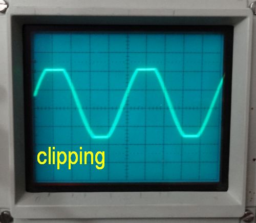

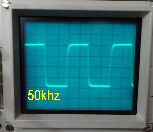

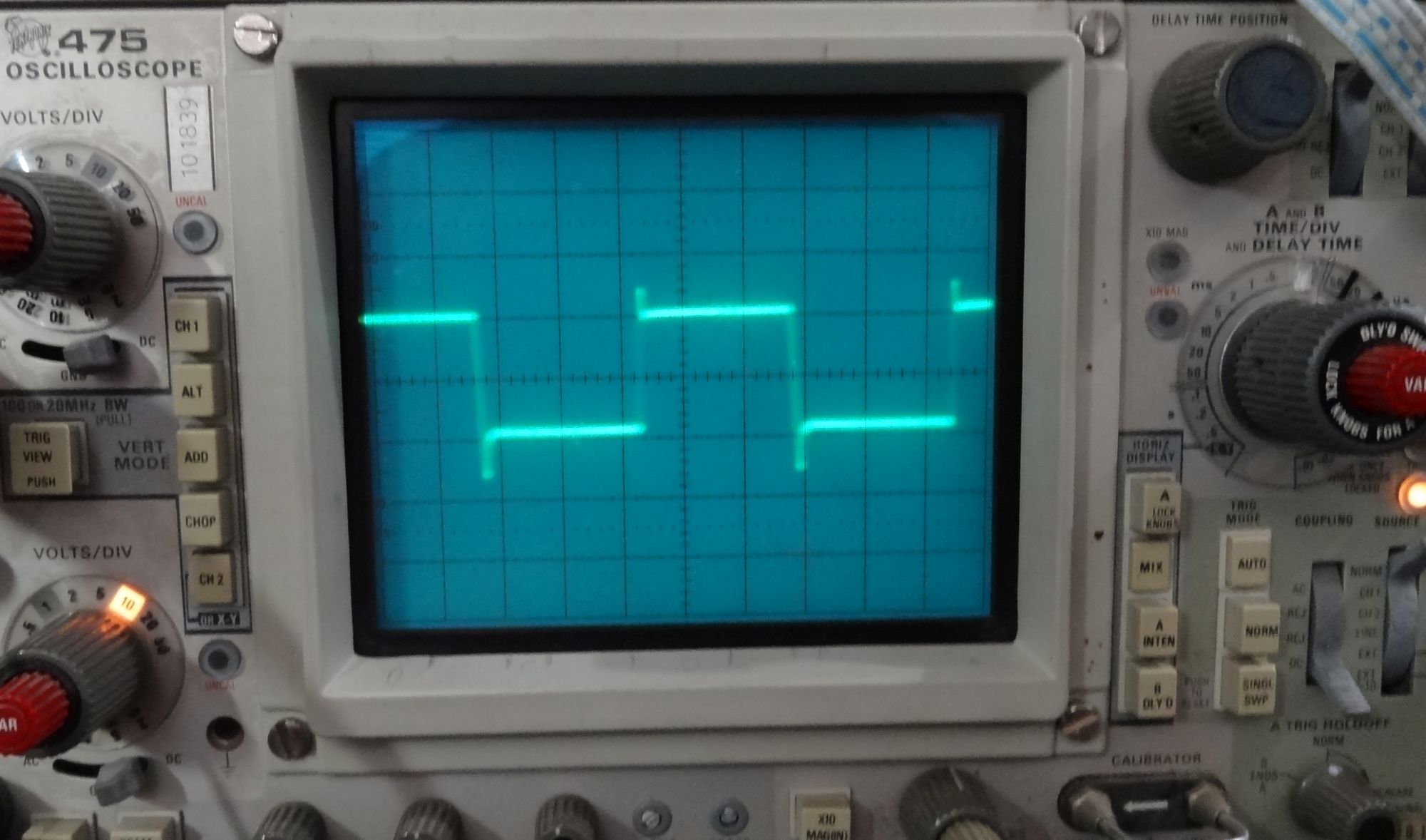

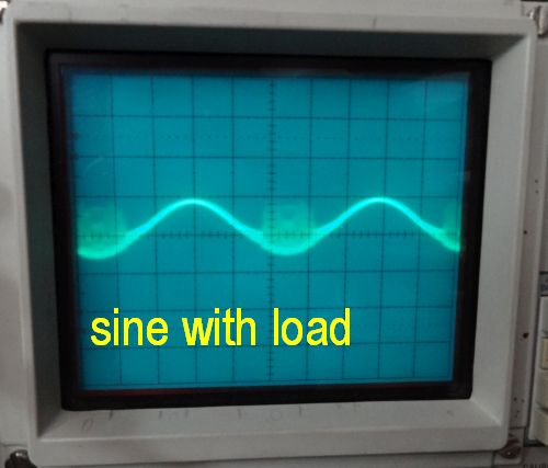

OK I made the changes and tested. With no load it looks great. However, add a load and it stops playing nice instantly. One more thing of note. With no load it clips with less than 1V input. Here are some scope shots. All the square wave shots are with 10vac output.
Hi Terry,
Much better! Looks like a local oscillation in the OPS (negative shoulder). Does the amplitude decrease with the load? This would be strange, as 8R load should not decrease the amplitude that much.
Can we try to put R7, C9 (470R, 100pF) back in place - then test - and after that R20, C15 (47R, 150pF) back in place - and then test.
It will make the loop response close to ideal.
If the oscillation is still there - please try to increase R23 - like 68R, then 100R - re-biasing each time.
Many thanks,
Valery

Hi Terry,
Many thanks,
Valery

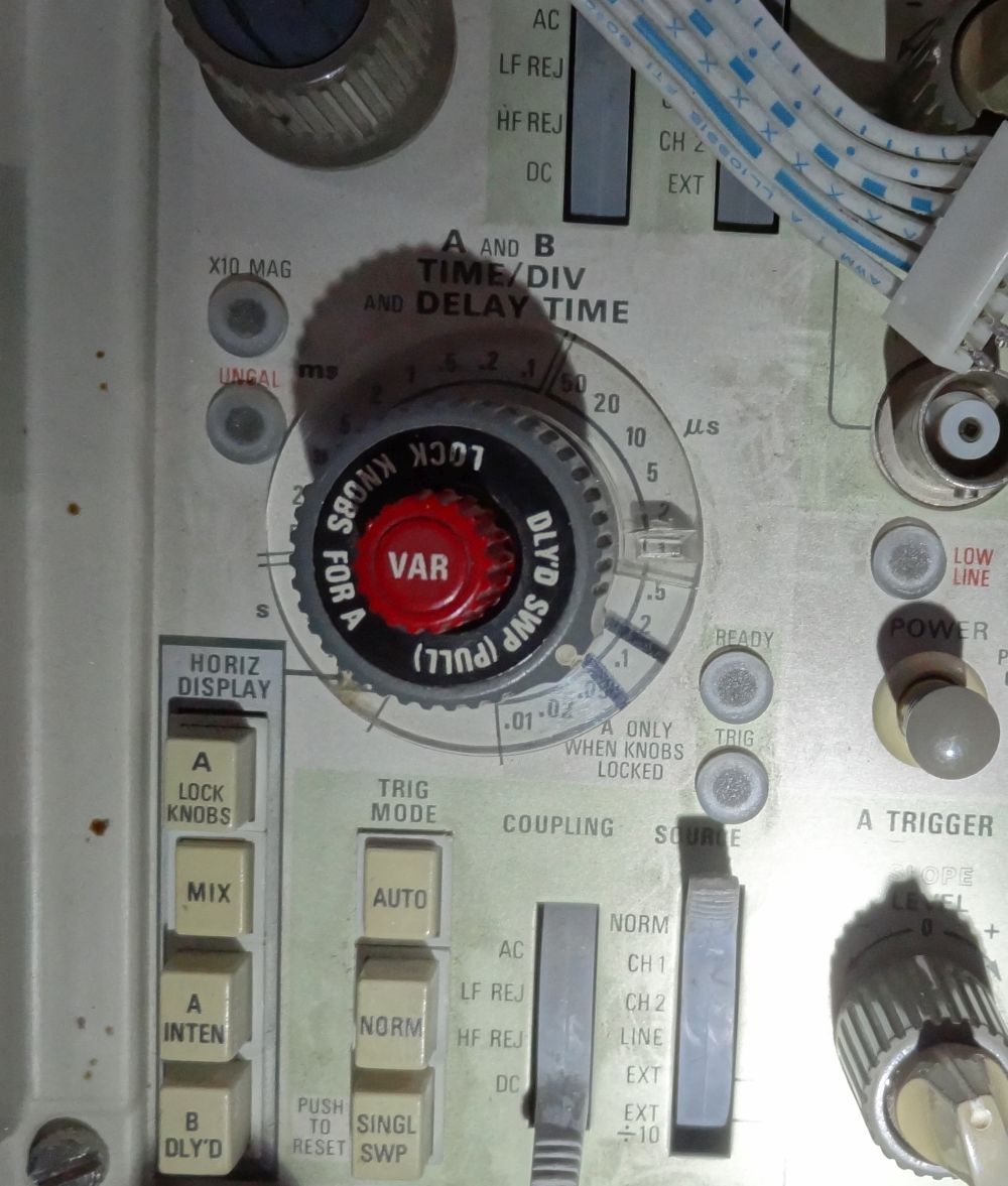

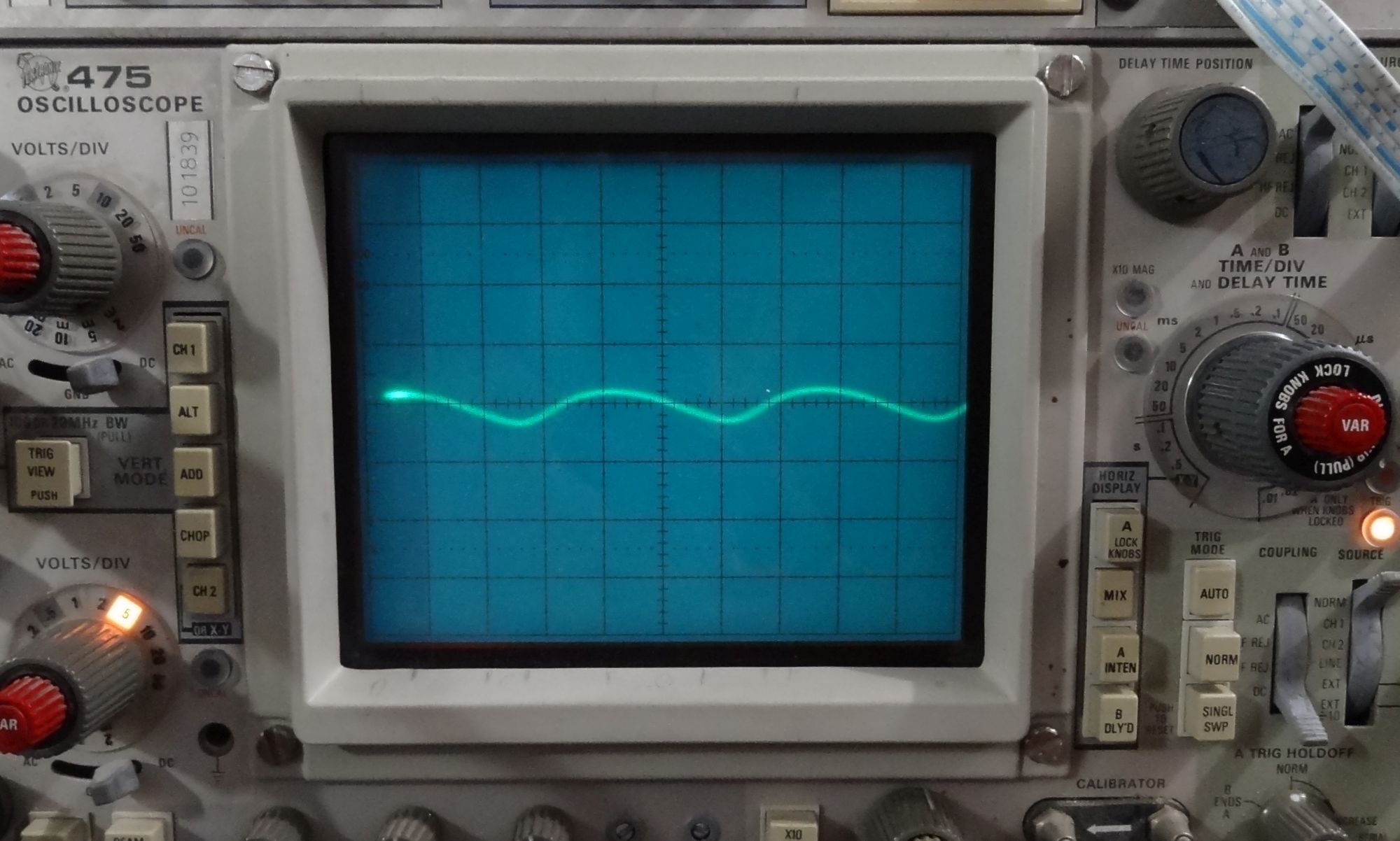

I hooked up the Mini Slew. I set it to 76mA per rail, (the lowest it will go. I see some type of signal with the input shorted and no load. If I play a square wave through it I see a thick line on both positive and negative shoulders but of course I see a thick line with no signal. Adding a load doesn't seem to change much but raises the bias to about 80mA. I'm attaching scope shots of what I see with the input shorted. I had to increase the TIME/DIV. I am including a shot of that too as I don't know how to use that feature other than turn the knob. 😉
The input is shorted. This is not there with another IPS. I just hooked up the CFA-XH IPS and it looks perfect. That ripple is coming from this IPS.
Terry, thanks a lot - very useful. It slightly oscillates - not violently, but it's there.
I will think a little bit. The thing looks very promising, but requires particularly careful compensation.
It it 0.1uS setting? The value between the black marks?
Then it oscillates at around 2.85MHz...
