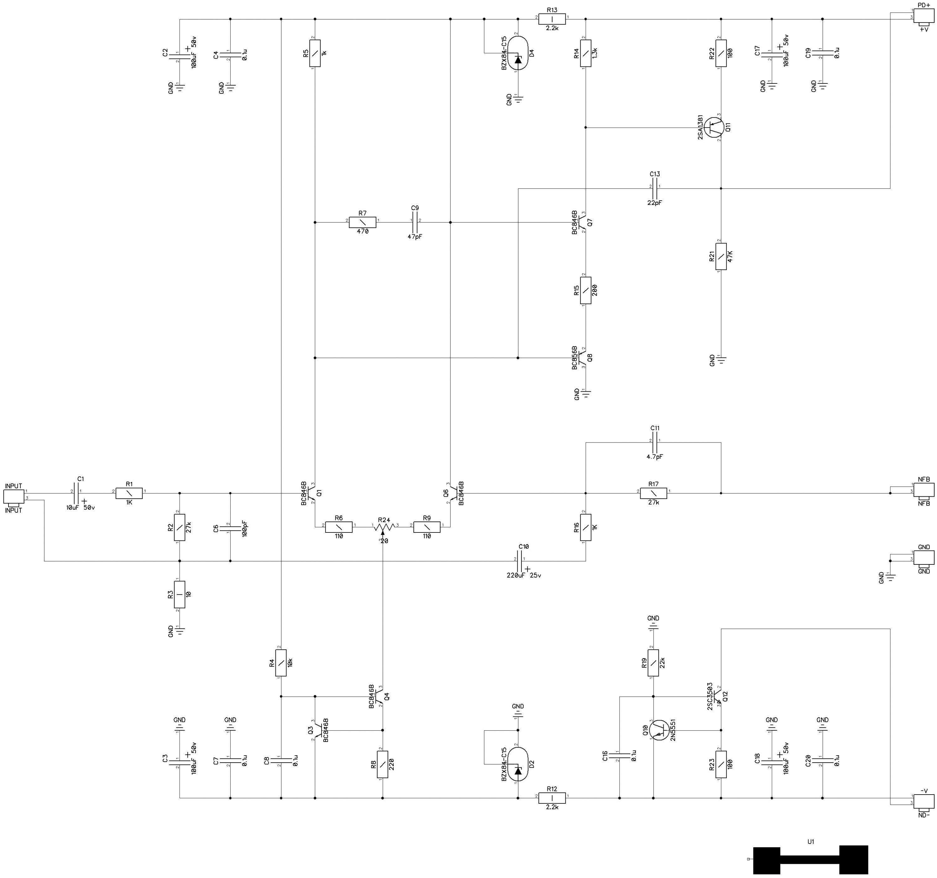

Hi Terry,
In fact, the variant you've got now (with C13 installed) is excellent - I've checked it in a number of simulations.
Can you please try C11, say, 1pf - if you've got the value that small - leaving all the rest just as is?
If it runs well, you can try to reduce C13 from 22p to 15p. This is going to give the sharpest corners.
Then we select the best option for compensation caps.
As a final touch, you can change the resistors for the best balance of the circuit:
R22 = R23 = 100
R8 = 220
So I'm clear. I don't make the other changes from post #111? Leave C13 in and C12 out?
The smallest cap I have is 2p.

So to be clear, C12 is out and C13 is in? I will try reducing C13 to 15P and see if that changes anything. I will also reduce R22=R23=100R and see if I can use 220R for R8 and see if I can get rid of the piggy backed resistor.
Blessings, Terry
Edit; I forgot to ask. Did you notice that the negative shoulder is weaker that the positive?
Also, your last schematic you added C5 back in. I don't have that. Do you want that there?
Blessings, Terry
Right, C12 out, C13 in, as it is now (so, its left side goes to the base of Q8). Test with 15p will be interesting. In overall, reasonable range for it is 15p - 33p. Less C - "sharper" response, more C - "milder" one.
C5 - no, not required any more.
Weaker negative shoulder - looks like a bit of an offset.
R22=R23=100R and 220R for R8 should give a good overall balance.

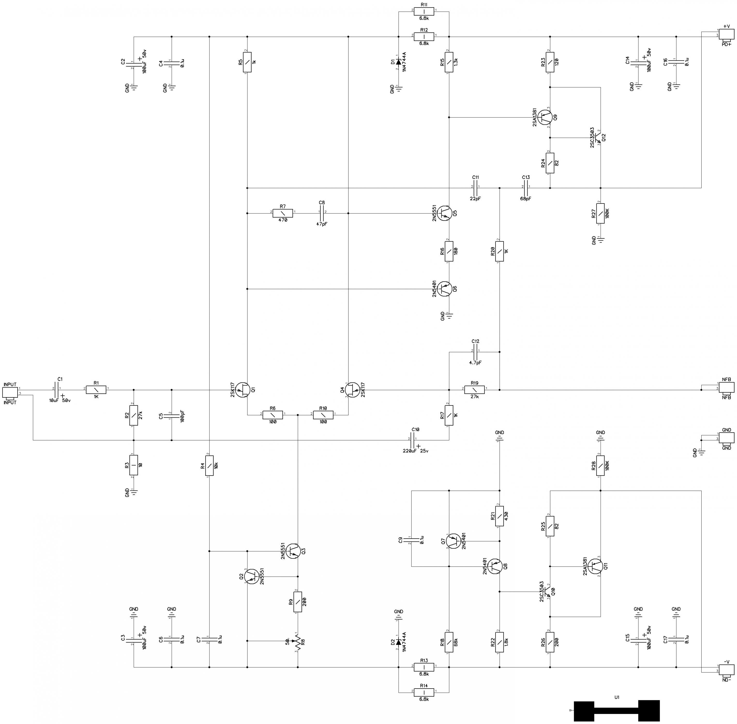

Tested design
Hello All,
I'm kind of... back 😛
Attached is the final schematic of this particular design, aligned with the tests, performed by Terry.
Slight miscommunication during those testing sessions have revealed a great compensation approach, that I have studied deeper and am using it in a number of successive designs now 😎
However - more good things are coming 😉
Valery

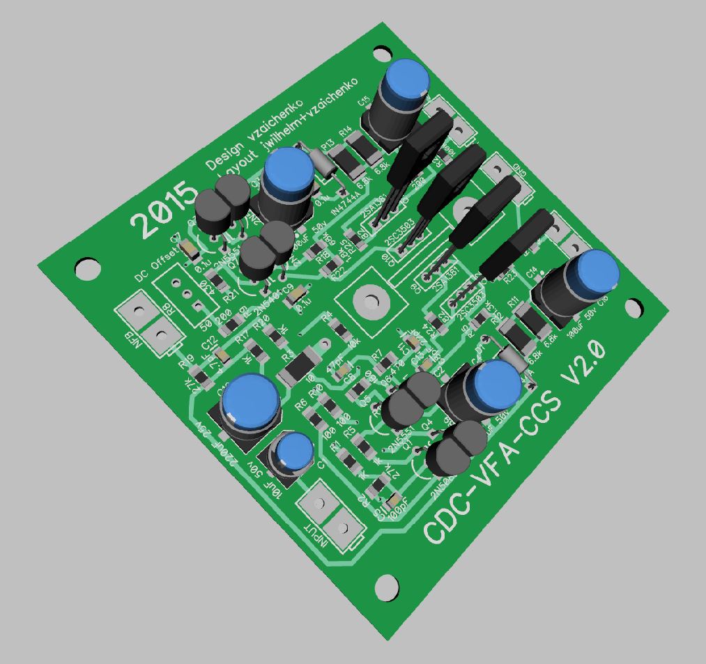

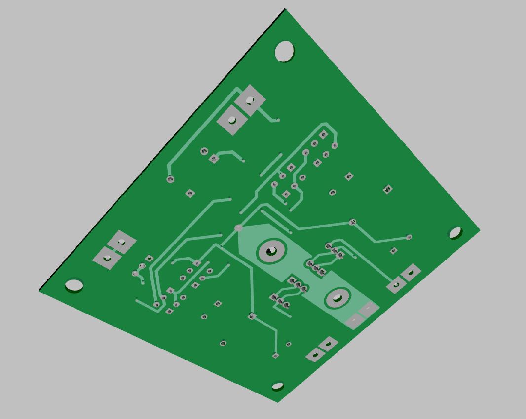

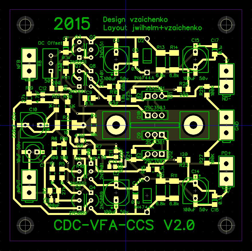

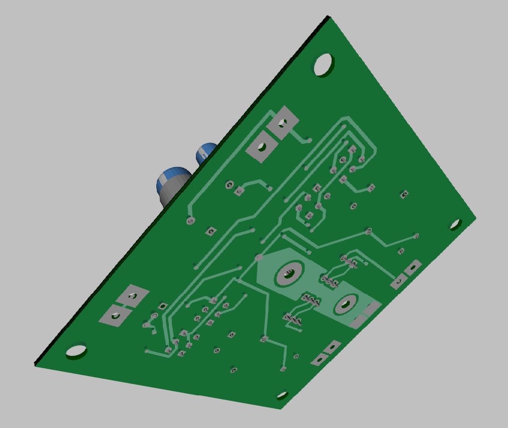

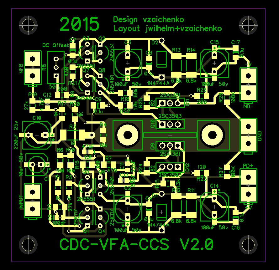

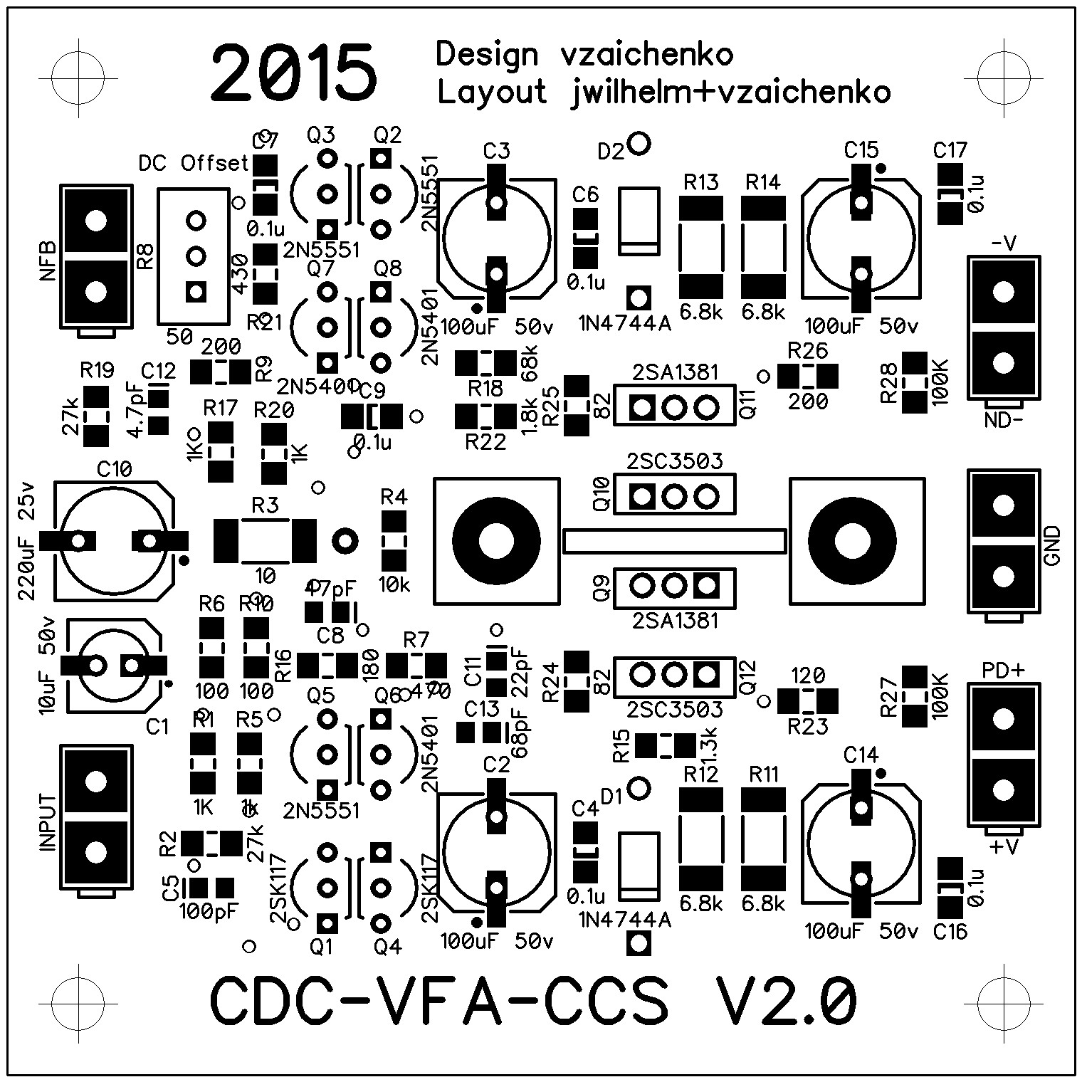

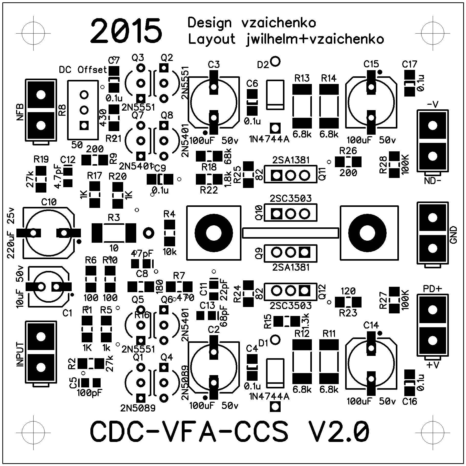

Here comes CDC-VFA-CCS V2
Preserving all the benefits of the 1-st version, here goes a refined version. Even less distortion, even more speed and versatility.
I will test this one myself - PCBs are coming tomorrow. Layout is half-SMD - all the active devices are TH, electrolytics are either SMD or TH.
Jeff, I took one of your layouts as a basis - helped a lot! 😉 Your overall parts placement is excellent.
This one can be easily used with wide range of OPS modules. I have simulated 3 options - for BJTs (EF3), IRFPs (with one EF) and Lateral FETs (direct drive) as the output devices. Slightly different VAS currents and compensation values are recommended.
This is almost a CFA-fast VFA 😉
Test results and measurements will follow soon.
Valery

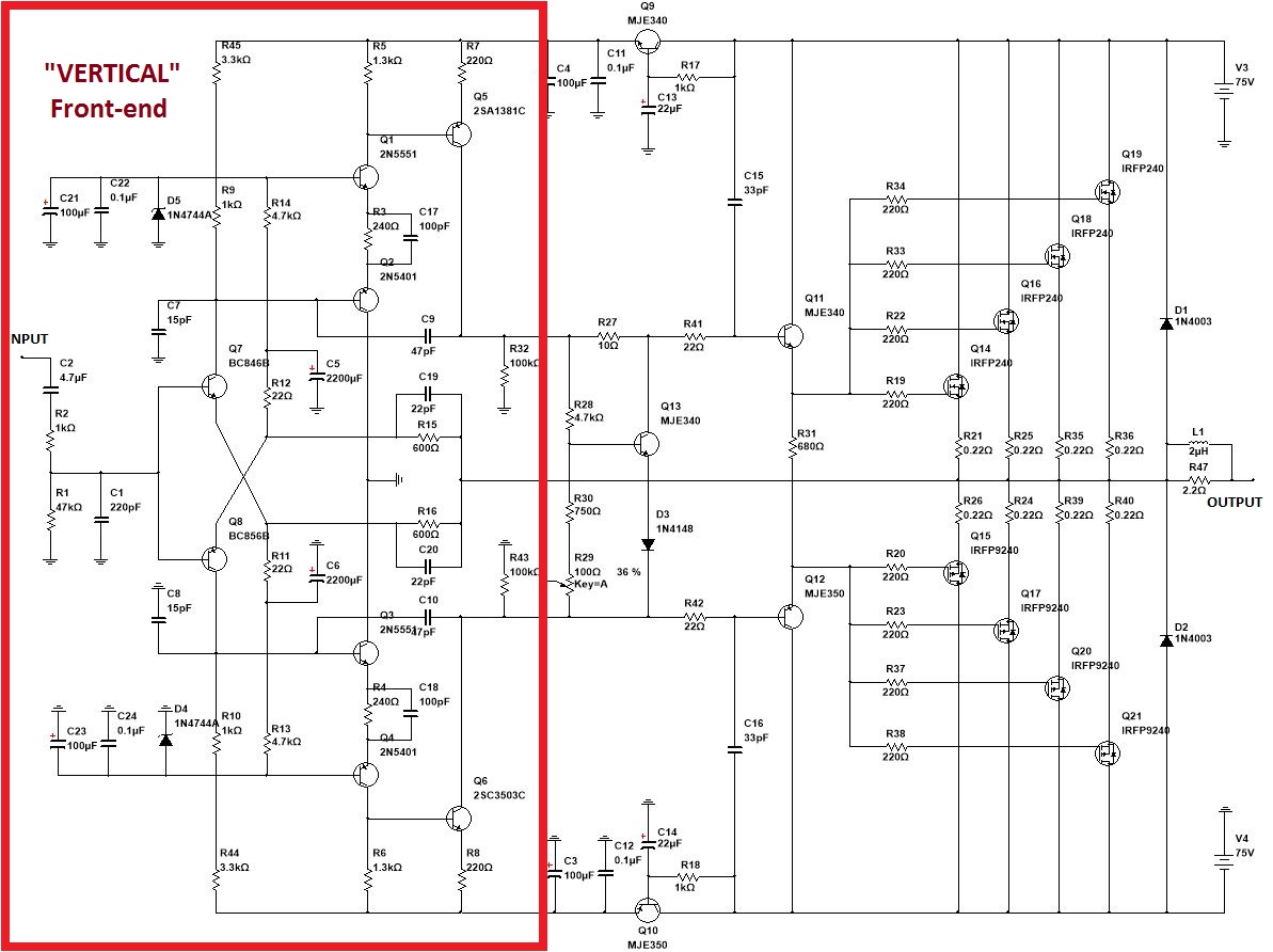

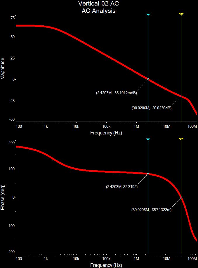

VERTICAL front-end - back to the future!
And then I thought... why don't I try this great complementary (vertical) differential topology in a symmetric CFA front-end. I took my earlier CF-FET schematic as a basis and - voila!
Here comes the VERTICAL.
Key benefits:
1) Very high open loop linearity. No GNFB THD = 0.07% @ 20KHz, 20V RMS output (around 50W @ 8 Ohm). With the loop closed, the tallest harmonics (2, then 3) are close to -100db. Well - these are simulated values, but comparing to the other simulations - built ones - this is very good.
2) Rather high slew rate. Really difficult to say exactly at the moment, but it's high for sure. I will measure it at the live prototype later on.
3) Scalability - easy to have the output swing of the scale you want. Key regimes are independent from the rails voltage, having the input stage always supplied with +/-15V, so wide range of good low-noise low-voltage transistors can be used. With +/-75V rails, it's easily swings for having 250-280W of high-quality power @ 8 Ohm.
4) Versatility - easy to adapt to the wide range of the output stages of different topologies with different output devices, etc.
5) Simplicity. Initial CF-FET had 6 active devices, this one has got 8 - which is also not that bad.
It requires DC servo (not shown on the schematic here).
Working on the layout... coming soon 😉 It will be the same 3"x3" inch size, as the previous ones in this series.
The front-end is marked by the red frame.
AC analysis is simulated for the whole amp - this time in combination with IRFP-based OPS.
Valery

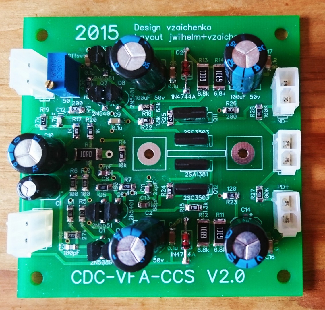

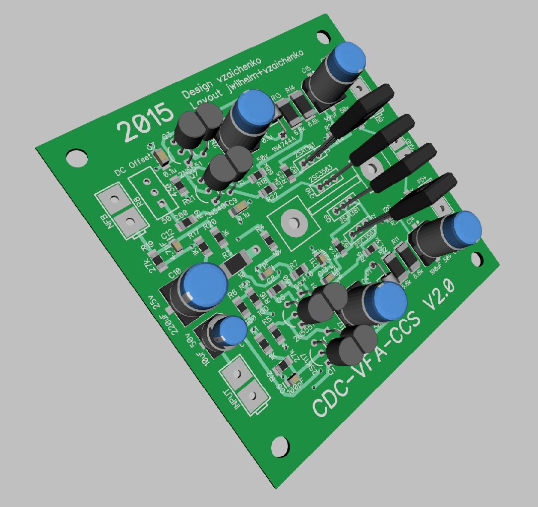

CDC-VFA-CCS V2.0 - built and tested standalone
Hello All,
My lab is roughly 30% back to life, so I have assembled and tested the latest version of CDC-VFA-CCS front-end.
Here is the schematic and PCB images "as built".
This one has got jFETs at the input. It's possible to use some low-noise BJTs as well - I will test that option later on.
Next post will present the measurement results.
Valery
