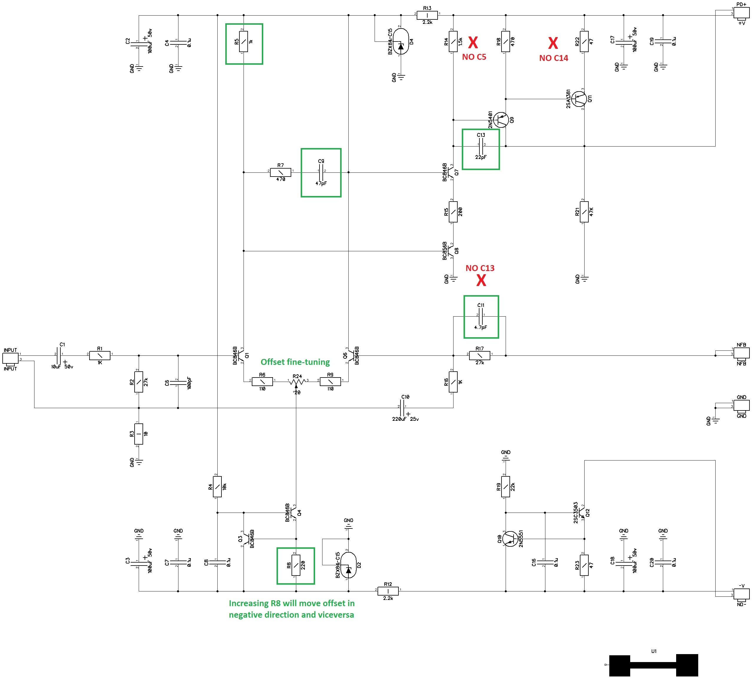

Terry, can you please try this variant. The simplest and the cleanest one. Simulated AC analysis looks great. I still keep it rather fast. I there will be still some oscillation, we will just slow it down significantly with higher cap values next time.
So, we remove all the small caps, leaving in place only C9, C11 and C13 (see the values).
We also amend R5 and R8. Now, if you will not be able to zero-out the offset, just slightly change R8 (one step, like from 220 to 240). Higher value will move the offset in negative direction. And then just fine-tune with the trimmer.
R23 - for TubSuMo = 47, for Slew = 130.

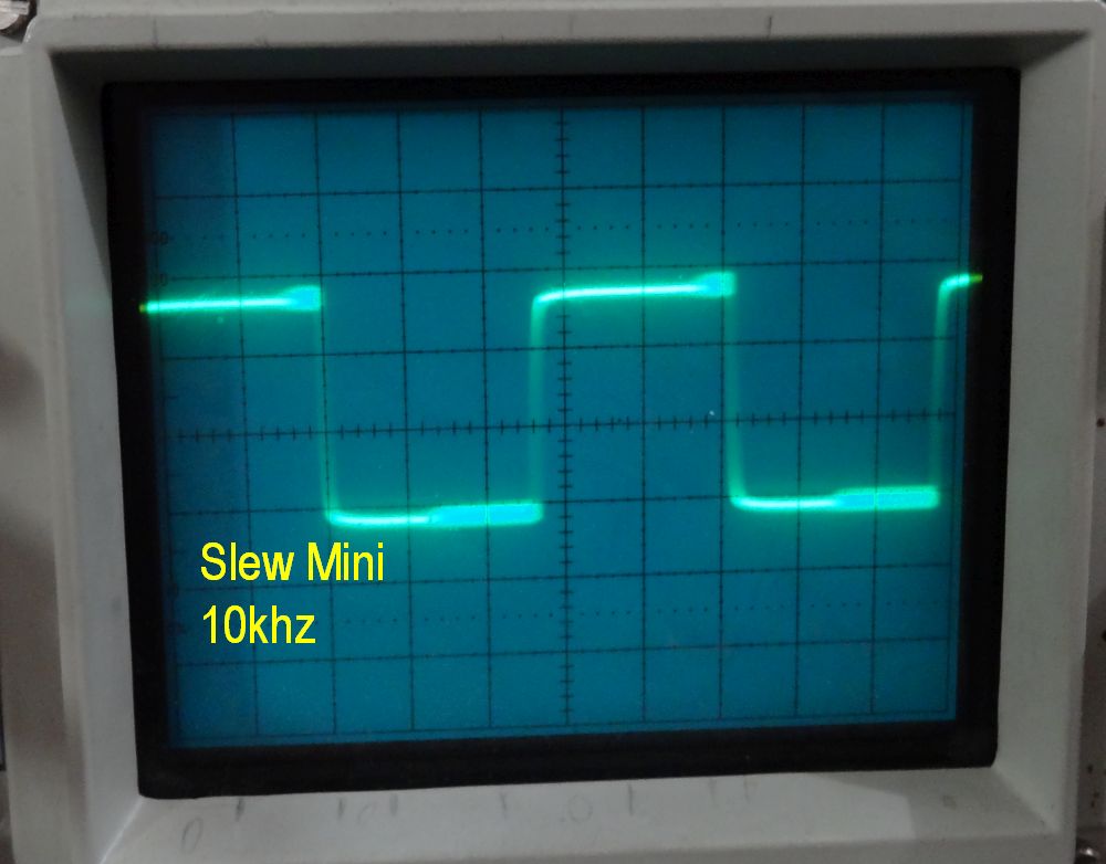

OK it looks like you also left in C6 so I did too. It is better. The oscillation with the input shorted is gone. It still oscillates some with the load attached but is better. Pics attached.
One thing of note. It oscillates at all frequencies with a square wave, but with a sine wave I can see oscillation at 1khz but not at 10khz. The oscillation begins at about 6vac output. No oscillation visible without a load attached.

Many thanks Terry! C6 - you're right, should be there. I'll check a couple of other things and come back.
Silly me, I read them as shadows.............It it 0.1uS setting? The value between the black marks?
Then it oscillates at around 2.85MHz...

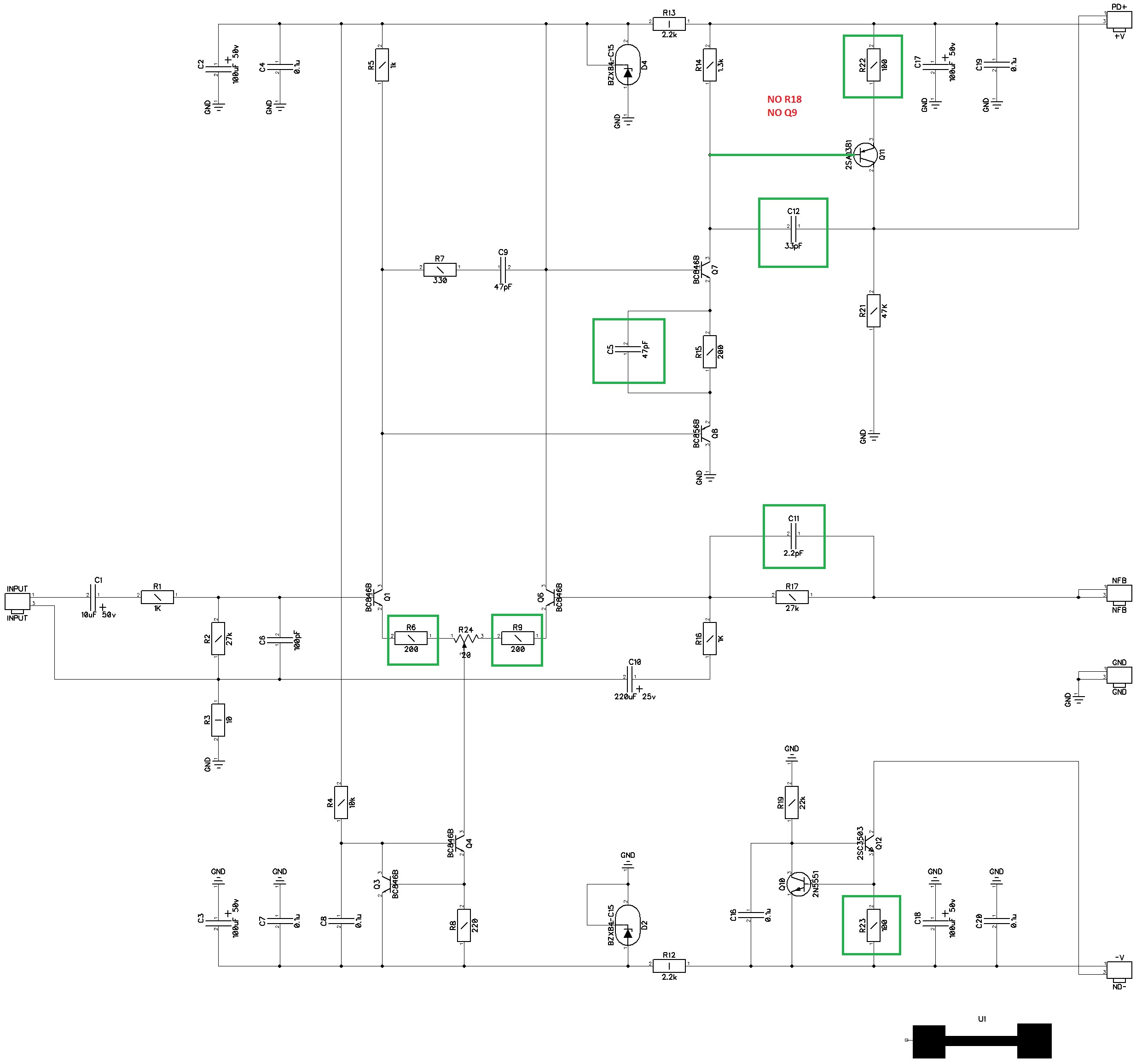

Hi Terry,

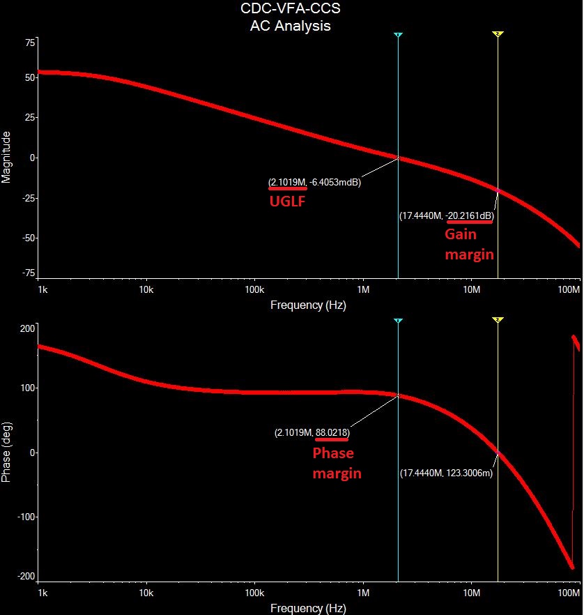

Looks like too much gain in the VAS became a problem. So, I decided to go away from the Darlington pair there. The topology becomes even simpler.
Could you please try this one. Green boxes indicate the parts/values changed.
R18 and Q9 are removed, Q9's b-e is jumpered so that Q11's base goes to Q7's collector.
R22 = R23 = 100 makes it suitable for both Slewmaster and Tubsumo at 7mA VAS current.

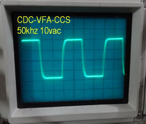

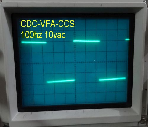

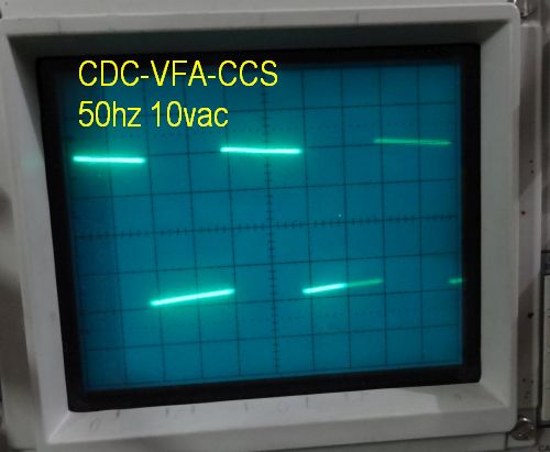

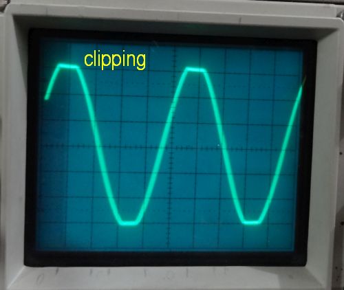

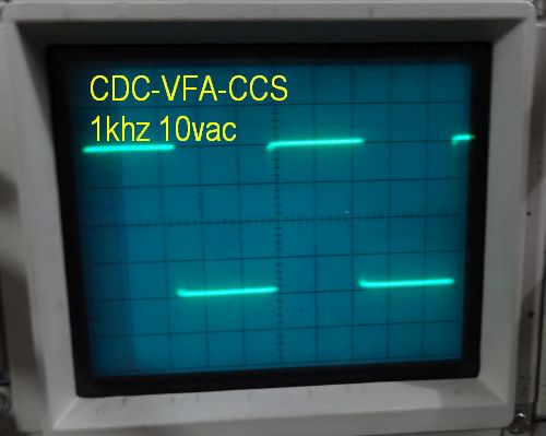

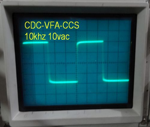

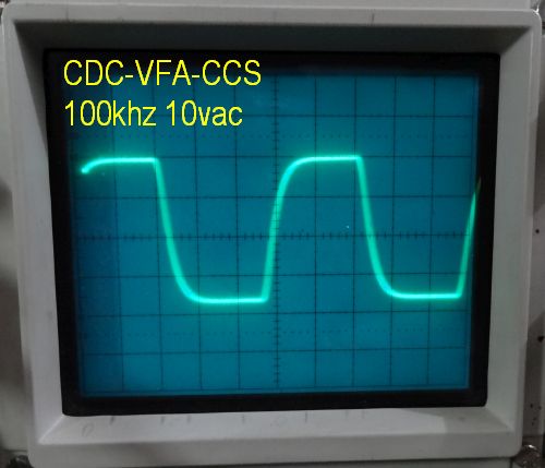

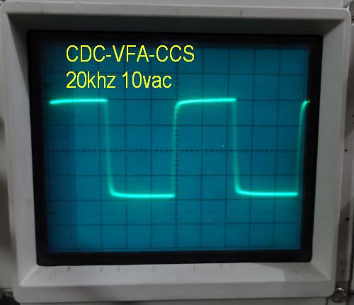

Hi Valery,
That seems to have done the trick. No more issues with a load attached. I am attaching some scope shots. This has really good bass response. This is tested with the Slew mini latet OPS.
R8=220r gives about 0 offset with the trimmer full throw. The next step I had was 270r with was too much so I had to parallel a 2k2 then I was able to zero the offset. I had 180r in there due to modification in post #92.
Blessings, Terry
Blessings, Terry

Bingo! 🙂
Terry - thanks a lot! Now it looks really good. It may be fine-tuned for even sharper sq wave response, but even now it looks good.
This is one of the options for CFA-fast VFA. Complementary Differential Circuit really does its job.
I'm very happy with the result now, which could not be achieved without your help for sure
