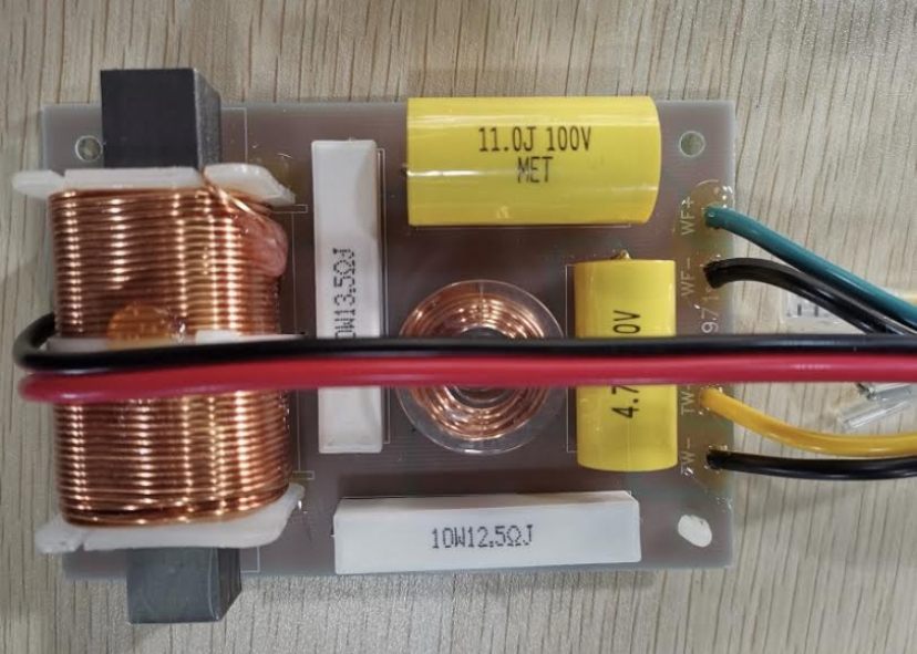

Here you go - you want minimal effort I see. 🙂
Crossover Part Numbers from Parts Express (per speaker)
L4 = 5mH 18ga #275-141 qnty 1
L1 = 0.1mH 20ga #257-568 qnty 1
C2 = 4.7uF MKP #255-020 qnty 1
C3A = 10uF MKP #027-114 qnty 1
C3B = 1uF MKP #027-410 qnty 1
R2A, R4 = 12.5ohm #006-12.5 qnty 2
R2B = 1.0ohm #006-027-101 qnty 1
C3 = C3A+C3B
R2 = R2A+R2B
870177d1598224698-rst28f-dc130a-foamcore-homage-ls3-5a-ls3-5a-homage-dc130a-rst28f-xo-schematic-v02-jpg
It looks something like this:
897666d1606620464-rst28f-dc130a-foamcore-homage-ls3-5a-26d0c267-ce54-441b-8996-eb37c00c69b2-jpeg
Or this if you have exact custom values 🙂
attachment.php
