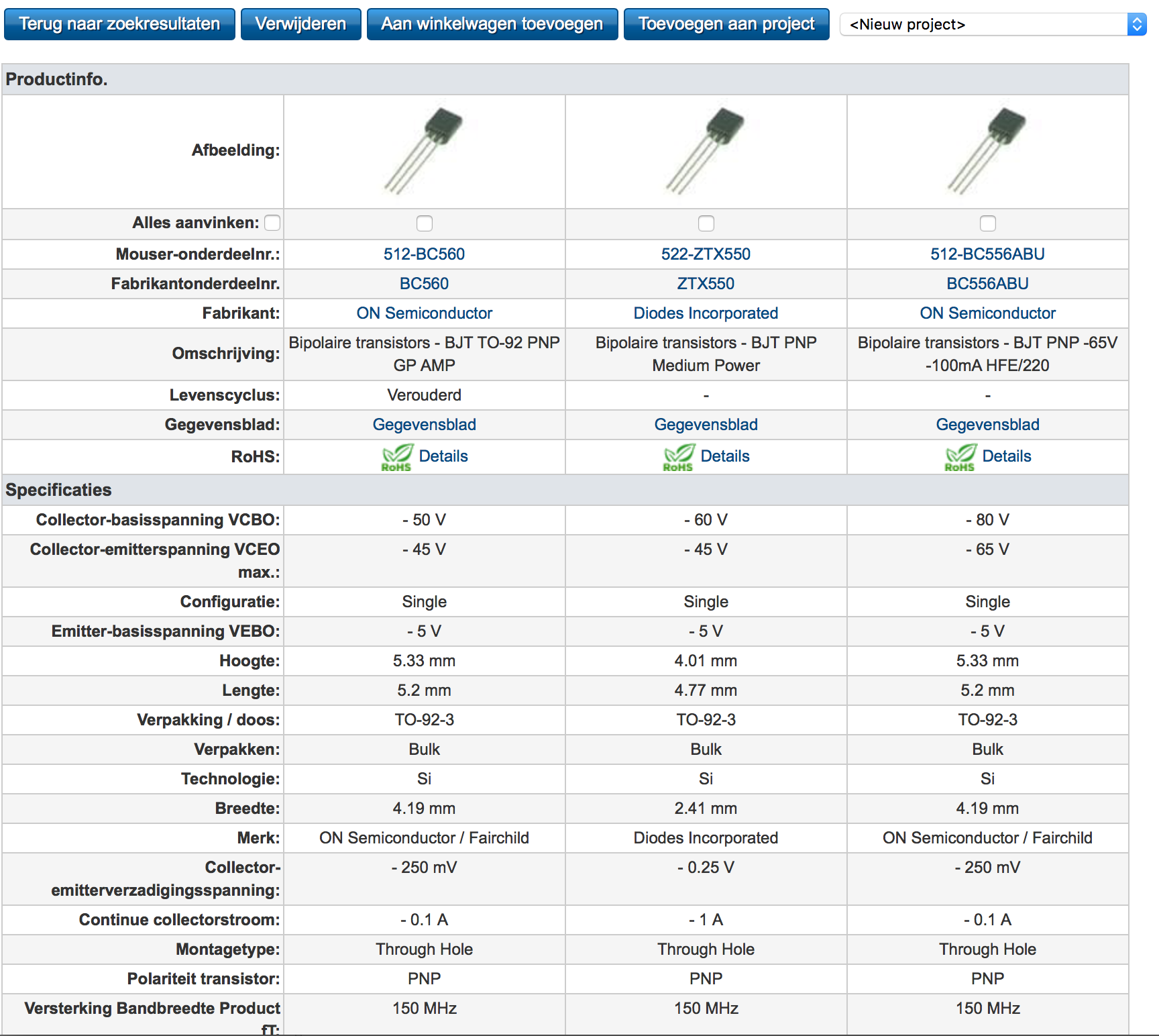

I am building one of your older SSLV1.1 boards, the negative PS.
It has a BC 560 listed but this is not available anymore.
I have found some alternatives on Mouser but am unsure which parameters are most important. Can you advise the best replacement?

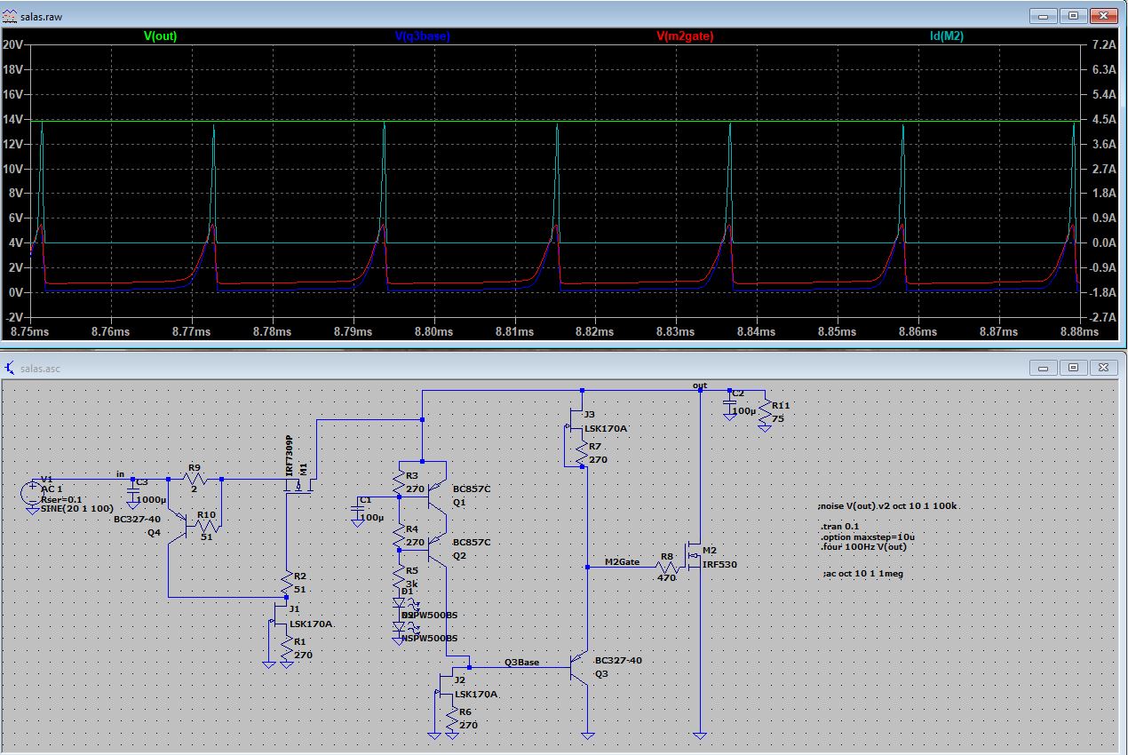

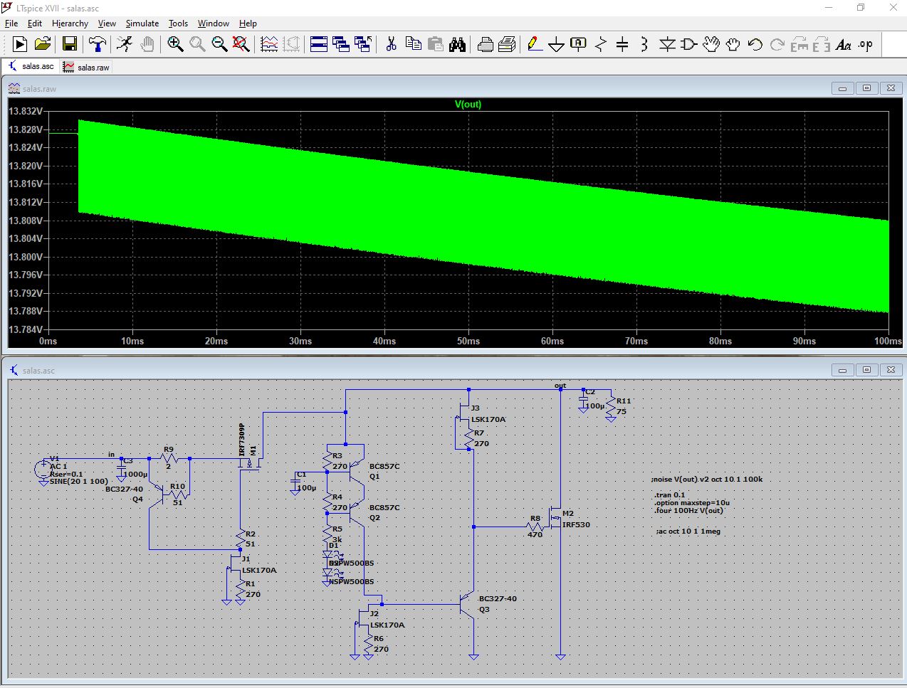

HI Salas,
I would like to build your v1.3 (pos and neg) before that I thought it is a good idea to modell it in LTSpyce. but for me a high frequency oscillation is shown. What am i doing wrong?
Thanks in advance,
Szabolcs

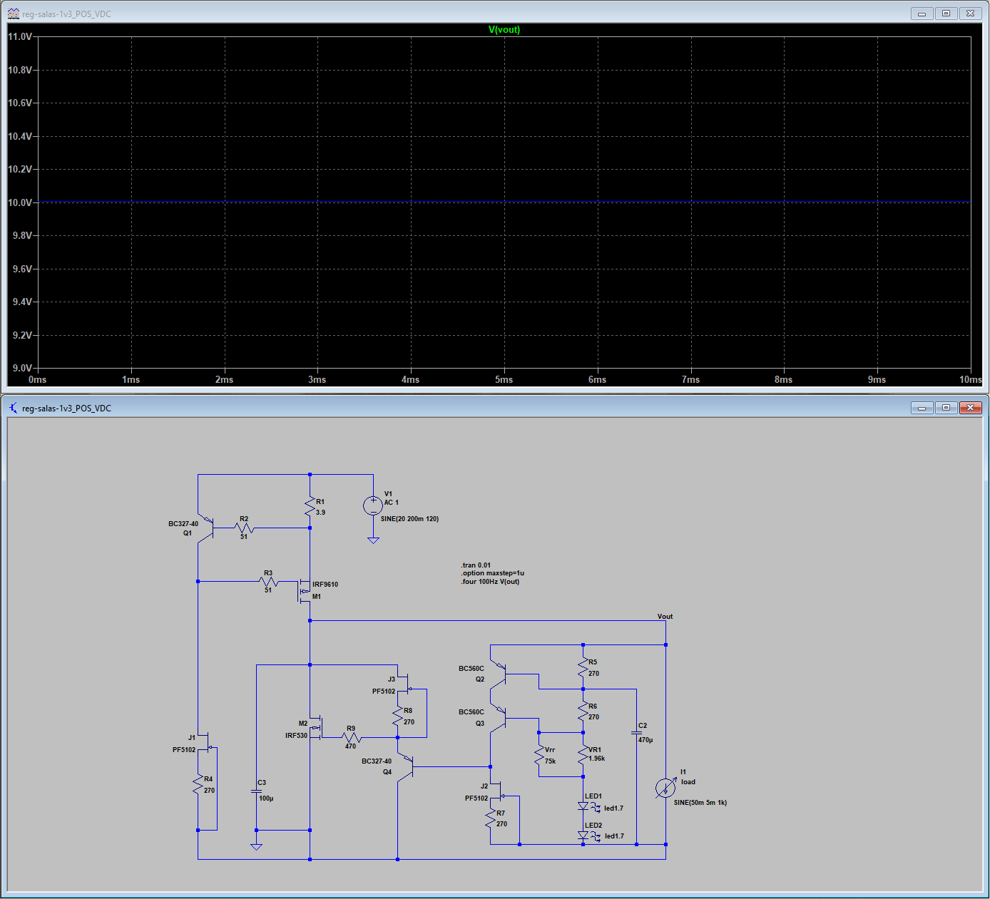

HI Salas,
Thanks in advance,
Szabolcs
I see nothing weird when running similar .tran parameters in my original modeling. Don't know, change M1, JFETs, BC models in your analysis? They don't directly correspond to BOM many of those you used. Put some ESR and ESL in your electrolytics modeling also.
Salas, in your experience, is what he is showing - 20 mV at around 4400 Hz - going to cause a noise issue? I was looking at using this regulator with a B1 Korg so it would go through another set of filter caps too.

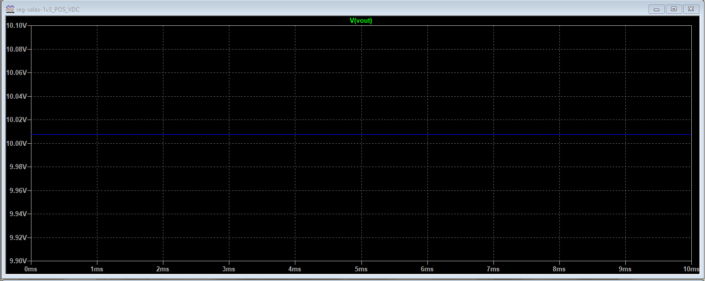

Yes the ESR was the solution. If I put e.g. 0.1ohm to the output CAP than immediately it is OK.I see nothing weird when running similar .tran parameters in my original modeling. Don't know, change M1, JFETs, BC models in your analysis? They don't directly correspond to BOM many of those you used. Put some ESR and ESL in your electrolytics modeling also.

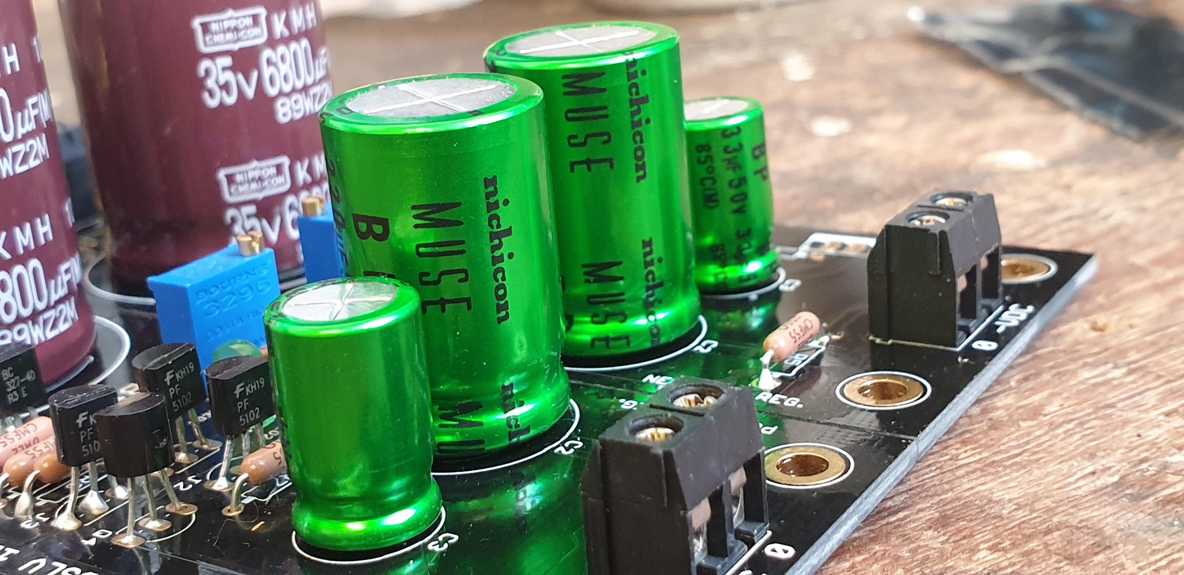

I read in another thread about Muse ES BP caps actually having a better orientation. I did notice the longer lead and the lettering on the label being aligned.
Did I put these in how one would deem the best way? I learned of this after soldering them in!
That's not a purely technically explained orientation preference but a subjective recommendation that I haven't explored. These non polar capacitors are most possibly made by the same assembly machines that produce vastly bigger quantities of polar capacitor types, and that's why they retain a standard legs length difference I would think. A difference that of course serves no essential electrical polarity notice anymore in a bipolar type like the Muse ES.
