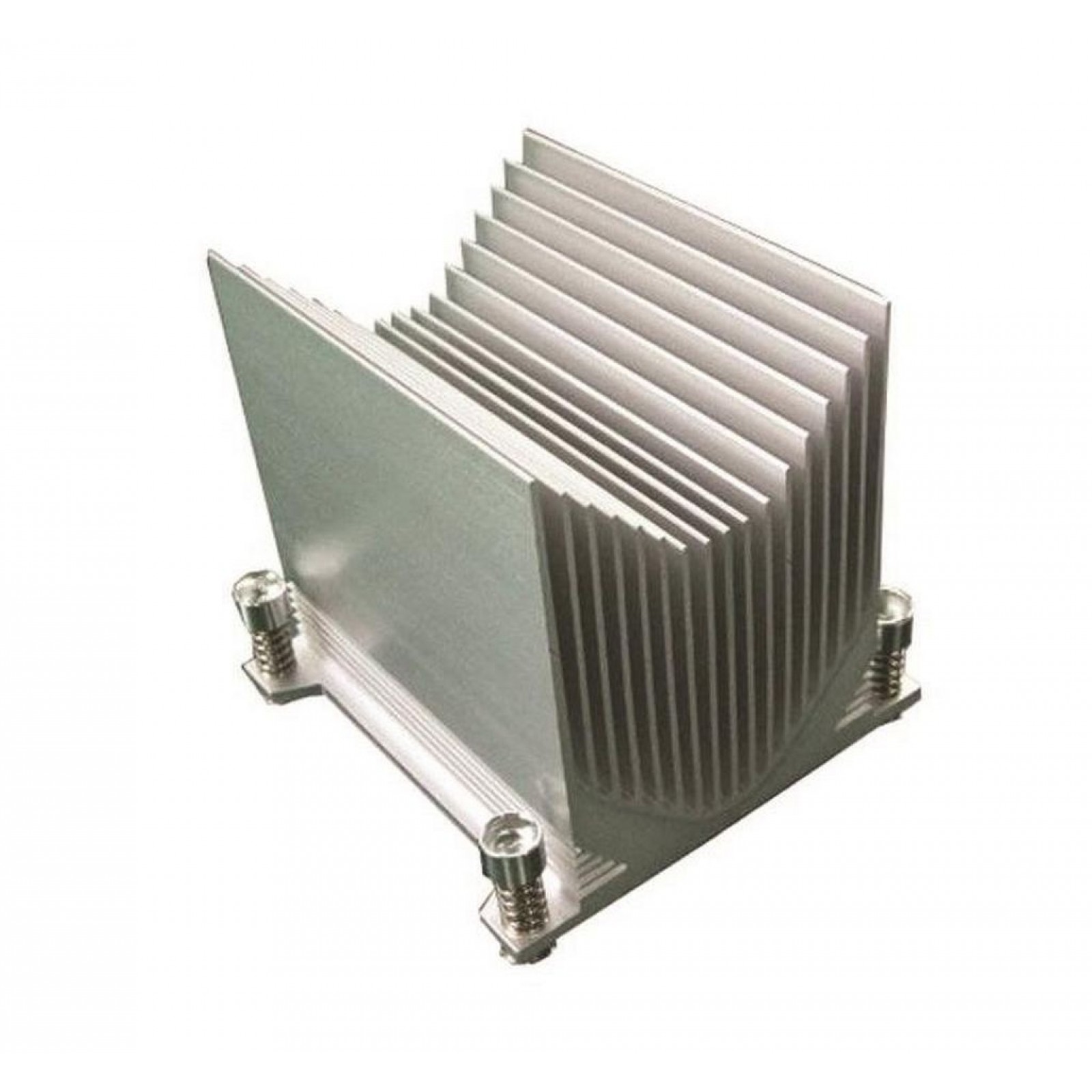

Heatsinks
I came across these whilst reading the Xmas TDA7293 thread and having nearly completed my Ubibs but not having decided on sinks yet. I thought these might do the trick and I can get them cheap enough.
They have a gross volume of approx 4"^3....ie 4x4x4 inches minus the cutouts obviously. They are a Dell CPU cooler .
Do you think these have enough thermal mass? Assuming I'm not pushing the Ubib to the max. I would hope to mount one M1 and M2 on one HS.
