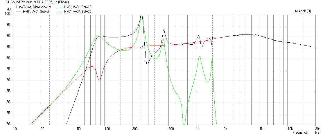

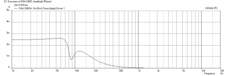

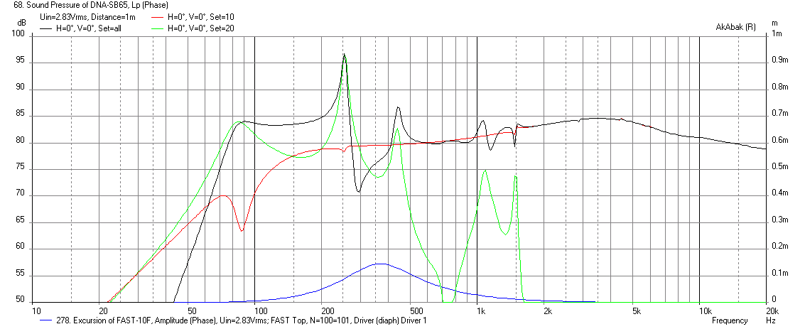

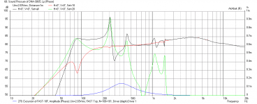

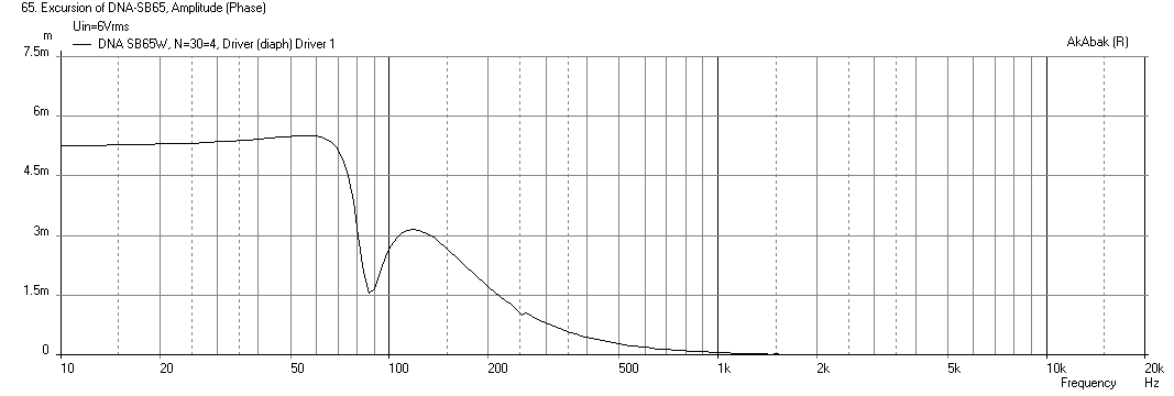

DNA mini (0.45x scale) with SB65WBAC25-4
Before I describe the sim, I figured out how to memorize this driver's long name: SB 65 (mm nominal dia) Wide Band Aluminum Cone 25mm (voice coil) - 4 (ohms).
Ok, so if we take this design, nominally for a 5in driver, and cut the size down by about half and use it for a 2.5in driver that should be OK, right? Well, not quite and luckily for us, the DNA is not a true horn so the tuning frequency is set more by the chamber and vent size which forms part of the hybrid bass reflex part of the DNA, the other half being a rear facing "horn" that provides impedance matching of the BR duct to the environment.
Here is a rendering of the DNA (from website):
Here is my reverse engineered dimensions of the full scale DNA:
If we scale this drawing by 0.45x (easy to apply in the existing Akabak model). The true size is about 3.6in wide (internally) x 12.375in tall (externally) x 5.75in deep (externally). That is a tiny rear-firing hybrid-BR-horn speaker. Then add a 1.7in dia x 6in long vent tube between the driver chamber and the first segment of the horn. This is what you get in 4pi space with diffraction and reflection turned on but walls are far away. The sensitivity is not good but at least the bass levels are high enough to overcome baffle step losses:
Here is the corresponding cone displacement at xmax:
And this is the SPL output at xmax with 6v of drive:
So it seems that it is really excursion limited and you won't get much SPL out of this. However, for near field use, probably OK. The result of using such a tiny driver to get bass is problematic as we can see. A better true horn loaded design will enable this to go to much higher SPL's.

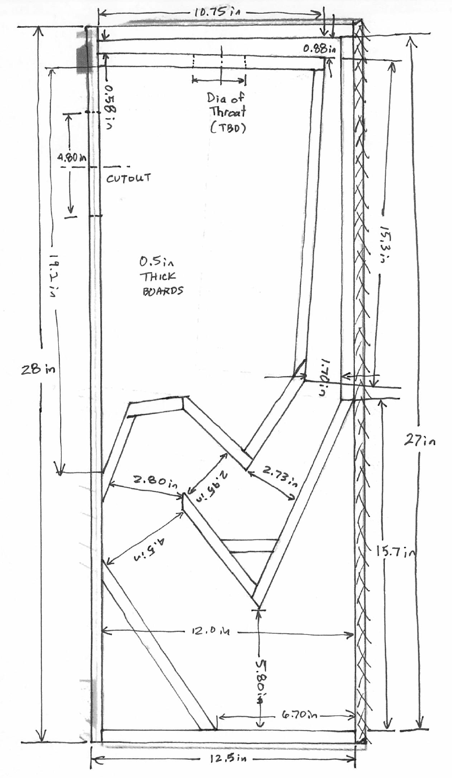

![478464d1429492264-sb-acoustics-sb65wbac25-4-what-do-dna-sb65wbac25-4-freq-1m-max-spl.png](https://www.diyaudio.com/forums/attachments/full-range/478464d1429492264-sb-acoustics-sb65wbac25-4-what-do-dna-sb65wbac25-4-freq-1m-max-spl.png)

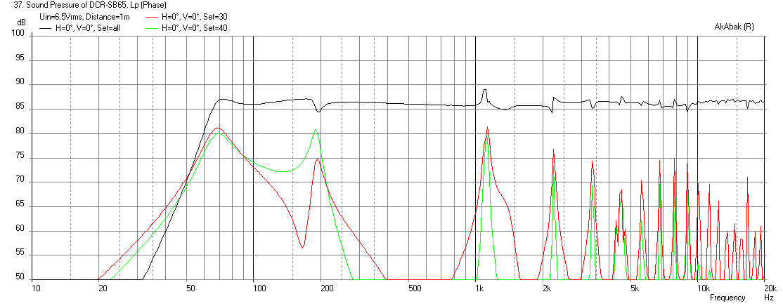

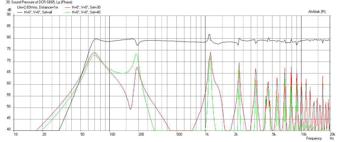

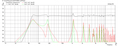

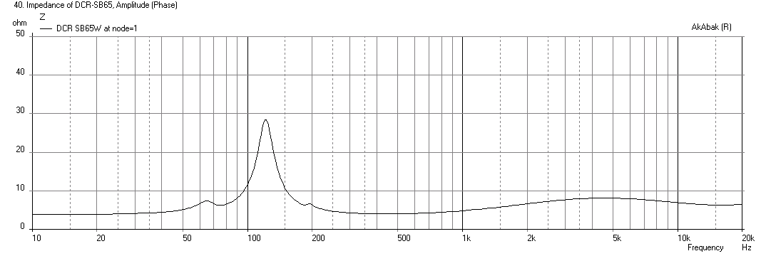

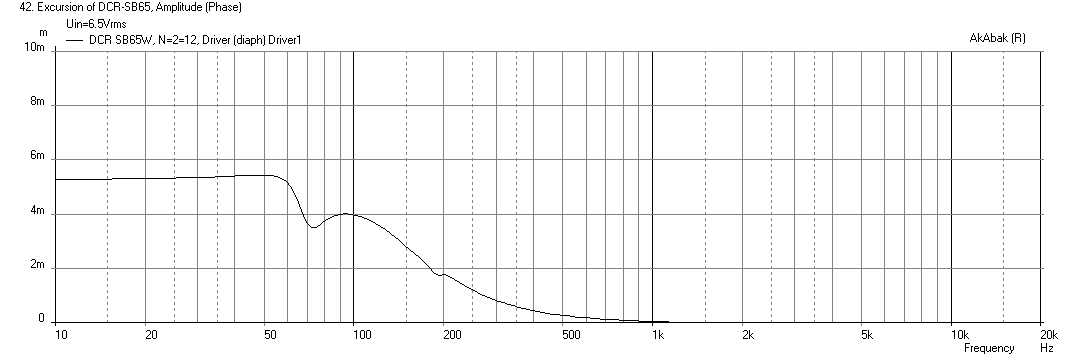

A Tiny 62Hz DCR?
This is a very easy build and certainly not as fancy as the mini DNA, but achieves a remarkably flat, albeit lower sensitivity system. For near-field monitors or PC soeakers, the lower sensitivity may not be an issue.
The box is 4in wide x 6in deep x 12in tall (quite small). The slot vents are 4in wide x 0.4in high x 4in long. The interchamber vent is 1.6in dia round tube that is 1.33in long. A BSC circuit was used to balance lows and highs as follows: 0.3mH + 4ohm + 3.3uF all in parallel. The result is truly an amazingly flat response. If the driver tracks this, it could be a mini monitor.
Here is predicted SPL at 2.83v and 1m away in 4pi space:
Here is corresponding cone displacement at xmax (5.3mm) reached with 6,5 volts of drive:
Here is corresponding max SPL:
Here is Impedance of system:
Note that higher SPL's can be achieved if high passed at say 55Hz.
![478505d1429530836-sb-acoustics-sb65wbac25-4-what-do-dcr-sb65wbac25-4-displ.png](https://www.diyaudio.com/forums/attachments/full-range/478505d1429530836-sb-acoustics-sb65wbac25-4-what-do-dcr-sb65wbac25-4-displ.png)
![478507d1429530836-sb-acoustics-sb65wbac25-4-what-do-dcr-sb65wbac25-4-impedance.png](https://www.diyaudio.com/forums/attachments/full-range/478507d1429530836-sb-acoustics-sb65wbac25-4-what-do-dcr-sb65wbac25-4-impedance.png)

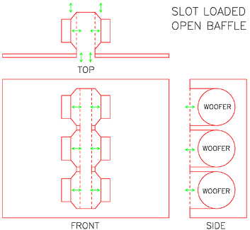

something like this but where the 20cm (8") woofer is not forward firing but a single pair is slot loaded. A folded W version of Nelson Pass's SLOB The Slot Loaded Open Baffle Project Article By Nelson Pass.
In Nelson's design he uses 6x 8" woofers in each slot but he is planning for these to be big room filling speakers. My aim is more a high quality, low distortion near-field monitor.
This would make a small (for OB) approximately 30cm x 40cm x 30cm open-backed box (folded OB) which could be used near-field or in a room. The reason I am leaning toward a small line-array is that the drivers max SPL does seem a bit limited if we want to keep distortion under control.

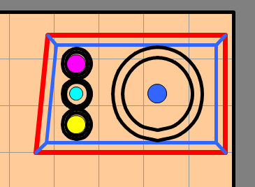

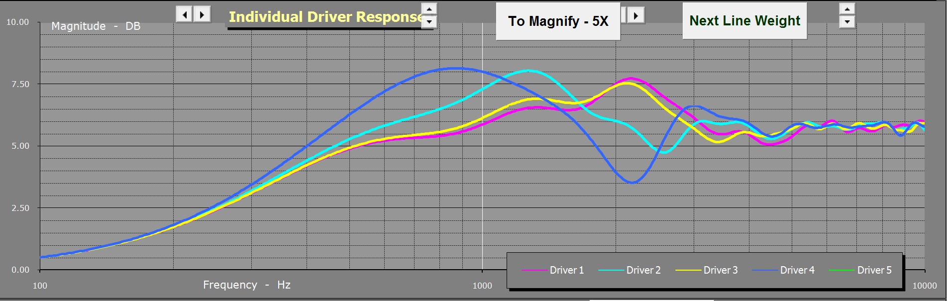

XRK do you know how to simulate a 3x line array of sb65 drivers? Is there free software for this?
I guess I am most interested in simulating the combing and lobbing effects to predict minimum listening distance and off axis response.
I known with PA line arrays for events that they follow a de-curve and are not flat. It also looks like the curve is not radial but an increasing curve. I wonder if with such a small array needs to curve though.
I still need to learn a lot more about line arrays

Yes, you can model it with my software of choice: Akabak. I have modeled the 25 driver IDS-25 with TC9FD's below. You can see the comb effect at various drivers. You will need an archaic Windows machine (pre 64 bit) - XP or W2K. The software has a learning curve but start small and work your way up in complexity. It's a script programming language that uses JIT compilation. There is some window dialog automation but not a whole lot. I can get you the script for the 25 driver array. To model your OB with 3 drivers is pretty simple. I think you have a trapezoidal baffle so that can be simulated with a different baffle width for each driver position. It will give you pretty close results. I have also modeled the SLOB with Akabak as well.
