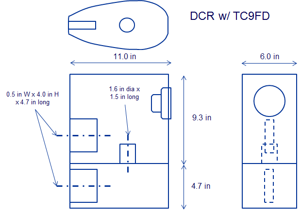

xrk in "Viva la Vifa" there is a curvy DCR for TC9 with 3 ports. In the proposed DCR here #5 you proposed 2 ports. The ratio between the 2 chambers is 2/1 ? The first (bigger chamber) has port only to the small ? Did you made any foam box to verify the given curves on "Here is corresponding max SPL" (80Db at about 80Hz ! Quite impressive). Is it possible (if I don't bother you) to post a sketch of the proposed DCR ?

A DCR has two ports and volume ratio was 2:1 for upper vs lower chamber. I think my proposal was to extend this to a triple chamber reflex or TCR, but I never did that and don’t think much would be gained. The DCR provides better control of cone excursion and provides a nicer quality of bass as there are two chambers tunes to different frequencies. For the TC9FD, sensitivity was about 86dB and with a typical -5dB baffle step loss that is 80dB at 2.83vrms.
The SB65 is 82dB at 2.83v and with -5dB baffle step loss would be about 77dB at 2.83v. So indeed 65dB is very doable. I think a DCR would be a good alignment for this driver rather than a MLTL. I’ll work on that when I get some time.
Here was design for TC9FD DCR:
Here was sound from DCR vs various ports and integrated sound. As you can see the sound falls off in bass so a baffle step compensation circuit is needed to shelve the higher frequencies. Probably a 0.5mH cool and circa 2-3ohm resistor in parallel.
I made fancy curved walls to reduce diffraction and skinny slot ports but all that can be replaced worh prismatic box and round tubes.

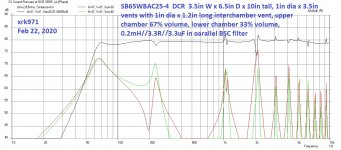

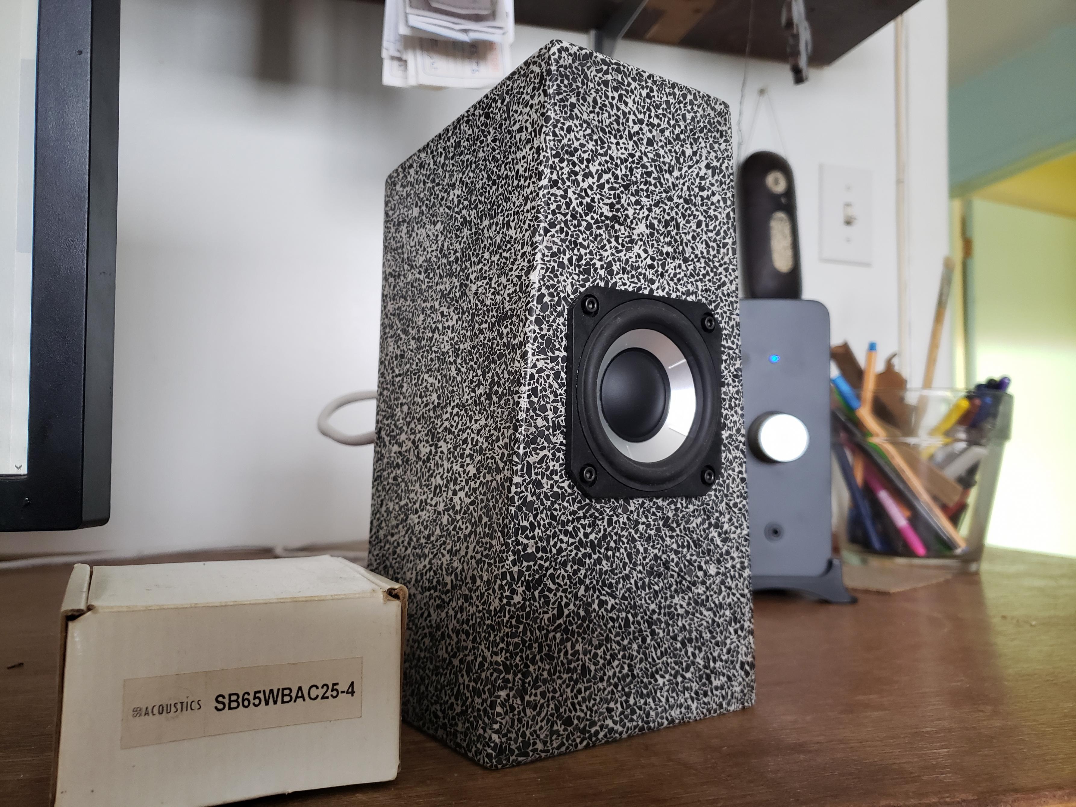

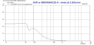

DCR Design

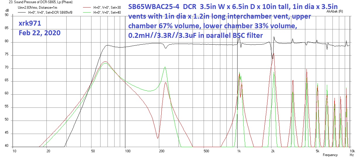

Here is a pretty compact design for a DCR (dual chamber reflex) for the SB65WBAC25-4 driver. It really should not be used above 2.83vrms input (or about 2w of power) if you have much musical content below 50Hz. This will give you about 80dB SPL - good level for near field desktop listening.
These are inside dimensions so external will depend on your wood thickness.
3.5in wide x 6.5in deep x 10in tall (total). So if using 1/2in ply, add 1.5in to the height since there is a divider plus top and bottom. Each external vent is 1in dia (ID) tube x 3.5in long, the inter-chamber vent is 1in dia x 1.2in long. Needs a special BSC filter comprised of 3 components in parallel: 0.2mH air core inductor (20ga copper) + 3.3ohm 2W or higher resistor (use Panasonic ERX or KOA Speer BPR, or any metal thin film) + 3.3uF MKP film capacitor. Line inside of chamber with felt and add small amount of polyfill stuffing. Be sure to roundover the backside of the driver cutout to allow free air flow around the basket.
Here is predicted frequency response (4pi space - sitting on stand in middle of room):

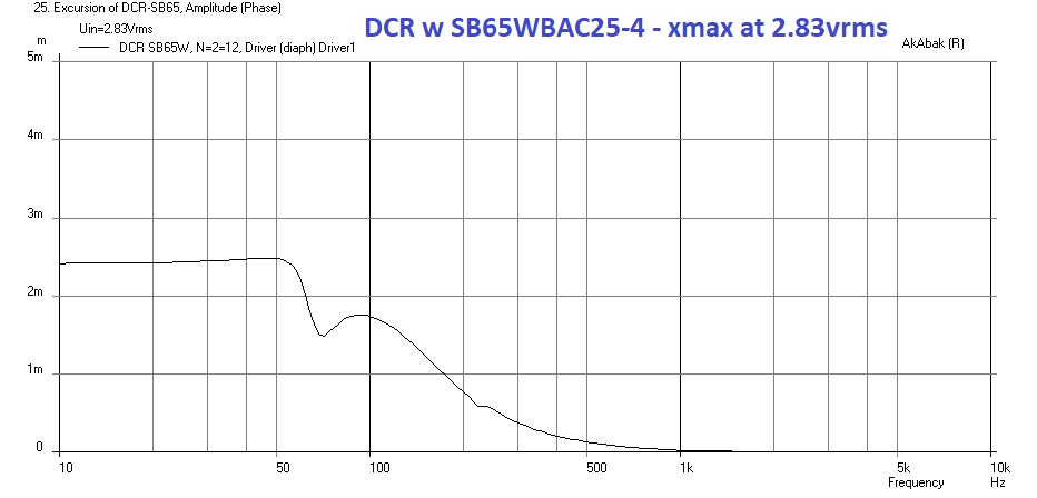

Here is predicted cone excursion at 2.83v rms:
I think it will sound very good with bass extension down 57Hz (-6dB), although any bass below 200Hz will tend to have significant distortion due to the high cone excursions. But play around 70dB and you will be fine.
You can adjust the 3.3ohm resistor to taste. Smaller value for brighter sound. On front baffle, use nice 1/2in radius roundover to minimize baffle diffraction. Flush mount the drivers with a rebate as that helps improve imaging and reduces diffraction. Put the BSC filter on bottom chamber bottom wall to add weight to stabilize the speaker.

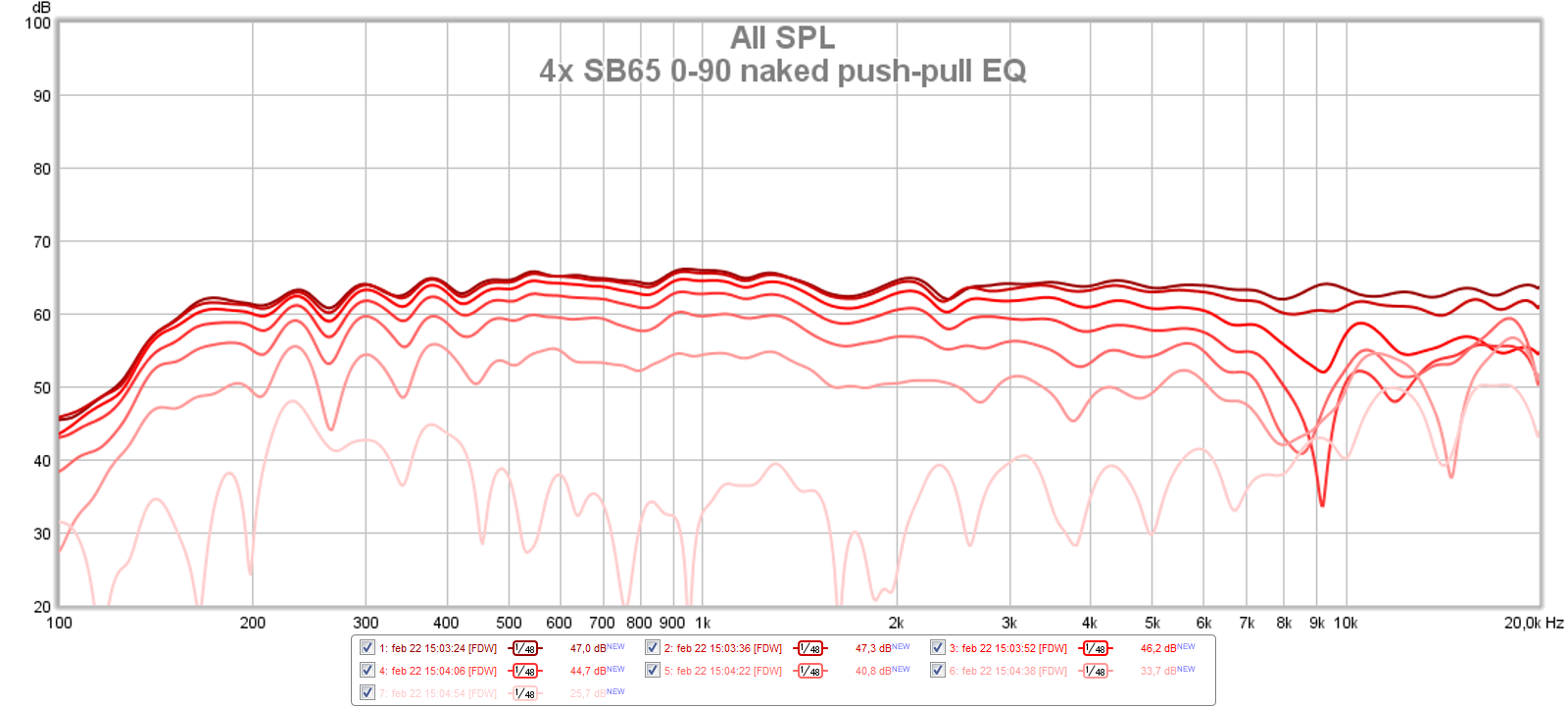

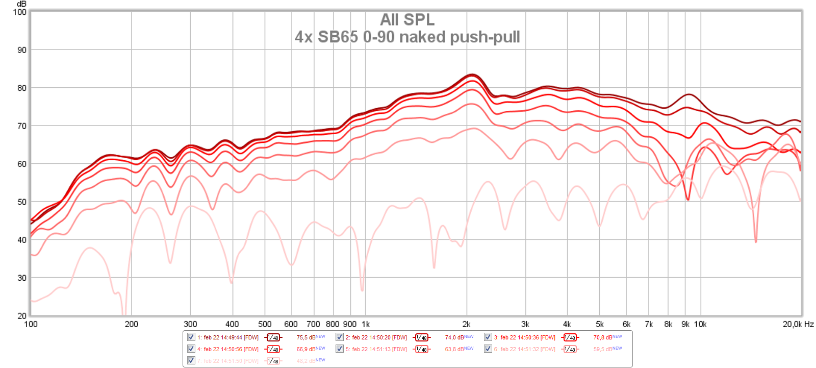

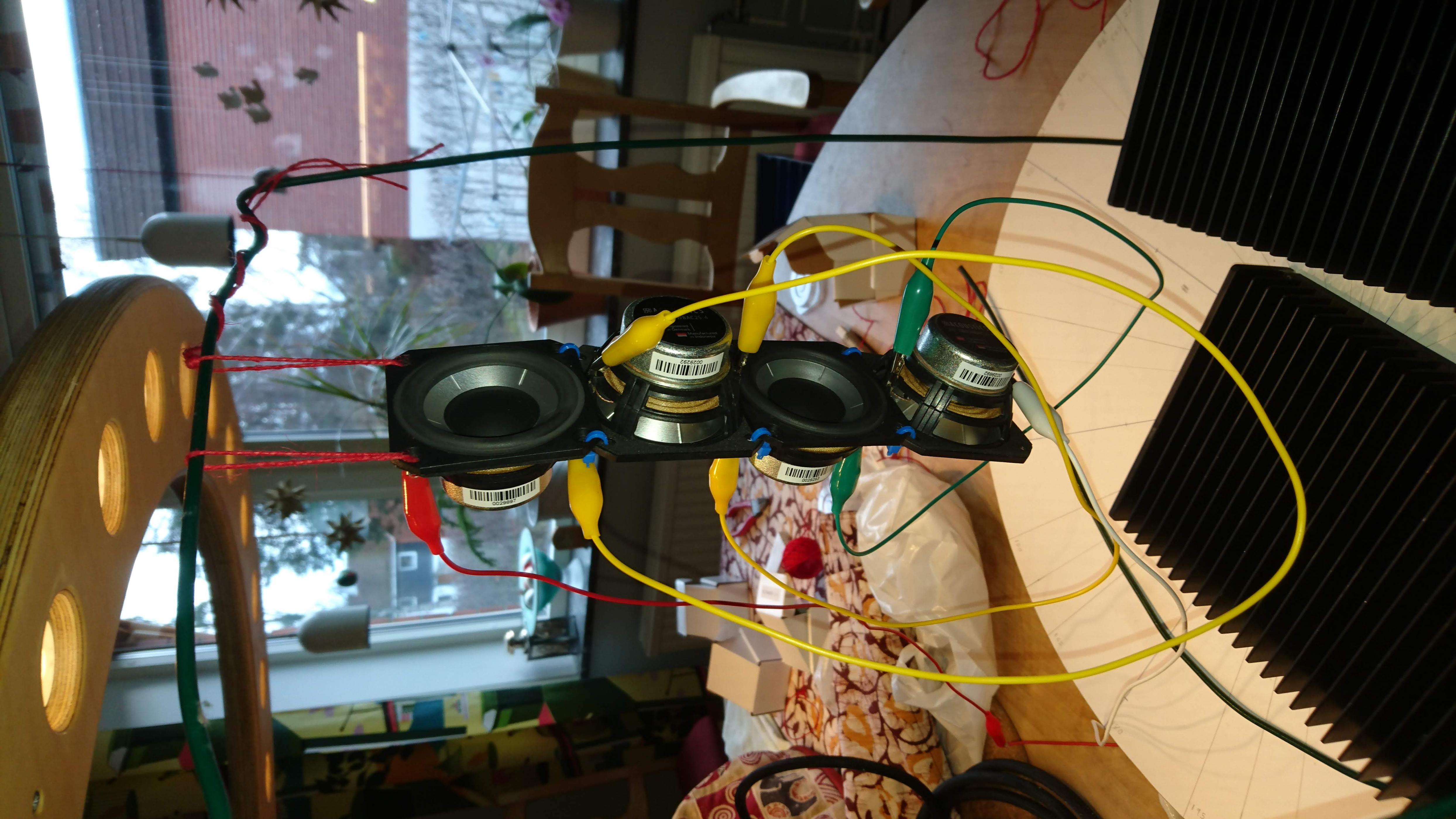

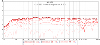

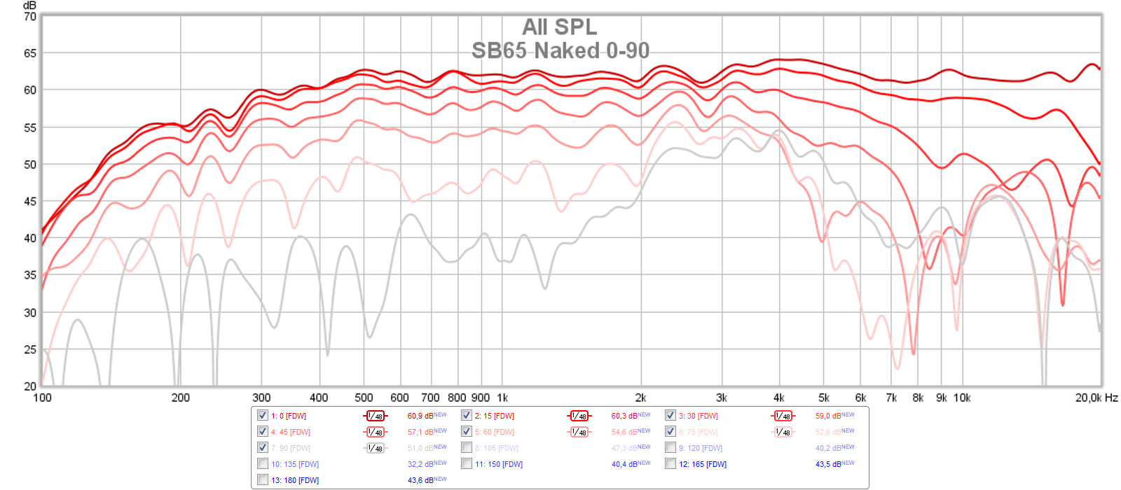

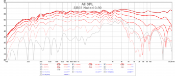

Those drivers are pretty nice, perform really well in a dipole setup too:
First is a single driver naked with EQ, and then in a small 4x setup half drivers inverted. First is without EQ and second with.
OB,

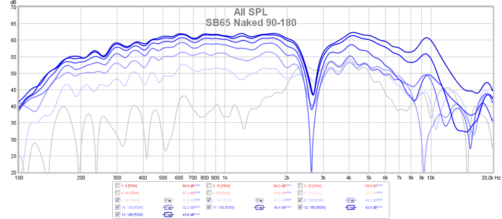

Very nice result. Never thought to use them bare as a dipole before.
What causes the sharp dip at 2.7kHz?
My guess is something caused by the magnet structure on the rear. I have seen it on every driver where the magnet is large compared to the cone, and worse the bigger comparatively it is. A similar dip is present in coaxial drivers with large waveguides for the tweeter, like the RCF CX10N251.
