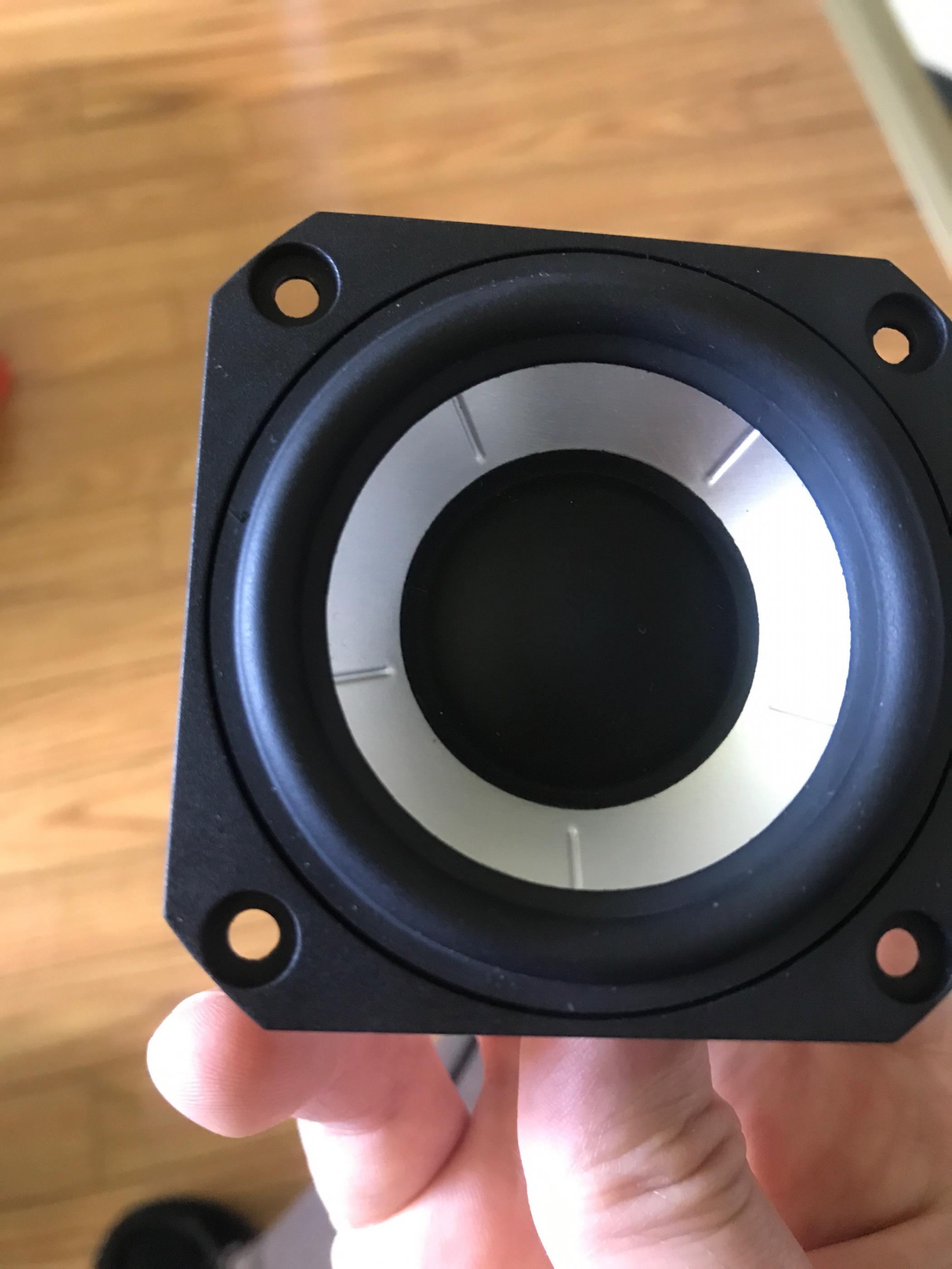

Drivers arrived a couple days ago from madisound. I also ordered a couple of peerless tc6fc00 to compare them with since I like the sound of paper cones.
I have to say I have never seen a driver as immaculately put together as the sb65. The voice coil aligns perfectly in the magnet and every joint and glue seem is immaculate.

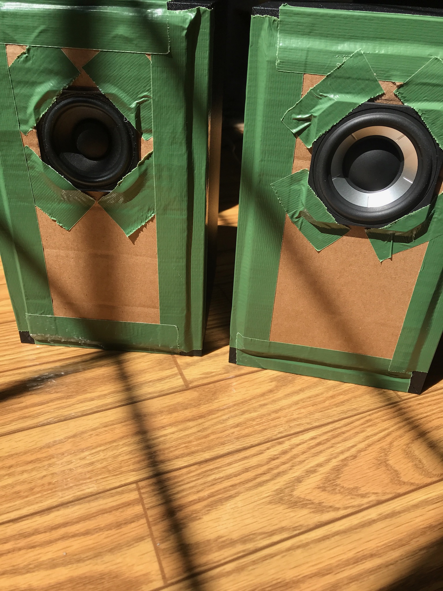

I duct taped one of each driver in a couple of sealed boxes for some listening tests. Initially I prefered the peerless since it sounded more natural. But as the drivers started to break in I found that I really like the sound of the sb65. After a few hours I was only listening to the sb65. The peerless tc6 sounded muffled and strained in comparison. The superior venting and motor of the sb65 makes a big difference.
I generally don't like metal cones but the sb65 doesn't sound shrill. The big poly dust cap damps the cone and gives it a more soft delicate type of sound. Not as organic as paper but not ringy either.
The highs are great, and I can barely tell that the dispersion narrows a bit. Also they go surprisingly low. I would say in the right box in a small room they could be run full range. They're definitely not like a subwoofer but you don't need that for music imo.

I reattached the peerless driver to the baffle from behind so it could breathe better and the sound seemed to open up a bit. I might end up doing a fast with the peerless tc6 for the vintage paper top end and doing the sb65 by itself in a ported box. Full range the sb65 is definitely better. It definitely needs baffle steo though to sound right.

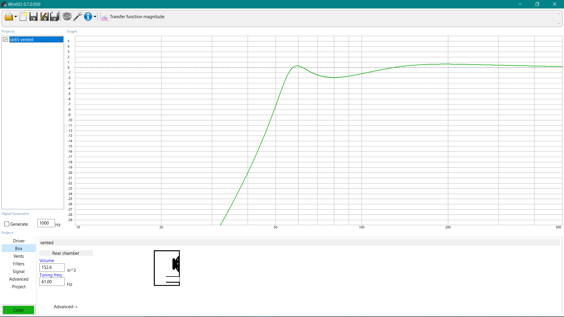

I've modeled them in an EBS bass reflex to go down to about 55hz with only a 1db ripple in the response.
Try them in a 150 cu inch enclosure with 1"x5" port. The tuning is around 50hz if I remember correctly. Its on another computer I don't have access to right now. I also built a test box and it sounded good. Not like subwoofer bass but good enough and can certainly mate to a sub.

Here is a pic. This alignment with the sb65 gets down to around 55 hz. The port is 5.68" x 1' ID. A fatter port isn't necessary as these are more geared to low volume listening.
Some might find the ripple objectionable but compared to room effects, especially in a small room, it doesn't matter much. I did do a cardboard test box.
It might make for a cute little box, but I think asking this small driver to perform all the way down to 55Hz is a bit much.

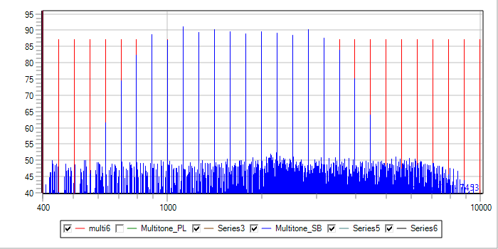

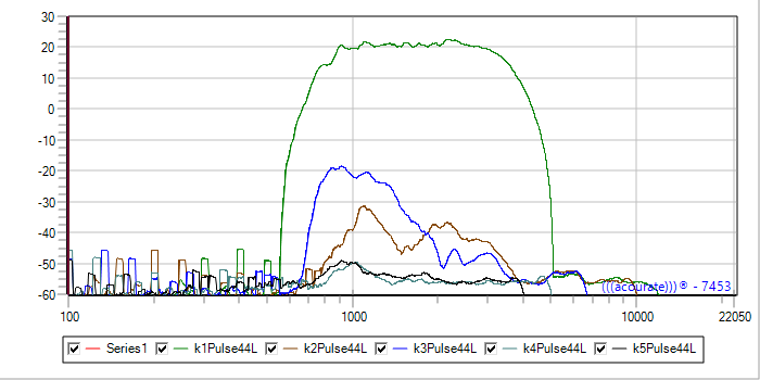

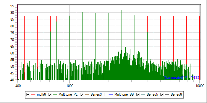

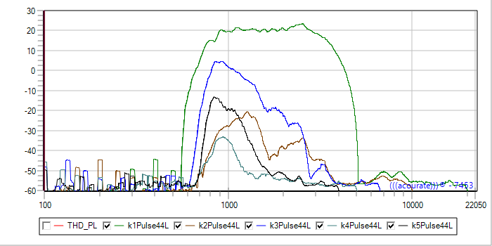

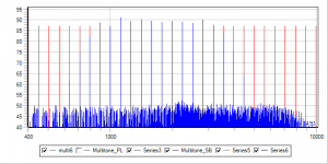

I had them both, intended to be used in a multiway system. For me, listening to a sine-sweep, the SB was not perfect, but comfortably ok. The Peerless instead subjectively failed right away.
Measured with a NT passband filter (800Hz ... 3.5kHz) shows that under this specific condition, the SB is clearly superior to the Peerless:
SB (sine thd)
Peerless (sind thd)
Under same conditions, SB produced 1% thd @ 1kHz, whereas Peerless produced 10% thd @ 1kHz.
SB (im multitone)
Peerless (im multitone)
In Multitone test same picture - SB showed less IM poducts than Peerless
Make your choice ...
