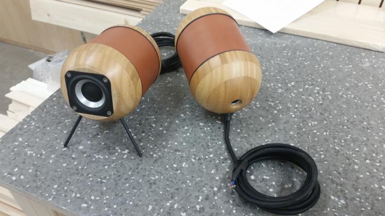

We made a pair IKEA -coconut version consisting of 2 bowls, cardboard tube w/ leather.
The hole in the rear bowl serves as a resistive port.
The low internal volume due to that a small subwoofer (8") are hidden under the desktop, no intention to force any low end out of the SBA's.
This was tuned with a notch filter for desktop listening. Don't remember the component values.
Thanks XRK. I am starting the final build very soon.Neat speaker Avondalenaim! Have you tried XO at 1kHz? I think that might sound very good too as it gives the full range more of the telephone band for great imaging.

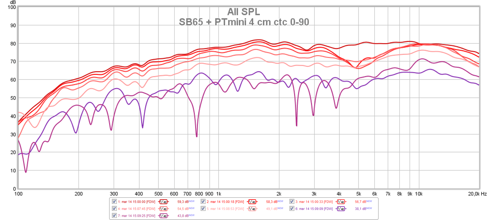

The problem with a separate tweeter is you will get lots of lobing since you can't get the tweeter close enough to the SB65. If you want better high frequency response I would suggest using a smaller FR driver or a large format tweeter in a waveguide. In my experiments, however, while it isn't the best tweeter I have found it to be good enough. Any attempts to cross to a separate tweeter have just made everything worse.
To solve the 10-20 khz bump I just adjust the top end down with some EQ.
I tried to use 4th order slopes."Lots" of lobing will depend on how steep the crossover is. The simulations look pretty good with a 3rd order slope. What did you end up using?
Chris
![SB65 + PTmini 4 cm ctc 0-90.png SB65 + PTmini 4 cm ctc 0-90.png](https://www.diyaudio.com/community/data/attachments/952/952974-fa3af012835602a8b12dd28b61db9b94.jpg)
2 driver tall mini-array SB65 with back to back Dayton PTMini planar tweeters (4 tweeters in total) as close as physically possible (4cm) beside it measured in the horizontal plane. Since I would have used them in an array then placing the tweeter above or below is not possible. In the end, however, placing tweeter above or below will just hide the lobing in the horizontal plane but the problems are still there in the off axis repsonse.
The lobing can probably be mitigated more with much sharper slopes but is it really worth it then since sharp slopes are no free lunch. In the end I decided that the high end of the SB65 is good enough that I didn't add a tweeter. And it has decent rear output too, a good enough dipole response up to ~ 10 khz before the rear starts to fall off which to me was good enough.
Might work better if the drivers can be placed closer, say in front of the SB65 like this array. That was not an option for me, however, since I was building a dipole array.
