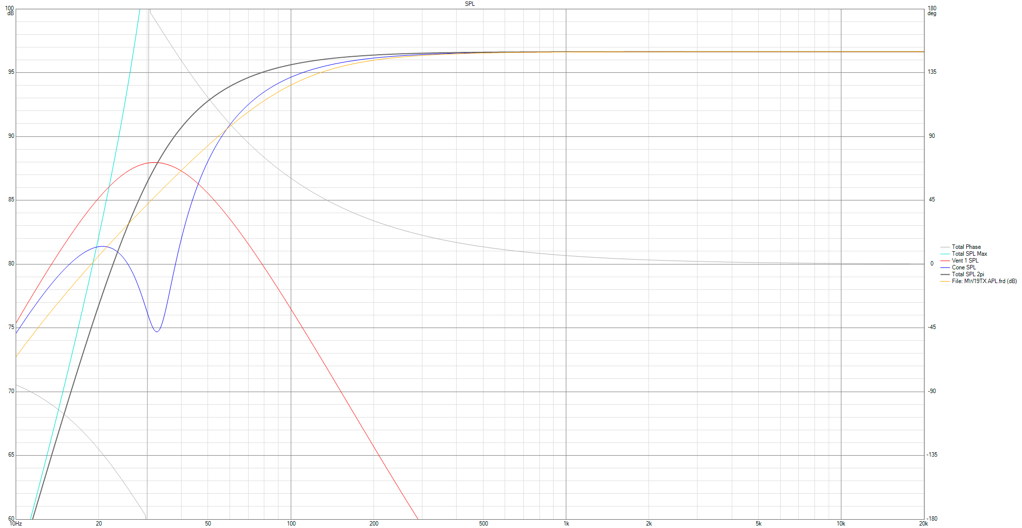

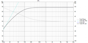

There are two plots, both are Qtc=0.5, Box volume = 70 ltr and Fb = 45Hz. The difference between the two plots is that the yellow plot is high Ql so low leakage while the gray is the APL box with low Ql meaning high leakage. The advantage is the +3dB at 20Hz. Impedance, phase and group delay is ofc also improved like they are when Transmission Line is the agenda.

The point I wana make for the APL vs BR is that if you look at the image I have included you can see what each individual part does.
The BR is Bessel tuned.
The APL graph is imported onto the BR simulation - this graph is the yellow one.
The total SPL into half sphere of the BR is indicated with the dark gray graph.
The port is indicated with red - remember that a port is always 180 degree out of phase with the driver.
The cone motion is indicated in blue.
We can see that there is a complete phase shift occurring at the port tuning frequency which in this case is at 30Hz. Also notice the cone movement between 25hz to about 55Hz... In a video I found on youtube a few years ago, this dip in cone output is recorded. Both a sealed and ported enclosure is demonstrated.
Ported vs. Sealed - Detailed Comparison - YouTube
While there are some benefits seen between 20-200Hz in this case, the cone and port behavior is less than ideal in my opinion.

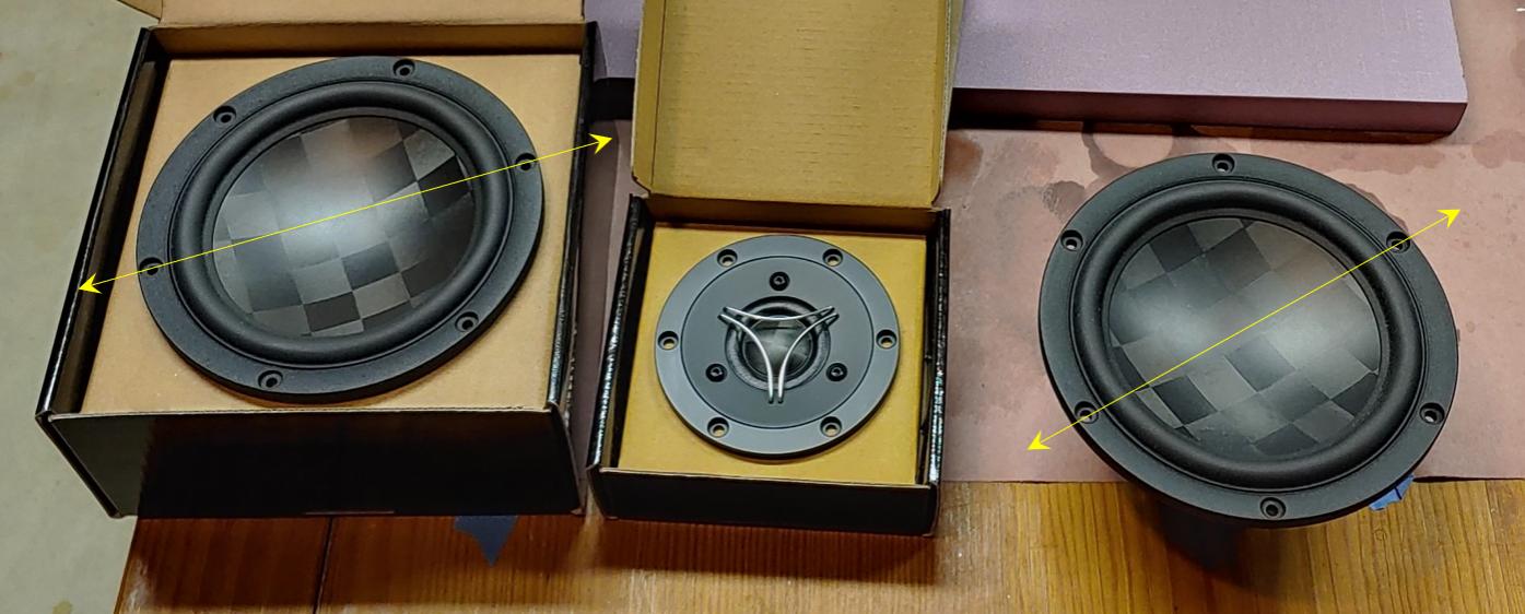

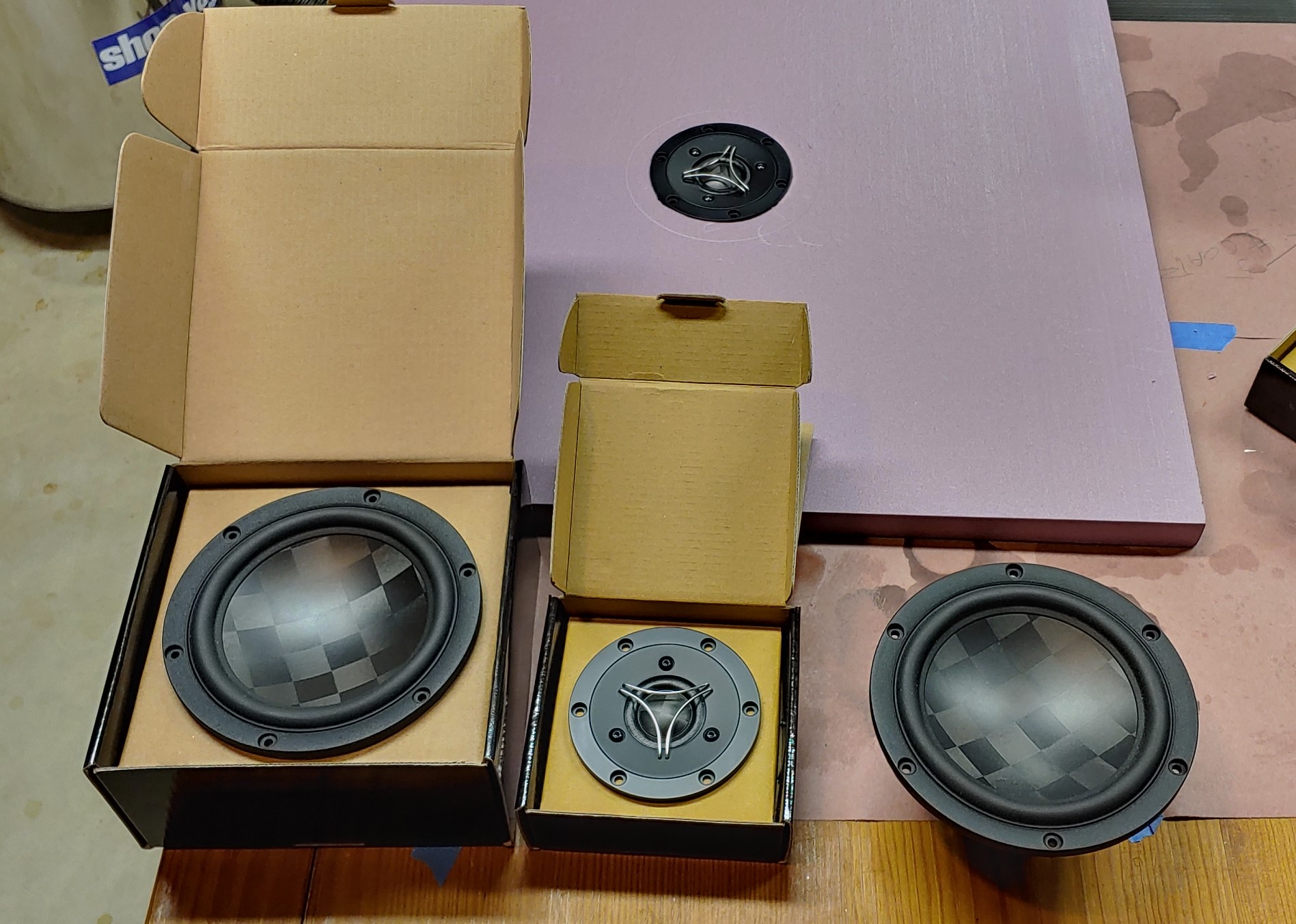

My new drivers arrived today. A pair of TW29TXN-B and a pair of MW16TX-4.

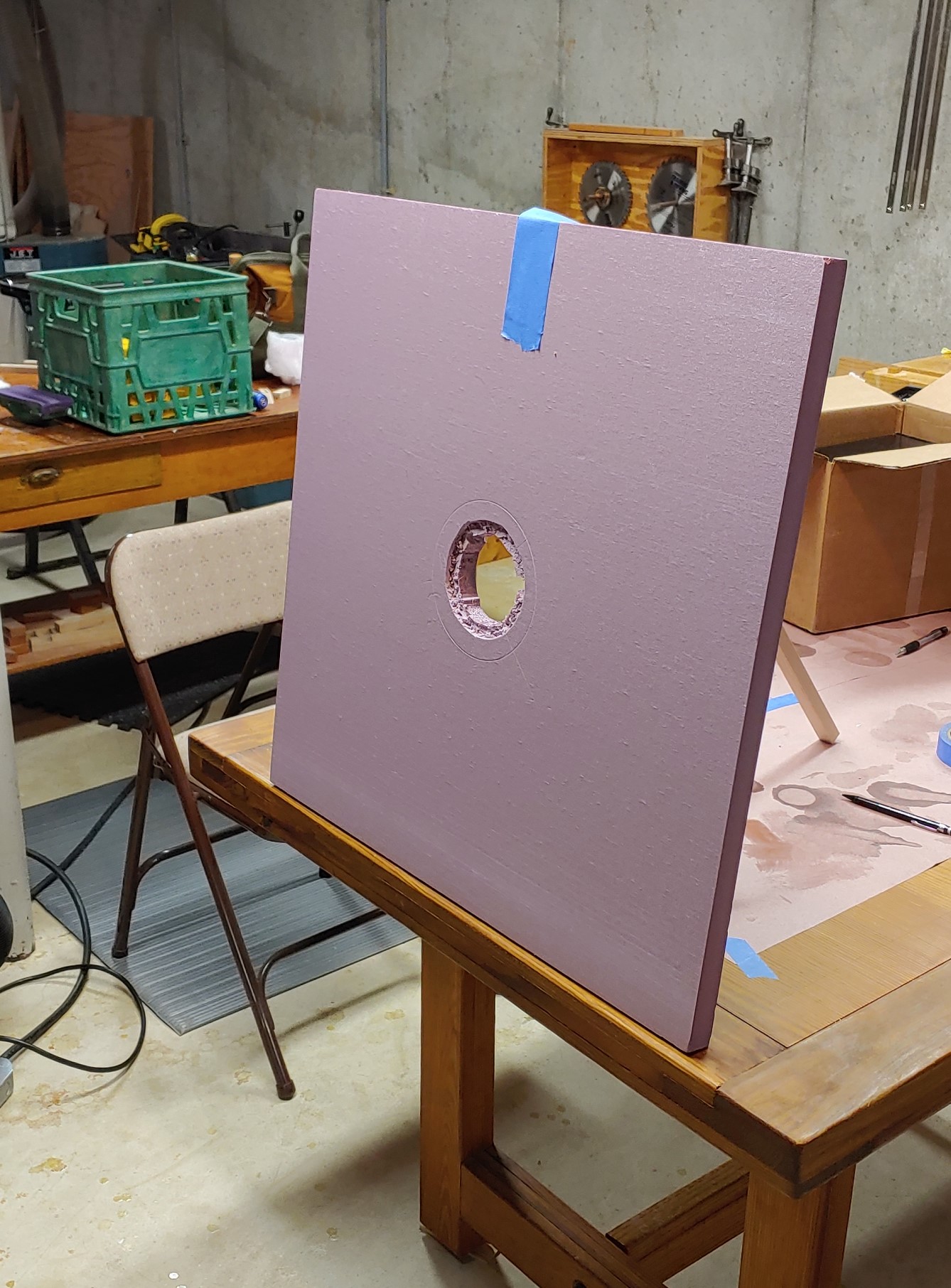

I am fabricating a baffle to do some measurements. I am using a 24"x24" sheet of XPS foam board (thanks to XRK971 for recommending this). I hope to have some results in a couple of days... Frequency response on and off axis, harmonic distortion, etc..
I have to ask... how well does the pattern of the weave line up with the mounting holes?My new drivers arrived today. A pair of TW29TXN-B and a pair of MW16TX-4.
Honestly I did not check that. I know it is important to some people, but it is not something I am concerned about.
Looking at the photos, it looks to me like it is aligned decently...
