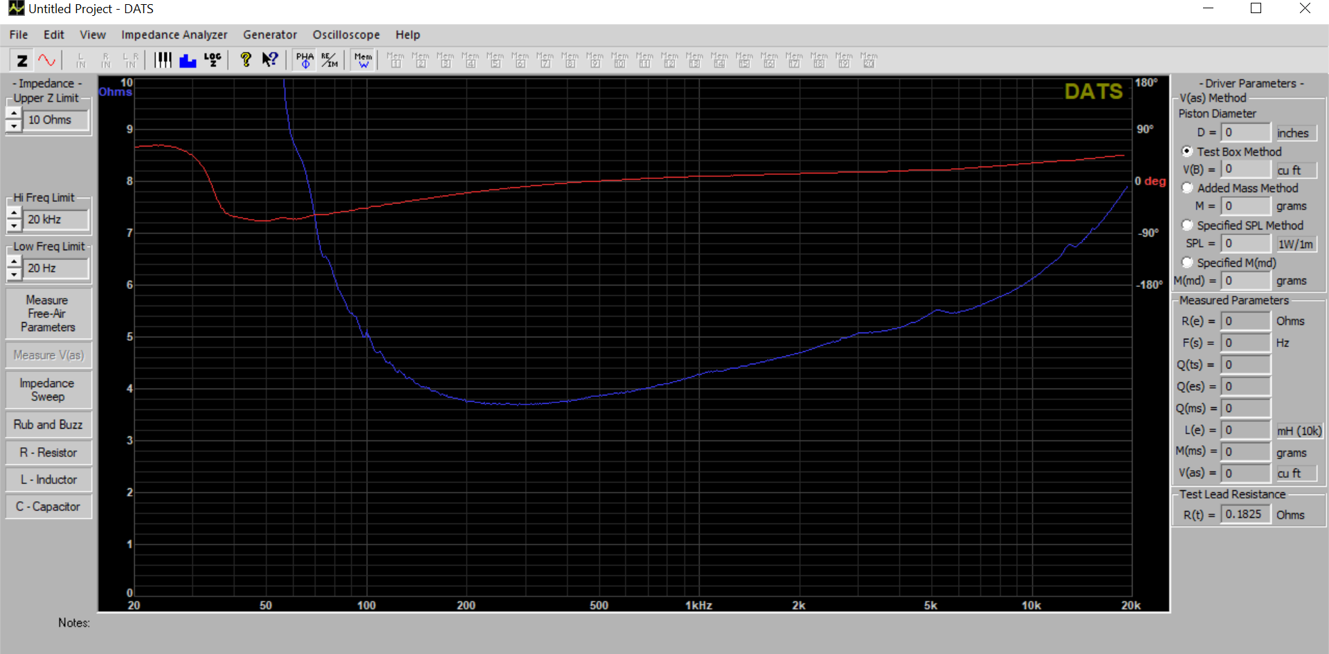

think you have DATS V2 version and I have DATS V3 version. DATS V3 is more accurate and more powerfull - resonance impedance graph is steeper, peak higher. Therefore, in my opinion, the subtle differences
I have DATSv3. When I magnify the impedance scale, my plot looks similar to yours.
My concern has been with how I interpret the 5k wiggle. I did not want to assume that it is a cone resonance without some other kind of evidence. Impedance curve anomalies can be caused by room echos /reflections or baffle resonances. However, now we have two independent impedance measurements (yours and mine) and both show a wiggle at 5k and also at 12k. So I am convinced the impedance wiggles are real and inherent to the driver... it is not a test setup error.
It also appears to have some minor energy storage at c. 1.2KHz & 3KHz. Probably not sufficient to cause great concern -if your focus is purely upon pistonic operation alone, you're more likely to be looking at a metal cone unit with a narrower usable operating BW.

SB's data sheet shows pretty clearly the main resonance is around 5khz, so I'm not sure why this is unexpected?
The data sheet I have does not show the impedance with enough resolution to see any wiggles at 5k or 12k... so I could not be certain that I was not making a test error until I was confirmed by BPatrik.
Since I can not make a CSD plot with enough resolution to see the resonance... and since the 5k on-axis rise and the 60 degree off-axis null occur right where an ideal infinitely stiff cone would have a off axis null... And since I am the first (to my knowledge) to post measurements of the MW16TX drivers... I was hesitant to claim a 5 k resonance.
