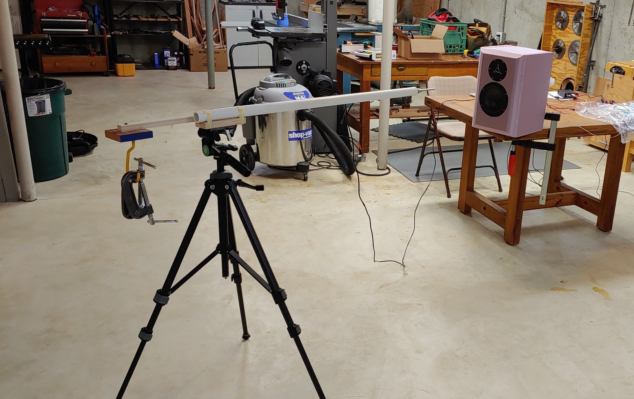

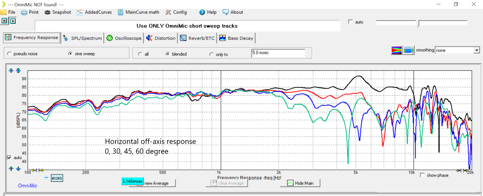

I believe I have refined my test setup to the point where it can measure an accurate waterfall response. I needed to build a more rigid baffle than my simple 24 x 24-inch foam board. So I built a prototype box from foam board, reinforced, and open back.

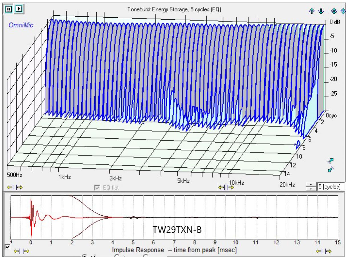

The Omnimic software has the capability of producing a “Tone-burst Energy Storage” plot. I am sure many people are familiar with the TES plot, but for those unfamiliar, I will give a short explanation.
The TES plot is very similar to a waterfall plot, but with two differences.
(1) The input function for the TES is a 5-cycle sinewave of gradually increasing then decreasing energy, whereas in the traditional waterfall plot, the input is an impulse. The plot will show expected response in grey, and any acoustic energy beyond the tone-burst signal will be displayed as light-blue. The expected (grey) response ends at 3 cycles, so anything beyond 3 cycles is an unexpected response (blue).
(2) The y-axis of the traditional waterfall plot is time, usually in milliseconds. The y-axis of the TES plot is cycles. This is an important distinction, and one reason why I like the TES plot. On a traditional waterfall plot, if we observe delayed energy at both 2 kHz and 10 kHz which falls down to -30 dB after 3 ms, both the 2 khz and 10 kHz resonances would look similar even though 3 ms represents 6 cycles of 2 kHz and 30 cycles at 10 kHz. This same response on a TES plot would be displayed along the y-axis as 6 cycles at 2 kHz and 30 cycles at 10 kHz.
With that explanation, I will get on to the data. First, I have a photo of my test setup. Next is the TES plots of the two drivers. These plots have been normalized to a flat frequency response.
Satori TW29TXN-B
The TES plot of the TW29TXN-B shows some low level “delayed energy” between 1.5 kHz and 8 kHz, at a level of -25 dB. This same signature is present on every driver I have ever tested, so I am convinced it is inherent to my test setup, probably a reflection near my microphone. Therefore, I am assuming that my noise threshold for this test is -25 dB between 1.5 kHz and 8 kHz, and anything below that is ambient noise. On the other hand, the delayed energy above 16 kHz is very likely a real response. It is a very well damped resonance, starting out at -20 dB and quickly falling to -30 dB after about 3 cycles.

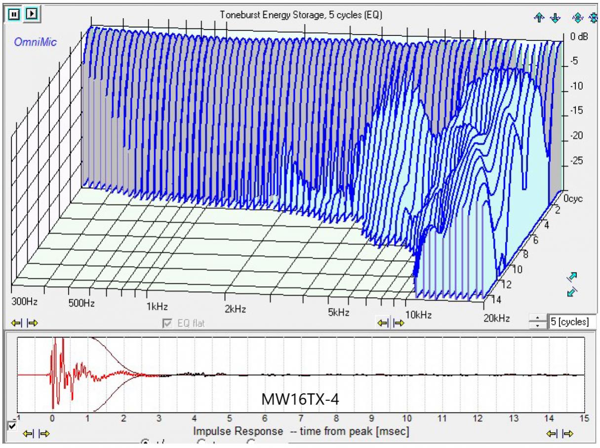

Satori MW16TX-4
The TES plot of the MW16TX driver again shows my ambient noise problem from 1.5 k to 3.5 k below -25 dB, so this response should be ignored. Beginning around 4 kHz, we see the start of some resonant behavior which seems centered at around 5 kHz. The resonance starts off at about -8 dB and quickly drops down to below -30 dB after just 8 cycles. I consider this a very well controlled resonance, quite different than a metal cone driver. Between 10 - 20 kHz, there is another wide band resonance which is less well damped. Any resonance in this region is insignificant because it is at least well outside the operating band of the driver. Even this resonance is damped enough that the frequency response is quite reasonably flat in this range.

Could be cool to see if the midrange would perform more even - no bump off-axis at around 2,6KHz, if the baffle was cut narrow around the driver like most of the designs from Heissmann.
Thank you for your thoughts...
I have not decided what the form of my enclosure would be. The foamboard boxes are first generation prototypes... I would like to do a highly profiled baffle such as Avalon, Revel Salon, Heissmann as you mentioned, or Magico... I need to carefully assess my craftsmanship skills. I am certain I could build this kind of baffle, but could I also make it beautiful?

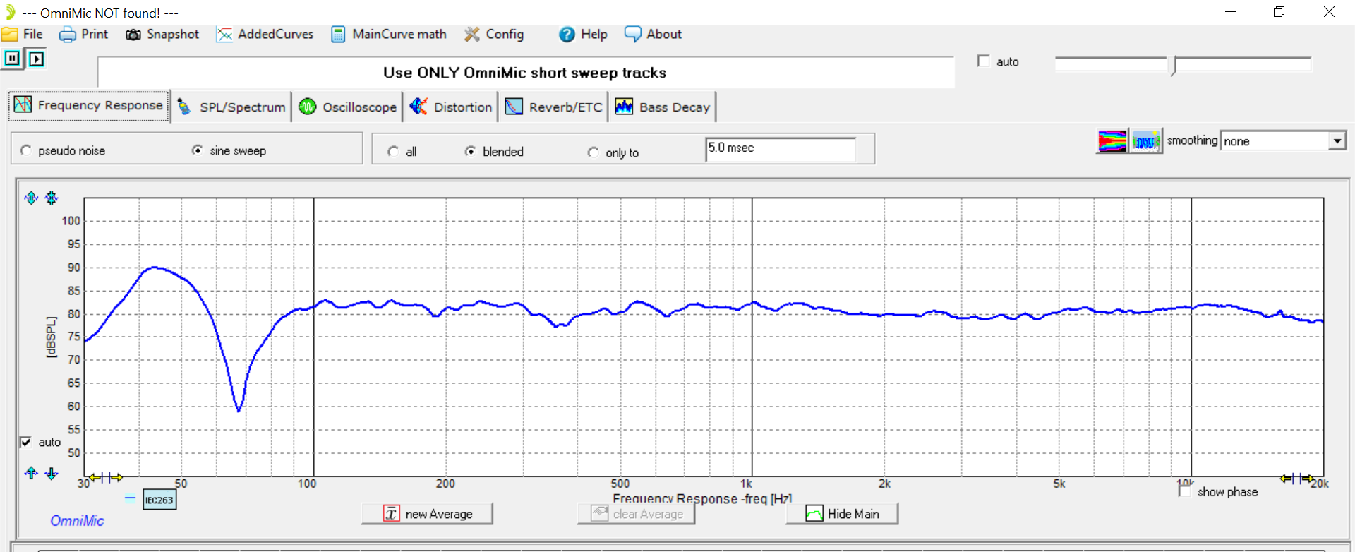

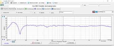

The drivers required a very minimal amount of EQ within their pass band. The mid driver needed 8 dB of baffle step compensation, and a notch filter at 5 kHz to control the cone resonance. The tweeter needed a slight boost at 3.2k. As a starting point I am using BW3 at 200 Hz and LR4 at 2 kHz. There is 680 mm of delay between the woofer and the mid because the satellite is about 2 feet in front of the woofer cabinet. There is an additional 26 mm of delay between the mid and tweeter. The mid-tweeter delay was optimized by inverting the tweeter polarity and adjusting the delay to get the maximum null.
All of the following measurements were measured at 24 inches from the satellite, on an axis mid-way between the tweeter and mid driver. The first plot is the on-axis FR. The time window was 4.7 ms. I must admit that getting a good flat response was much easier with these drivers than it was with the SB ceramic drivers, mostly due to very forgiving nature of the Satori MW16TX.

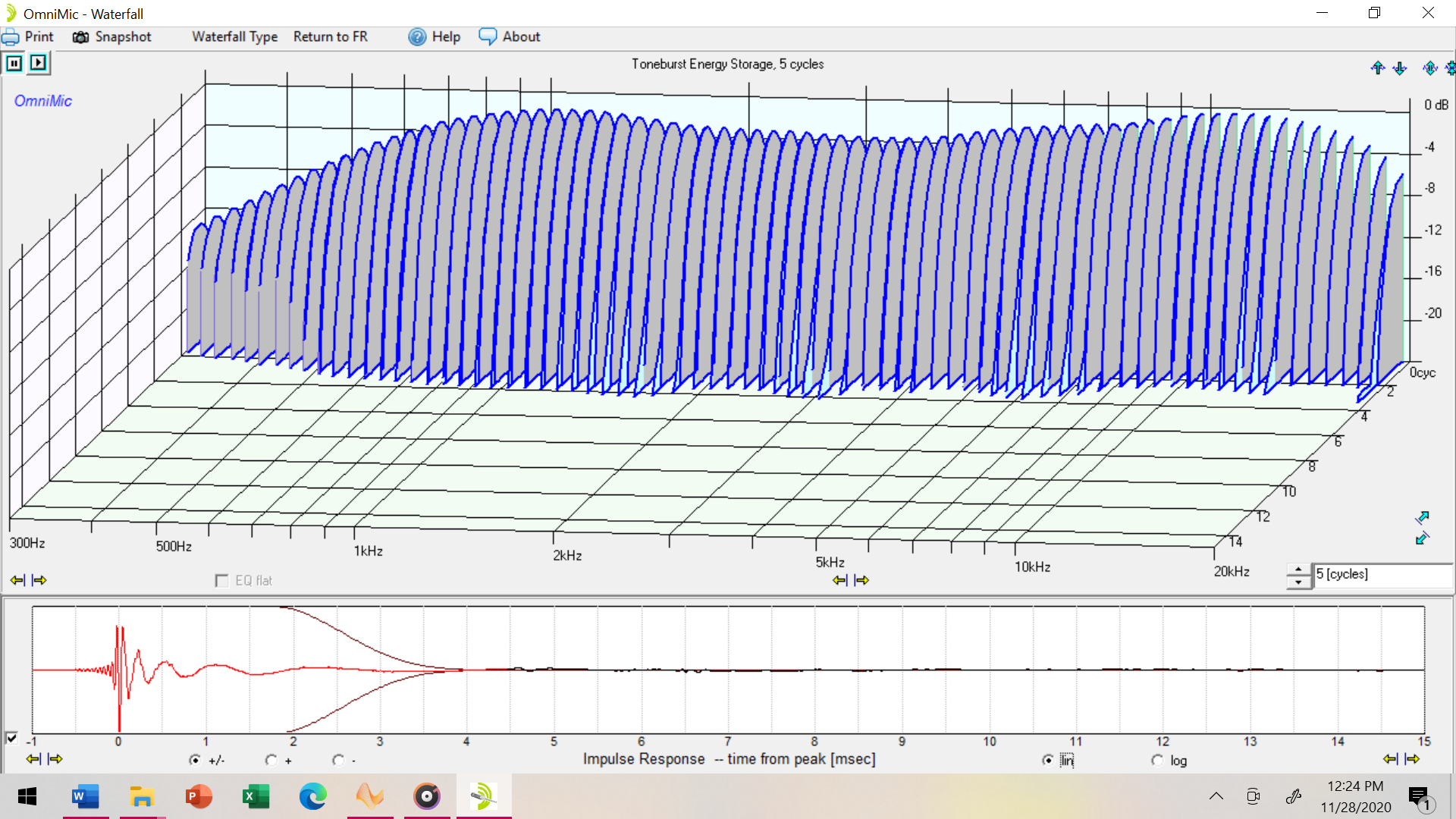

The next plot is the Tone-Burst Energy Storage plot for the whole system. I am pleased with this performance. I posted this to show that the MW16TX resonances at 5k-up are easilly handled with proper filtering.
