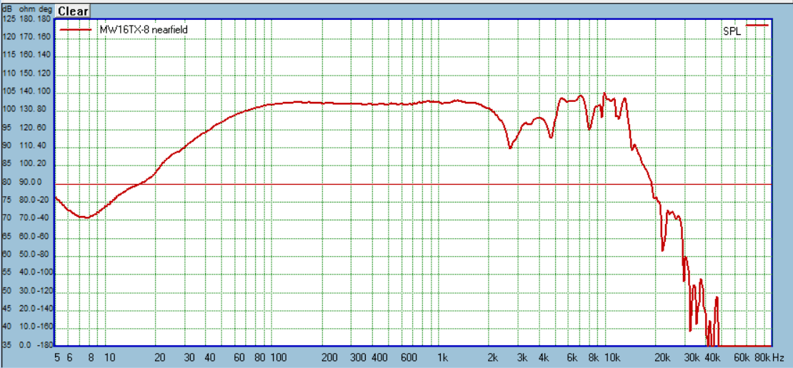

Graph looks hopeful. (Where went HF breakup peaks?) I don't think the 1.5m-delayed TL port output causes cancellation of the direct driver output like BR below Helmholtz. At 57hz the 6m wavelength is 4X the TL, so the backwave becomes 90deg out-of-phase and combines with direct output at +3dB (if equal amplitude). At 60hz the gain is a bit more, at 50hz a bit less but still positive (until 38hz). At 43hz the TL gain is minimal but quarterwave resonance dominates cone output anyway. There are minor TL sub-segment resonances due to bends and folds but nothing that would create a valley around 50hz.
Near-field measurement is good -- I used my head and two ears plus volume-control to measure finger-traced tone-sweeps. In-room I surely cannot hope to exceed SB Acoustics in measurement accuracy, but playing music at 1m the lower bass notes aren't quite as satisfyingly complete.
https://audioxpress.com/article/test-bench-sb-acoustics-satori-mw16tx-8-textreme-wooferwchang: "Graph looks hopeful. (Where went HF breakup peaks?)"
It's a nearfield measurement.
Everything else you wrote is speculation that could be resolved by simply making real measurements and posting them.

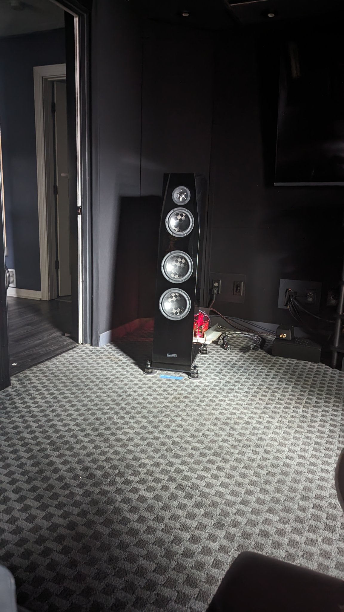

I have an full Textreme Sasandu active that I absolutely love. I would put them up against any speakers at any price. I am playing them full range and constantly get asked if I have my subs playing. The weird thing is you can't even see he woofers move. But they are cranking along at about 95db. The room is shaking but it doesn't even look like they are working at all. What an impressive speaker.

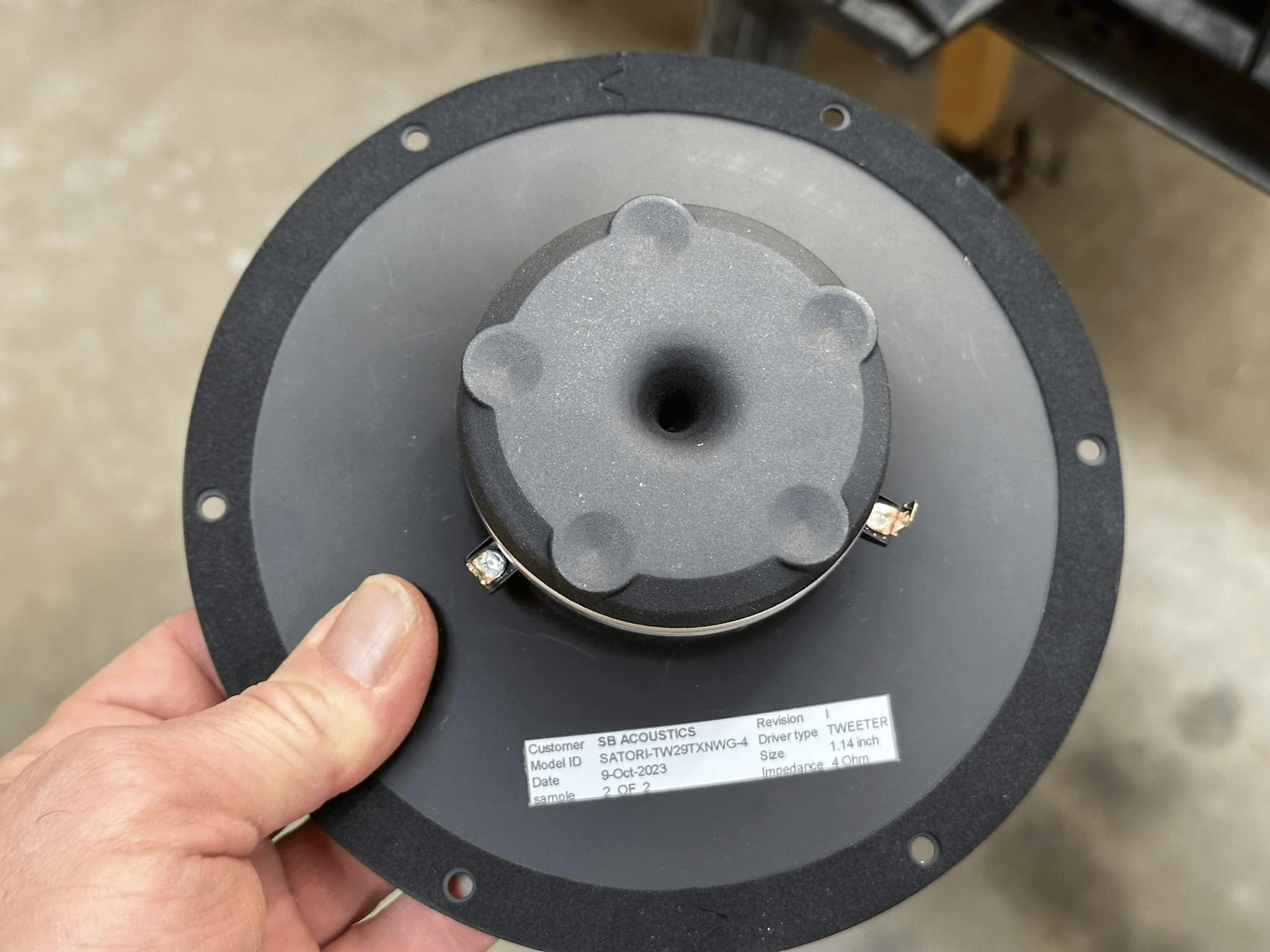

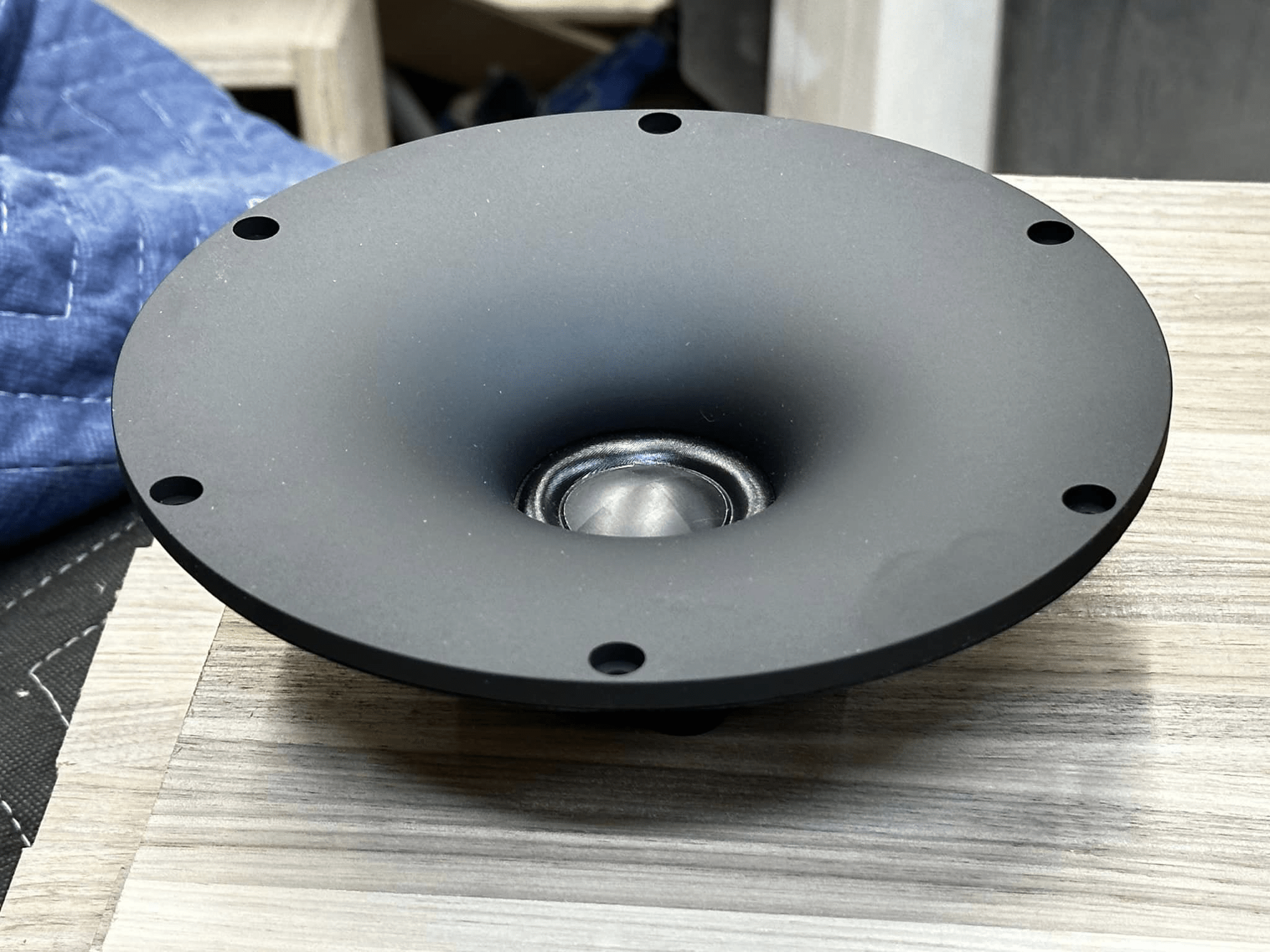

I copied these images from Javad Shadzi's facebook page. It is not clear to me if these are pre-production units, or if he had some aluminum waveguides machined and integrated them onto the tweeter himself. I think I remember reading that he was selling waveguides for the TW29TX, but now I can't find the facebook post... I admit I am not very proficient at finding information on facebook...
So yes, the TW29TXNWG exists in some form, but it is not mentioned on the SBA website (yet).
Glad that it existsView attachment 1321513 View attachment 1321514
I'm not a fan of the TW29BNWG as it's doesn't have a protective grille to protect the dome. My Focal Scala Utopia (with grille) have large stickers to fixate the Beryllium in case of a damaged/shattered dome.
