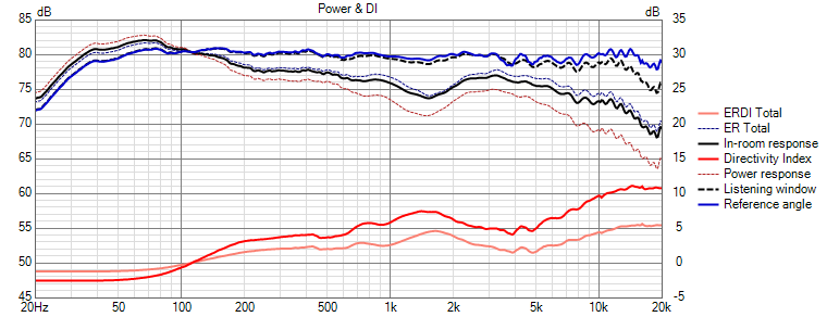

Another aspect to consider: If the response is rising from 1k to 3k, many people will perceive a harshness or shrillness. It only has to be 1 to 2 dB rise, and not necessarily on-axis although that would be worst case. If the ER curve, the PIR curve, or the power response curve have a rising response from 1k to 3k, this can create the sensation of harshness that has nothing to do with the driver, but is entirely related to the radiation pattern.
This is the kind of response I am talking about. Note that the on-axis and listening window curves are flat +/- 1 dB. However, the Power response, ER, and PIR curves all have a rise from 1.5k to about 3k.

You really think that is enough to cause a noticeable shrillness in music? How about the rise from 5k to 20k? That seems like a much sharper rise but you are saying the rise between 1k and 3k where it's at? I've have built speakers in the past and due to the cross over points and Butterworth filters there where bumps in the frequency response there and never had anything I would consider shrill before. But then again I've never really plotted the power response before.This is the kind of response I am talking about. Note that the on-axis and listening window curves are flat +/- 1 dB. However, the Power response, ER, and PIR curves all have a rise from 1.5k to about 3k.
When I had mine in the test box (I haven't finished my floor standers yet.) they didn't have any shrillness to them but one thing I did notice was they where very revealing. If there where any flaws in the recording you where going to hear them. To some people this might come across as shrillness absent a better description, I don't know. I did have a good amount of roll off for the higher registers though but nothing that the midrange would of heard.
Yes, thats why people use a waveguide, to even out the off axis to make it sound more relaxed.You really think that is enough to cause a noticeable shrillness in music?
Some people think so, including people whose opinion matters. I don't seem particularly sensitive to this kind of radiation signature, and it may be to the type of music I prefer when I do critical listening. But many people are very sensitive to this phenomenon.You really think that is enough to cause a noticeable shrillness in music?
As @Jonasz mentions, a waveguide can control the directivity of a tweeter so that it blends well with the mid driver over the range from 1k to 4k, which is where a crossover is typically located. This allows the designer to avoid the 1k-3k rise in ER, PIR, and power. However, it can be done without a waveguide.

Apparently, some people are more sensitive than I am to a rise in the 1k-3k region. I was able to mitigate the response with some careful DSP filter adjustments. For me, the difference in sound quality is small, but others might perceive a larger difference, and I think it might be program dependent. It is probably room dependent as well.
When I said "Some people think so, including people whose opinion matters" ... I was specifically thinking of @fluid and Kimmo. Both have discussed this subject, and that is how I became aware of it.
So I am not promoting a particular radiation pattern as superior. I am just offering some thoughts to svans on what he might be hearing in terms of "harshness"...

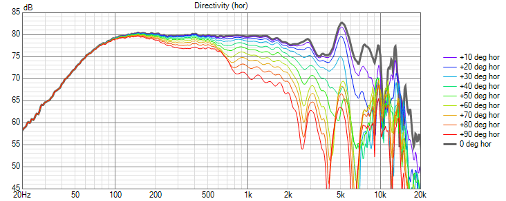

Here is the measured polar response of the MW16TX-4 in my cabinet, with no filtering applied except a +6 dB baffle step compensation. We can see that there is a cone resonance at 5k. This is something that any crossover will have to deal with, whether active or passive. I found a notch filter works very well. The higher the crossover, the more difficult this peak becomes, but a 2.5k crossover is quite practical.
There is also a bit of misbehavior at 2.7k-3k, and after looking at the spectral decay plots, I don't see much stored energy at this frequency, so I think it is the rubber surround moving in antiphase. The off-axis cancellation null should also happen at about 3k, so this is also what we are seeing here. This small burble at 2.7k - 3k does not need a notch filter, in my opinion.
