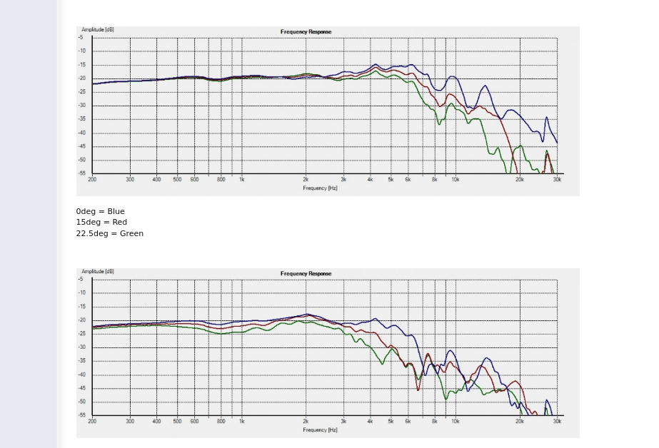

I suppose I'm talking about the entire off axis energy that the tweeter, and loudspeaker, produces as a whole. It's the entire ethos behind why using a waveguide is a good idea in the first place. Controlled directivity. The basic idea is that you linearise the off-axis energy that the speaker produces out to a specific off axis angle. From experience this usually looks like till about 30 degrees for domestic speakers. In other words the frequency response across the first 30 degrees off axis is as close to as identical as possible. This means if you sit anywhere within these 30 degrees the tonal balance of the sound will stay, roughly, the same. Freedom from any head in a vice.
This is only half of the story however and arguably the least important aspect of what a waveguide does for domestic listening. For domestic listening, in typical rooms, we need reflections within the room to create a realistic sound field. A complete absence of these reflections would create a sound field like headphones which is not why one listens to loudspeakers. The reflections are necessary. This is only up until a point however. If these reflections arrive too quickly vs the direct sound we end up with an issue. It affects the brains ability to pinpoint the location of a sound source. For our brain to construct a realistic stereo image it basically processes the information in the music that give it cues as to where any of the sounds within it are located. If you blur these cues with room early reflections the imaging gets smeared. These reflections usually come from side walls and are created by the off axis energy produced out at wide angles. While a typical domestic waveguide attempts to linearise the energy within the first 30 degrees off-axis it does so by focusing the far off axis energy into this 30 degree beam. This is a smooth, progressive, process so all that happens is you end up with a more controlled 30 degrees and less energy out at the wider angles vs if the waveguide wasn't used. The reduction of energy thrown out to the side walls reduces the intensity of the 'early reflections' produced within the room and enhances the clarity and precision of the perceived images within the sound field.
To my ears the subjective effect of increasing the intensity of these early reflections is to add 'hash' or 'noise' to the higher frequencies making them come across as confused and difficult to listen to. It's not 'bright' in the typical sense it's just unpleasant and feels like the brain is having to work hard to listen to the music.
Room treatment can be used to reduce the intensity of early reflections but the trouble with this is it also reduces the intensity of the late reflections. We want late reflections as they are necessary in creating the spaciousness that we want when listening to loudspeakers.
As to your question about preferring the XT25 to the DX25? Absolutely yes. And a 19mm tweeter is even worse than a standard dome with the DXT tweeter better than the XT25.
Now the bigger a waveguide is the further down in frequency it will be able to control the directivity. As far as I remember I think Geddes said something about this being beneficial even down as low as 500Hz? I'm guessing that the biggest benefits happen much before this though.

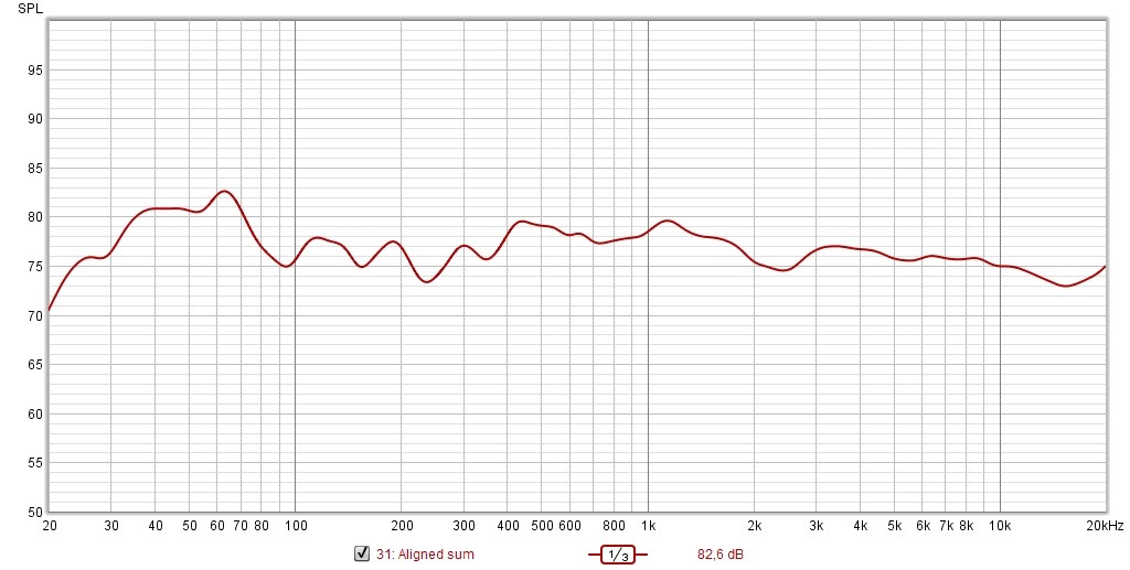

Hi Folks !
I've ended the first version of my speaker.
Second step will consist in designing and adding a port to transform in a BR !

Yop,What box size and turning freq did you used for that box?
If you used MW16TX-4 ofc.
It's a 24liter box tuned at 40hz.
Digital XO
Tweeter XO LR24@2300hz.
Beware of the port diameter and it's length, mine have a nice half wavelength pipe resonance. Fortunately inaudible at listening position and on-axis.
I use this bookshelf half time as is, only with a HP_but36@30hz.
The other half time with a sub, xo LR24@80hz.
Oh, and with 1 or 2 EQs for room correction.
The result is quite impressive at listening position

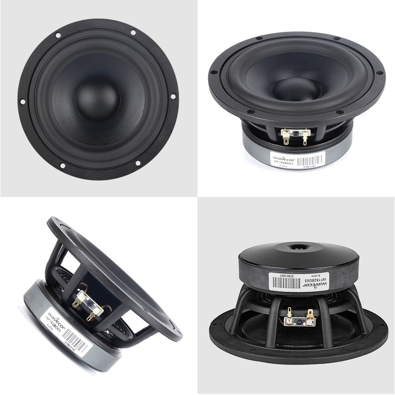

在我看来,Perlisten 的司机来自 Seas。低音扬声器上看起来像一个 Seas 篮子,高音/中音扬声器上的小方形面板与 Seas 的一些前面板相匹配。
Peerless 确实有方形框架高音扬声器,但低音扬声器篮看起来不像,我记忆中只有 Seas 有。
贴纸与 Seas 不匹配,但很可能符合 Perlisten 的意愿。
It may be a wavecor Chinese OEM.
