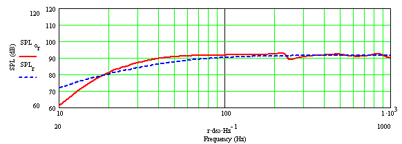

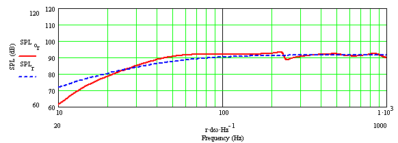

How do you mean 'better'? (genuine question here BTW -no umbridge taken.
) I assume you mean FR shape or extension, or similar, right?
Just to explain the above slightly: the FR is shaped to be in step with room-gain. You typically get about 12db of that (assuming the room is big enough to support it) below about 50Hz, which makes us flat 92db 1/w 1/m sensitivity to the indicated 1/2 space F10 in the graph, plus coupled to a far larger quantity of air than a small-vent or sealed box, so it'll sound somewhat 'bigger'.
In room final cut-off, again, assuming you've a big space, will probably be around 10Hz.
The 19Hz is deliberate: it's ~0.707Fs, which is as far below Fs as I'm willing to tune. It's not really an issue with these drivers, but it's a personal rule that I stick to. I also wanted to keep excursion way down -shorter the travel, the more linear the performance. I reckon people worry a bit too much about this to be honest when it comes to sub-bass, but if it's possible to achieve it within the other design parameters, it's worth doing.
