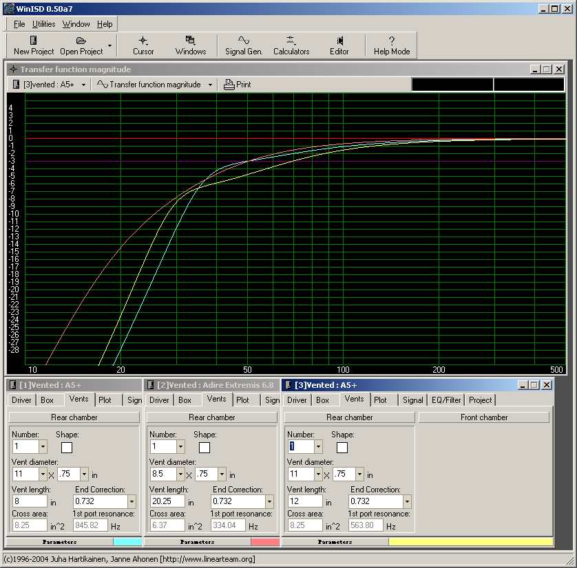

This thread seems inactive for a while, but I hope I can get some help. I am about to build the shadow as a full range multi driver system.
I am not using the Extremis, but 4 HiVi A5+ drivers. What I need to know is how do I model the enclosure?
In an earlier post I believe I read that I should treat it as a ported enclosure. OK, using WinISD I modeled two Adire Extremis 6.8 as though it were a ported enclosure. The WINIsd plot shows that in pink. I did two models of the HiVi A5+, the blue is tuned to ~40hz, the yellow is tuned to 34.2Hz. Since I do not know the impact of the flare on the response I have no way to know which would be better.

aceinc said:I am about to build the shadow as a full range multi driver system.
Paul,
I did get your private mail...
it is a crapshoot as to whether your drivers will work in the Shadow as it stands. It could well work in a Shadow-like BVR. I leave the sims to Scott... i'm sure he will check in.
