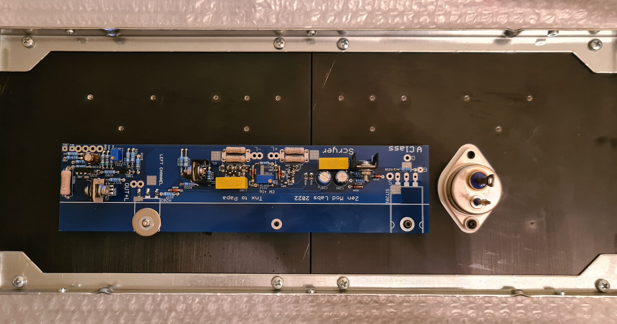

Looking at the amp board and aluminum T-bar mounting position, about 1/3 of the 2SK2087 hangs off the T-bar. Doesn't seem to be an ideal mounting method.
no problem if you mount OS parts (and pcb) directly on heatsink
no problem even if you use L or T bar - mount them in same fashion as mounting directly on heatsink - first OS part then pcb then washer then split washer then screw
.........which means that I'm going to abandon in future arrangement of having L(T) bar in sandwich between OS part and pcb - eases layering of top copper
N.B. even if half of it hanging free, if you have half back tab connected to heatsink, 2SK2087C will be happy with just 40W or so of heat, back pad is that big
