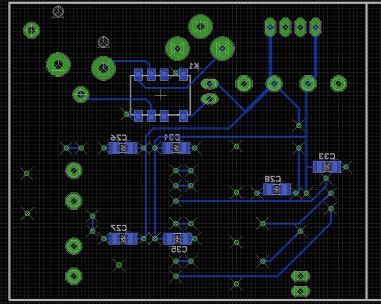

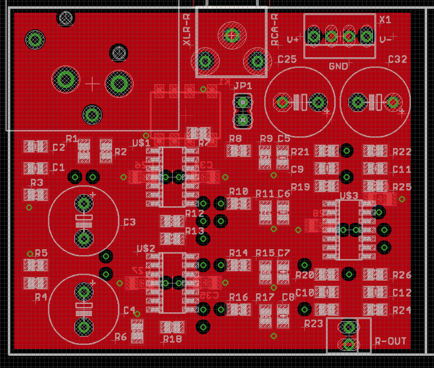

Thanks Toni. Actually, I had found that shifting it to the left of R1 made routing a lot easier. Here's a snip of the bottom layer of the board (right channel) showing the relay K1.
(I need to add + pin identification on the bottom of the board for the pol caps - a tip I learnt from Mark.)

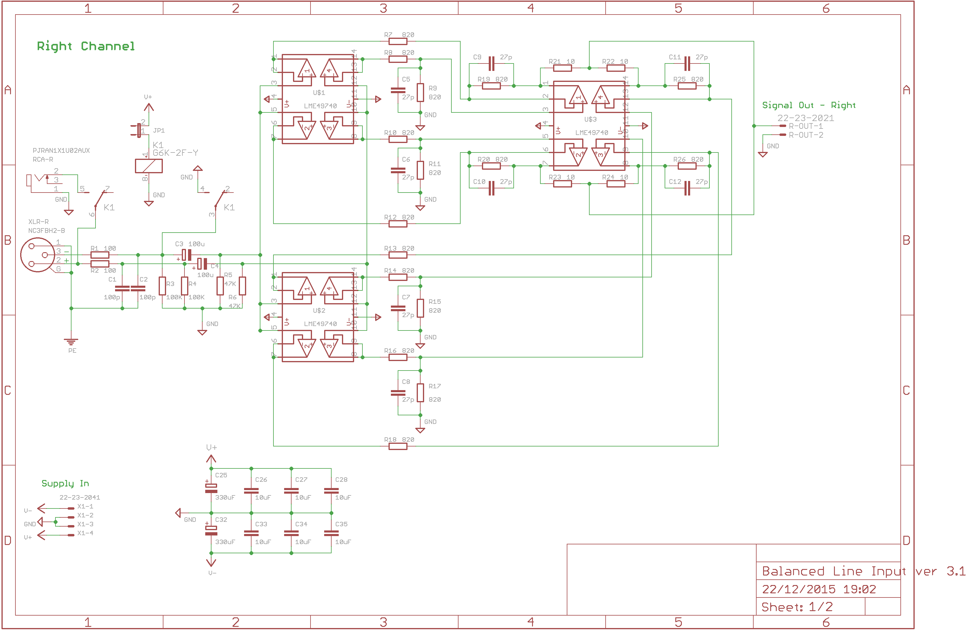

Actually between R1 and C3 is better. Change made and changes to left channel implemented as well.
View of ground planes. I set Width=10mil and Isolate=24mil. 24mil looks like a lot but this calculator tosses or 25.4mil for 12V...

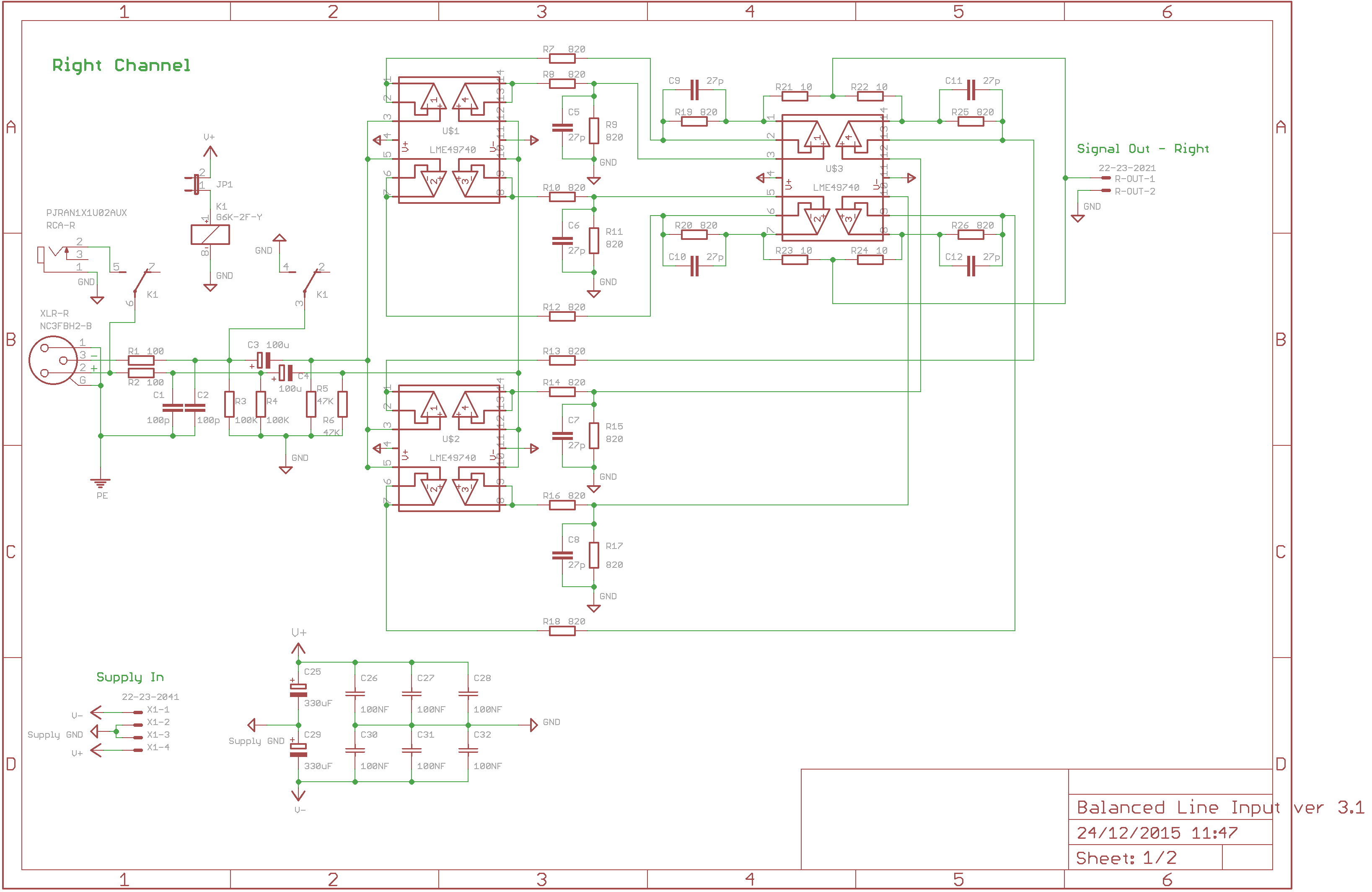

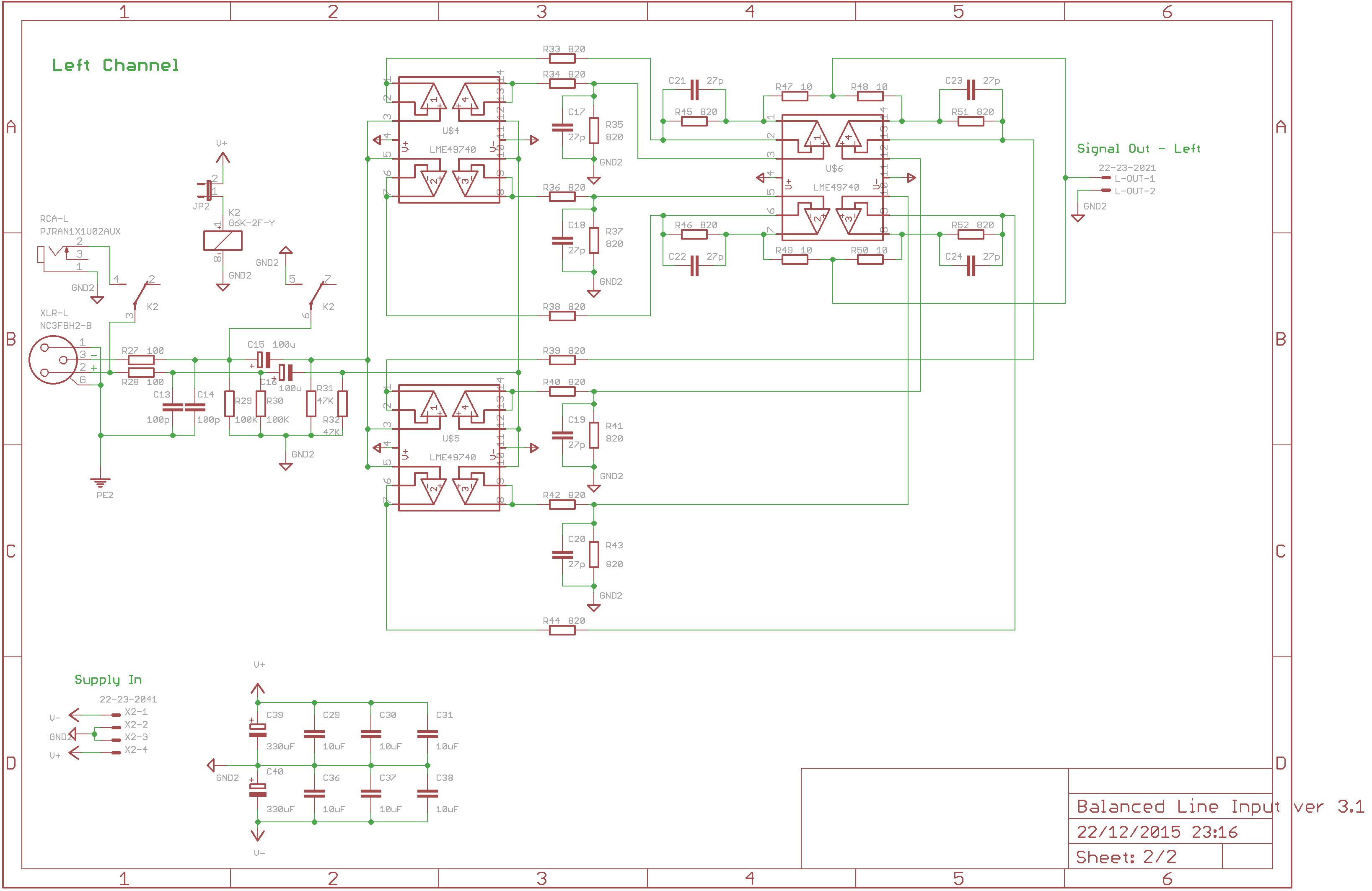

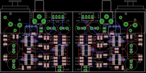

Images of latest circuit and full board (ground planes not displayed) attached also. (Board remains 120 x 50mm.)
I will double-check the connector footprints and everything else tomorrow.
Thanks for the help guys!

Toni suggested I isolate the supply reservoir caps' ground from the rest of the circuit, i.e. route these back to a segregated 'supply ground'. He also suggested changing the bypass caps to 100n from 10uF. Revised circuit and BoM attached.
I'm tempted to send this version to the board house for production while I am away for the next 10 days.

FWIW pcbway won't do a v-score less than 75mm. Their audit software also picks up on the fact that either side of the v-score isn't identical and labels it as two separate designs in a panel with a premium cost. I'm not going to add a v-score. I will just try to mark the centre of the PCB to provide guidance for anyone wanting to cut them in two (with Dremel, table saw or otherwise), hopefully in a manner which doesn't designate the PCB as two designs rather than one.
I'm also going to make a couple of changes. Having read a lot of Self's Small Signal Audio Design while holidaying in Florida over Christmas and New Year, I am going to change the 100nF bypass caps to be across the +/- rails rather than to ground. According to Self, the 4562 isn't fussy about decoupling and 100nF across the rails close to the package should ensure HF stability. He also makes that point that connections to ground risk coupling ground noise into the circuit. It will also save me 6 caps.
Secondly, I am going to try to fit bigger 12.5mm diameter caps for C3, C4 (and their equivalents on the other channel). A larger than 100u cap should reduce distortion below 100Hz or so.
Hi. Self adds these for HF stability reasons. Do you really think they can be omitted from the design?
EMI, RFI ...

Don't do it. See datasheet of LM4562: the evaluation circuit also has a 100nF bypass from +V to GND and a 100nF bypass from -V to GND.
BR, Toni

Re the supply bypassing, the source of my suggested change was the text in Self's Small Signal Audio Design 2nd ed on pages 145 (last paragraph) and 149. The first is in a discussion of the NE5532/4 op amp while the second is in a discussion of the LM4562.
The essential requirement is that the +ve and -ve rails should be decoupled with a 100nF capacitor between them, at a distance of not more than a few millimetres from the op amp; normally one such capacitor is fitted per package as close to it as possible. It is not necessary, and often not desirable to have two capacitors going to ground; every capacitor between a supply rail and ground carries the risk of injecting rail noise into the ground.
(sic)It is not fussy about decoupling, and as with the 5532, 100nF across the supply rails close to the package should ensure HF stability.

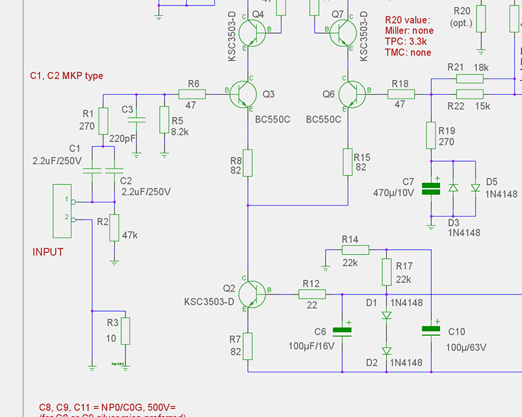

I've been trying to think about current need of this little board. Quiescent (no signal) is relatively easy (I think) at 18.5-20mA per LME49740. Let's call it c60mA per channel to accommodate some leakage in the supply caps etc. But I am unsure of myself when I begin to try to estimate current need with signal added despite the fact that it is elementary topic. My presumption is that I need to make an assumption about peak line levels on the input (from my pre-amplifier) and need to know the input impedance of the IPS/VAS that this line receiver is driving. Toni, do you have the latter for your SA2014? Is it basically just the parallel resistance 47k || 8.2k or am I making a stupid mistake with all this? (Schematic excerpt attached.)
... and need to know the input impedance of the IPS/VAS that this line receiver is driving. Toni, do you have the latter for your SA2014? Is it basically just the parallel resistance 47k || 8.2k or am I making a stupid mistake with all this? (Schematic excerpt attached.)
Input impedance is mostly 47k || (8.2k+270). SA2014 likes to see a line buffer with low output impedance. Your balanced to SE circuit fulfills this need - you can expect best performance with this combination.
To drive the SA2014 to the maximum output power you need an input signal with 1.4 Vrms.

Stupid question:
You're using a fancy low-noise balanced input stage only to drive a single-ended input employing a differential input stage. Why? The amplifier input might as well be modified to be balanced instead - at which point a mere buffer at the input may well get the job done. (You might be able to tell I've been reading Putzeys a lot lately. )
Polarized input coupling caps (between pull-down resistors no less)? Srsly? While this may well work for a while, you're giving the poor dielectric layer no chance to regenerate, and the poor things would eventually end up becoming rather leaky (with the specifics depending on cap quality, basic leakage and sheer luck of the draw). Better go for 22-47 µF bipolars instead, plenty big enough still. Either those or low-leakage types.
Your unbalanced input is fundamentally flawed. Or rather, having it on a device having its signal ground tied to PE is. Inputs like that rely on classic "GND think". Thou shall not have more than one ground potential. Connect to earth at one point, and keep the entire rest of the setup floating. The entire rest. Add just one device that is built as Class I or likes to develop a substantial voltage vs. earth potential (SMPS' in TVs come to mind), one safety earthed CATV or antenna connection, one shielded network cable that's carrying earth potential from somewhere, and you're screwed - there's your ground loop. In that sense, consumer and pro audio are fundamentally incompatible (and consumer audio is just broken these days).
Putzeys suggests one way of implementing an unbalanced input in his "Dealing with legacy pin-1 problems" article. I would add a ground lift switch to that, just in case the source's common mode potential likes to drift way off (at that point a transformer is the best option anyway). You may also decide not to add the unbalanced input at all and make proper adapter cables instead, complete with impedance balancing (Bill Whitlock has written a lot on the subject, Putzeys also describes a version though the RC for the cable shield may be better off being connected on the transmitting end).
BTW, having a super-low-noise input is all good and well, but have you looked at the output noise of your preamp, and how far down you are likely to ever get it? If the balanced output likes to double the level (as it often does), have you considered going for an input gain of -6 dB?
Same story as the O2 headphone amp's input stage. I'd be pretty hard-pressed to name any source that got anywhere near its noise levels. At the same time, the poor little NJM2068 may break a bit of a sweat when confronted with high input levels due to feedback network impedance, depending on gain setting.

Lots of points here. Let me respond quickly to a few of them now and perhaps more in the morning. It's late and I didn't get any sleep last night courtesy of a red-eye transatlantic flight with a very young baby (one that is now struggling to adjust to a return to UK timezone).
I don't get to modify the amplifier - I'm using Toni's existing and superb "SA2014" design with his boards. Having read Self, whose design this is (well, the balanced side at least to which I have tried to integrate his guidance re unbalanced line inputs) it seems "a mere buffer" would have a noise level substantially worse than an unbalanced connection and it was this which provided the motivation for his design - to lower the noise of the balanced input buffer to at least equal that of an unbalanced connection.
The input coupling caps are not polarised. I've just used a stock Eagle part in the schematic and board. There will be no + marking on the board. The caps to be used are UEP1V471MHD bipolar 35V 470u. (The BoM I posted listed the smaller 100uF ones, but the decision was made to provide for the larger caps.)
Signal GND is not tied to PE. The only connection to PE via XLR pin 1 is the initial RF filter, the idea being to not pollute signal ground with any RF noise. (The GND of the supply caps returns to the supply. All other connections are to an isolated Signal Ground.)
As you will have noted from earlier posts, I am personally less concerned with single-ended input but added it anyway for 'flexibility'. Hence, I am not concerned about the volume difference that will exist from the two inputs. I don't expect (nor expect anyone else that might decide to use it) to bounce between inputs and so find the relative volume levels annoying. So I did not worry about a typology where balanced signals had a gain of -6dB while unbalanced signals had unity gain and stuck with unity gain for both. It made integrating the unbalanced signal much easier. Of course it could be changed so that the unbalanced connection skirts the low noise unity gain balanced input buffer (which in turn could be altered for -6dB gain) but, as said, I wasn't fussed about the relative volume issue. The unbalanced signal with RF filtering components etc could then connect directly at the output connector or have its own fancy low noise input buffer. When not concerned about relative gain it made sense to use the typology shown here. Perhaps there is a typology that readily integrates Self's low noise balanced input buffer (see Fig 18.28 is Small Signal Audio Design 2nd ed) with different gain structures for each signal type (see Fig 18.10) but it didn't seem to me to be worth pursuing.
My preamplifier specs list THD +N @ 1kHz as less than 0.0006% at all output levels. But, regardless, the idea was to build an exceedingly good balanced input for use with Toni's amp.
