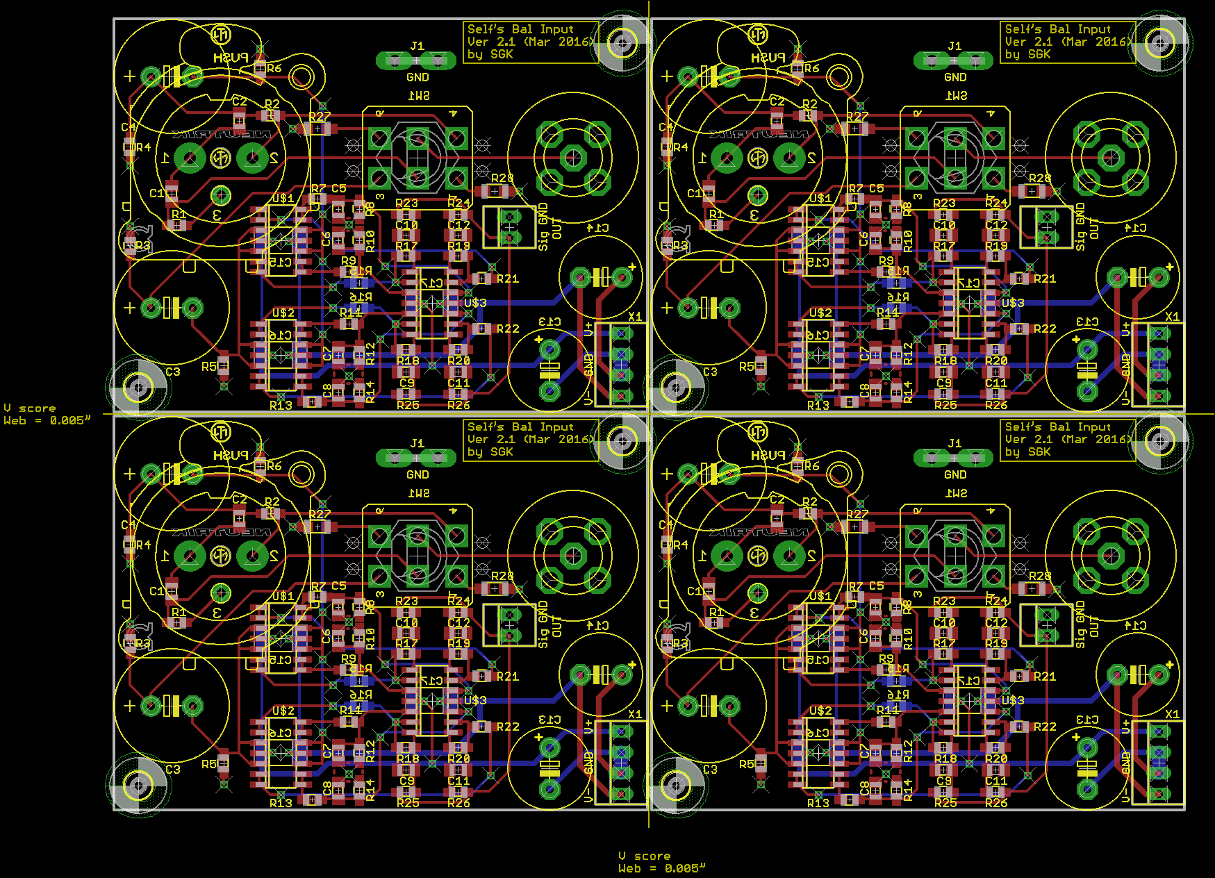

Hi SGK,
I have a question. Is it a strict requirement to have all the input connectors to go straight into the board? Wouldn't it be much easier to make a really small 100% symmetric PCB layout with in and out using molex connectors? The balanced schematic and the use of quad op-amps easily allow this. And then just use short wires to the XLR/RCA sockets and the switch? You can make the board so small that it will easily fit in between or anywhere near the XLR/RCA connectors if mounting it on the back panel is a requirement. Also, I would try to minimize the bottom layer traces length around the op-amps not to cut the GND plane too much (I hope I've got it right and GND plane is on the bottom layer). I also see that your power traces are of variable width which seems to be a bit arbitrary.

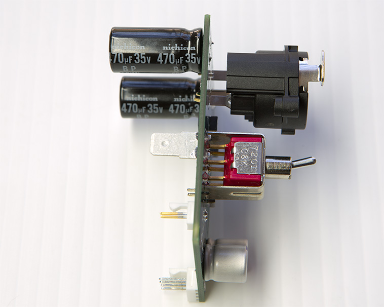

Hi Oleg.
Yes it was the idea from the beginning to have a board which sat behind the connectors and avoided the need to wire from connector to board. Not that it stops anyone from doing so. All in all it becomes very space efficient. It also means there is a convenient place to mount the toggle switch. The board is 48mm x 65mm and sits 24 mm back from the rear panel of the enclosure - the depth of both the XLR and RCA connectors.
It's a four layer board with the two inner layers ground planes.
On the power traces, I just made the ones which feed more than one final destination a little wider than the rest (24 mil vs 12 mil). I recognise this was probably a bit misguided but it likely has no cost. I can probably still change them.

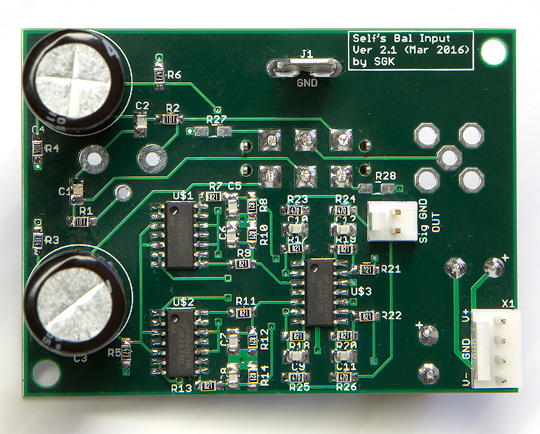

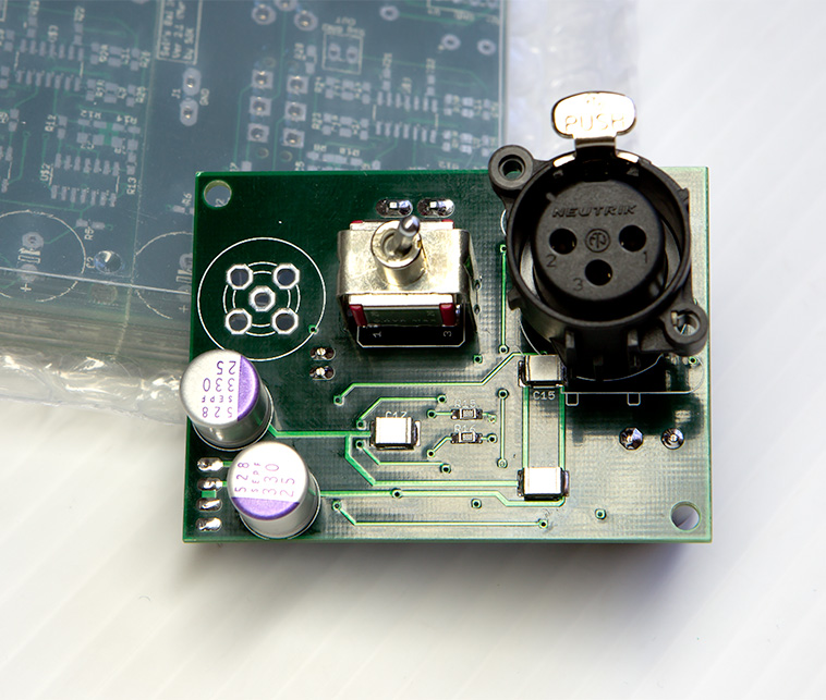

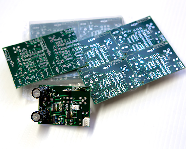

Some pics (unfortunately without the RCA connector). Wave footprints made the soldering easy, although at high mag it looks like I used too much solder. Testing to come.
Very nice boards - congratulations!

Yes you're right, the input filter goes back to the enclosure.
How does the PCB mounted plastic XLR socket connect to enclosure?
Hi. The NC3FAV1 (link to Neutrik website in post 94) has pin 1 connected to a "pin" in the shell which presses against the chassis when mounted. Here is the photo of the NC3FAV1 connector pictured in the link above. You can see this pin if you look at the bottom right screw socket. From the link above "grounding: mating connector shell to pin1 and front panel". It is why I selected this part.
