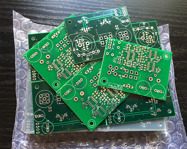

Very nice boards - congratulations!

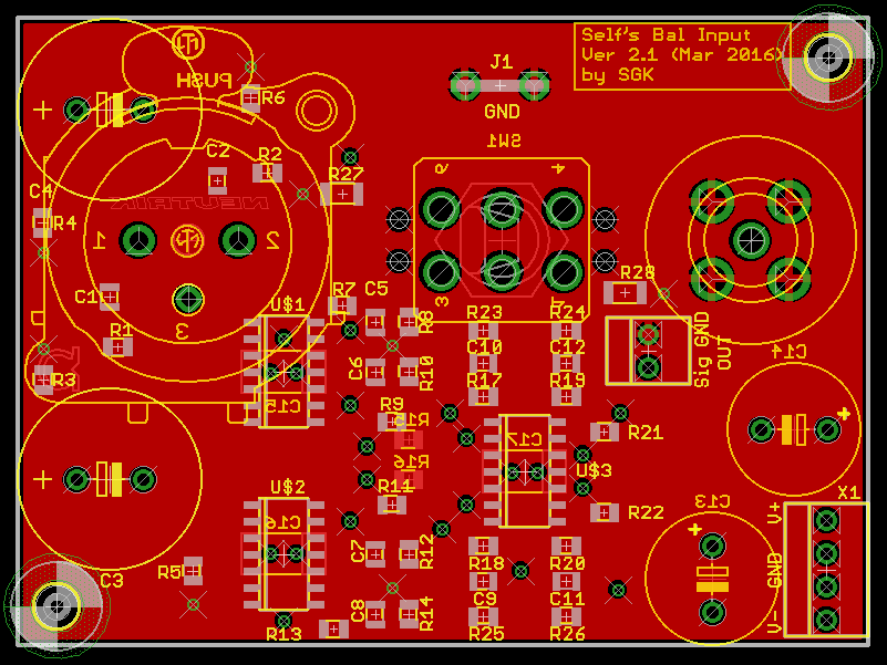

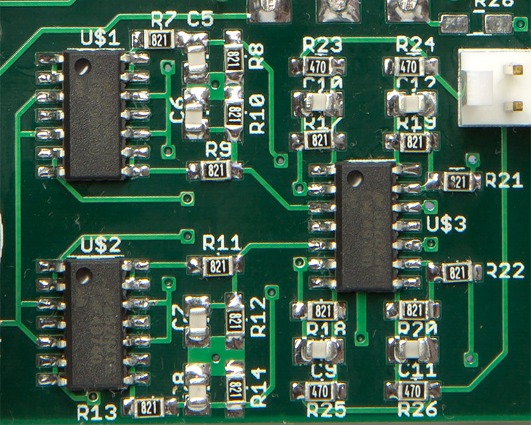

Thanks. I made a couple of silly mistakes with the silkscreen but I don't think it's the end of the world. Just disappointing. I hope the board tests ok!
Fellow DIYer astx (Toni) has been kind enough to conduct some testing of the board.

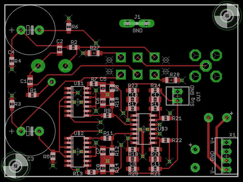

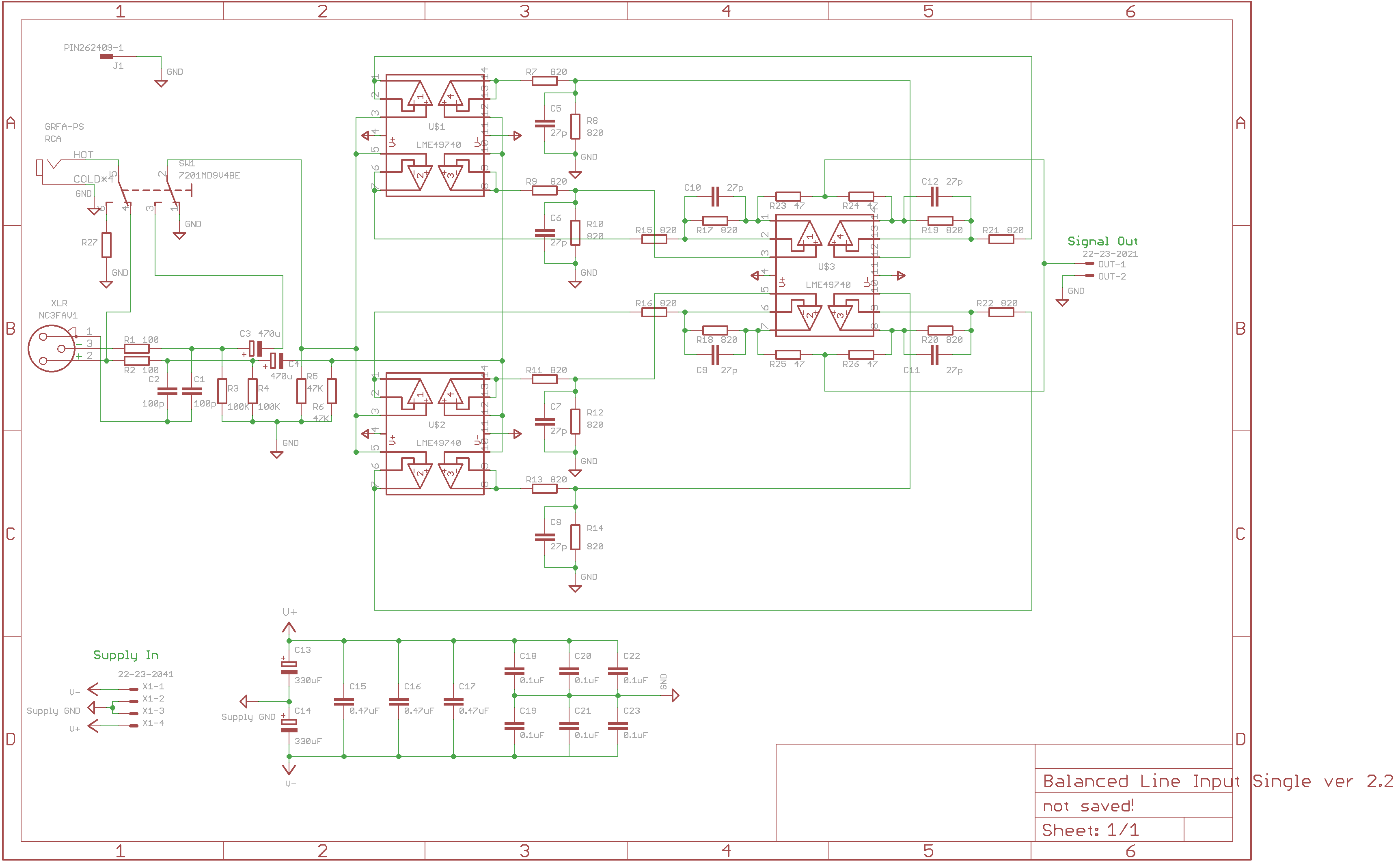

The first finding was that my supply bypassing with 0.1uF from rail to rail was insufficient. I have amended the board to accommodate 0.1uF from each rail to signal ground. I've left provision for caps from rail to rail as well. I should have made the board more flexible in the first place.

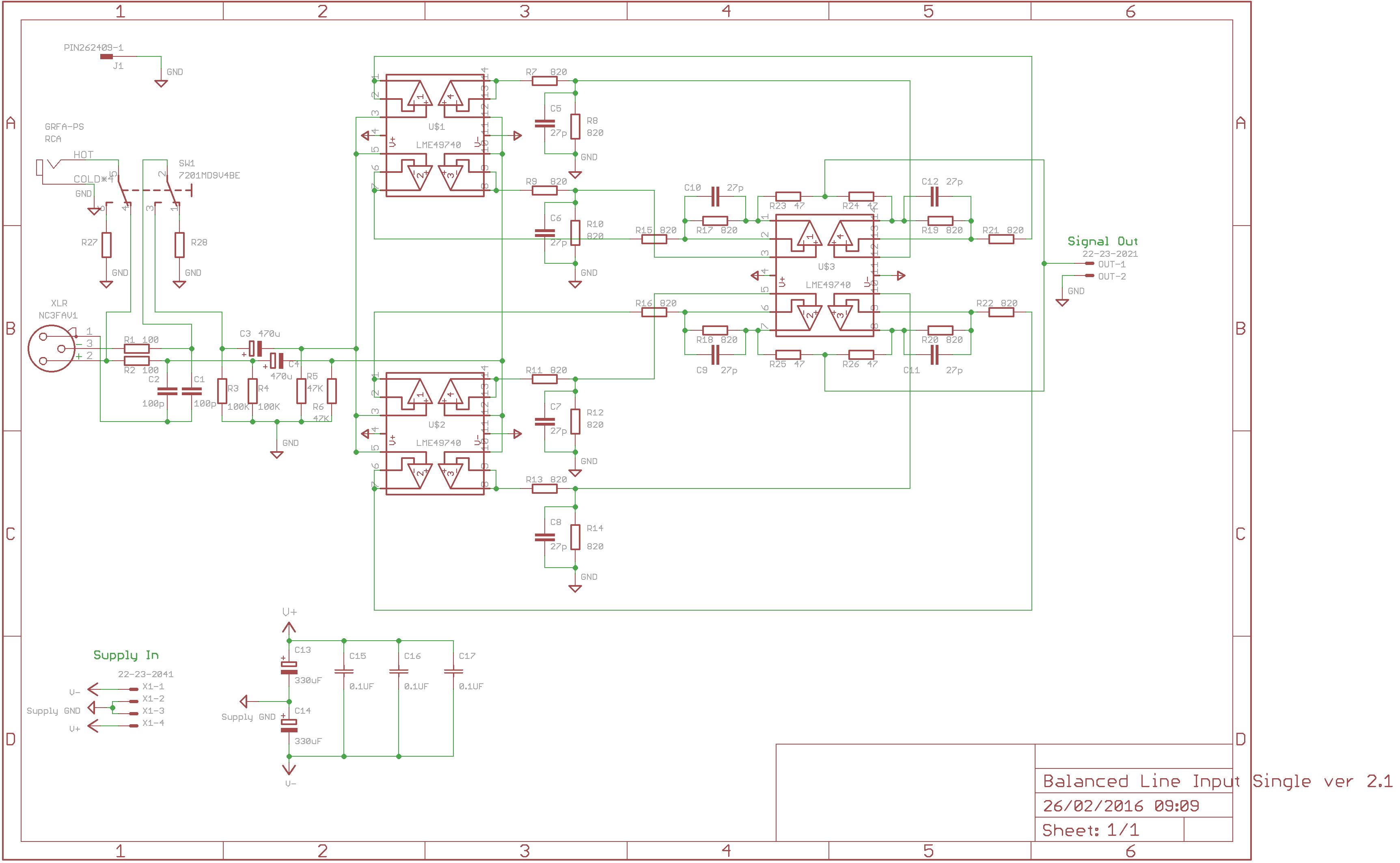

The second issue identified is an interesting one. I have attached the schematic for the board that went to fabrication below (first pic). While testing single-ended input, Toni found that it was necessary to ground the path to pins 4 and 5 of U$1 and U$2 (I will from now on call this the "pin 3 path") on the right side of C3. The board, as fabricated, has provision to ground the pin 3 path by jumpering R28 but only on the left side of C3. Toni measured -110dB A-weighted referred to 4V RMS if the grounding occurred on the left side of C3 (by jumpering R28) but -130dB (his measurement limit) if he grounded the pin 3 path on the right side of C3. Note that a grounding of the pin 3 path is tantamount to connecting the single-ended "cold" to pins 4 and 5 - the connection is via the ground plane.
It's interesting to step back a little at this point and reflect on Bruno Putzey's two articles: The G Word, or How to Get Your Audio Off the Ground and section 4.5 of Dealing With Legacy Pin 1 Problems. In the former he stresses that a balanced input need not have symmetrical pin 2 and 3 signals - one can be static or constant, even at 0V. In the second article he deals with connecting single-ended sources into a balanced input.
Bruno's articles would suggest the better way to connect single-ended cold (single-ended hot is connected to pin 2 as outlined in his article) is to pin 3 and potentially with an RC filter to the chassis. Also a trace could used rather than the signal ground plane.
I find it puzzling that the two scenarios measure rather differently. The + single-ended signal is going through the full pin 2 path. Toni also found he needed to add connect single-ended cold not just to xlr pin 3 but also to signal ground via a 10R resistor. Yet I believe Bruno intends that the input be floating.
I'd be interested in anyone's thoughts on all this. Toni please correct or add to my summary of the testing.

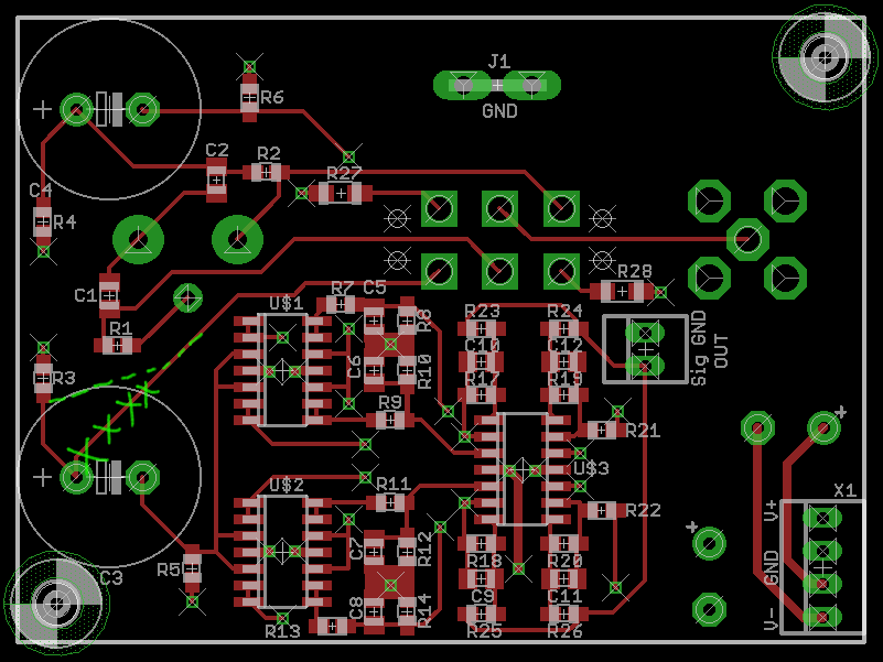

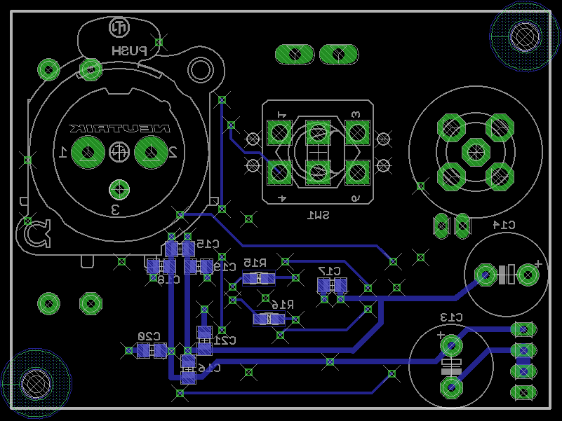

I have amended the board to correct the bypassing, fix the orientation of the toggle switch and shift the break in the pin 3 path to the right side of C3. The other thing Toni suggested was adding provision for a voltage divider at the output for more flexibility - either merely to add a minimum load or to add attenuation. Images attached.
Essentially a differential input is a floating input. Nothing more, nothing less. The only reason why one should consider including an RC combination is to keep the signal within the common mode range of the input circuit (remember that the source may be floating) and to keep RFI that’s been picked up by the RCA cable out of the box.
Note: my measurement equipment and/or setup may give not so good noise figures if RCA cold is connected on left side of C3...

Sounds like C3 is managing to introduce 20 dB of A-weighted noise all by itself. That's surprising.Toni measured -110dB A-weighted referred to 4V RMS if the grounding occurred on the left side of C3 (by jumpering R28) but -130dB (his measurement limit) if he grounded the pin 3 path on the right side of C3.
Also sounds like you expect to measure -110dB on the unmodified unit when you insert a shorting plug into the XLR socket. Then with the shorting plug in place, you expect to measure -130dB when you short the two terminals of C3 together. (Left terminal is already ground thanks to the shorting plug).

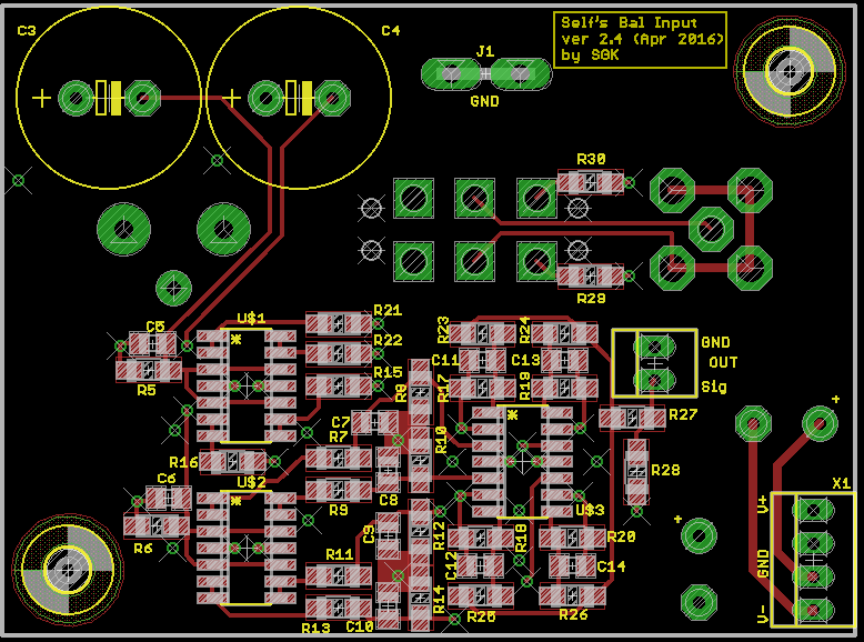

The pos. inputs of the lme49740 are ultra sensitive. I've added 22p parallel to R5 and R6 and the distortion and noise figure betters significant. Maybe a loop on pcb due to the 2 ground layers and/or lme49740 needs some caps directly at inputs to supress oscillation and avoid rf noise?

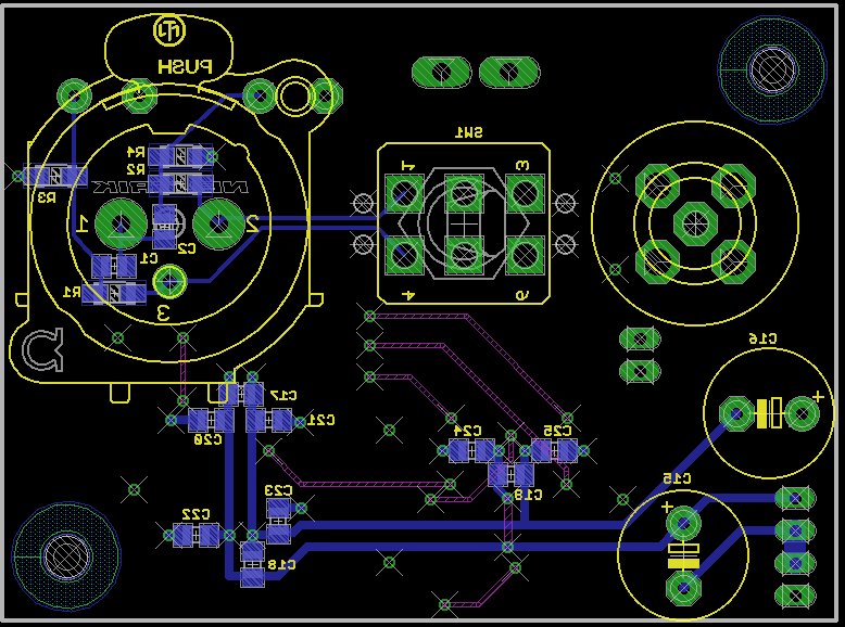

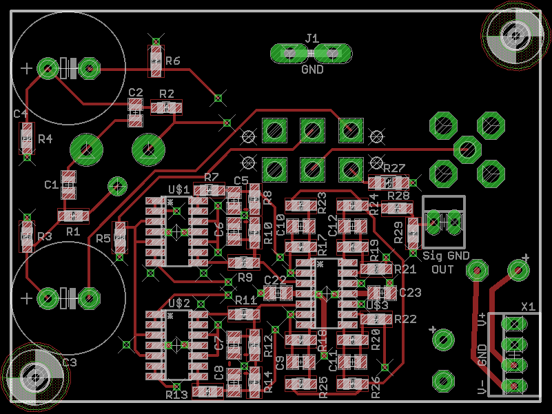

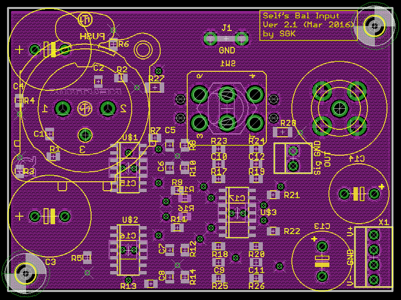

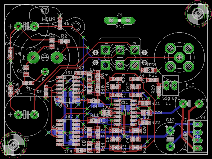

Revised version. Better decoupling, better routing, larger resistors etc. Layer 2 used for routing also. Only one ground plane. Will be sent to ASTX Labs for testing shortly!
Very nice - looking really good. Can't wait for testing ...
