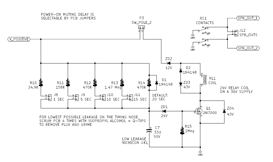

I have a solution for the Mosfet, but now I need one for the 1.47 Meg ohm (1%) 0.25W resistor.
Would this SM chip resistor work as a solution?
https://www.digikey.com/en/products/detail/yageo/RC1206FR-071M47L/728439
Changing PSFILT resistor R13, from 1.47 Meg to 1.50 Meg, will only make a tiny change to the timing of the 15 second turn-on-delay setting. I doubt anyone would notice any difference. And I suspect that very few people have chosen a delay of 15 seconds; who has that much patience?
Incidentally, on the day I ordered parts for the prototype build, Mouser had 1.47 Meg in stock but was sold out of 1.5 Meg resistors. It's an ever changing merry go round.

Thanks for the response Mark on the clarity of the affect with the substitution of the hard to come by and now elusive 1.47M ohm resistor.
Now I can complete my order and work towards finishing this Vfet project.
