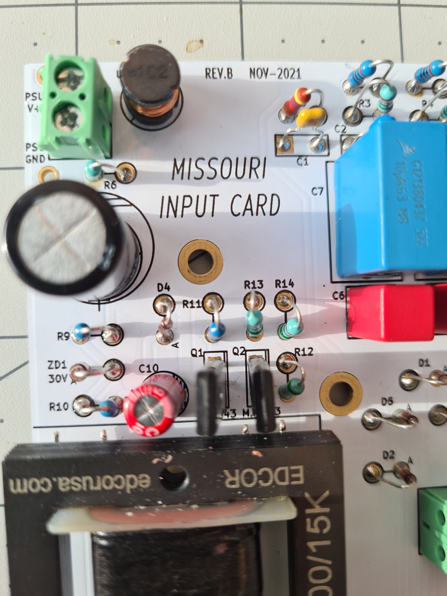

Hi Mark, would you mind helping me troubleshoot one of my Missouri boards?
Through switching between different combinations of L & R channels for output stage and the Missouri I've narrowed it down to the Left Missouri board. The sound out of it is really very quiet, bass particularly so if that makes a difference.
I've reflowed all solder joints, checked that the components on both side are identical and no luck. Do you have any ideas of what it might be / how to check past looking for a dead component?

It's a lot more convenient to measure and diagnose a Front End card when it's out of the amp chassis and sitting on the bench, all by itself, hooked up to a +36V lab power supply. You have access to the bottom side of the board, and you can connect alligator clips or probe tips more easily, without interference from the chassis walls and floor.
The first thing I'd do is carefully remove all ICs from their sockets and inspect the pins of each chip. Sometimes they get inserted wrong and the lead folds under, giving poor contact or no contact. Straighten the pins and triple check the part numbers and the pin-1 indicators, before reinserting them into their sockets. Swapping the chips, or inserting them backwards, is not what you want.
Begin by verifying that the top half of the Missouri schematic is working: measure the voltage between VTOP and GND. I find it easiest to do this if I insert a piece of hookup wire into the "PSU GND" euroblox terminal, and connect my scope GND / DVM blackprobe to that piece of wire.
VTOP is on the flywires (exposed metal, bent leads) of bleeder resistors R13 and R14, if you stuffed the PCB following the silkscreen guidance. Is VTOP somewhere in the neighborhood of 27-29 volts, as it should be?
Integrated circuit U2 pin 7 is supposed to be connected to VTOP so measure the voltage on that pin. Is it correct? U1 pin 8 is supposed to be connected to VTOP so measure the voltage on that pin. Is it correct?
Then verify that U2 pin 4 is at 0.00 volts (GND) as it should be. Verify that U1 pin 4 is at 0.00 volts.
Verify that "VHALF" is indeed half of the VTOP voltage as it should be. Measure VHALF at U1 pin 1 and also at U2 pin 1.
Now connect a signal generator (or phone with a signal generator app) to VIN++ and VIN--. Verify with a scope (alligator clip to PSU GND) that signal appears at U2 pin 3.
Verify that U2 is functioning correctly as a differential-to-single-ended converter. Verify with a scope (alligator clip to PSU GND) that signal appears at U2 pin 6, at the expected amplitude and not teeny tiny rinky dinky.
Verify that U1B is functioning correctly as a unity gain buffer. Does signal appear at U1 pin 7?

I'll run through how I've connected for good orders sake - I have no lab PSU so it's:Begin by verifying that the top half of the Missouri schematic is working: measure the voltage between VTOP and GND. I find it easiest to do this if I insert a piece of hookup wire into the "PSU GND" euroblox terminal, and connect my scope GND / DVM blackprobe to that piece of wire.
Meanwell supply > PSFILT board > PSFILT CH2_V+ > FE PSU_V+
PSFILT CH2_GND > FE PSU GND & hookup wire from here
Just to confirm, I then measure 36 vdc between FE PSU_V+ & FE PSU GND
Between FE PSU GND & VTOP (either of the tops of R13 and R14) I get 0 VDC
It's fair to assume that the problem is in the power supply filter half then as the power isn't going through the circuit?

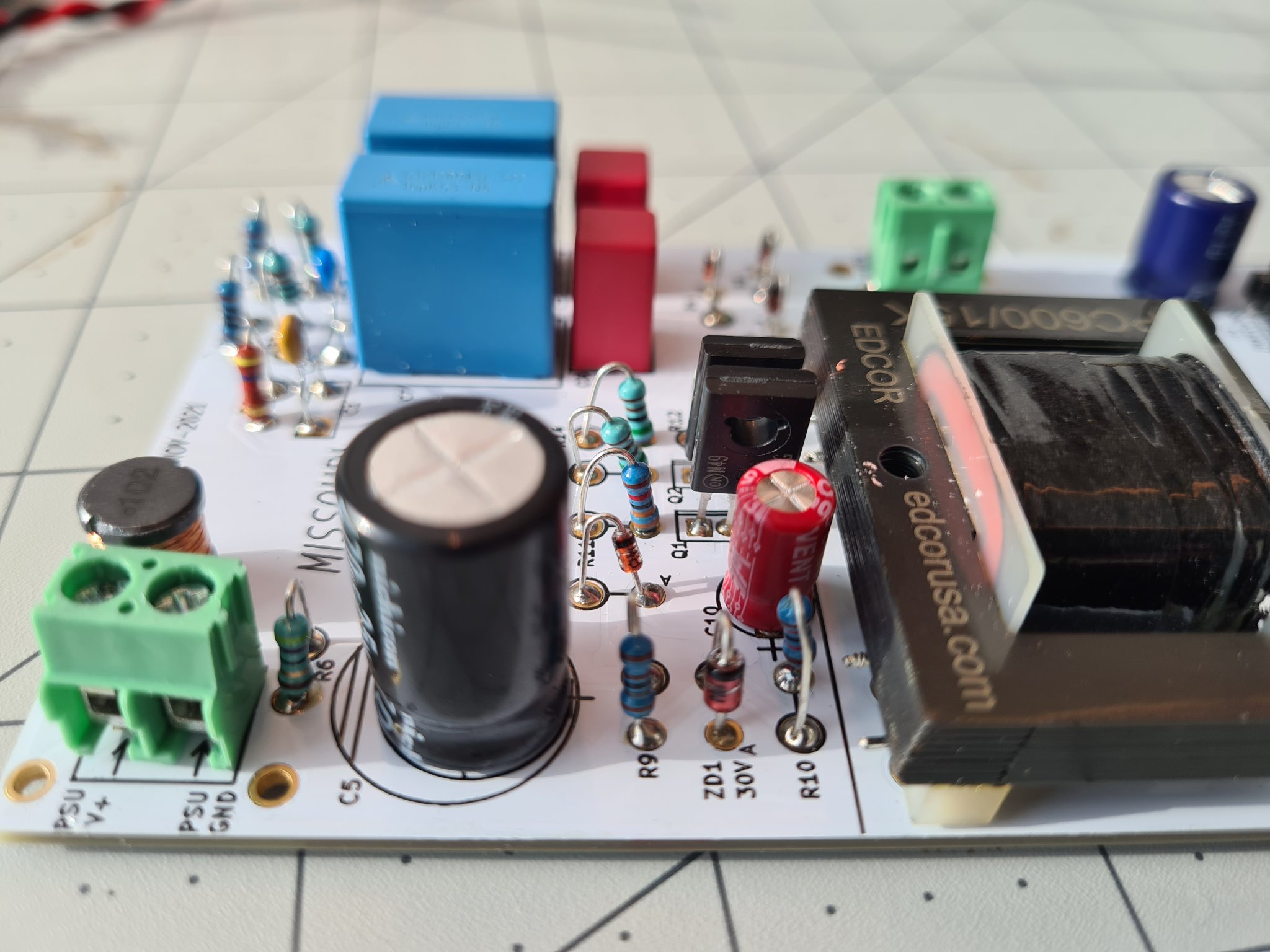

You might have stuffed R13 and R14 backwards (opposite to silkscreen guidance) and since you didn't attach a photo, nobody knows.
Post a clear, close up photo of the top left 1/4th of your failing PCB, showing R6, R9, R10, R11, R12, R13, R14 and the silkscreen words "MISSOURI INPUT CARD".
Then, with voltmeter blackprobe connected to PSU GND, measure and record seven voltage readings. Measure with voltmeter redprobe connected to the flywires of those seven resistors: R6 R9 R10 R11 R12 R13 R14 . These measurements will help you narrow down the investigation and figure out where the original fault might be.
Just to name one example, using one of those voltage measurements: If the voltage on the flywire of R6 is not +36V or thereabouts, that means there's something wrong with either P5 or L1 or R6. {do you see why?} The problem might be incorrect stuffing, bad soldering, failed component, etc. You need the voltage measurement(s) to decide where attention should be focused.
Example 2: If the flywire of R10 is not +30V or thereabouts, that means something's wrong with Zener diode ZD1. {do you see why?} Bad soldering, diode failure, installed backwards, etc. You need the voltage measurement(s) to decide where attention should be focused.

I'm with you and appreciate you showing me how I narrow it down, segment by segment, I would not have known / learnt that otherwise. Photos also attached, I can see how that would help...You might have stuffed R13 and R14 backwards (opposite to silkscreen guidance) and since you didn't attach a photo, nobody knows.

For measurements I get:
R6 - 35.7
R9 - 34.5
R10 - 29.9
R11 - 0
R12 - 29.1
R13 - 0
R14 - 0
So the problem looks like the capacitor at C10 then as it stops the circuit completing at R11 but at R12 it can go around it. When I measure it, it the multimeter does go up, down and everywhere not staying at 47k. Does that seem correct?
