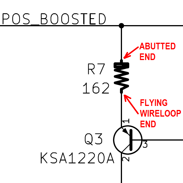

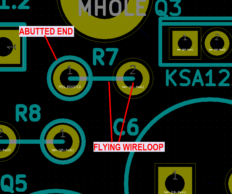

I'm afraid you misinterpreted the silkscreen guidelines, and installed every resistor backwards. See attached images of a different PCB whose name is not Missouri, but whose silkscreen guidelines are the same as the ones on Missouri. It seems that on your board, what I intended to be the flywire is actually the butt, and what I intended to be the butt is actually the flywire. Don't unsolder resistors and flip them; instead, adapt and improvise.

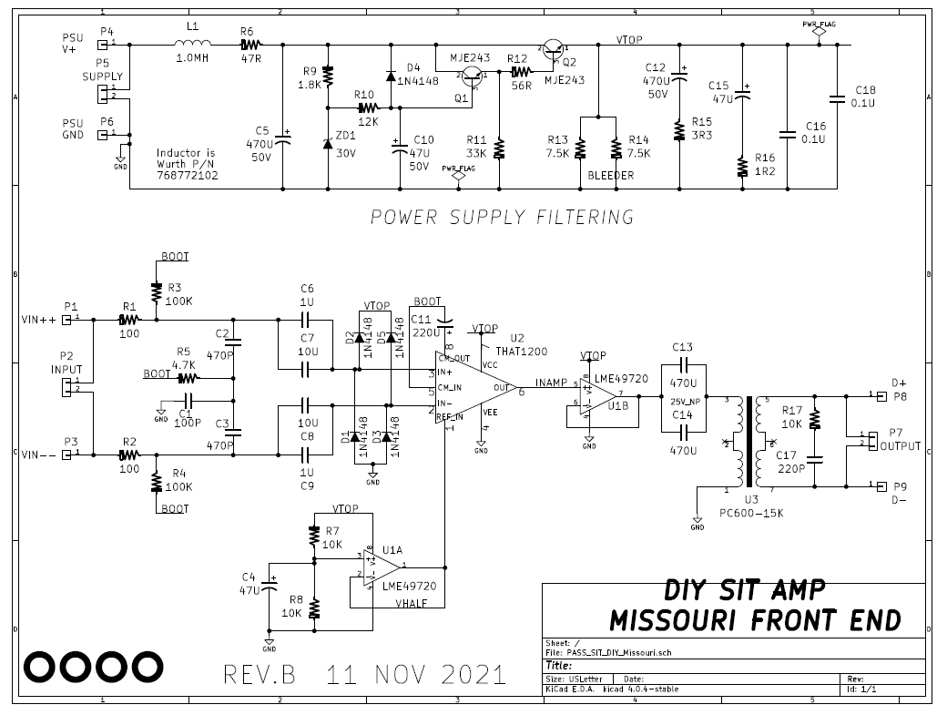

For your PCB it means that R11, R13, and R14's flywires are all connected to GND. That's why you measured 0.0 volts on those resistors' flywires.
But the goal is to see whether the top half of your Missouri is correctly producing the filtered supply voltage called VTOP.
To get an accurate measurement of VTOP, connect voltmeter blackprobe to PSU GND and touch voltmeter redprobe to pin 7 of U2, and then to pin 8 of U1. Both are connected to VTOP and both should measure somewhere in the vicinity of +28 volts. If you installed diodes D2 and D5 in such a way that their CATHODES (band end) are probe-able, those cathodes are also connected to VTOP. Your voltmeter should read somewhere in the vicinity of +28 volts.
edit- For those who might whine about the flywire notation, remember that member @ElliotA built another Missouri board, presumably with all resistors backwards just like this board, and he believes the other Missouri works just fine. As indeed it should: resistors are symmetric components and it makes absolutely no difference electrically, which way they're stuffed and soldered.
The only disadvantage of stuffing the resistors backwards is: now you're going to have more difficulty making measurements, because important probe points on important signals are now going to be buried under the butt of vertical components. But hey, if you never make mistakes and never need to debug or measure your boards, then it doesn't matter whether signals are or aren't probe-able; you'll never probe then anyway! It's your board, build it however you please, and nobody can stop you.

I do then measure circa 28-29v on R11, R13, and R14. Also U1, U2, D2 and D5. Is it fair to say then that from a power perspective the board is behaving OK?
VTOP seems to be working correctly, yes.

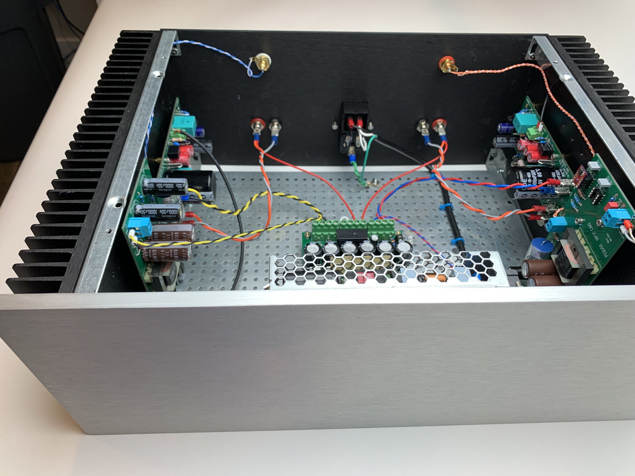

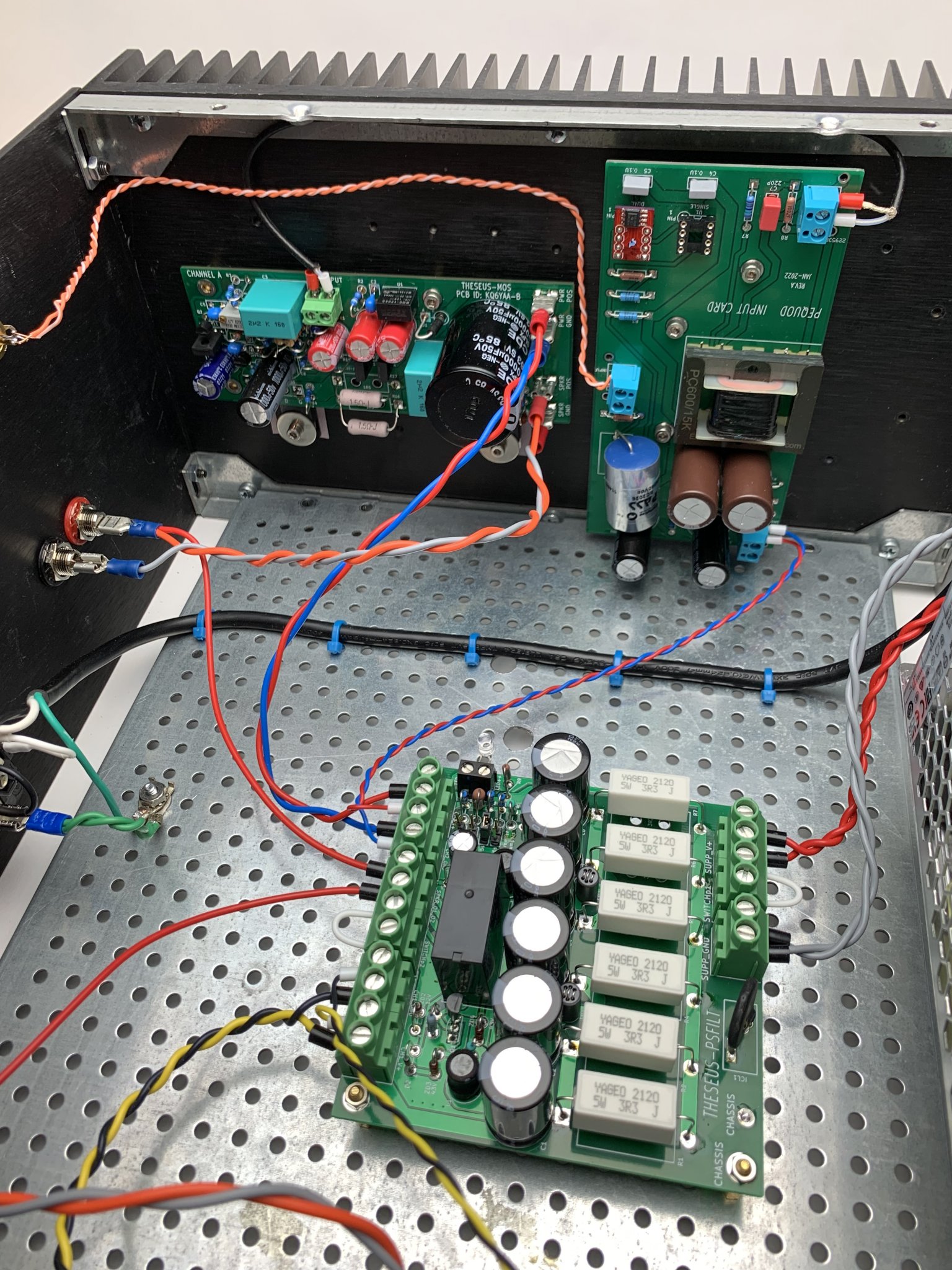

Getting to play with the Theseus MOS output stage, currently driven by the Pequod input stage. Power from an open frame 36V MeanWell filtered by Theseus-PSFILT SMPS filter and power on/off de-thumper.
Although I've only listened so far for a few hours, this sounds truly excellent! I’m very pleased with this project as a whole, the possibilities are almost unlimited for tinkering and trying a large amount of different circuit topologies and other neat things.

A lovely build, congratulations! Quite roomy inside that chassis, even with the PSU on the inside.
The power output stage is nice and compact since there's no thick aluminum T-bar extrusion for TO-3 mounting.
And kudos for using Pass Labs axial film capacitors on the inputs. Much envy, much covet.

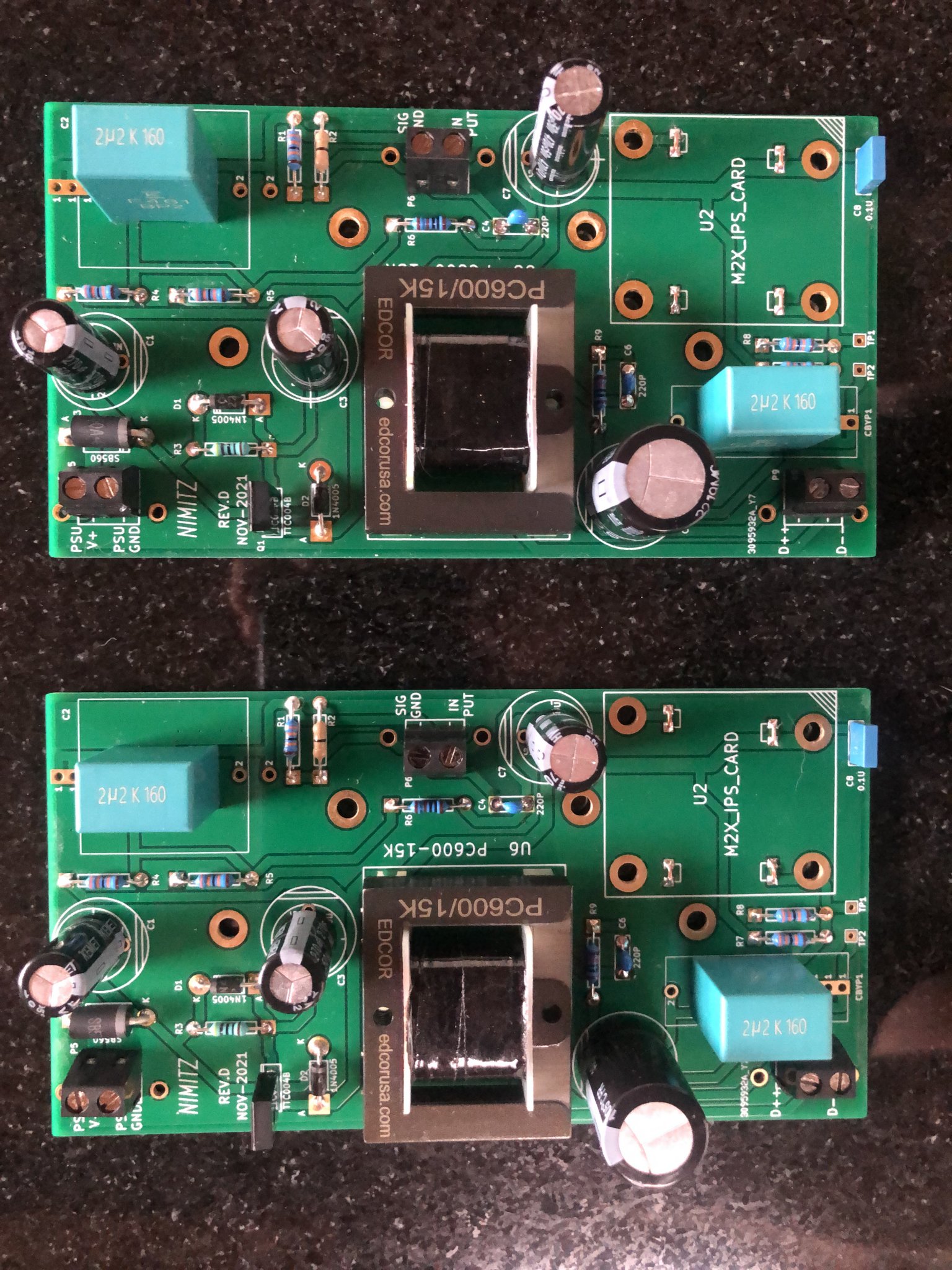

Pics of my Nimitz card build. My plan is to modify my P VFET lottery build with the Tuba filter and the Nimitz FE.
Reasoning is I really like my M2x with Norwood and I want to see how it sounds with the VFET.
Can somebody point me in the direction of how to best test the Nimitz FE card. I am struggling to find something. It needs to work properly before being installed. Thanks,

A general plan of attack when testing and troubleshooting a Front End card for Theseus, is laid out in post #135. Only twenty five posts ago.
If you're worried about your unproven Nimitz destroying your precious Norwood daughterboards, stuff and solder your Tucson boards and use dirt cheap opamps (I suggest TL071 which is plentiful and costs less than $1). Give Nimitz a chance to wreck your Tucson boards -- they are expendable. If it doesn't, leave Tucson in the amplifier for a week or two just in case trouble manifests itself gradually. Finally when you've got plenty of confidence in Nimitz, swap Tucson out and swap Norwood in. Done.
