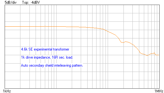

Another configuration on my 300B OPTs is:
P3-SsS-P6-SsS-P3, where again, the "s" layers are meant for series connections and they represent 1R impedance windings, whereas the outer capital ones represent 4R layers. This gives us the freedom to have 4R, 9R and 16R secondary connections with uniform frequency response.

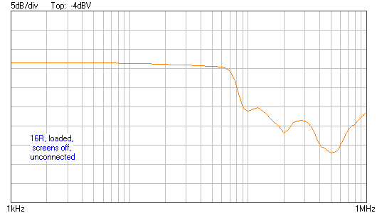

Here you can compare the FR behavior of identical core, interleaving pattern and almost the same primary impedance (4.6k vs 4.9k) of classic secondary pattern vs self-shielding secondary pattern. Note the dip resonance shifting from 90kHz to 190kHz

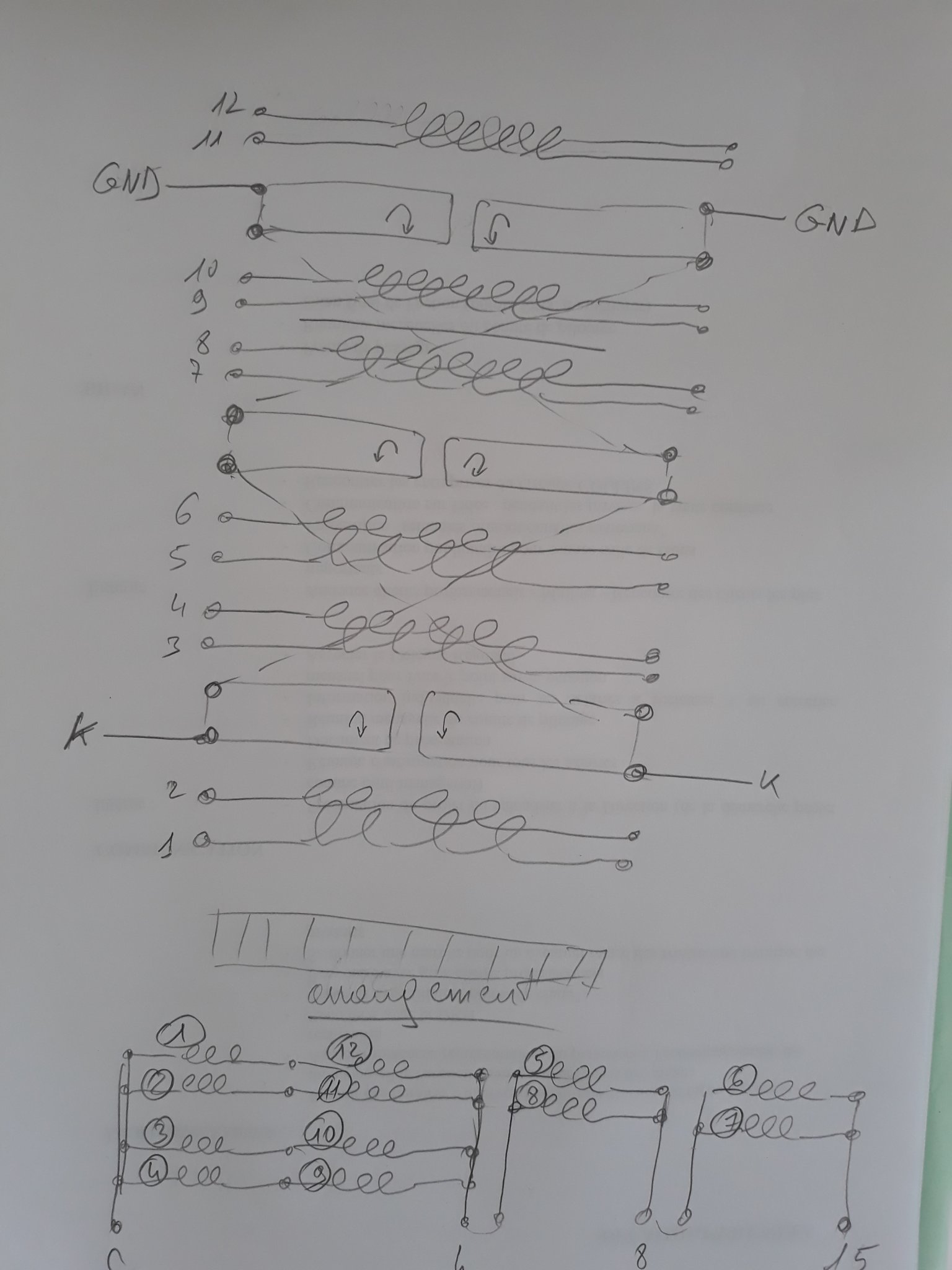

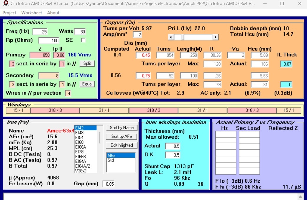

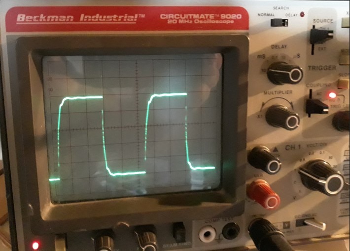

In my last Projet : 6P36C in Circlotron circuit, I use a usual secondary arrangement,
The résults obtained are good but could be improved,
If I understand well, it‘d be better to connect secondary that are winding togather : bi-wiring in my case
In my schematic, in your maner, it 'll be
4 Ohm :1 and 2 in serie // 3 and 4 // 9 and 10 // 11 and 12
Is it a wong way ?
Yan

Hi Yan,
The 10kHz looks pretty fine to me for this OPT.
Your schematic doesn't look to have more than two internal layers and one external layers, so it is not suitable for the self-screening technique.
However, things are looking pretty good. If your primary Anode potentials start at the outer primary regions (1st and 3rd primary packages) and B+ ends at the 2nd primary package, the connections look pretty fine, as the 4R windings are shunting the highest capacitance regions. Then, the series connected 5,6,7,8 layers are located into less "offensive" regions.
Also, a PP OPT is much more forgiving, when it comes to capacitance difference, compared to a SE OPT.
In this case, I'd leave it as it is.

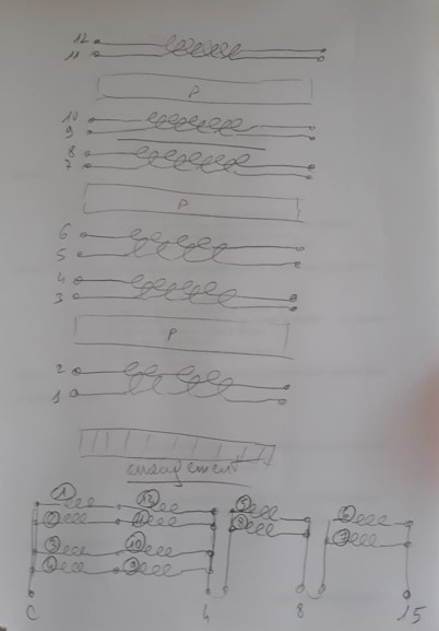

Yes off course.
But firstly, we re talking about secondary arrangement, so i drew shematic which shows secondarys only.
In fact, I used 2 vertical sectionalizing 1 for eatch primary alternately.

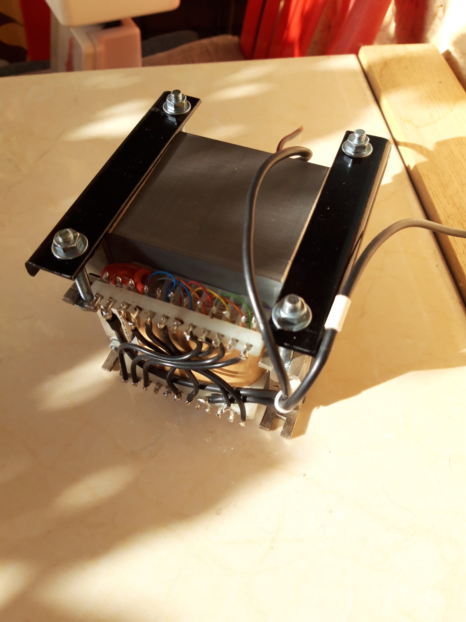

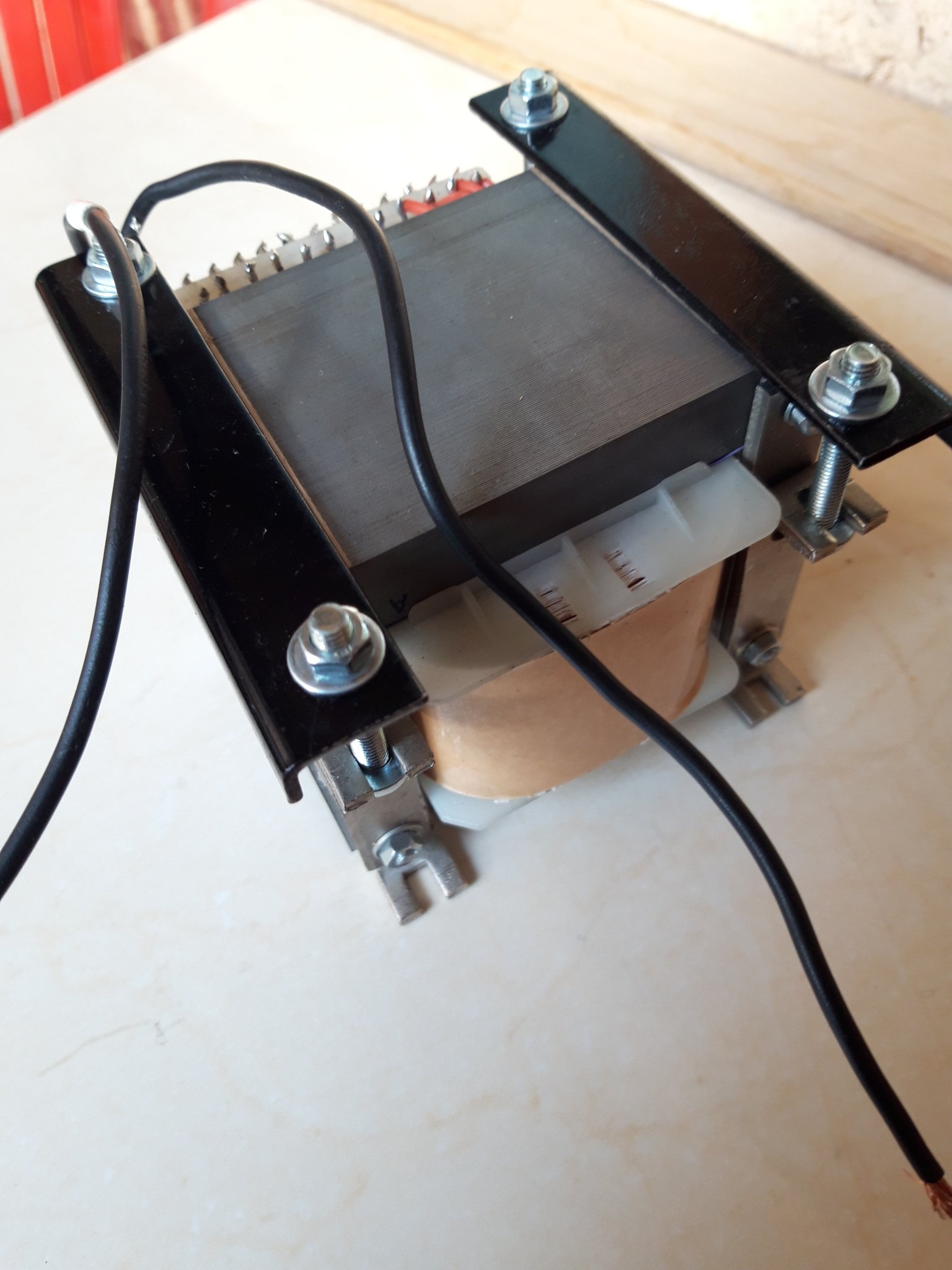

We built an OT for an SE amplifier with OT100 class A2 impedance Z=6.6K/8 ohm 6P+4S plus a KFB winding of 5% and 10%, frequency band at -1dB 15Hz-42 Khz, primary inductance L=24.6H input 0.15mm, loss inductance 6.3mH R=235 ohm EI96 core section of 20cm* 1.7Tesla, current through primary winding 125mA

Yes off course.
In such configuration, you already have equal capacitance across all P/S region, so the OPT is good enough. This is inherent for correctly executed PP OPTs. I wouldn't add anything to the interleaving at first sight. Well done, also for the cross-coupling.
Is the resonance a dip or a peak one?
Hi
I's a dip peack
I've made 3 itérations with différent isolation thickness avarage of 0.35 to avarage to 0.5.
Not real improvement.
A Excel sheet for RLC serie calculation give me critical R about 600Ohm (Lf 2mH, Cs 500pF)
For critical R about 100 Ohm I 'd have less than 0.4mH and 2000pF but i dont find the same with OPT DA (Yves Monmagnon) ????
It 's why I'm thinking about 5P- 4S arrangement
Yan
