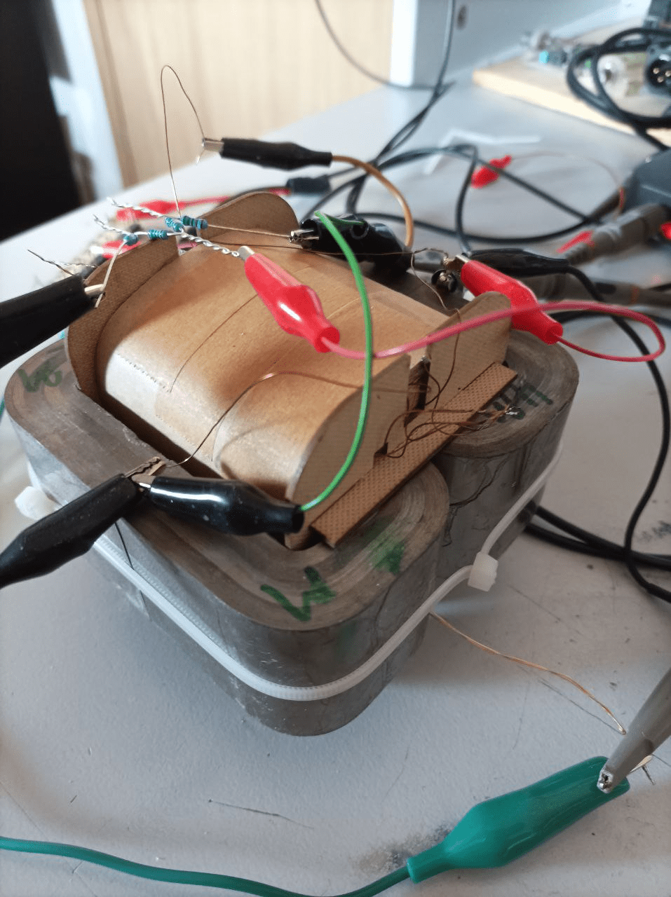

I'm currently winding the previously quoted phase splitter transformer. Just finished doing 1/2 of the secondaries, now screens are to be placed.

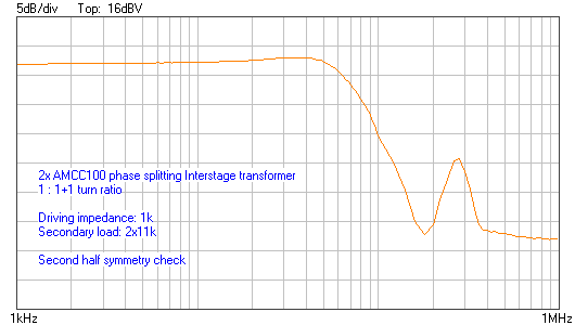

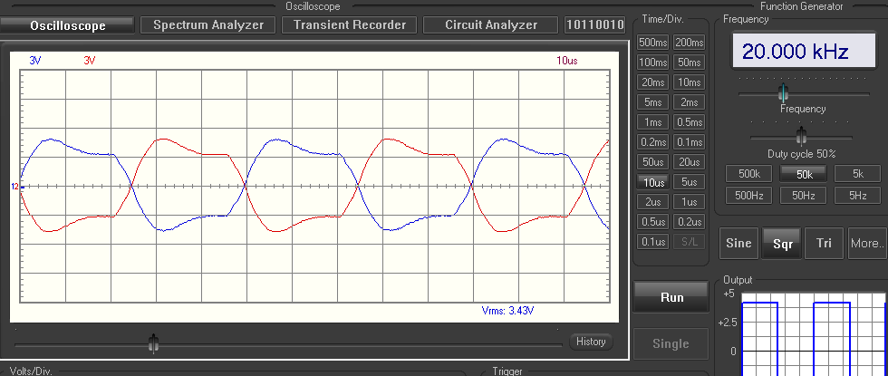

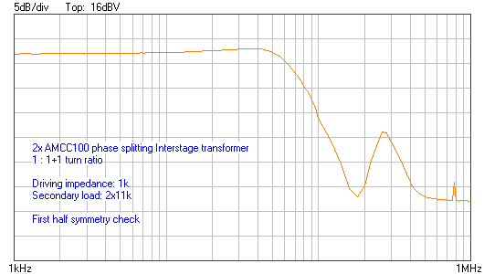

First measurements of the protype phase splitter. I feell happy. The symmetry between the halves is satisfactory. There is a peaking resonance at ~40kHz, which is easy to flatten using a higher secondary load or increasing driving impedance. I will experiment further by grounding the core, which theoretically if left floating, can lead to some asymmetry, which is still observable in the frequency responses. The cause could also be physical distance asymetry of the core related to the outer windings, or small winding asymmetries.

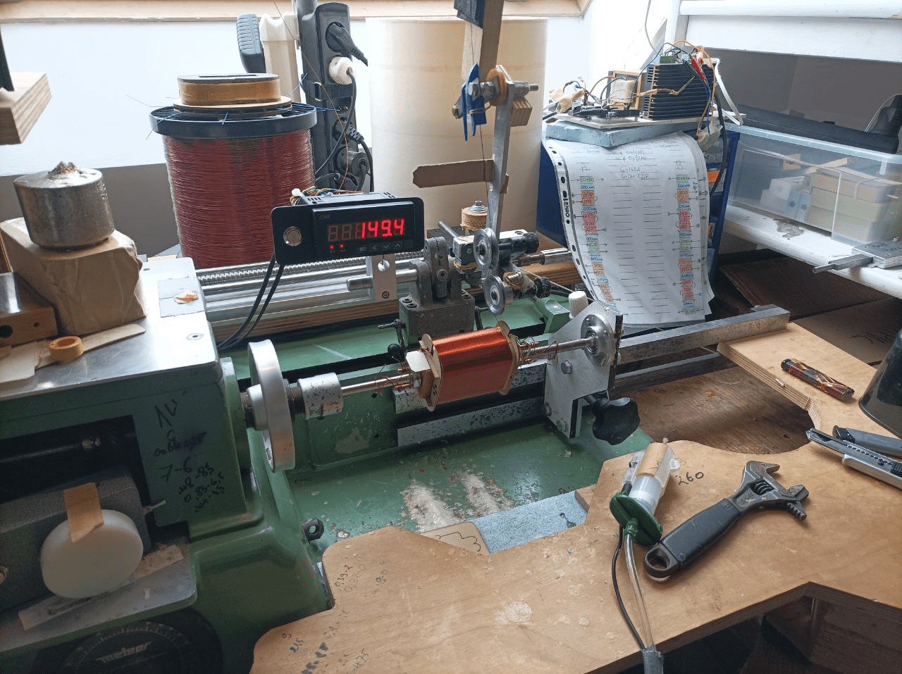

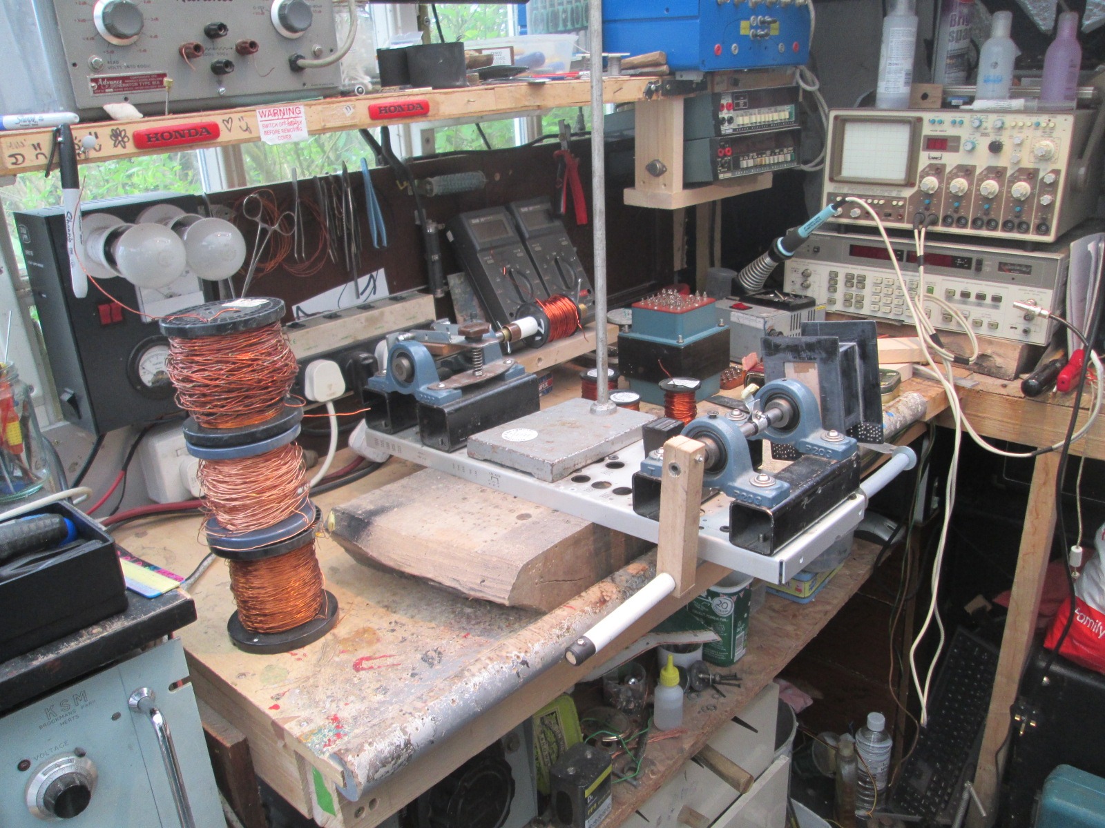

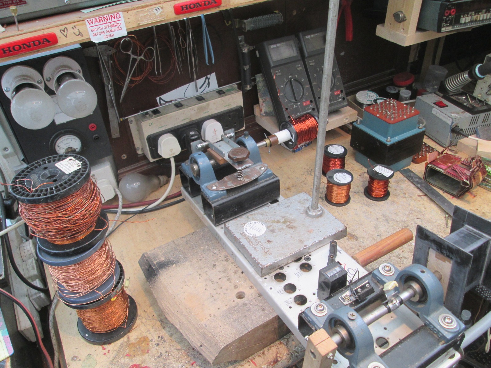

I see you have a replacement turns counter on the Meteor winder, is that something you have made yourself or one that is off the shelf/commercial, I would like to replace the old mechanical counter on my Aumann, it's good in one respect in being mechanical as I can power off the winder and it doesn't lose the number of turns so if I replaced it with an electronic counter that feature would be nice.

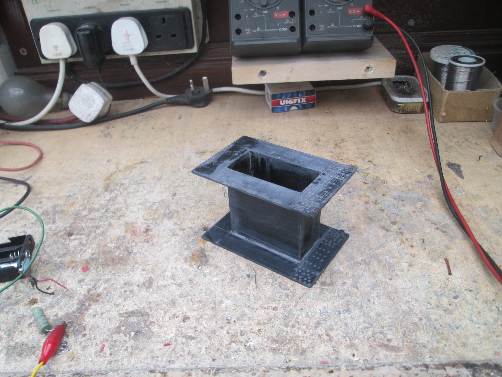

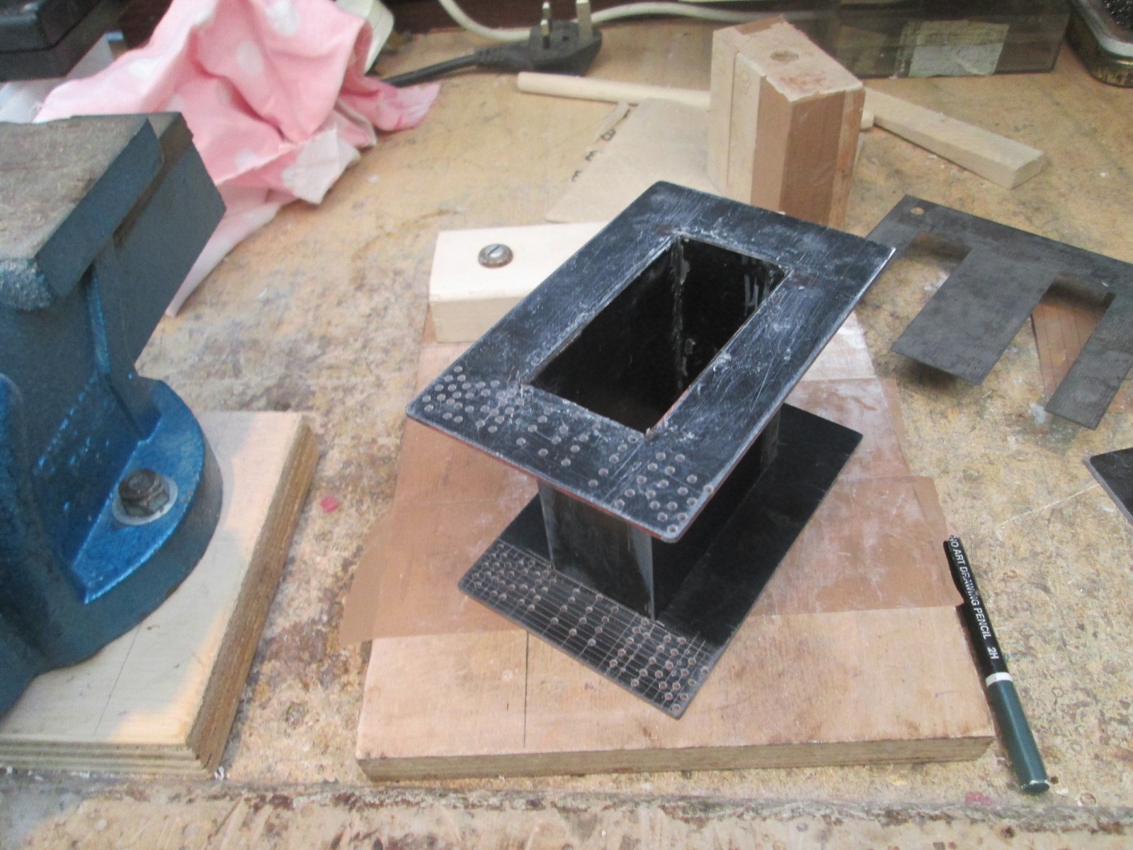

Here's an example of my recent work, it's not a audio OPT but a replacement mains tfmr for a Tektronix 585A oscilloscope. I built the bobbin by hand with files etc out of FR4 board. I've yet to wind it, but am making progress. This is my second attempt to wind it. See -
it's a very challenging wind, multiple windings, 19 in all. I'm using a very basic winder.

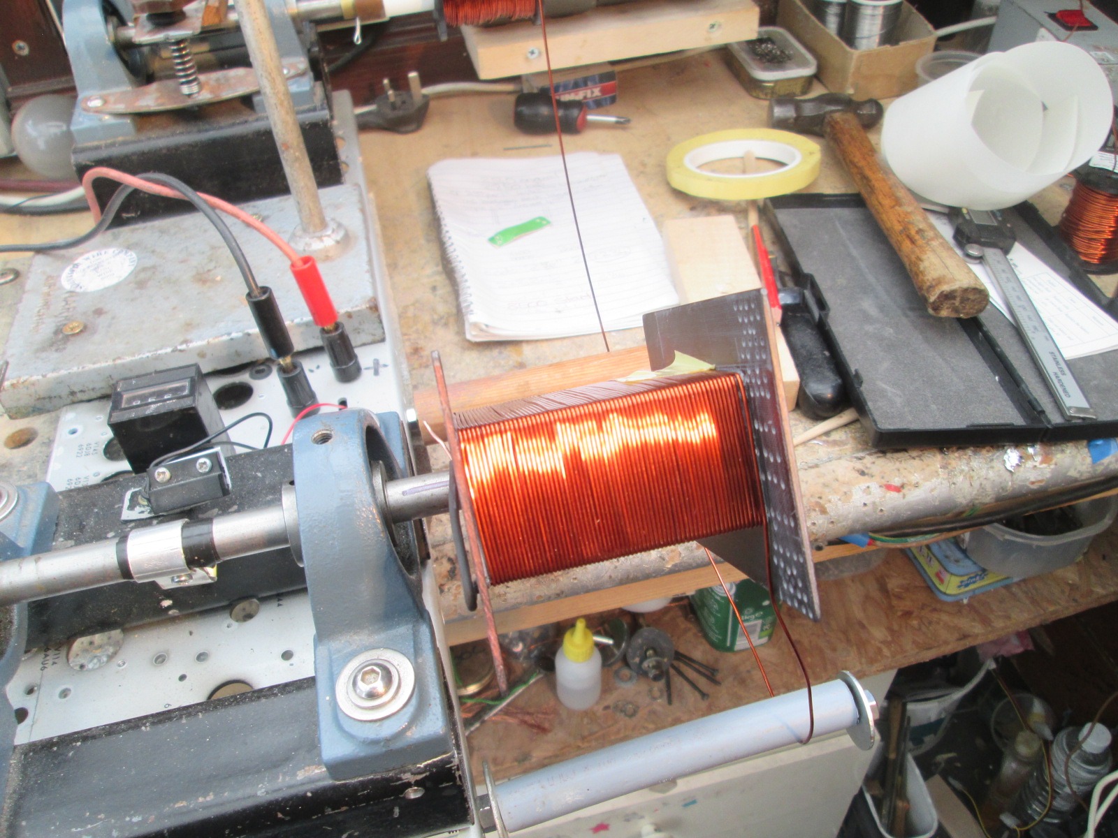

Regarding the heavier copper wire - you'd think that running the heavier copper wire over and under some rollers would make it more maleable/supple but in fact it has the opposite effect, copper 'work hardens' - every time it's bent it becomes a little harder until it reaches a maximum point, winding thicker wire is a PIA and I don't know of an easy way to get the wire to lay flat other than to work it with your hands as the turns go down, the upside is that usually thicker wire means low turns count so it's done reasonably quickly - maybe other forum members have some good tips/ideas on getting heavier wire to lay flat.

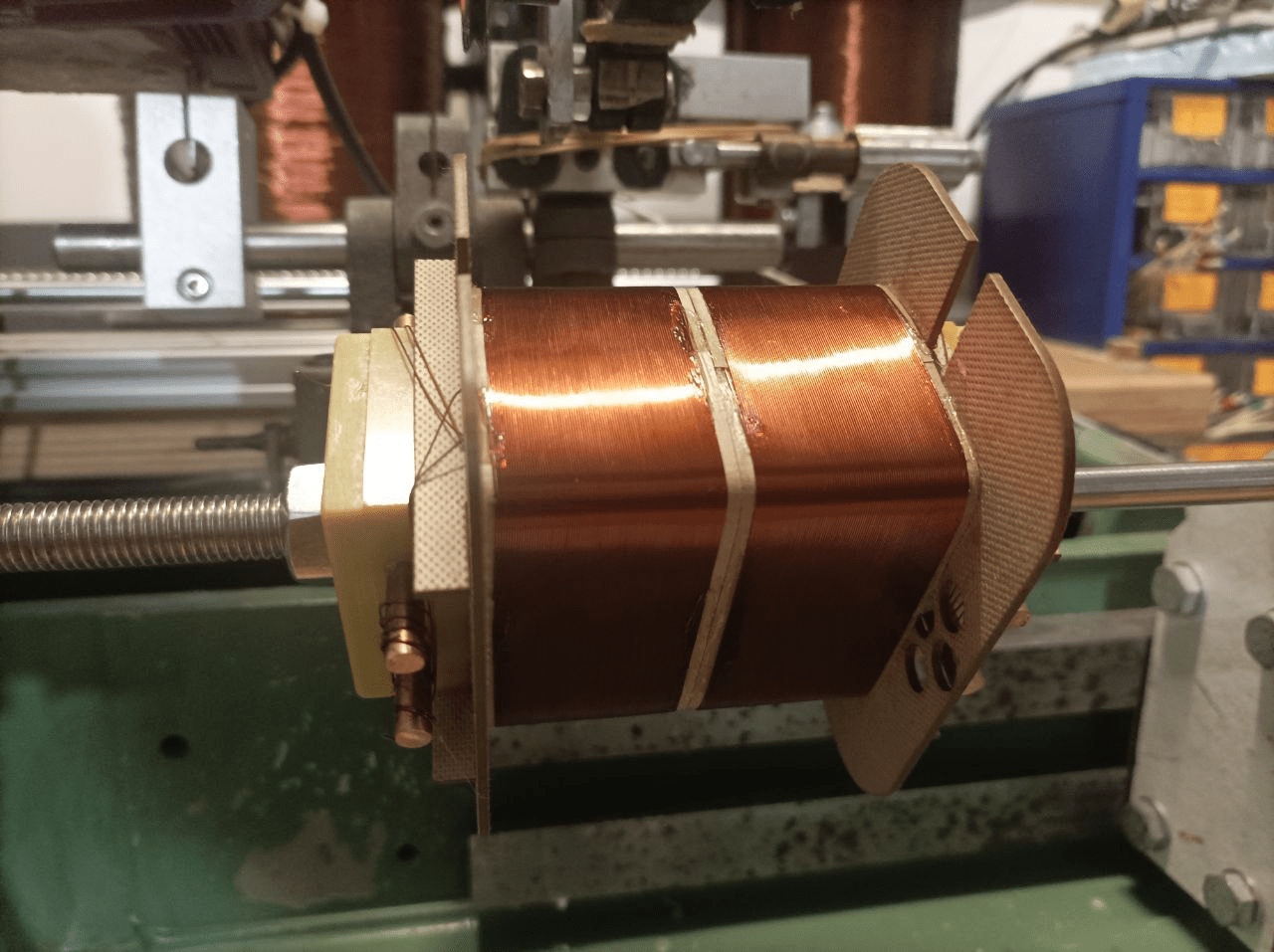

Started filming, so shouldn't be long. I know about work hardening metal, in this case copper, not sure if the two rollers will harden it much but it's a fair point. I'm using a glove on my right hand to fettle it more between two fingers. I've got the first layer of one half of the primary on, 64T. The original had 23T per inch, the bobbin I built is 2 7/8" wide, so 64T is ok.
Not sure if this is the right place for this Q, but here goes. The spec is for two 110v primarys, 172T each. There is also a buck/boost pri winding of 20T total. For a mains V of 245/250v all of these are in series, so pri wndg = 364T or 0.68v per turn. Core is 1 3/8" by 2 7/8" What I intend to do is leave off the buck/boost wndg's, the tfmr will only be used in the UK, but just add 20T onto the primary, this will make better use of the window space. 192T = 3 layers.
Question - I was intending to add an insulation layer between each primary layer, IE Nomex 4 thou thick, but this is a bobbin wind so could I get away without using this for each half of the primary? Worried about window space.
Andy.

Even if rewinding a transformer I still go through same procedure as if it is a new design, part of this is checking for fill of the winding window space, not sure if you have done this but if not I would recommend you do it, it's quite simple to add up the space taken up by the wire and all of the insulation and then calculate it as a percentage of the winding window, for me if the fill factor of the winding window is around 75% I know my proposed turns insulation etc will easily fit into the winding space - even up to 80% is ok, over 85% and things will get tight, at 90% then danger ! there is every chance I won't be able to get the laminations on without resorting to the use of clamps/vice to squash the windings down, not an ideal situation. I'm guessing this percentage amount will vary from person to person depending on their experience and technique.
