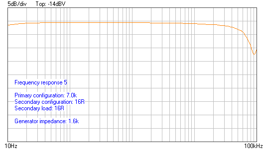

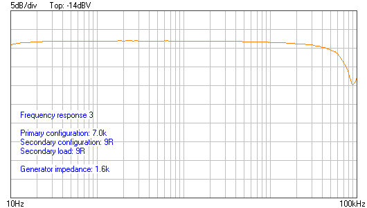

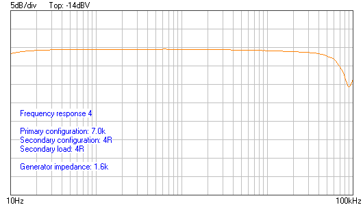

Celsius,
Keep in mind impedance increases exponentially. 2R+2R windings mean 2*2^2, so 8R.
To have 4R, 9R and 16R windings, you need at least a set of 4R, and sets of 1R.
4R // 1+1R -> 4R
4R + 1R -> ( SQRT(4) + SQRT(1) )^2 = 9R
4R + 4R -> 4^2 = 16R
The basic ways of winding tapped seccondaries, are either:
-Trifiliar, 1R x3 windings per layer. That way, you can chieve 1R, 4R and 9R. Or if starting with a 4R per winding, that translates to 4R, 16R and 36R
-Or top on top layers. One layer of 1R winding, then a second layer of 4R winding. You will get higher Ls when only using the 4R tap.
Keep in mind I like sharing frequency response for educational purposes only. Not meaning to boast or anything, but my goal is to demonstrate different cause and effect examples, while attempting to back them throughout logical and theoretical explanations. I love building risky* projects, just for the sake of squeezing headroom and study the analysis and behavior behind different frequency behaviors and their relation with the interleaving strategy. There is a lot of interleaving dogma that needs to be taken care of. Neither that I consider frequency response as sound quality factor, but that is another part of the subject.
