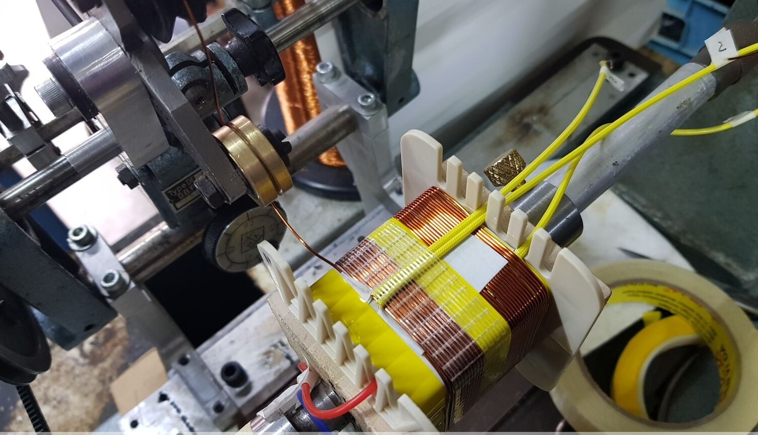

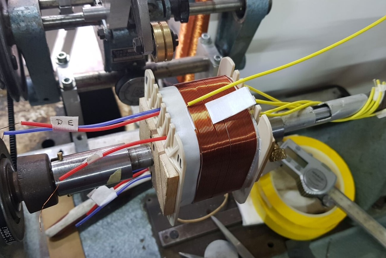

I want to try my self to make some experiments with winding an output transformer for fun, i was not able to find thinner insulation pressboard than 0.1mm and i was curios if you use thinner than this. And for coil bobbin (coil former) i want to use 1.5mm insulation pressboard, what do think will work ok? and here i need to find a way to cut it correctly, maybe with a laser which i don't have it :-( i am asking you these because i saw you have tested already, i hope don't bother you![]()
If you rely on the dielectric to hold your layer ends, I wouldn't recommend working with something bellow 0.08mm. Although if the paper is waxed, which makes is stronger, you could go to 0.05mm for fine wires, such as 0.13-0.18mm. You could buy Nomex 410, although expensive, on a thickness of 0.08mm.
I'm using 0.1mm for wire diameters 0.2 to 0.5, then 0.2mm for 0.6mm and above.
In art stores, you could find paper with 0.05mm thickness, but it will be quite fragile and foldy.

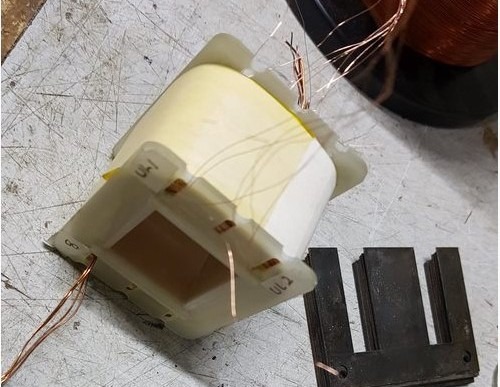

I'm using pressboard for coil formers, laser cut. 1.0mm for small coils, 1.5mm for medium sized transformer and 2.0mm for very big stuff.
Thank you for the advice given, they are very helpful for me. thinner insulation i found but not paper it is some PET Polyester Film (Heat class: „B”/ 130 °C, Impact tension: 8kV) and don't know what results will give And another option is to use baking paper but the same i don't know what result can get. But... The winter is coming!
I will have some free time to do some experiments.
I agree regarding the baking paper - I haven't had great experience with it - being silicon paper it is quite slippery not only does it not take tape well, if your layers are not perfectly flat, wire tends to slip off the edges, to counter this a reasonable margin is needed which eats into winding space. The old fashion sandwich wrap/tracing paper works ok for me. I have attached a screen shot taken from a book on coil winding that is available as an online loan from the internet archive, gives suggested insulation thickness between wire layers, the other pics show one way of anchoring turns when making a tap in a winding. If you are using a bobbin it is possible to do away with insulation between the layers of wire in each winding, just make sure the winding is even, to keep the voltage gradient between turns as small as possible, this can be done with care, just by hand feeding the wire - it is not uncommon for the primary turns per volt to be as high as 10 to 12 turns per volt so unless you are really sloppy it is unlikely that you'll get more than 50 or 60 volts between adjacent turns, if you are careful this can reduce to a max of less than 20 volts between adjacent turns. Prior to building my coil winder, I wound many transformers by hand this way, a simple low voltage driven spindle with wire fed by hand, the only thing that is a must is an accurate turns counter.

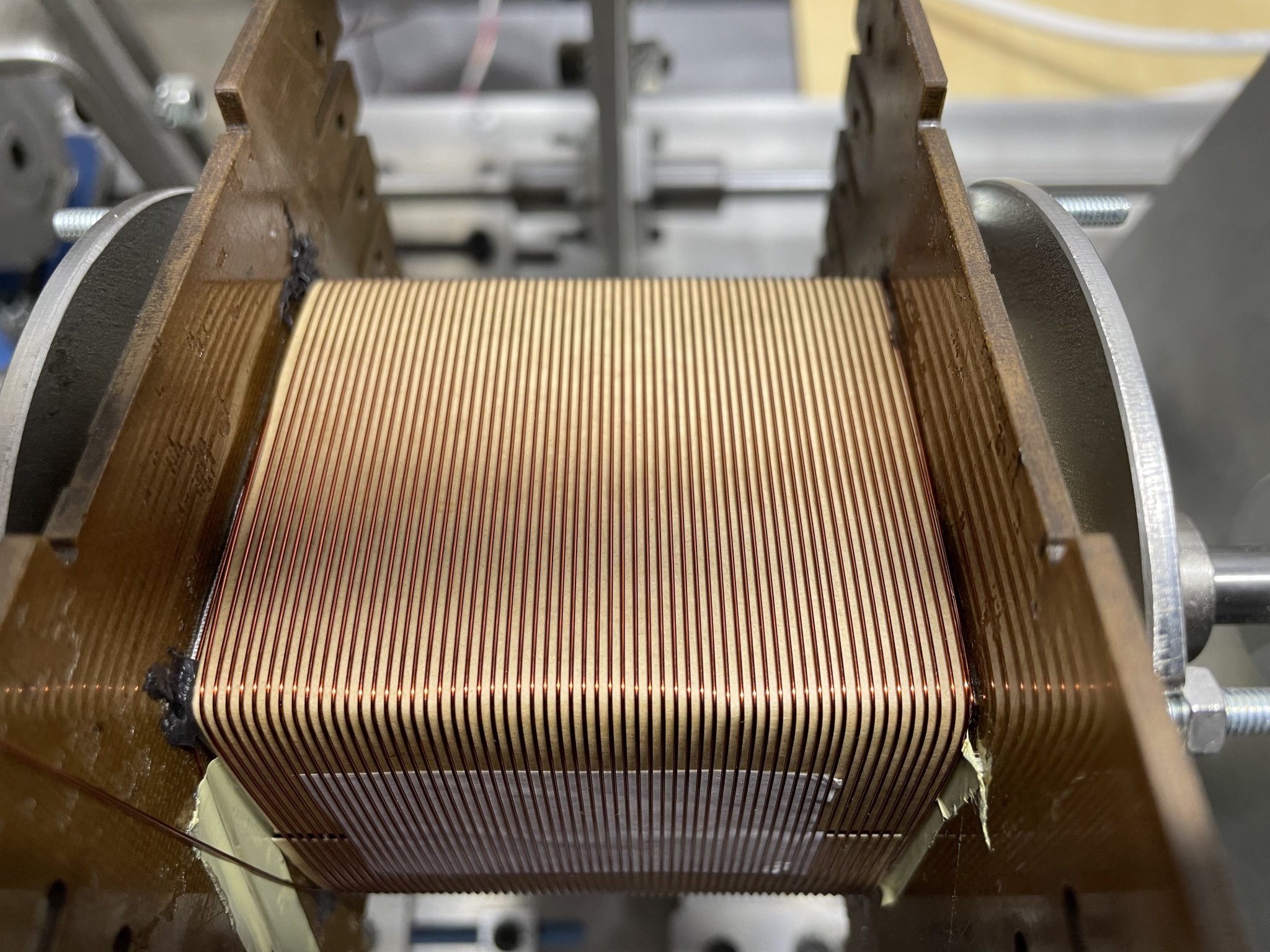

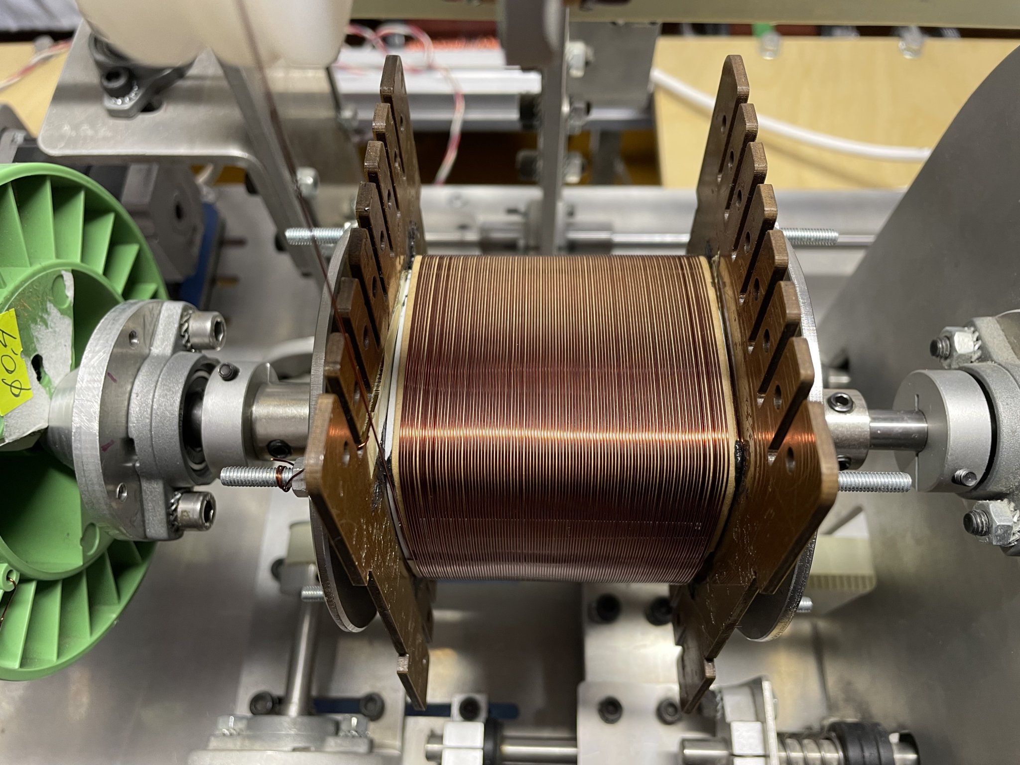

CNC is the next great thing since sliced bread, it allows almost instant setup for near perfect distribution of turns over the coil.
Although the thicker is solid wire the more tricky is to wind it.

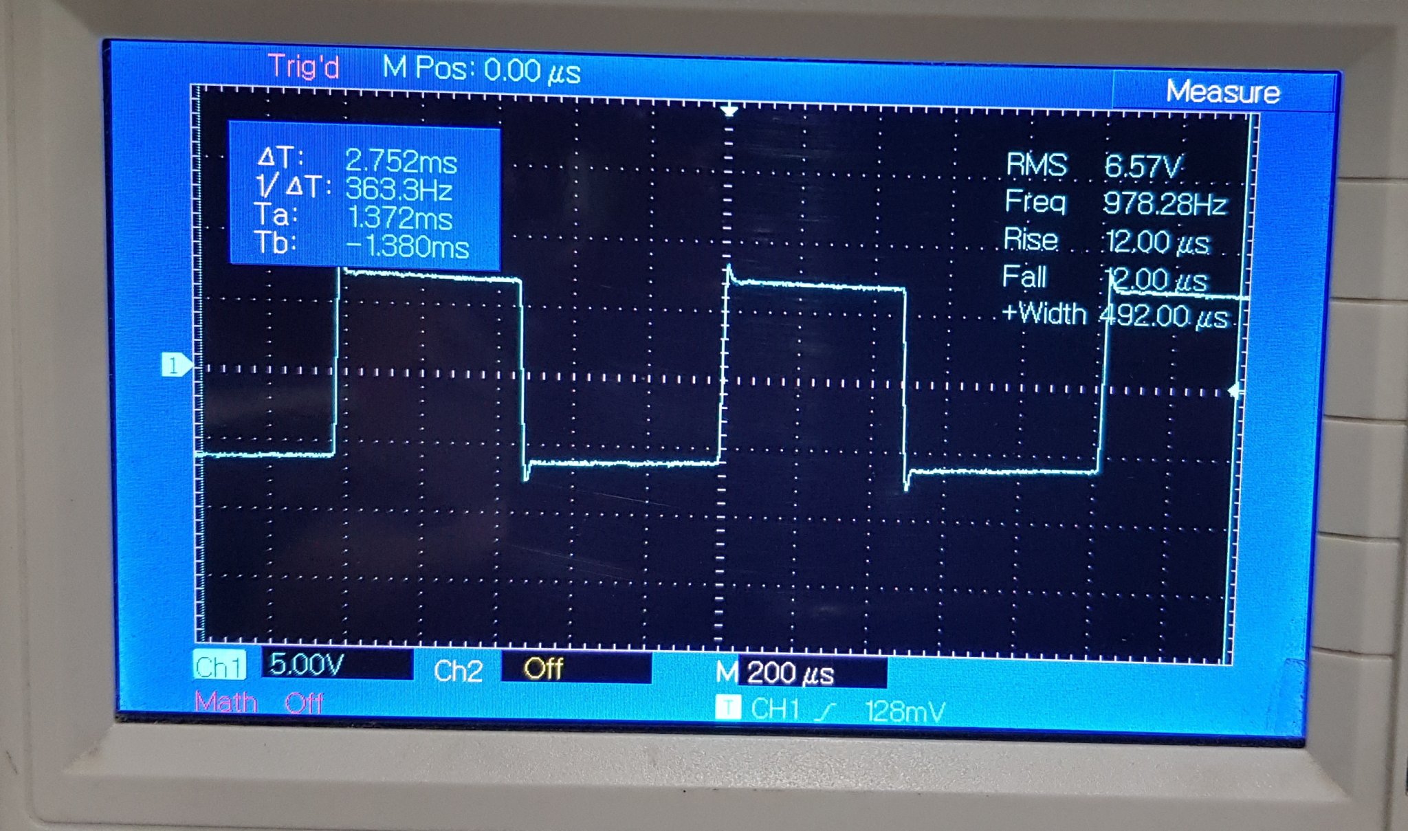

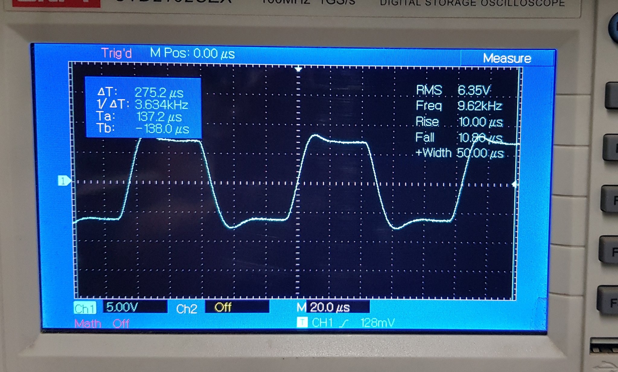

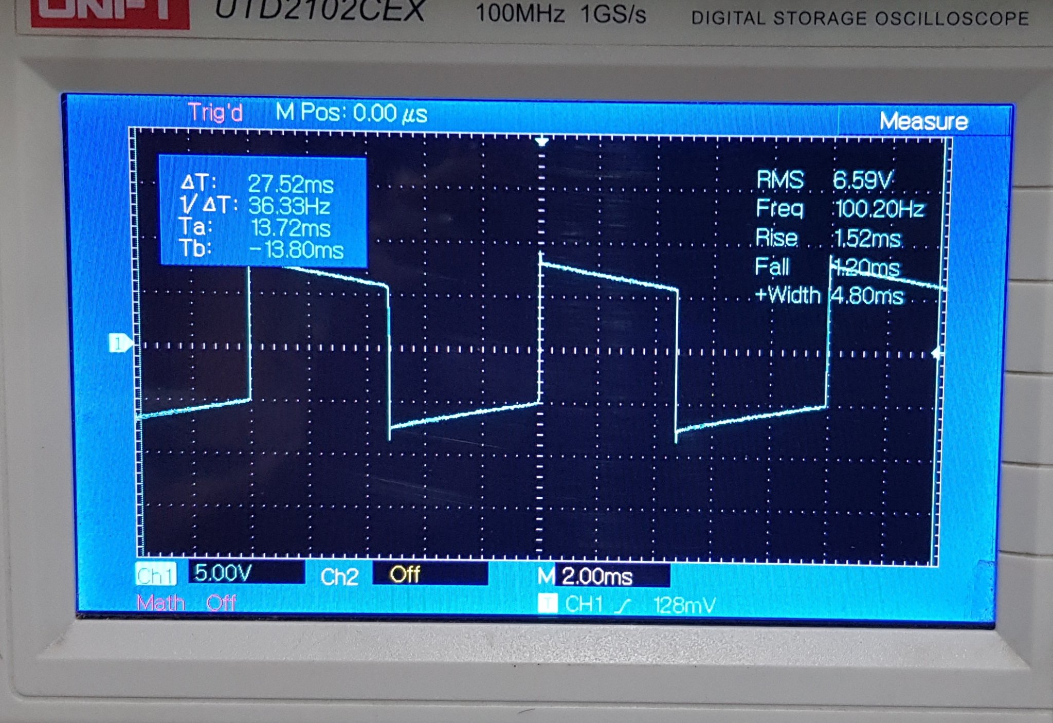

Thry to measure transfer with low imedance and high impedance source
and terminate secondary also with high impedance and lowering after.
A few simple and fast measurements...
(Bare in mind to measure or find data about computer or soundcard input resistor because it will be max value of termination.
every other value added will be parallel value of existing input R and this added...)
To determine where is the resonant peak if exists, and what happening in bass region. Regardless of the driving impedance and termonation impedance... And see what is the phase shift too. Because transfer almost always measure phase response in the same meas...
Then with measured Lp and Ls You can calculate mutual inductance and from resonant peak you can estimate capacitance, and other parameters...
Because if You have say +4-6db HF peek @ 14KHz, and -4-6db @ 100Hz, there is no point to listen to this transformer?

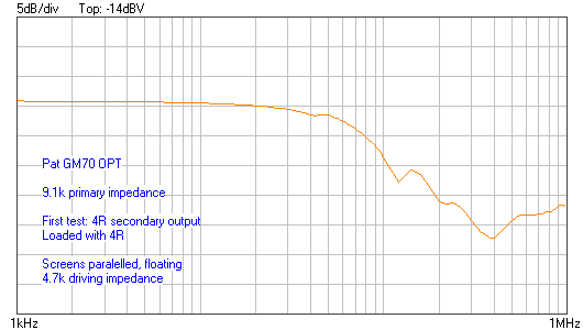

I'm a big fan of using electrostatic screens. Either under the form of windings or foil.
Electrostatic winding screens have one benefit compared to foils, as you can use them to add or substract voltage potentials by connecting different ends. This result is very important for my phase splitter SE
P transformer to achieve perfect symmetry between the PP halves over all frequency region.
Using additional screens the right way can help you destroy or reduce unwanted resonances by redirecting capacitances into a less offensive region.
Some troubling dipping resonances can happen when distant secondary layers are capacitively coupled into high-impedance primary layers, considering a low-interleaving, high Ls configuration is selected. The calculated Ls is 17mH.
In a PP transformer, one can get away with high capacitive regions between the secondaries, considering they're equal. However, in SE output transformers, capacitive regions are never equal and this capacitive difference, especially between series connected secondaries can cause a low-frequency offensive dipping resonance. In a sense, PP transformer are easier to achieve better HF response

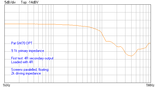

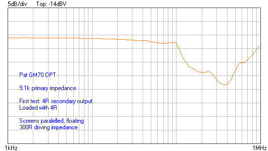

This transformer is designed with a high Ls, low interleave count. Double bobbin single C-core, using 3 P/S interleaves, into a configuration of Px/SS/P2x/S and 4200 primary turns count. Ls dominant roll-off.
There is a very small residual resonance at ~40kHz that could be taken care of by grounding the core and adding additional screen between the two bobbins that would shunt a small amount of residual primary to secondary capacitance, but I decided to leave it this way.
You can observe a quite universal frequency response behavior with different driving impedances - 300R to 4.7k. Little peaking ringing is observed for all configurations.

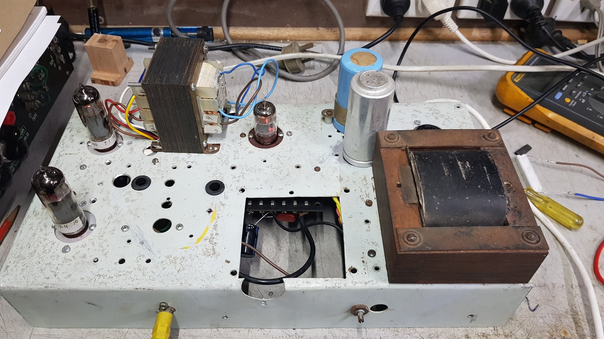

Just finished a copy of a Dynaco Z565 output transformer, for a Dynaco ST35 project I have in mind, the wind has 2 complete primaries connected in parallel, 6400 turns total become 3200 turns once all of the connections have been made - secondary is done in a similar way.
Initial testing was done with standard grade power transformer laminations, I built a mono version of the Dynaco SCA35 power amp so I could do some tests and measurements, so far very pleased with the results, the scope trace pics of 100Hz,1KHz and 10KHz are not too bad considering the laminations were ordinary power transformer type. My M6 GOSS laminations arrived a few days ago so once the varnish/potting is done I'll reassemble with these.
