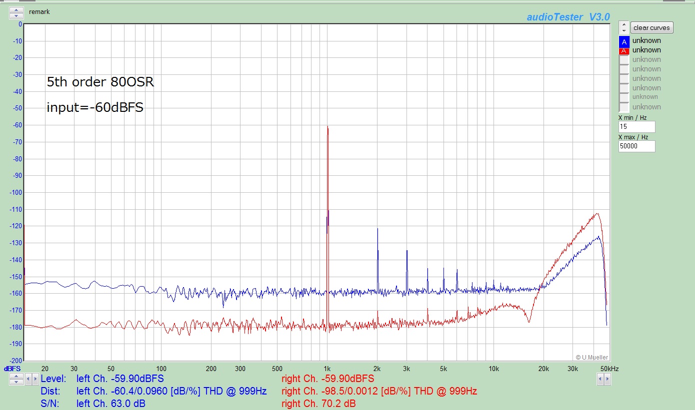

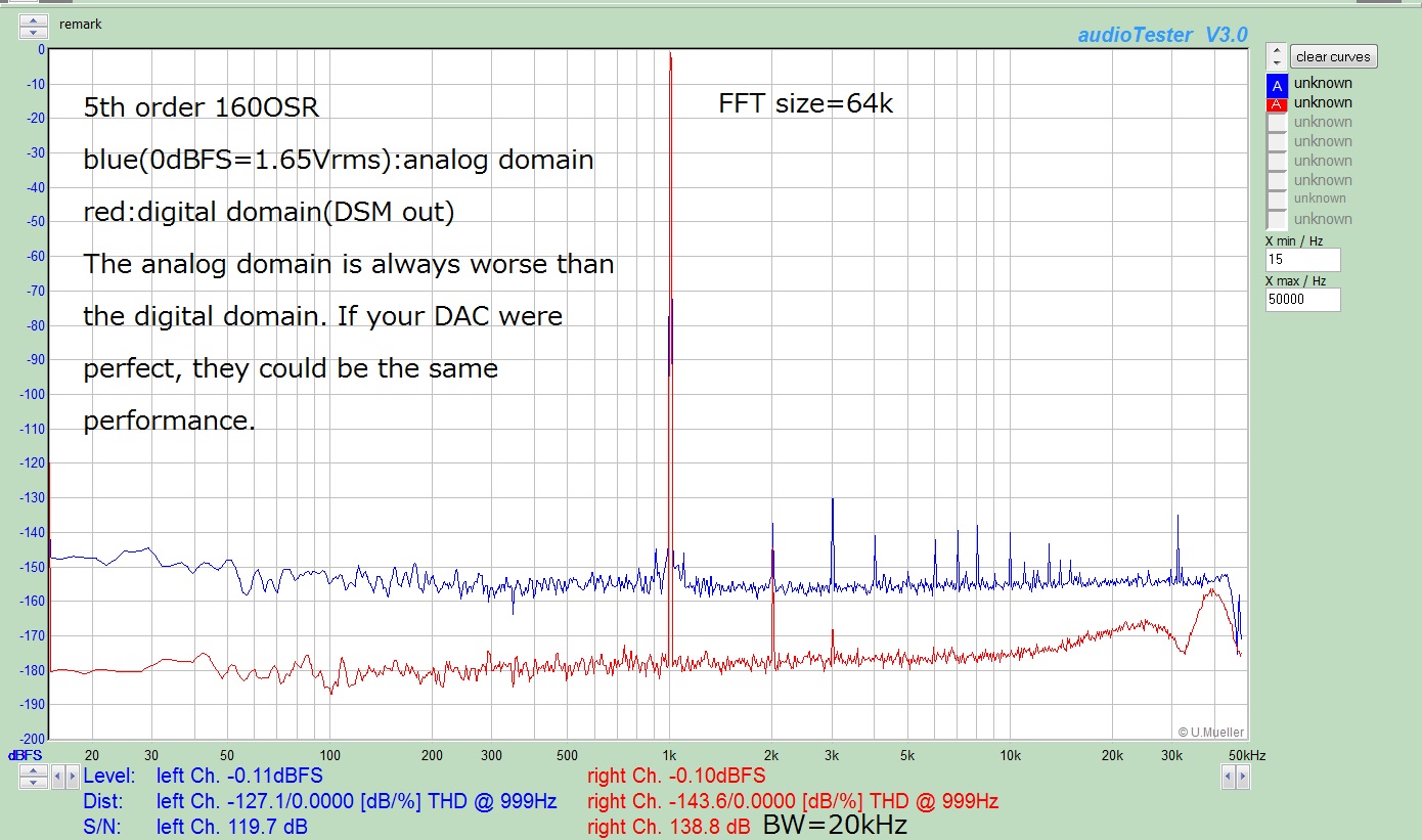

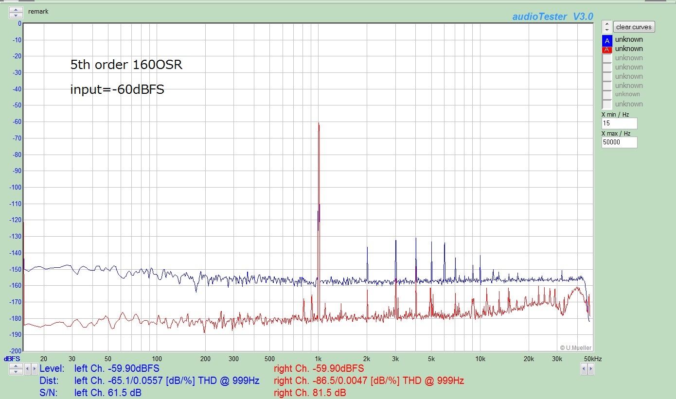

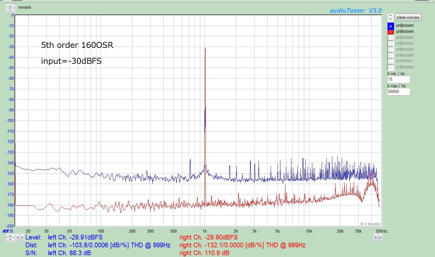

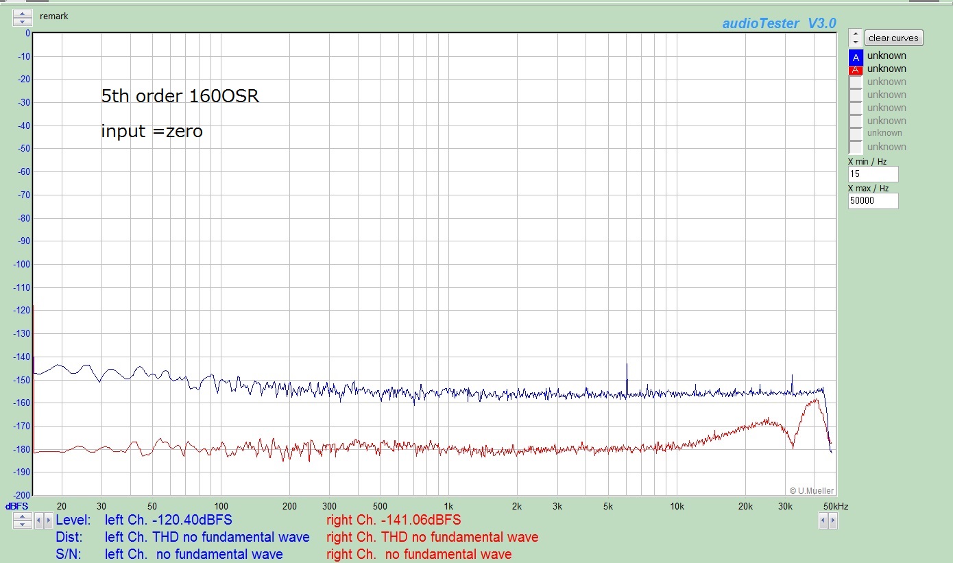

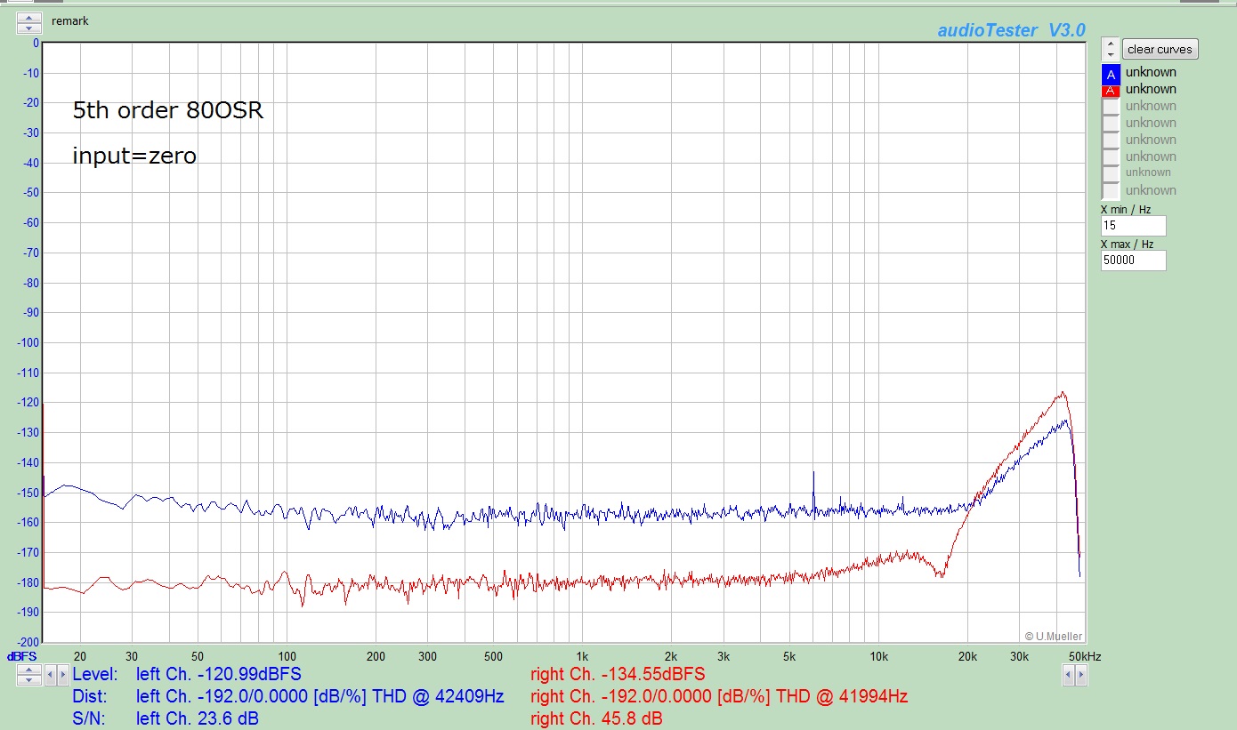

This is my revised synthesis for olo111' PCB. Post#52 didn't make DSDON active. DSM is 5th order 160OSR or 80OSR(with EEPROM-5pin 1kohm pulldown). I don't think high-order DSM has the advantage because the lowest order, which can have adequate noise-shaping, is enough. Your high performance in the digital domain has nothing to do with those in the analog domain.

Thank you xx3stksm for sharing your work. Tested, works fine 🙂

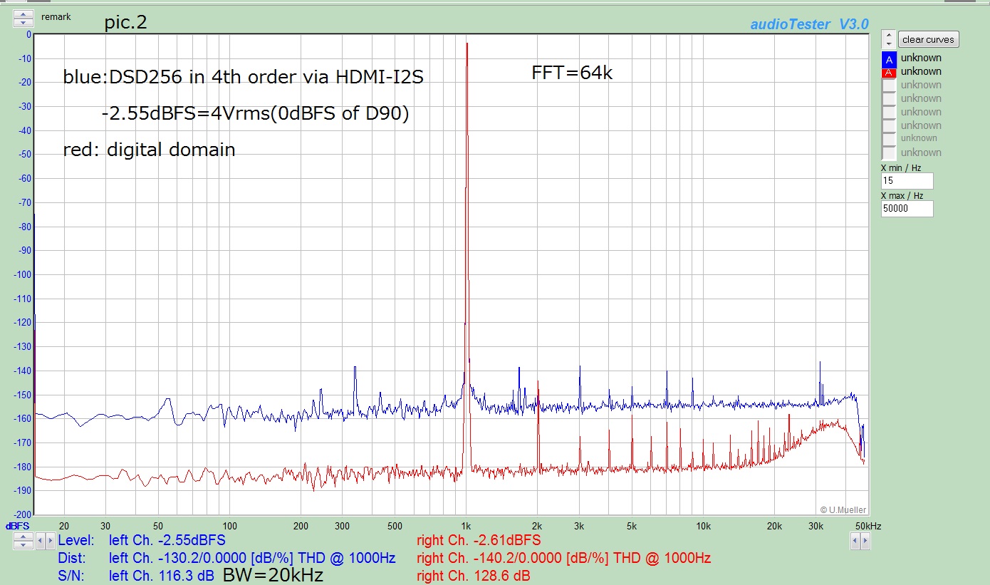

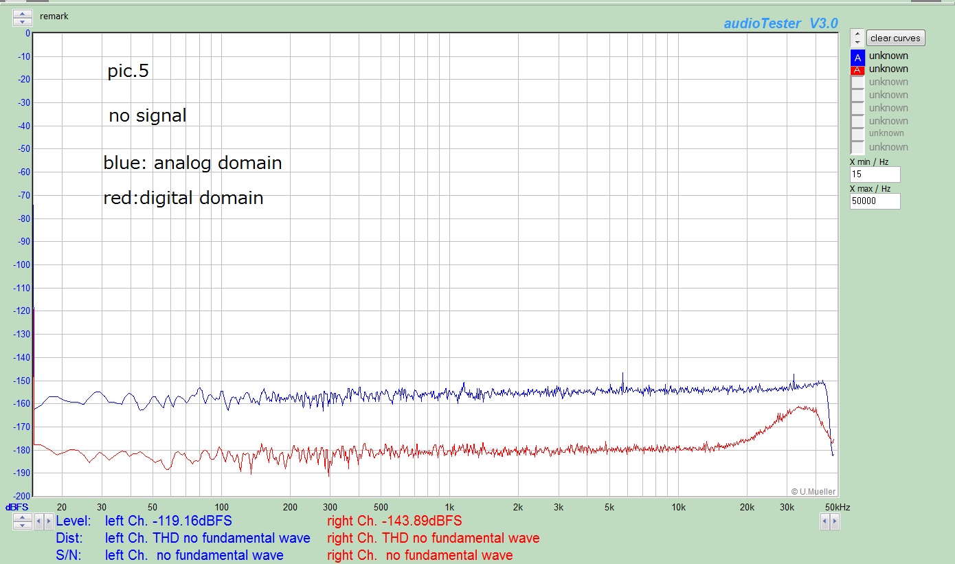

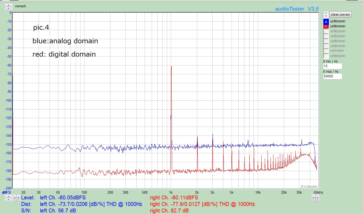

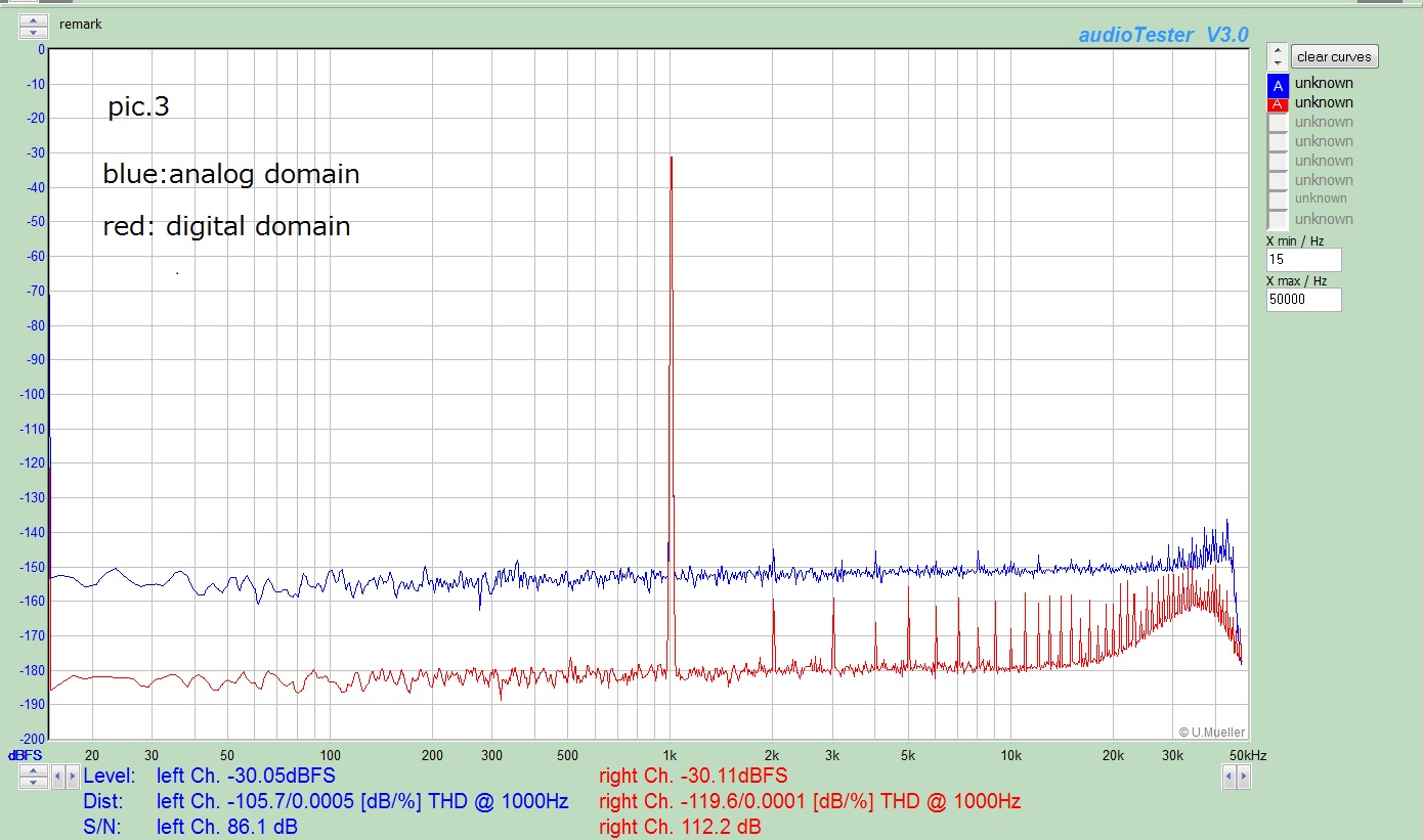

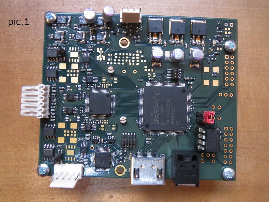

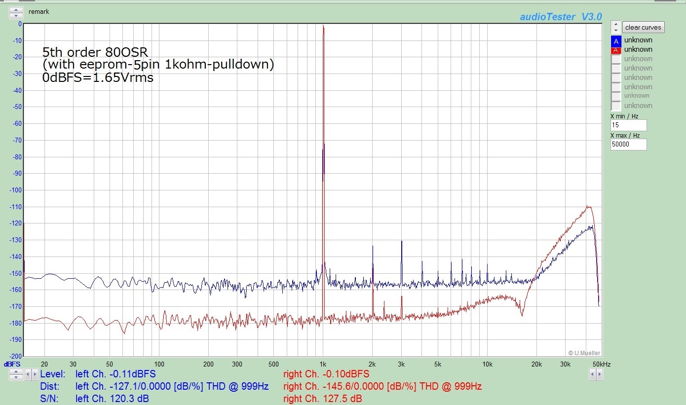

I measured the DSD performance of D90 because I have an ADC board(pic.1) with xc6slx9 and HDMI-I2S. It's straightforward to reassign the pin assignment for this board to feed D90 256DSD via HDMI-I2S. MCLK is 22.5792MHz because D90 doesn't accept a 48k family. The result is better than expected, though SNR is slightly worse due to the DSM amplitude penalty(-6dBFS is usually max). I guess DSD256 in 4th order is probably better than DSD128 in 5th order. 0dBFS performance is pic.2. THD is almost the same as USB, but SNR is 6dB worse. Since D90 doesn't have a dedicated 1bit converter, -6dBFS max means 6dB loss in SNR. But ES9038 doesn't have such excellent performance in DSD256 as long as I know. I would say AK4499 is the best monolithic chip in DSD mode. The attached Zip file is 4th order 256OSR for olo111's board, which is the same one used for D90.
Thank you very much xx3stksm for sharing your work again. Tested, works fine. Good job! 🙂

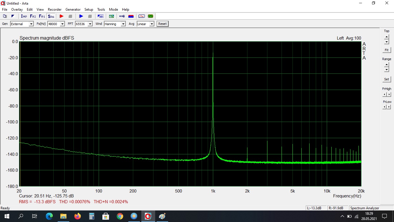

These differences are too small to hear and remember. That would have to be compared one to one. But you can see e.g. -10dBfs (first photo DSM5, second curent DSM4):
