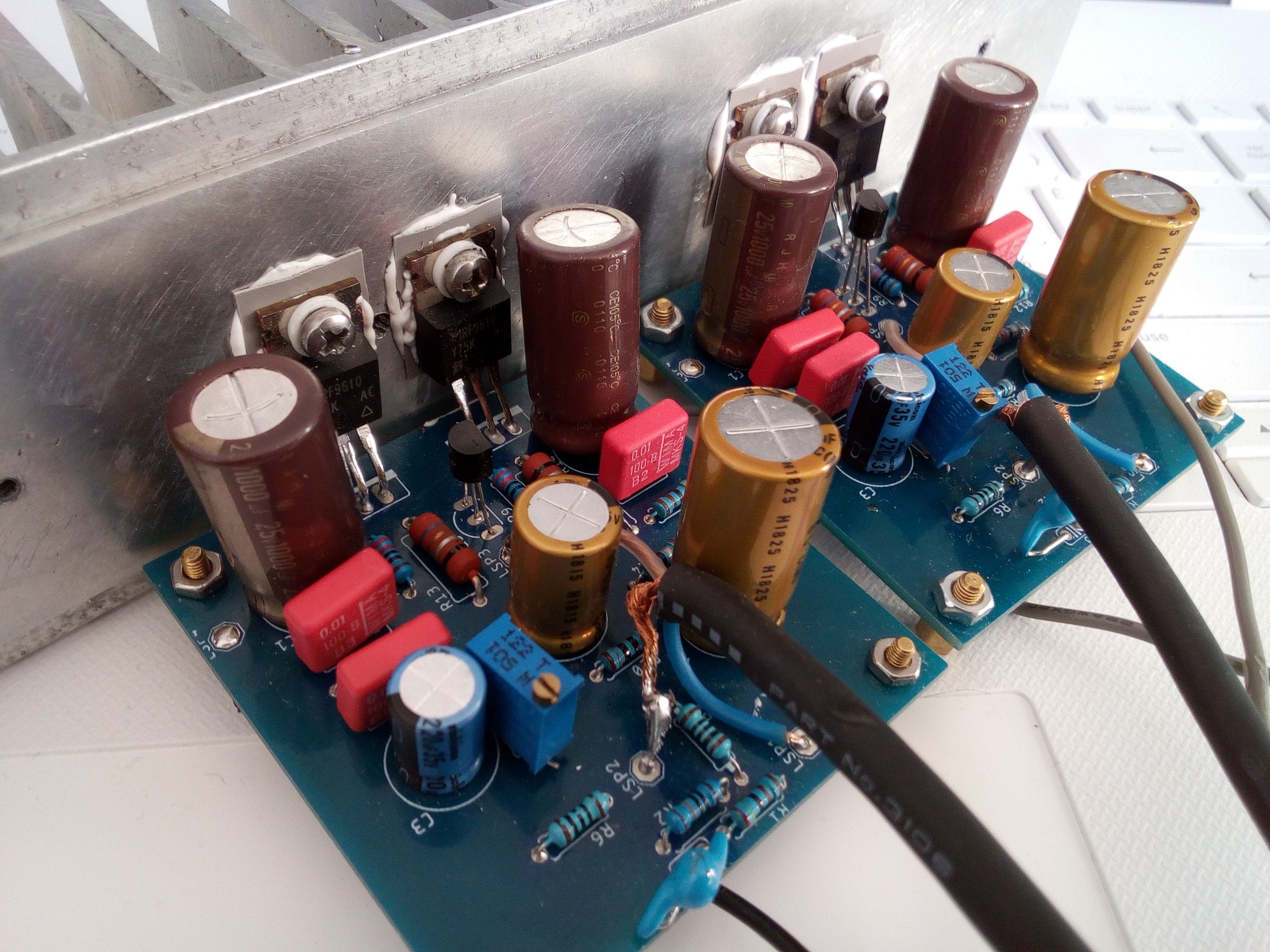

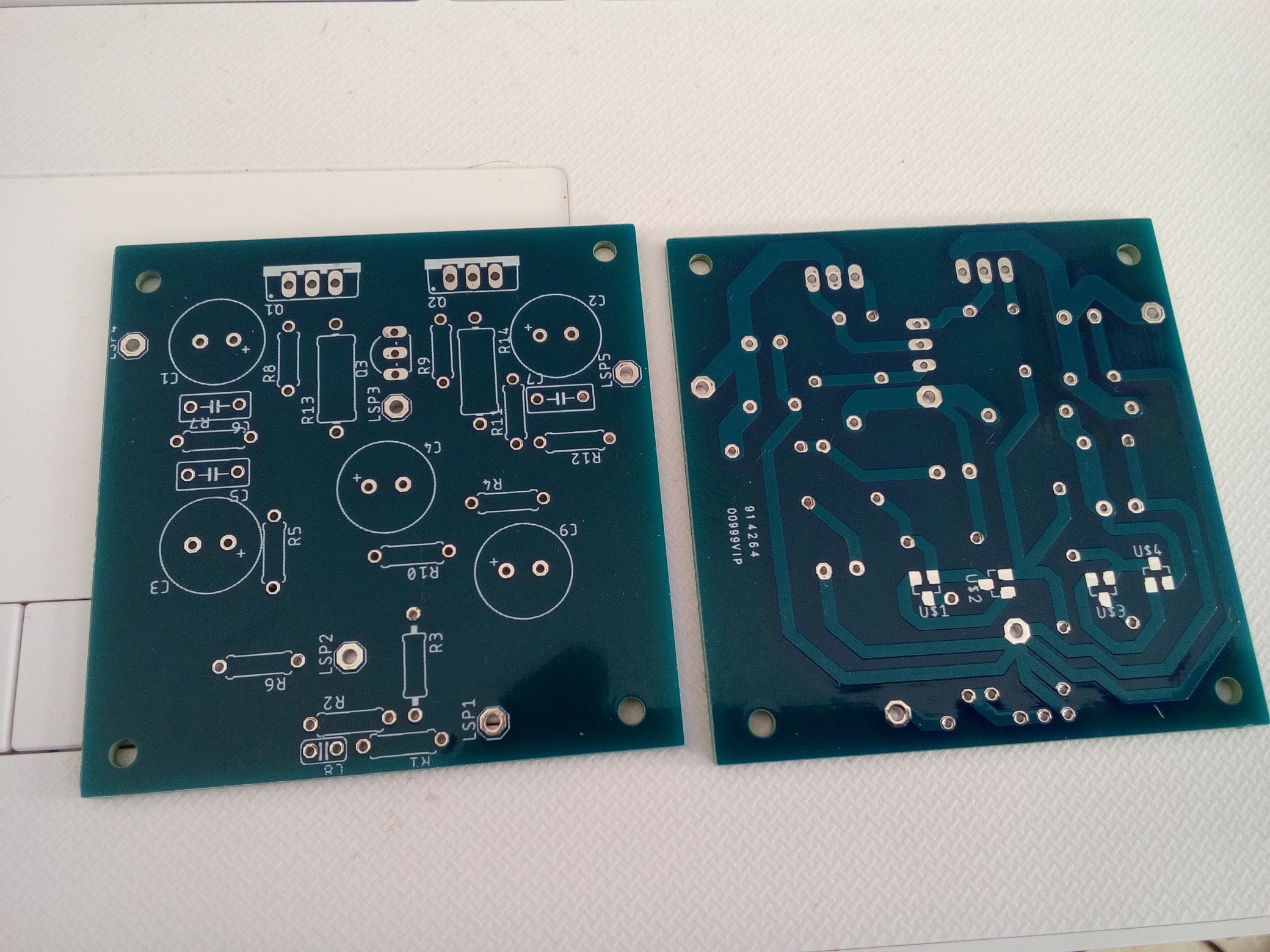

I have built my version of this amplifier with my PCB design. It is still on the tests with many different headphones (32 ohm ortho and 32, 50,300 600 ohm dynamic
it is not in the case yet, but I can say that
this amplifier sounds great.
Thanx XRK for sharing this project!
BTW
Have you thought about the power version of this amplifier (about 5-8 W) for HF loudspeakers? I have pair of old full range speakers with AlNiCO
Something like CAMP AMP Nelson Pass?

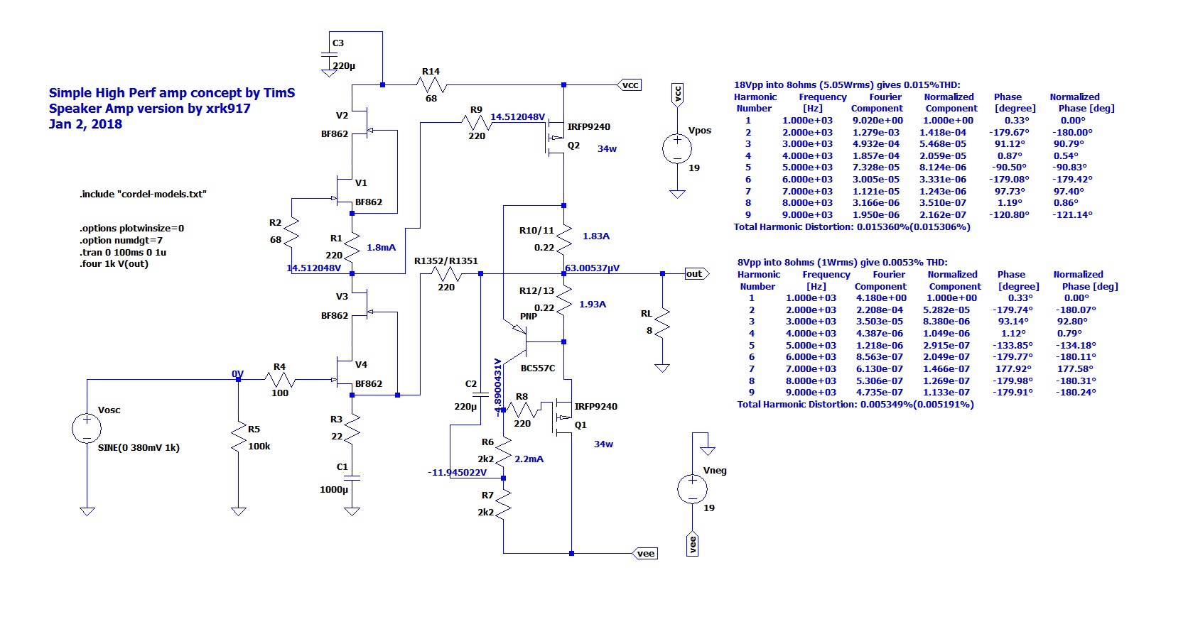

Glad you like the sound - it is very clear and articulate with gobs of deep deep bass. I suppose a 5-8w could easily be made by using IRFP9240's and increase rails to +/-24v and boost bias current to say 1.25amps, and we would have to be careful not to over-stress the BF862's as they are rated only 20v, but it may work because the voltages between them is not that high.

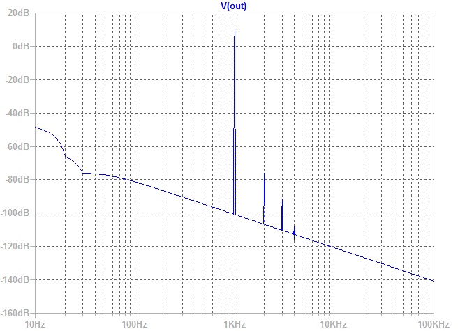

Simply replace the main bias current control power resistors with 0.22R, use +/-19v power supplies (2 laptop bricks in series), and switch to IRFP9240 MOSFETs. This gives a 1.83amp bias current and decent performance at 5Wrms and nice at 1Wrms into 8ohms. Not as clean as an Alpha 20 (which has fewer parts) and can go to 35w at 4ohms. But it is DC coupled all the way thru.
attachment.php
FFT for 8Vpp into 8ohms:
attachment.php

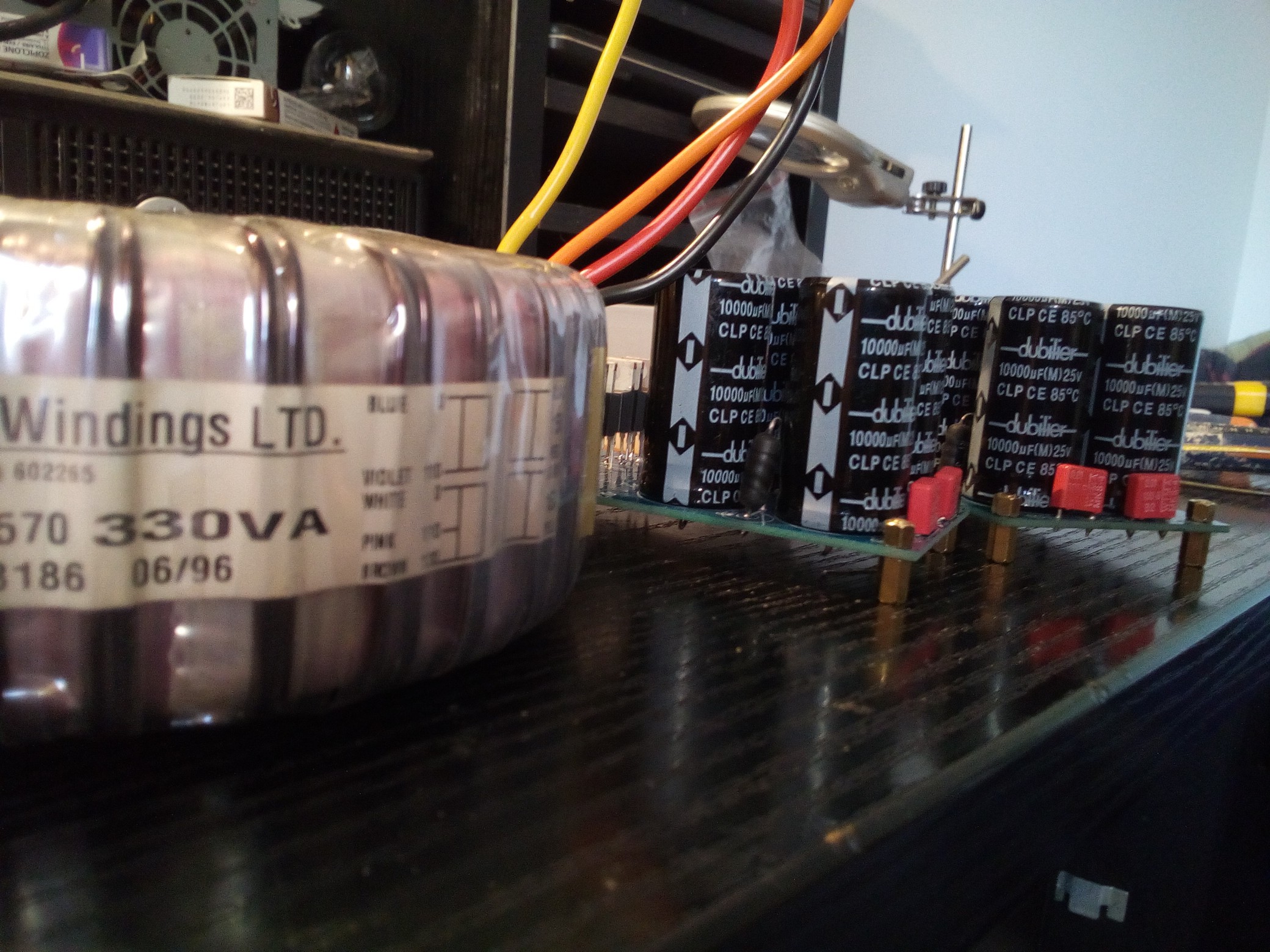

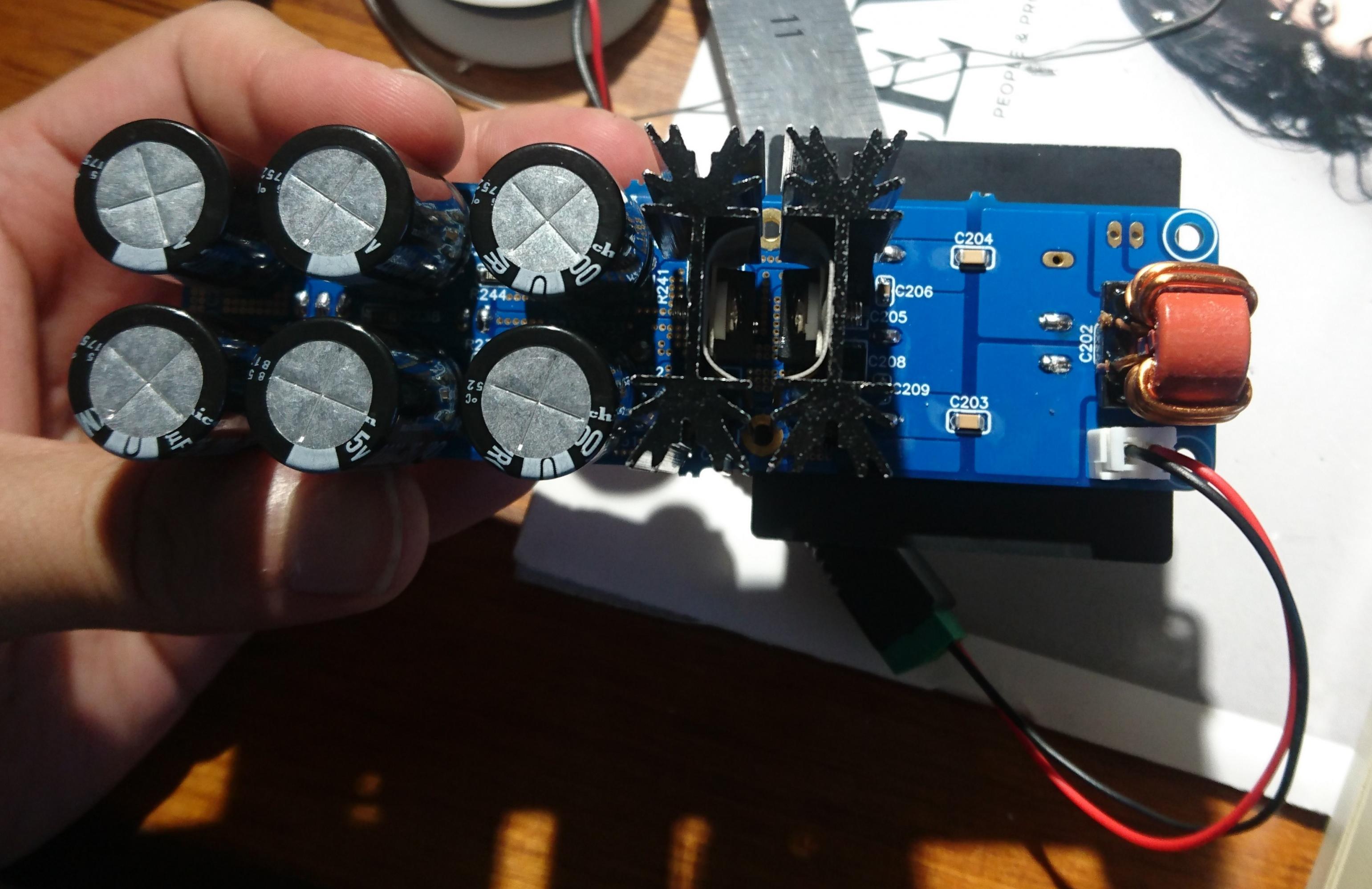

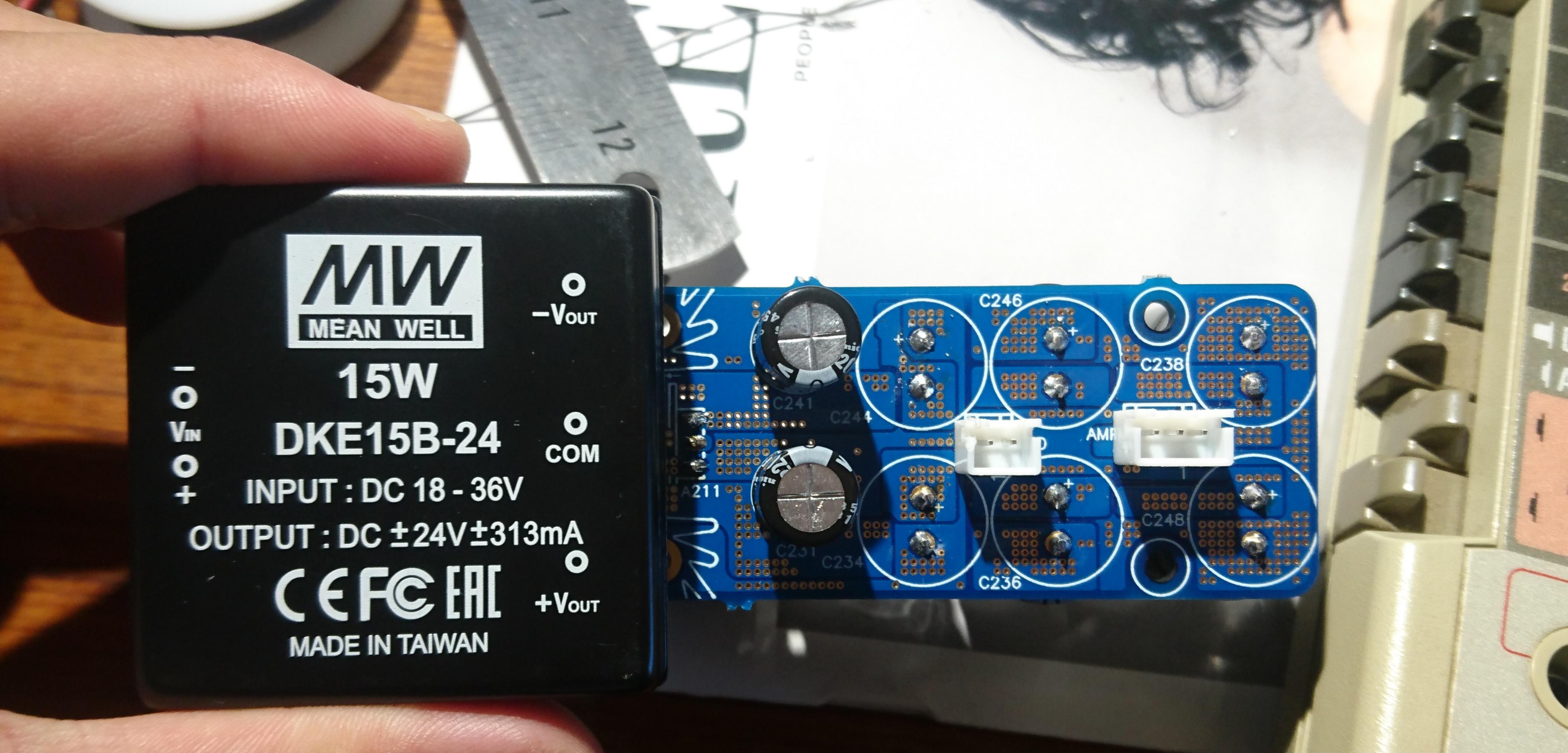

Progress has been slow on my build, getting there though. Finished up the PSU yesterday and a little more to go on the amp PCB.

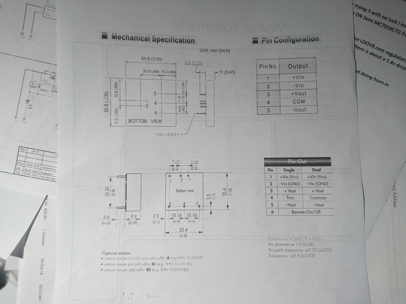

Just wanted to post that the Meanwell converter posted a while back seems to be a drop in replacement for the traco - I just shifted a few things to the back side of the PCB as the meanwell is a lot larger than the traco.
Here are some pictures of my power supply board.
Regs are socketed - testing with 7818 and 7918 at the moment.
Getting 16V on +ve & -17V after reg & cap mx.
I've forgotten - what was the output voltages we are aiming for after cap mx? (once the adjustable LDOVR regs are in place)
I did order and receive an adjustable neg reg from ldovr , up to -18V as on their website - voltages set by pads.
Which resistors have to be changed to allow higher output voltages?
replace R7 (1M5 resistor @ top right corner - 0.3V pad) with 105K (SMD 0603)
after modification 0.3V PAD will add 4V - you can configure from 3V to 22V with 1V step
for 20V - need to solder 8V, 4V, 1V and 0.3V (now 4V) pads
Vout = 3+8+4+1+4 =20V
