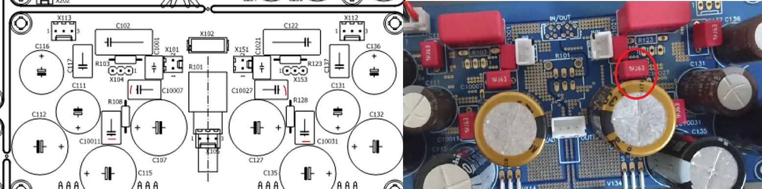

Probably nothing to do with your problem, but did you follow this as well:
Update Aug. 5, 2018: Silkscreen on PSU PCB has error: Diode V241 has cathode and anode flipped.. Mount diode with Anode towards Drain of P channel MOSFET on cap Mx.

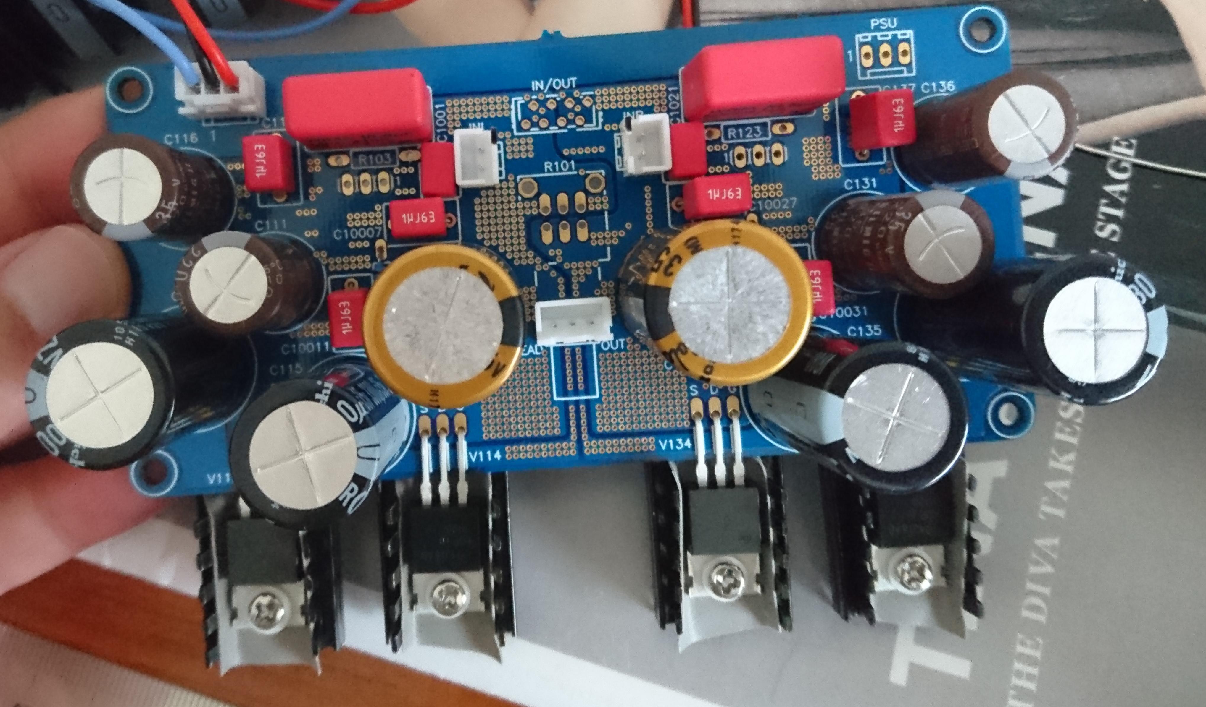

Here's a couple pics of my amp board, unless you guys spot some glaring issue I guess I'll get down to it later tonight.

Ok, installed v111 and v131, current draw is now down from 2A @ 15V from bench psu to about half an amp.
now there's sound from right channel, but distorted, and V133 and 134 are still cool to touch as opposed to 113 and 114 which are warm.

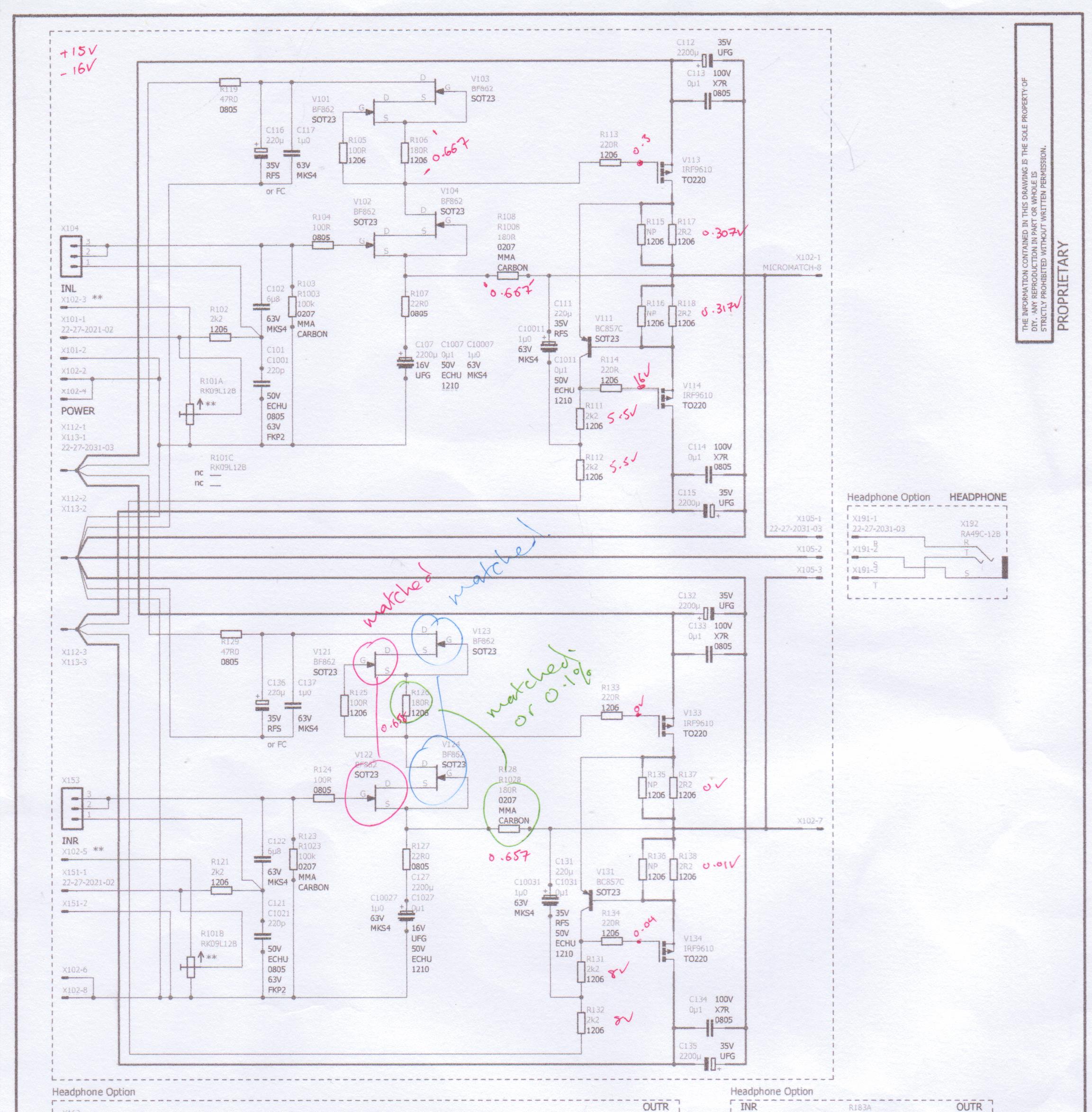

Here's measurements on the schematic - jfet stages seems to be working - similar voltages on both channels, mosfet stage - left (distorted) channel has 0V at the gate of both mosfets, and across R137 & 138.
Would bad mosfet(s) on the left be the conclusion?

There are only a few ways for the G of V133 to be 0v: a solder bridge on G to ground plane on opposite side, or for MOSFET to be dead (open circuit). As R133 is connected to JFETs which appear to be working, there should be similar voltage to L-channel. Are you certain that those are IRF9610 (P-channel) installed on V133 and V134?
So there is something very different between your two channels. Check the bad channel vs the good channel part by part - make sure all resistors are the correct value.
You verified that all installed MOSFETs are indeed P channel? Sometimes they put an N channel in a P channel tube. And we take it out and use it without looking to see if it is the right part.
All the resistors are correct values (checked SMD parts based of case marking - didn't measure), MOSFETS on right channel were good - pulled them and tested on those parts testers, confirmed working & P channel.
