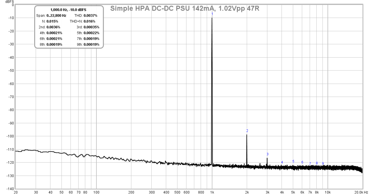

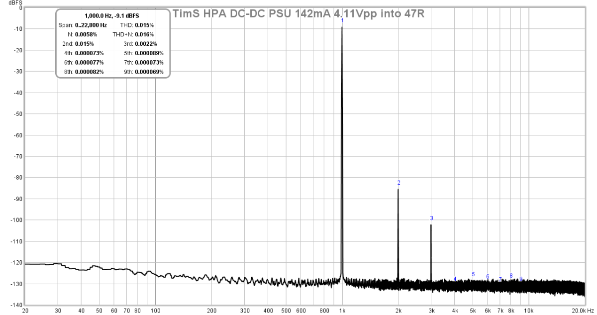

Some Measurements with DC-DC PSU
I think we can see that the new DC-DC PSU is working very well with the data here. It is almost like a battery in terms of a flat noise floor. A DC-coupled amp has a slight rise as frequency goes down to sub-audio (rumble range). But clearly, there is no 60Hz mains or any of its harmonics present.
This is my usual standard of 1Vpp into 47ohms FFT for intercomparison with my other amps. The level of third harmonic distortion is 10x less than second harmonic, which is very nice. This amp will have a clean and engaging natural sound to it. Data below is for 142mA bias made possible using 2.2R source resistors.
1.02Vpp into 47ohms:

4.0Vpp into 47ohms:
attachment.php
I think the higher distortions I am seeing may be result of thick film SMT resistors being used. I will need to order metal thin film equivalents.

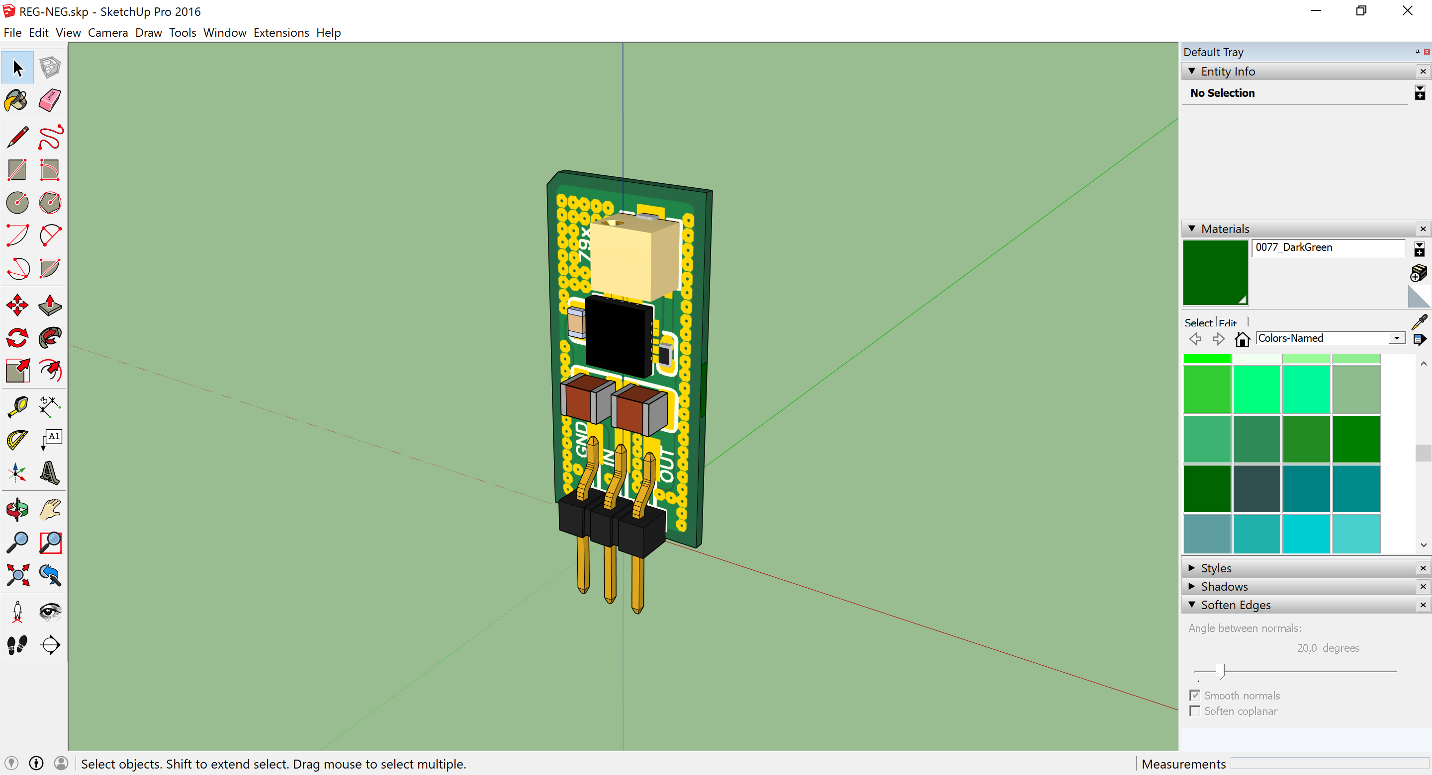

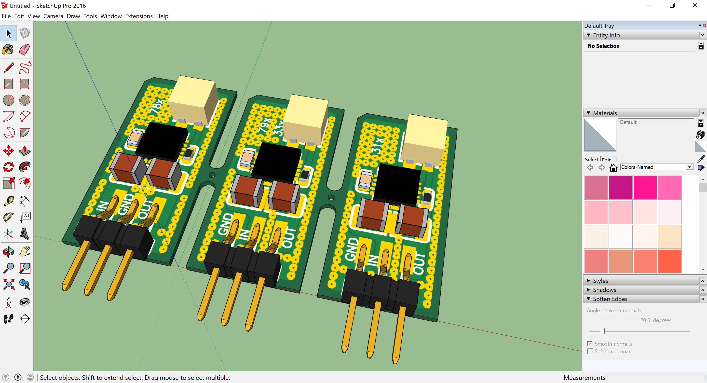

Thanks. To get this performance requires use of the TP7A4xxx LDO regulaors which are only available in quad flat pack with no leads and underside power pad for heatsink. They are rather tricky to solder (must be done with reflow) as needs a hot air gun from above and a hot plate from below, plus the pin pitch is 0.5mm. They don't make them in a larger package like SOTxxx or even SOIC where legs are visible. JPS64 is looking into getting some made to conform to a standard larger trough hole adapter board to resemble an LM3x7 TO220. One could use an LM317N or LM337N in SOT223, but the noise is about 10x higher at 38uV rms vs 4uV rms.

Could they be ordered from someone like say www.ldovr.com? Maybe we could do a GB for them?
I have bought one from there before - they are kind of pricey at $23 ea. Some Chinese ones are now in the circa $8 range (but not TO-220 pin compatible -but that's ok).
TPS7A3301 -5V -9 -12 -15V -18V 1A Ultra Low Noise LDO Negative Voltage Regulator 699924389058 | eBay
TPS7A4700 Low Noise Power Module DC-DC 3-36V to 3V 3.3V 5V 12V 15V 1A Adjustable 699901905578 | eBay
So these are also an option.
