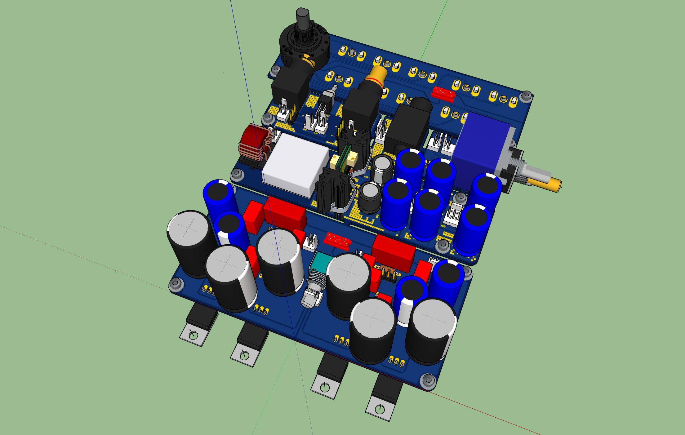

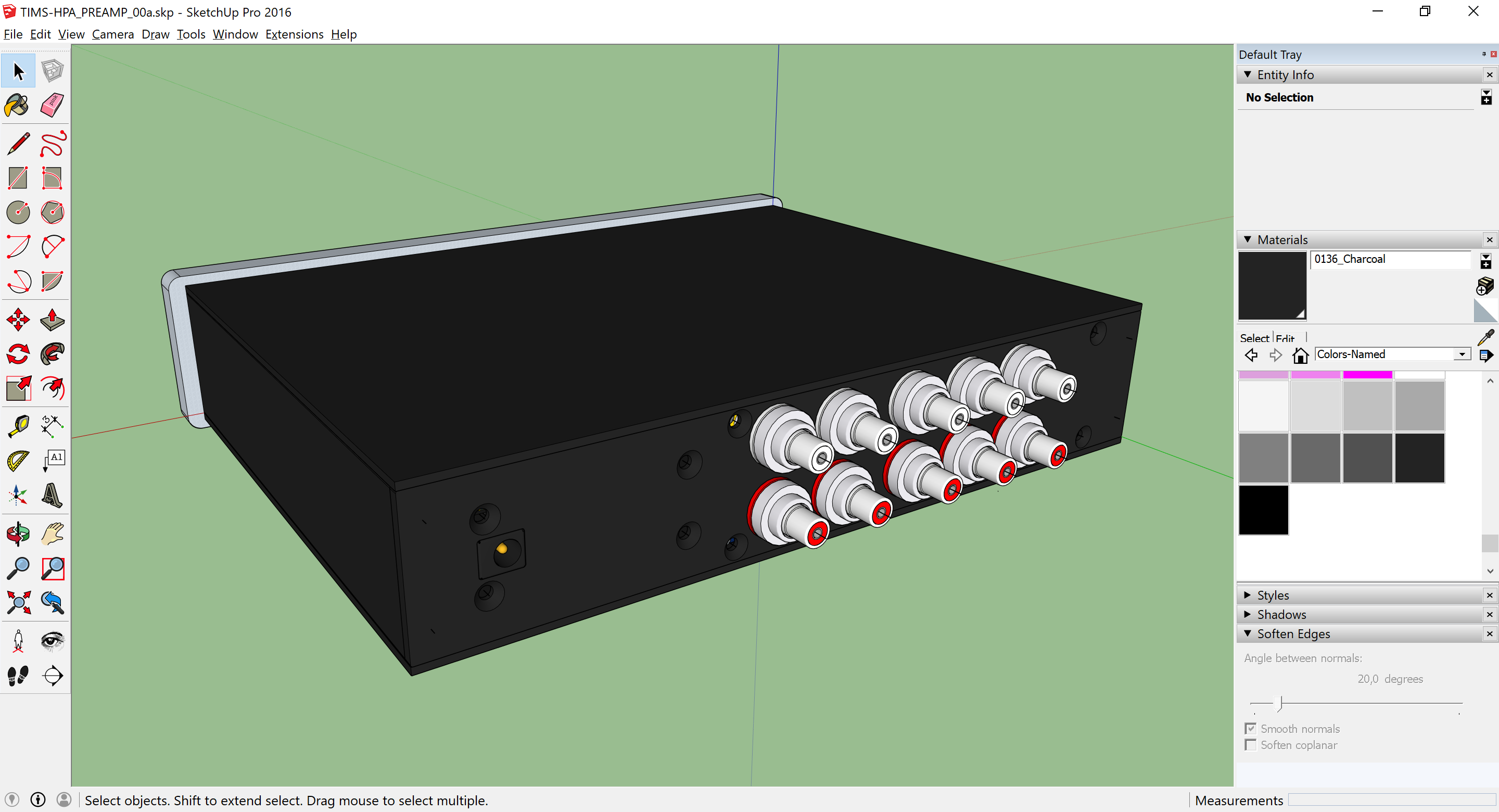

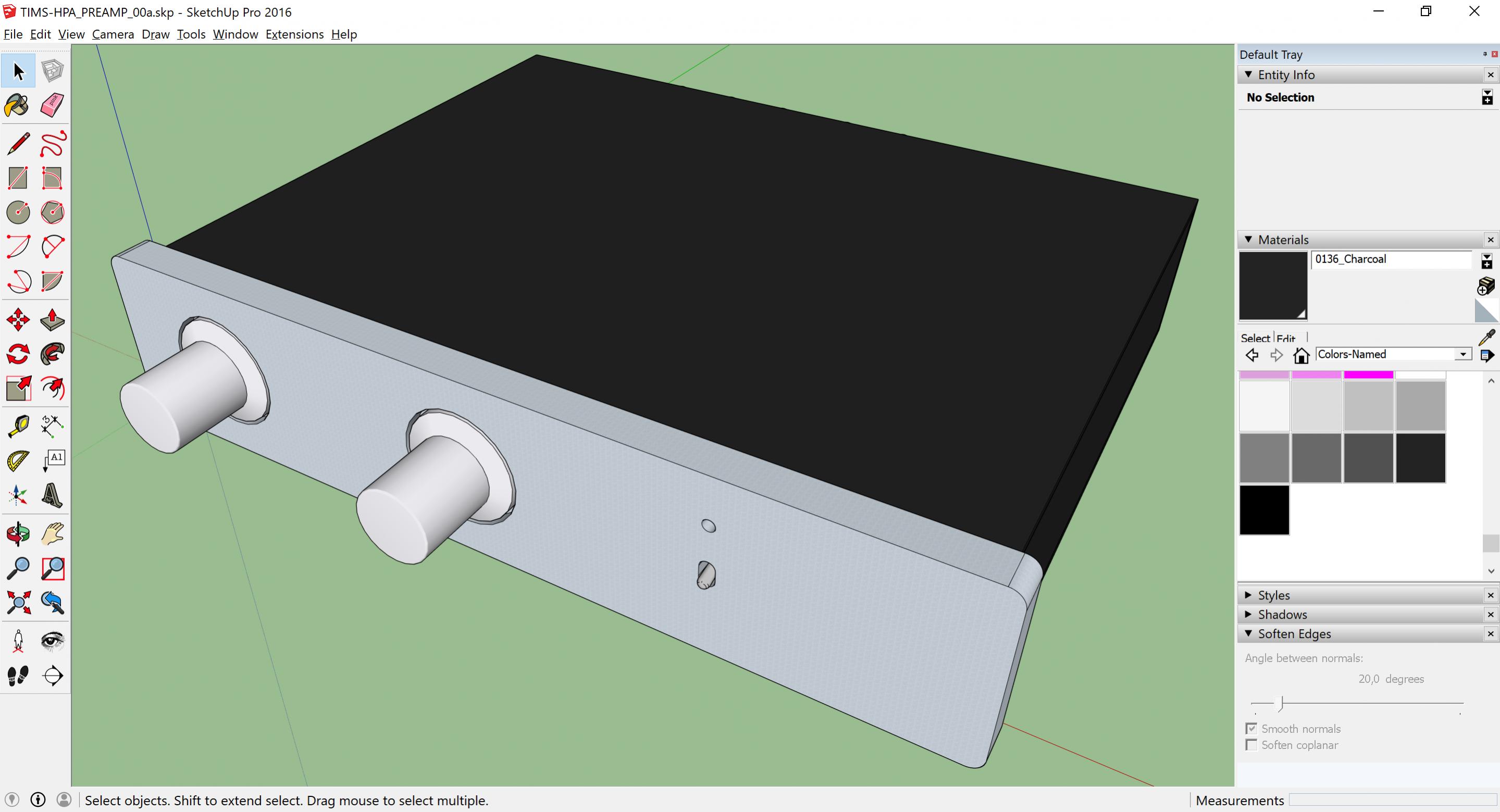

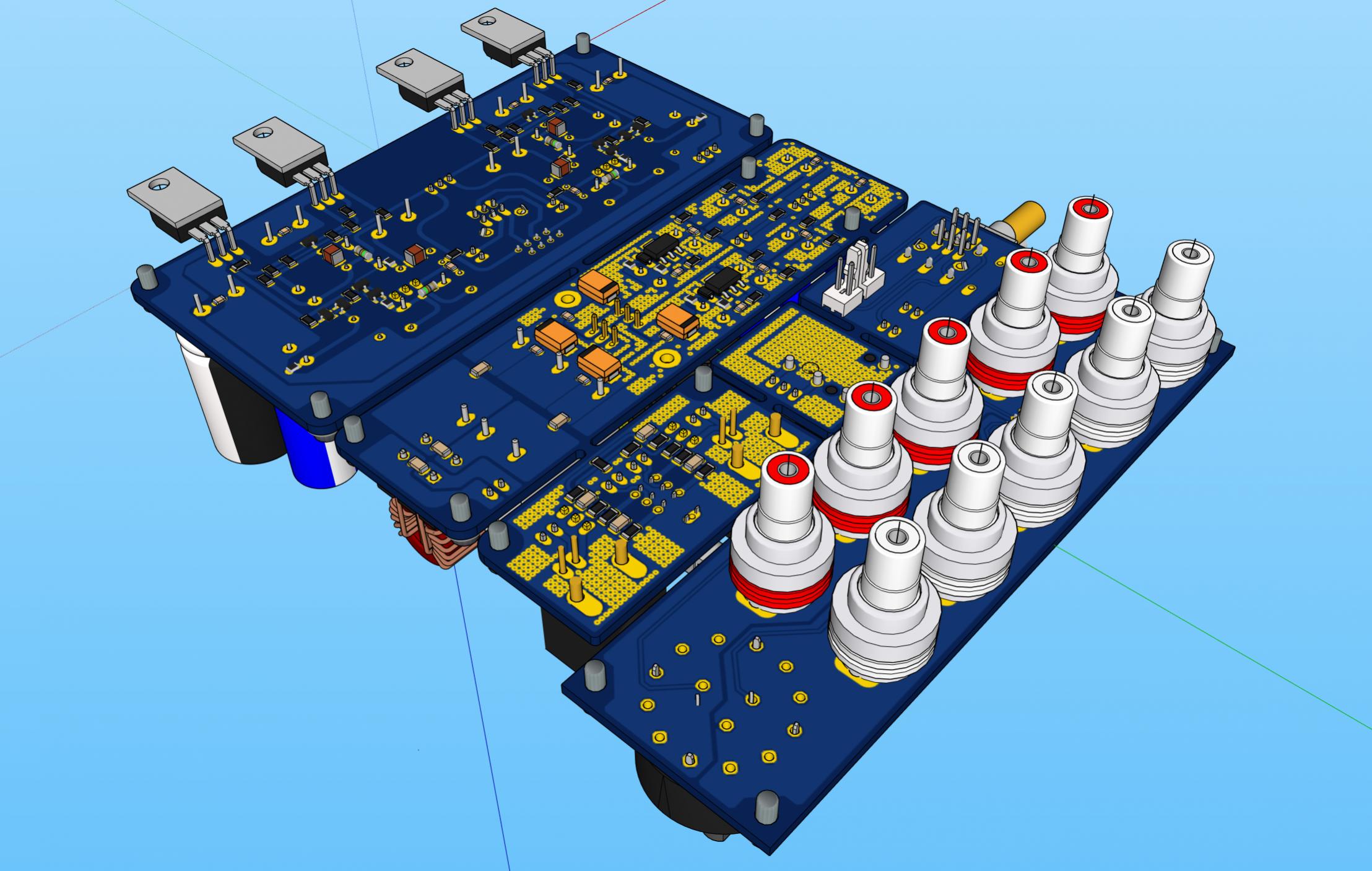

More progress from JPS64... The HPA is now also a very capable preamplifier with optional multiple input selector board. What type of RCA connectors do folks like? If you have a good one to suggest please do. The ones shown here are rather pricey at about $12ea (per jack).
If you do not need the multi-input preamp feature, simply skip the sub-board.
I was thinking of these from Switchraft, gold plated copper alloy, no shared grounds:
PJRAN2X1U01AUX Switchcraft | Mouser

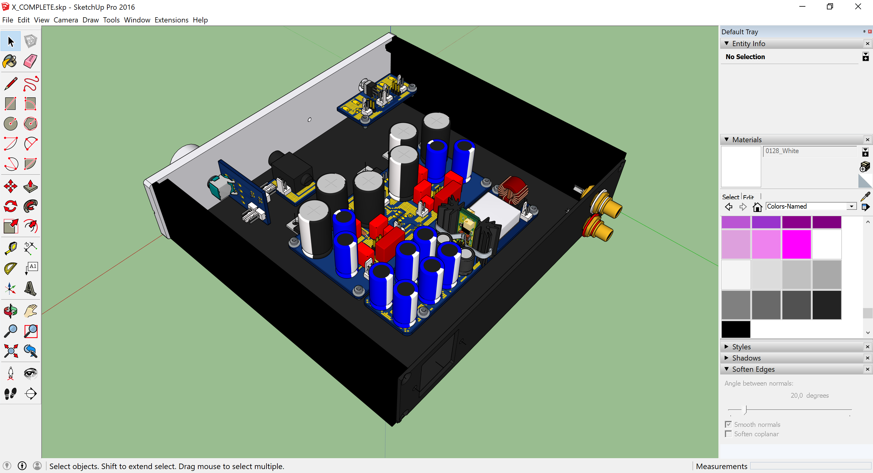

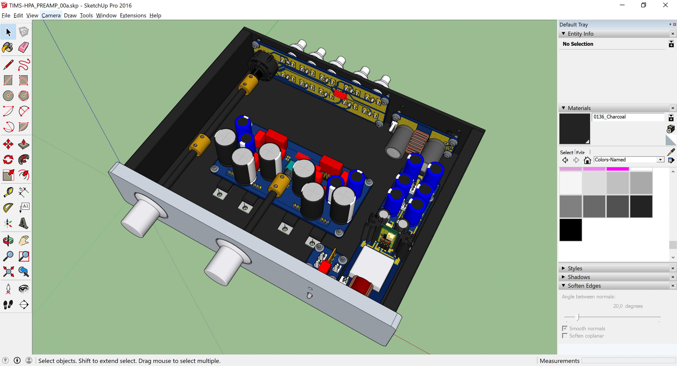

Hi X,
prefering this one: Mayitr 8 stucke Rot + Weiss RCA Buchse Chassis Hohe Qualitat RCA CMC Buchse Phono Kupfer Stecker Amp HiFi in Mayitr 8 stucke Rot + Weiss RCA Buchse Chassis Hohe Qualitat RCA CMC Buchse Phono Kupfer Stecker Amp HiFi aus Anschlusse auf AliExpress.com | Alibaba Group

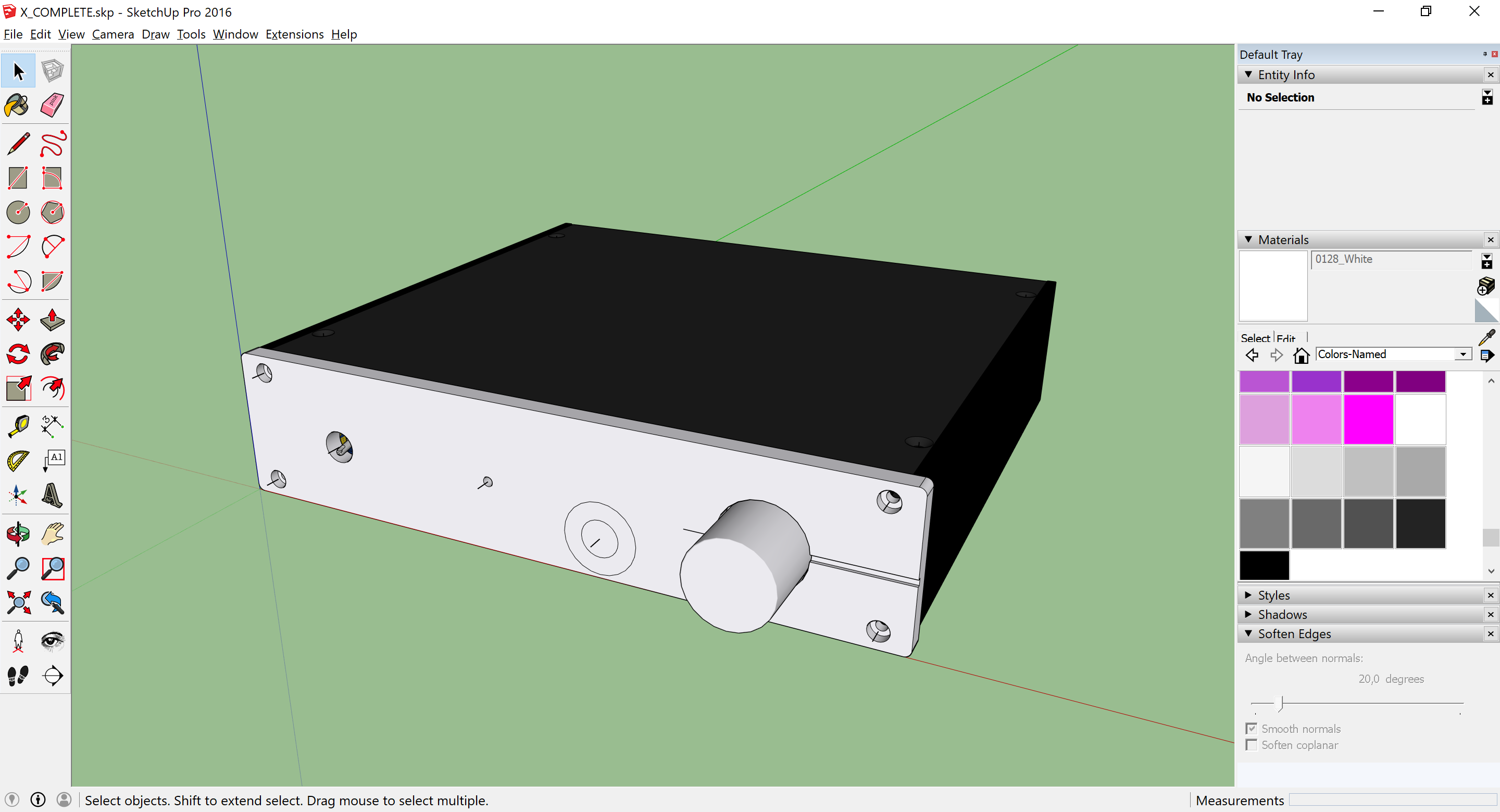

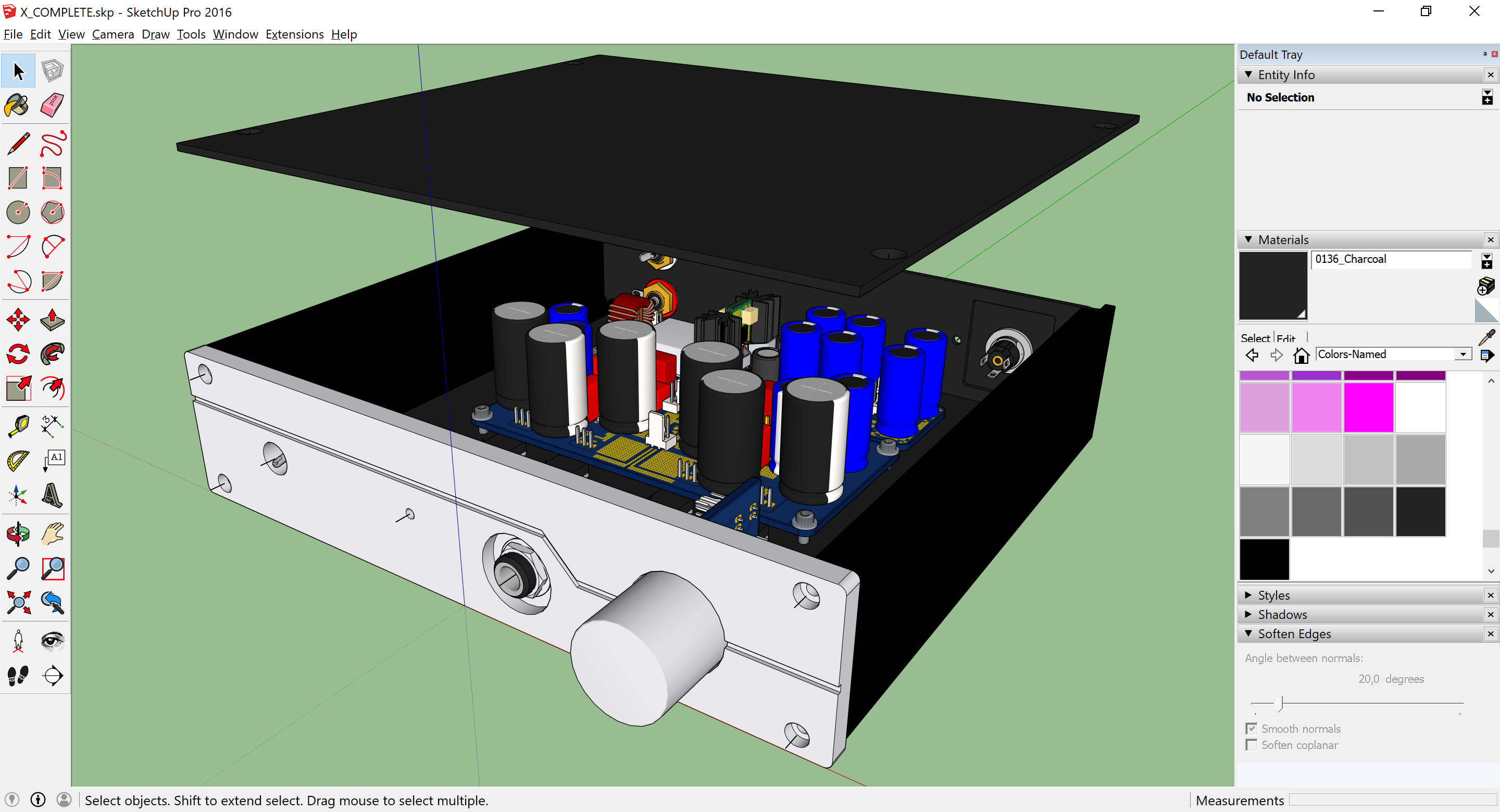

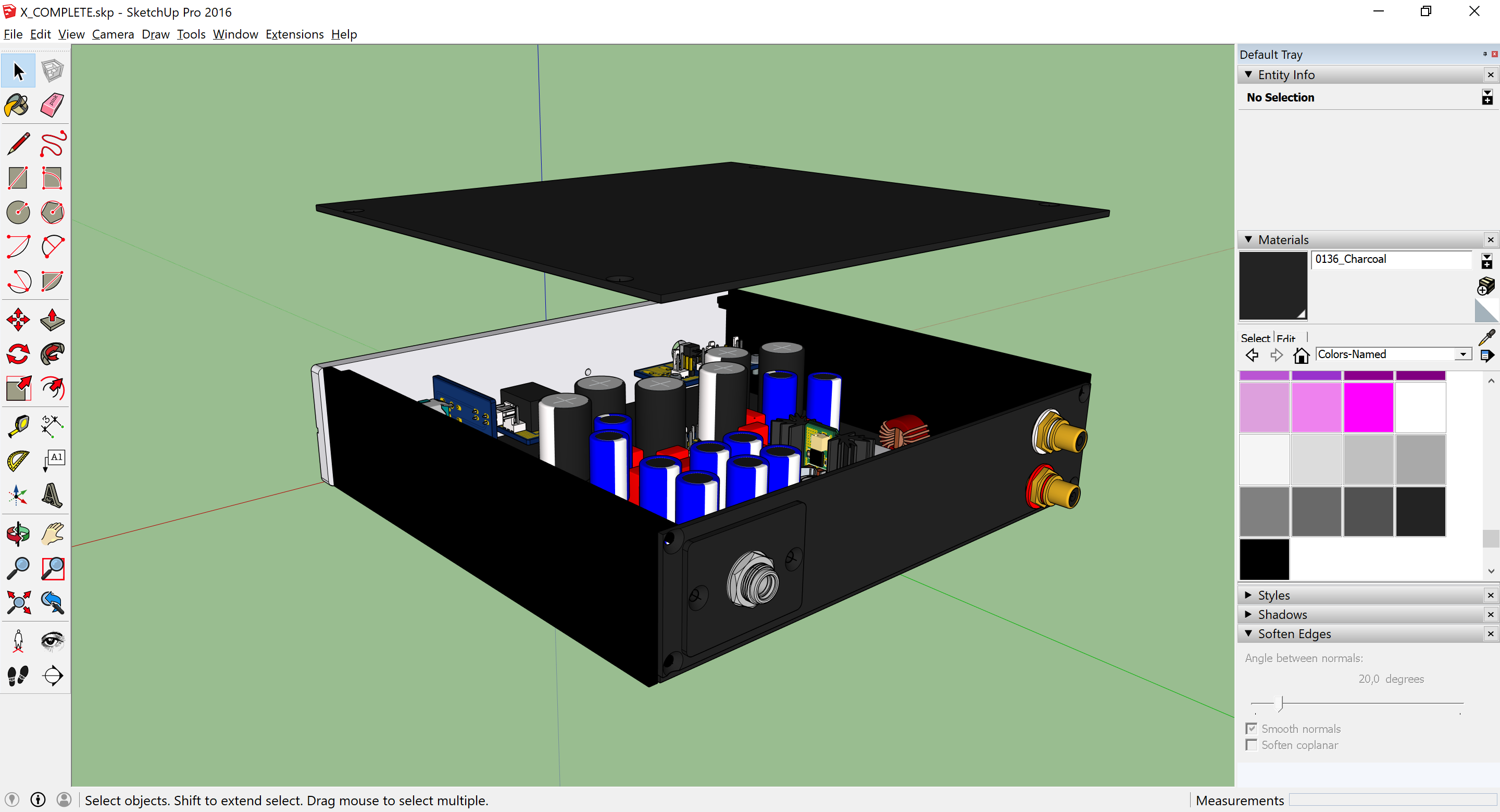

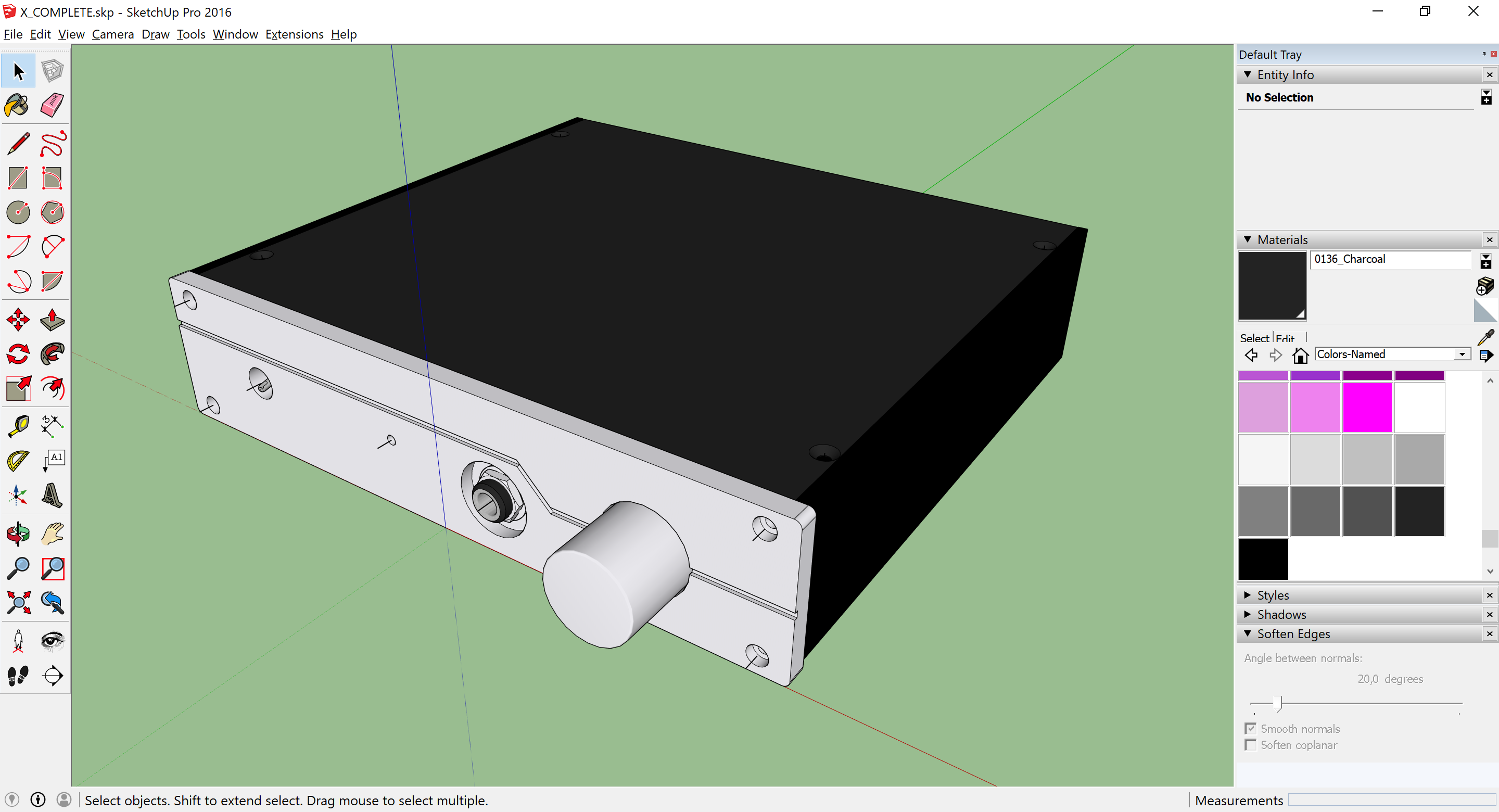

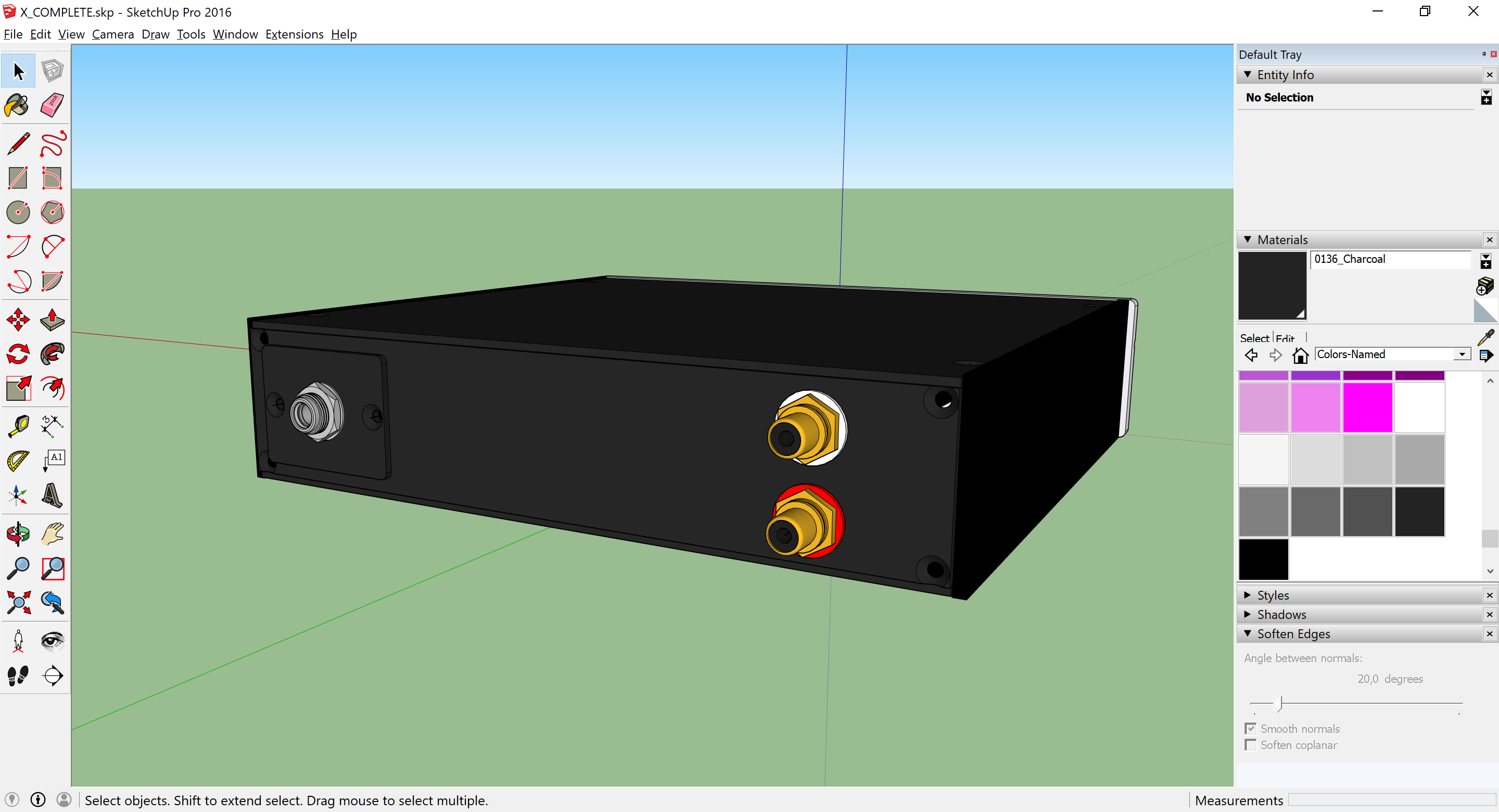

Finishing the preamplifier version, starting headphone version using your enclosure.
JP

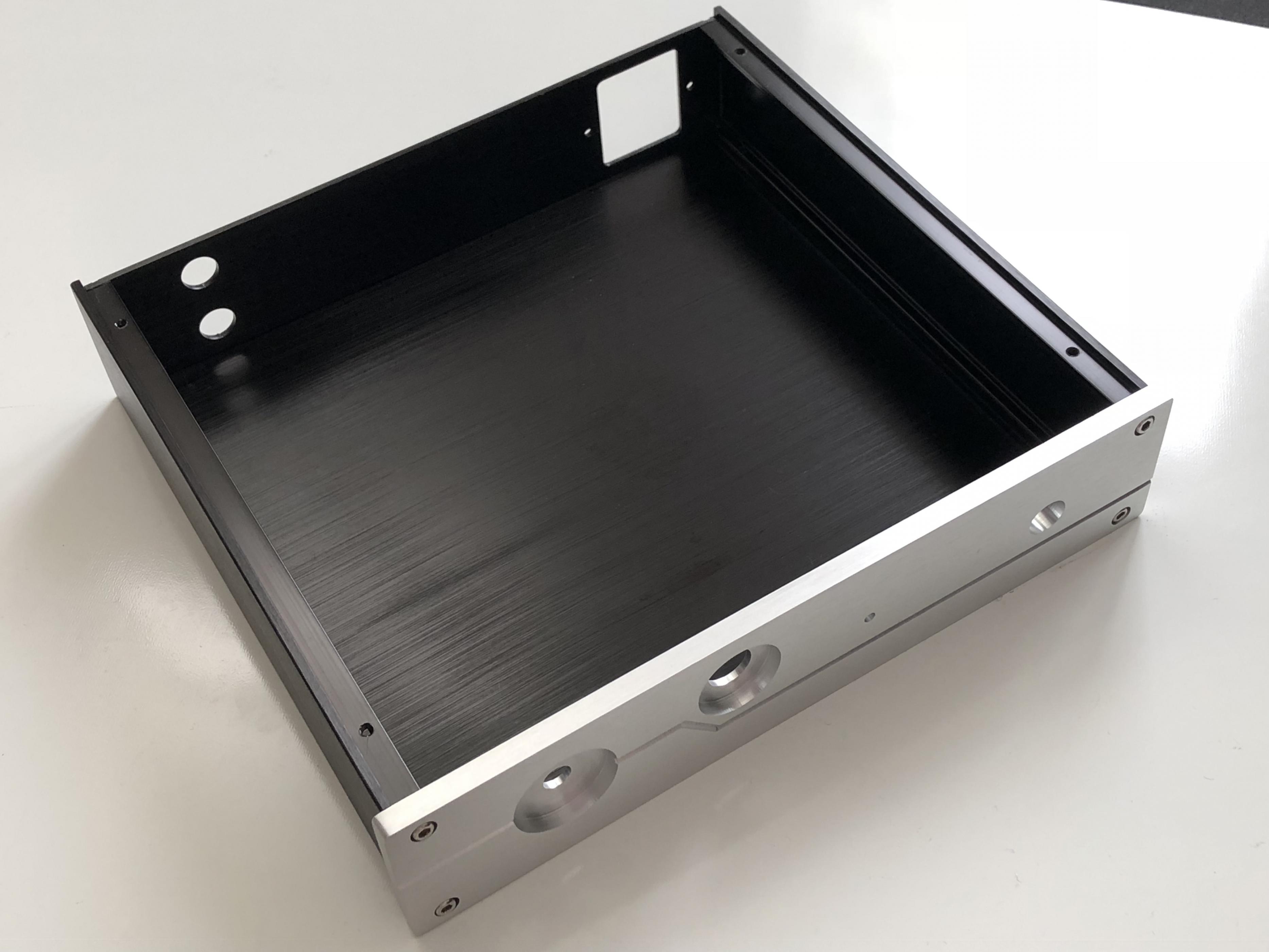

Wow, that looks beautiful, JP!
Here is the case from Aliexpress that you modeled in 3D.
PH I Headphone Amplifier All aluminum Chassis Preamplifier Enclosure Mini Case DIY Box-in Speaker Accessories from Consumer Electronics on Aliexpress.com | Alibaba Group

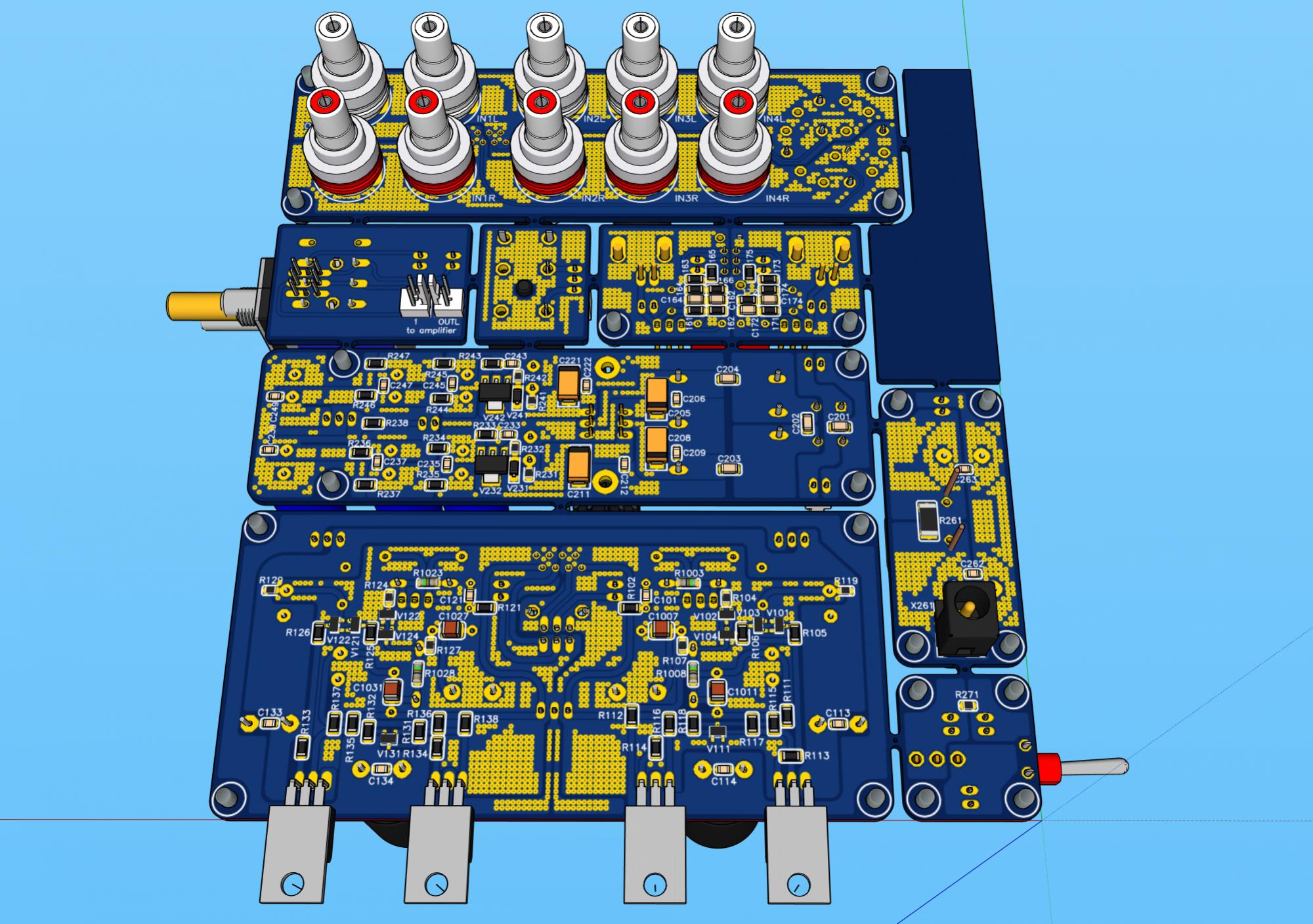

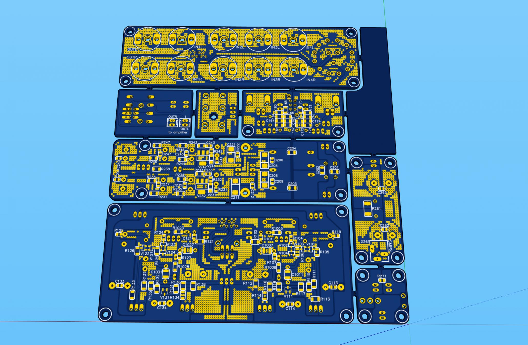

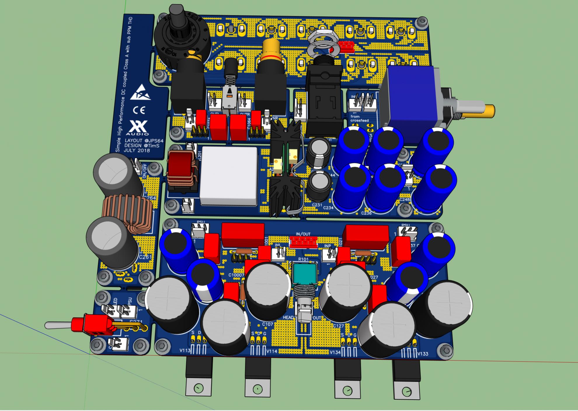

Simple Class HPA and Preamp Production Data

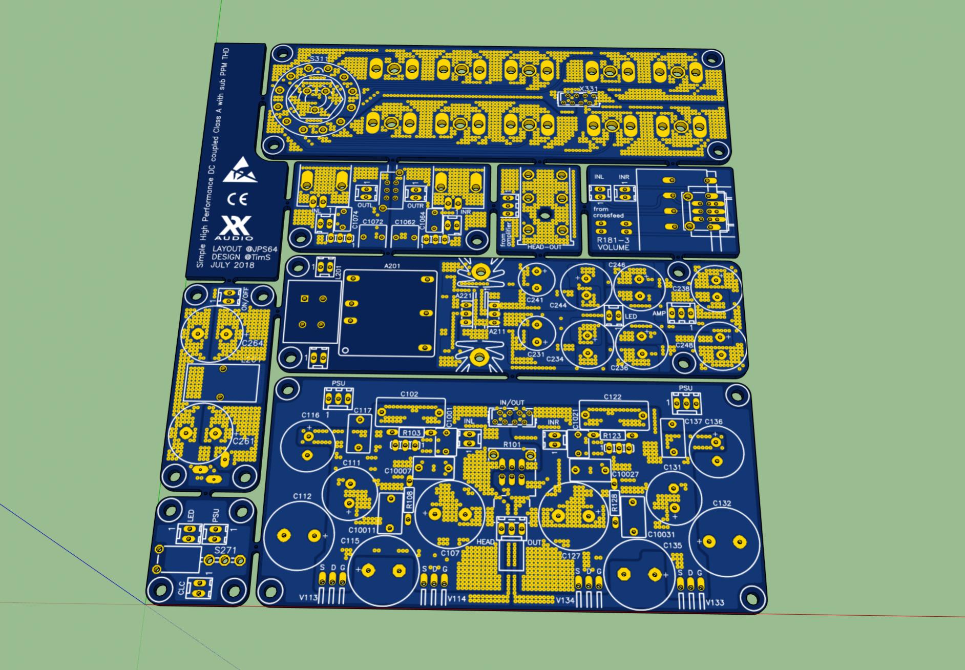

Many thanks to JPS64 for his untiring efforts to produce a magnificent set of professionally-done layouts and uniquely flexible design for either a HPA or a Preamp.

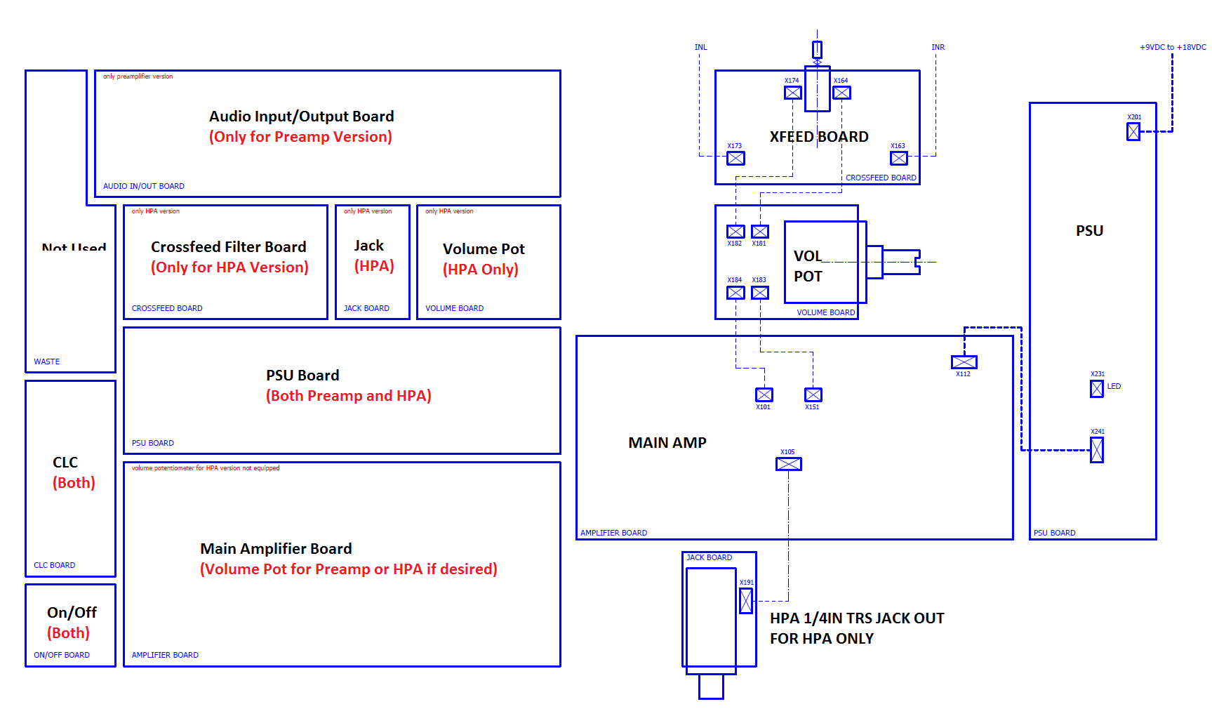

Here is a block diagram showing how the single panel with 8 sub-boards can be mixed and matched to produce either a HPA or a Preamp with multiple input selector jack:
The panel includes following boards:
For the preamplifier version, the following boards are not used: the crossfeed, headphone jack output board, and volume potentiometer.
For the preamplifier version, use the potentiometer built-into the main amp board; for the headphone version, use the separate volume potentiometer board.
Of course, you could use the external volume pot board for the preamp if you wish. The panel offers a wide range of possibilities.
Here are 3d renders:
The detailed schematics and stuffing guides are attached below as PDF's.
Comments/feedback welcome. If no more changes we can move to actual GB and I will start collecting payments via PayPal invoices.
The PCB's will be 2mm thick, with 2oz copper and gold ENIG finish and blue solder mask as depicted in renders.
Cost will be $28/panel (a stereo "set" as terminology was used when we originally thought we were using separate mono boards).
Shipping costs will be $5 in USA, $10 for Canada, and $15 everywhere else.
- input and source switch board (only preamplifier version)
- crossfeed board (with defeat Xfeed ON/OFF switch)
- headphone jack output board (6.35mm stere TRS output jack)
- volume potentiometer board (with the possibility of three different types of pots)
- PSU (includes CLC, DC-DC dual rail step up, cap Mx, CRCRC filter to produce battery-like rails from simple 12v wall-wart)
- CLC filter board (in case you want to use your own PSU)
- ON/OFF switch board
- amplifier board

Wow! VERY nice JP and X! Can't wait to get my hands on this one. Any update on the status of the voltage regulator boards?
In a pinch, you can use a plain old LM7818/7918 pin compatible with the regulator boards and it will sound very good. Then when the boards come in, swap them out.
Absolutely incredible, Jean-Paul, formidable!!
How you do produce this work so quickly? You an X could be twin brothers.....
Thank you, this is amazing.
Hugh
