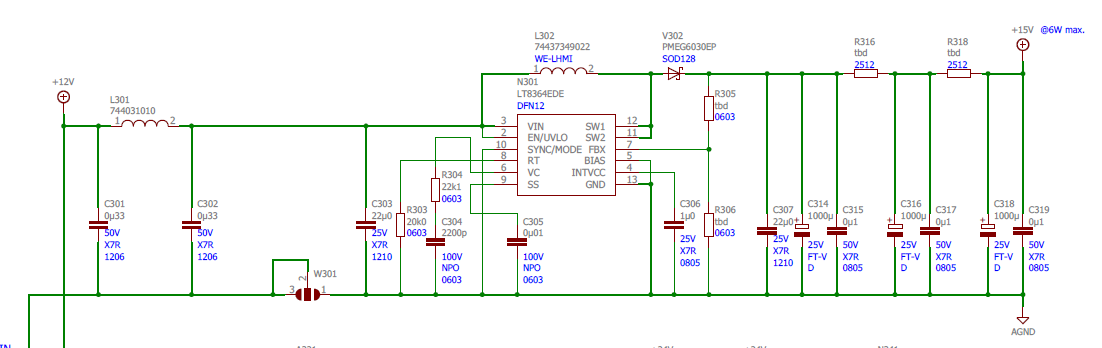

This was in this month's electronics magazine. Didn't search up the cost of the Ics but the title was "using two cheap ICs to generate +-15V" (intended to be used for amps).
What do you guys think?
Thanks for this - sort of what JP and I were already thinking. We have in fact, implemented the following in another project as a +15v source, and were looking to make a dual rail version. I did not know that you can the output of two units from same input to get a dual rail. The output must be isolated from the inputs for this to work.

JPS6 4 just found this nice +/-15v DC-DC design from TI:
http://www.ti.com/lit/df/tidreq7/tidreq7.pdf
BOM is about $14 ea.

Hey guys. Looking for any alternatives I can find for the Traco DC/DC converter. The Traco is $41 by itself. I noticed there is a Traco that is $1 cheaper that uses 24V input. Could this be substituted for the 12V input Traco? $1. Big deal. I know. But there is also a MeanWell DC/DC that is only $20, half the cost of the Traco! Problem is, it doesn't fit on the PCB. Would hookup wire be an alternative here or does that defeat the advantage of the PCB mount DC/DC? Here's a link to the MeanWell. Very similar specs to the Traco. Just a few less mA on the output current.
MeanWell 24V Isolated DC/DC Converter
