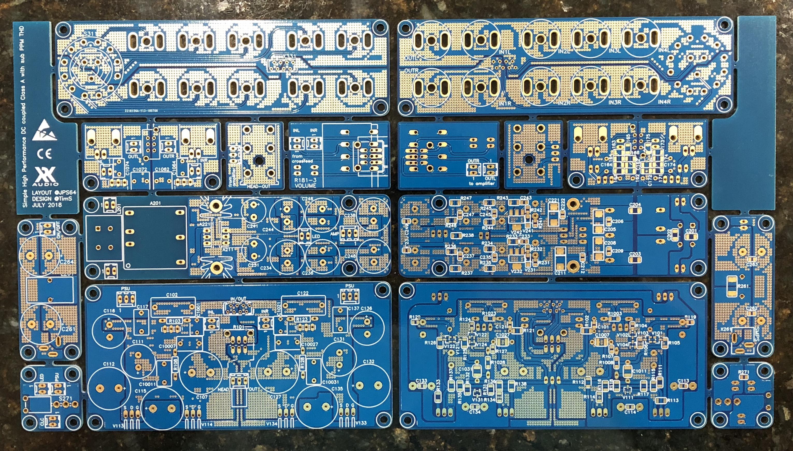

The PCBs arrived and they look great!
Thanks, JP!

Thank you Jwarch for making the comprehensive Mouser shopping cart! It is a huge undertaking and the one you put together is quite inclusive and has options and choices for different pots etc. I am still trying to wrap my head around the critical parts needed for a HPA build, which I believe, is the more popular application for this project.
Related to this is the ultralow noise TPS7Axxxx voltage regulators made by LDOVR.COM - member Badboygolf16v has been in contact with the vendor and says he can secure a 15% discount for us - not sure of the details if this is a GB or a coupon code. I will let him handle it if indeed it is a group buy. But thanks for your efforts Badboygolf16v!
I will send out the boards to everyone this weekend.
