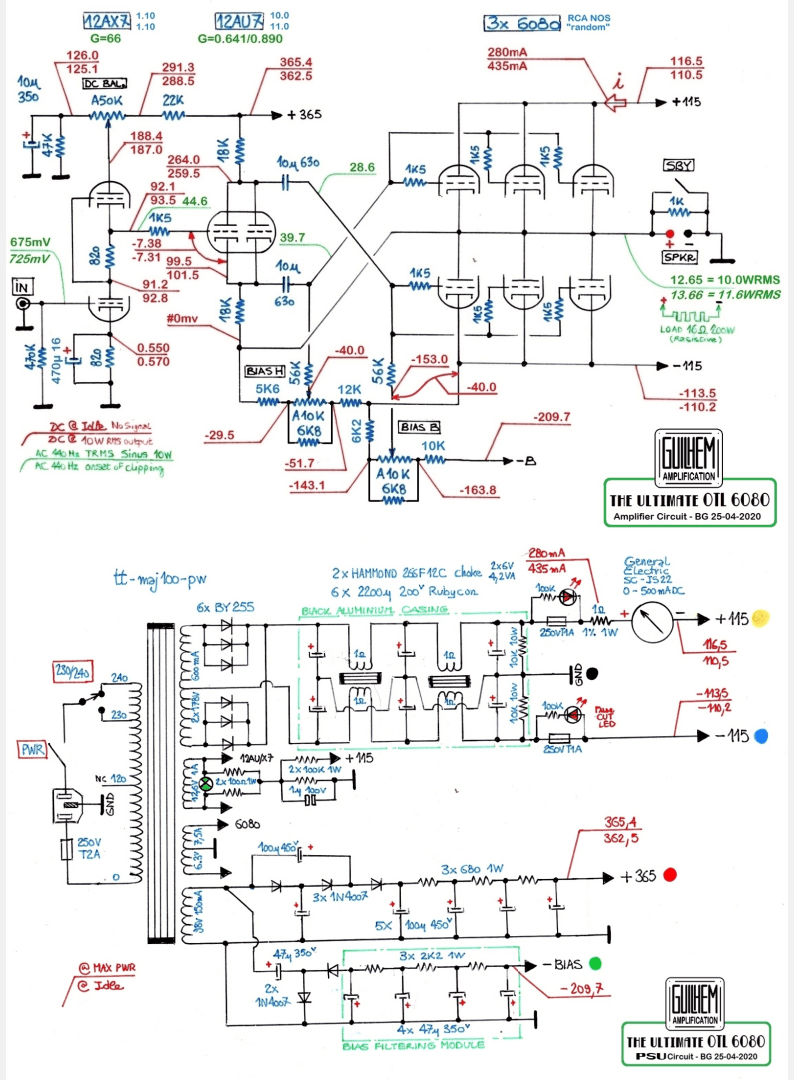

I built those 20W OTL with 4x6080 / 20WRMS fixed bias (below) in 1996, I sold them in the mid-2000 to a friend who still owns them without issue since then, if we except a set of new tubes :
I sold them because... They were heavy and big ! 🙄 But that's nonetheless true, compared to the size of my U-OTL of today !
T
So when I think simple, I think about the minimum possible number of components and adjustments, and there the auto bias 6AS7 clearly wins over fixed bias, still being able to deliver the circa 5W into 72R.
Still I am currently making a more powerful OTL with fixed bias: yesterday I put the 3 extra 7VAC windings on the toroidal, they feed voltage quadrupliers for generating about 32V for the fixed bias. This toroidal I took out of some discarded equipment. It had an 18V winding to which I added some more windings to get 22V for the 22JF6, then I added a 6.3V for the E180F drivers, and yesterday the three above-mentioned windings.

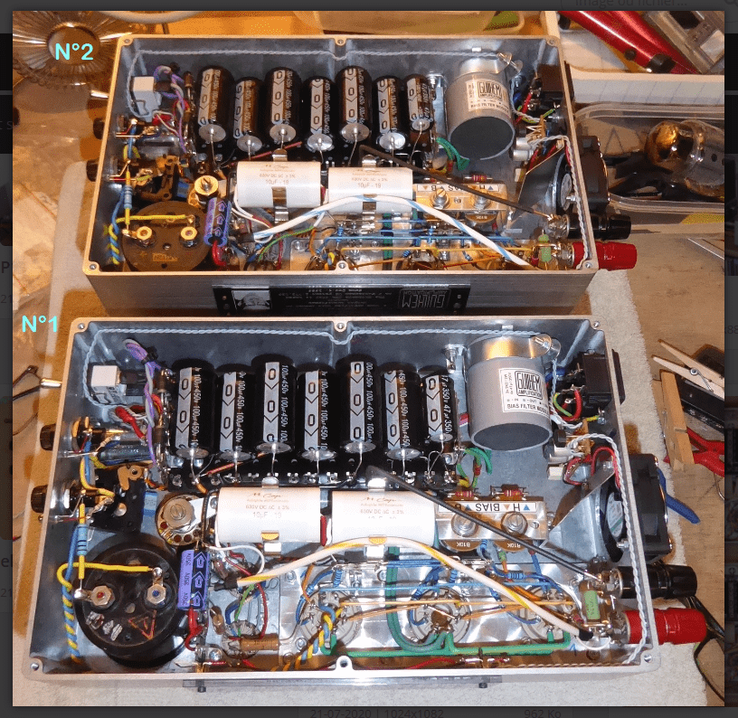

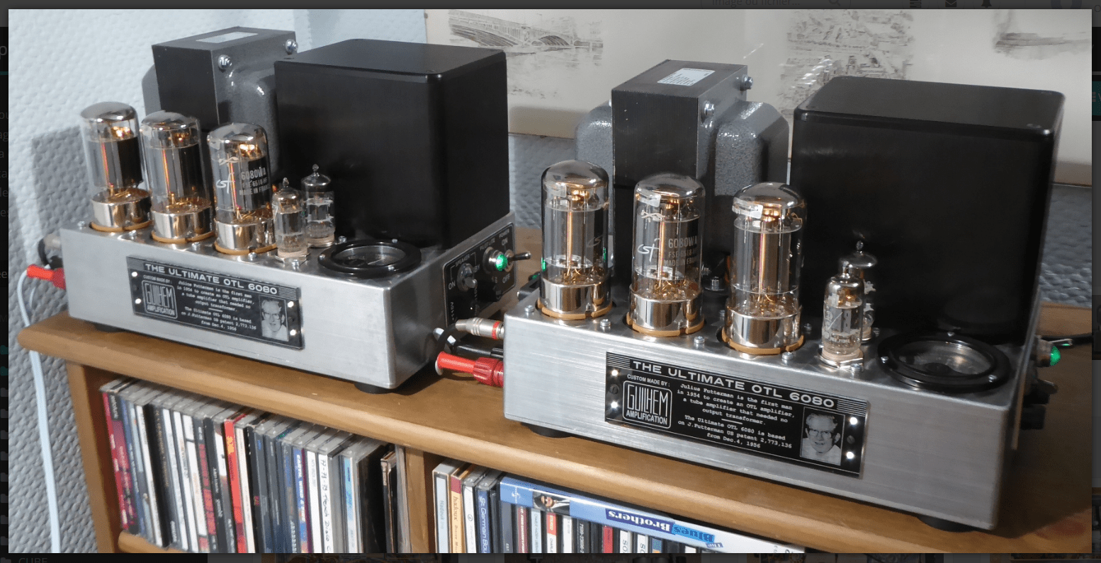

Yes @ErikdeBest : I like to post images, it speaks better, and follows as far as possible the rule "No picture ? Never existed !" 😉
Without wanting to show up, OK ? I must confess that I am sometimes reluctant to share my schematics, because I found many of them on several websites, webpages and forums, posted by people who claim to be the creator, or commented by pseudo-experts - if you see what I mean... Like "poor design, too small, it will burn, too simple, it won't work, you should have used a 12AYFG8BZ in ultra-cascode-bootstrap-fet-machin !" 😱🤣
But I follow the rule here : "pictures, it exists, and it works"...

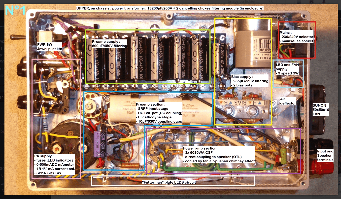

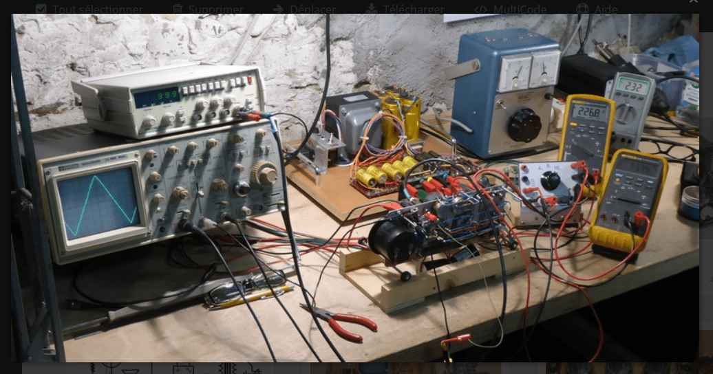

The protoype under tests in 2020-2021 :
The finished version in late 2021 :
I usually use them to drive a pair of Triangle T17FL2 fullrange DIY speakers or a pair of Klipsch Heresy I (with corrected crossover).
Here's the matching schematic of one mono block - you recognize Mr Futterman's 1956 original OTL patent principle :
And the inside layout :
SPECS :
- nominal power output 10WRMS 16R.
- input sensivity = 0.675V @10W.
- THD = to be measured soon... One of these days... When I'll have my measurement gear set up again !
- bandwidth = 1Hz-200KHz @-3dB 10WRMS 16R.
- output impedance = 20 Ohms.
- no global feedback loop.

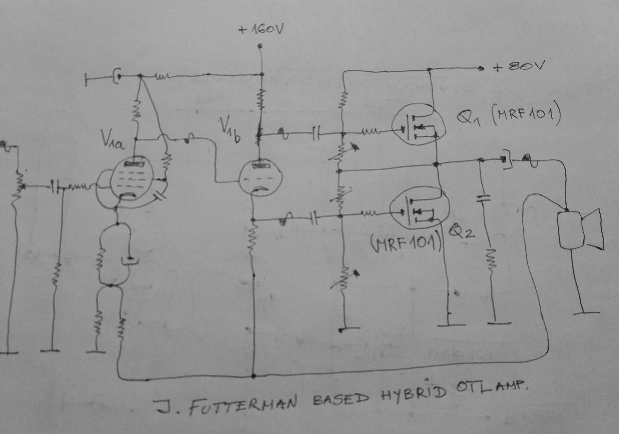

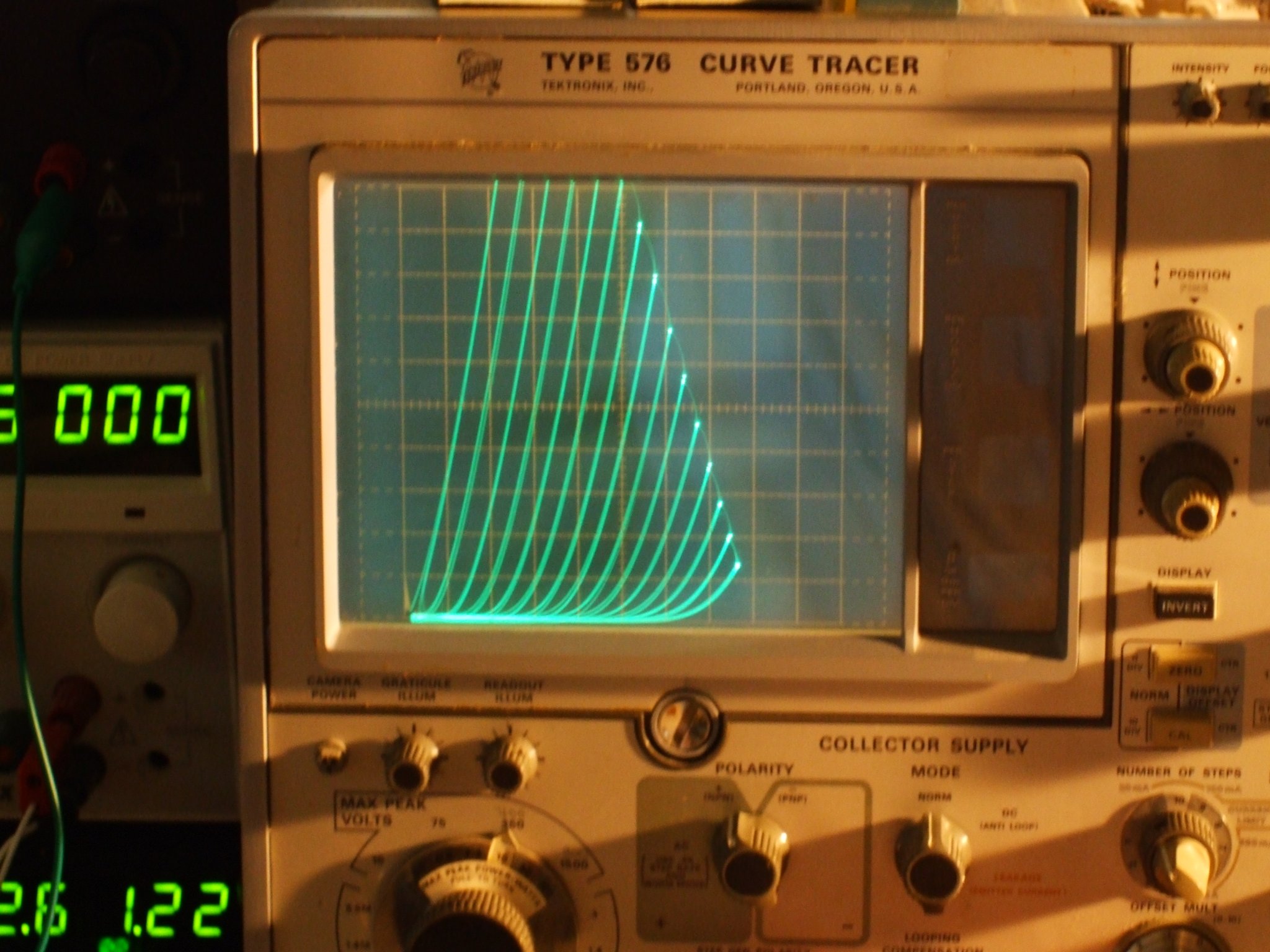

IMHO one solution and substitute for full tube OTL can be the Hybrid AB-class OTL amp , where input voltage gain stage and driver stage remains tubes, but output power devices are modern RF Lateral Mosfets , for example NXP- MRF101 , intented for linear amplification with relative low internal capacitances , it is one very ruged and easy available 182W device .
Is another hybrid solution to create a low impedance output stage, and then the requirements for the OPT make it much easier to use a smaller and cheaper one. The original poster only wanted to avoid the iron and copper of a big OPT.
Just put some constant Beta bipolar transistors under the output tube's cathodes to form a Darlington output for each. Can still be an OTL like design. Then you still have some "output tubes" to display on the chassis. Some little 48V switching power supplies to power the output stage transistor collectors.
I have seen such solution but I don`t like it because over the time such hybrid OPS will shift DC parameters in function of asociated tubes aging , mine idea is to use small signal pentode/triode tube such is ECF80 or simmilar tubes to directly AC drive the gates of SEPP-OPS , since driving power @20Khz is not more than 100mW for those lateral RF- N-type power mos-fets , and what ever happened to parameters of ECF80 tube OPS-DC parameters will stay stable , positive side of those RF-Mosfets is that they have negative tempco, so no special temperature compensation unit is neded ,
of course my schematic form post #87 is only conceptual , since in reality positive bias network for OPS is a little different , ...

The linear MRF Lateral Mosfet outputs will probably sound -more- linear than the real OTL.
The bipolar NPN Darlingtons will just multiply up (Beta ) the "output" tube currents, so should still sound just like a tube OTL. Re-biasing for aging tubes is just normal procedure for any tube Amp. The "output" tubes here will just be small signal tubes in the Darlington case. Should last a long time. NPNs doing the grunt work. Maybe 6197 tubes, got tons of them, $ 0.35 each. (nice curves below)

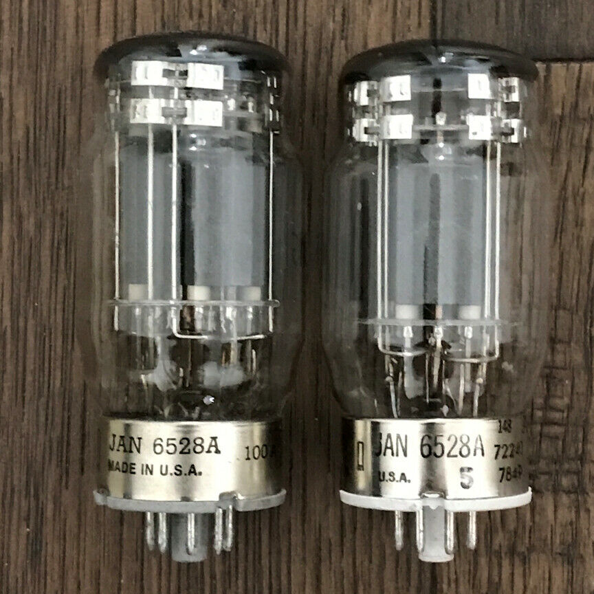

I'm ordering an 80 Watt 1200 ct P-P OT to make a trial P-P Amp with two 6528 regulator tubes. With a switch to flip in or out the two resistors for the OTL cheat patent. 80 Watts conventional OT P-P or 80 Watts TOT. ( Transparent OT !! ) 6528 pics at bottom.

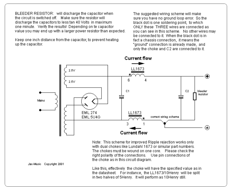

Thanks for the reply! So, the idea of the chokes is that they are connected as in this schematic by Jac-Music? Note this is not the CMC connection, normally used in audio. https://jandkaudiodesign.blogspot.com/2015/04/2-coil-choke.html
Oh, I experimented this cancelling-hum-transformer trick in the early-80s, with my first OTL amps... You can see it in this later 1996 20W/16R version below :
And in the present U-OTL :

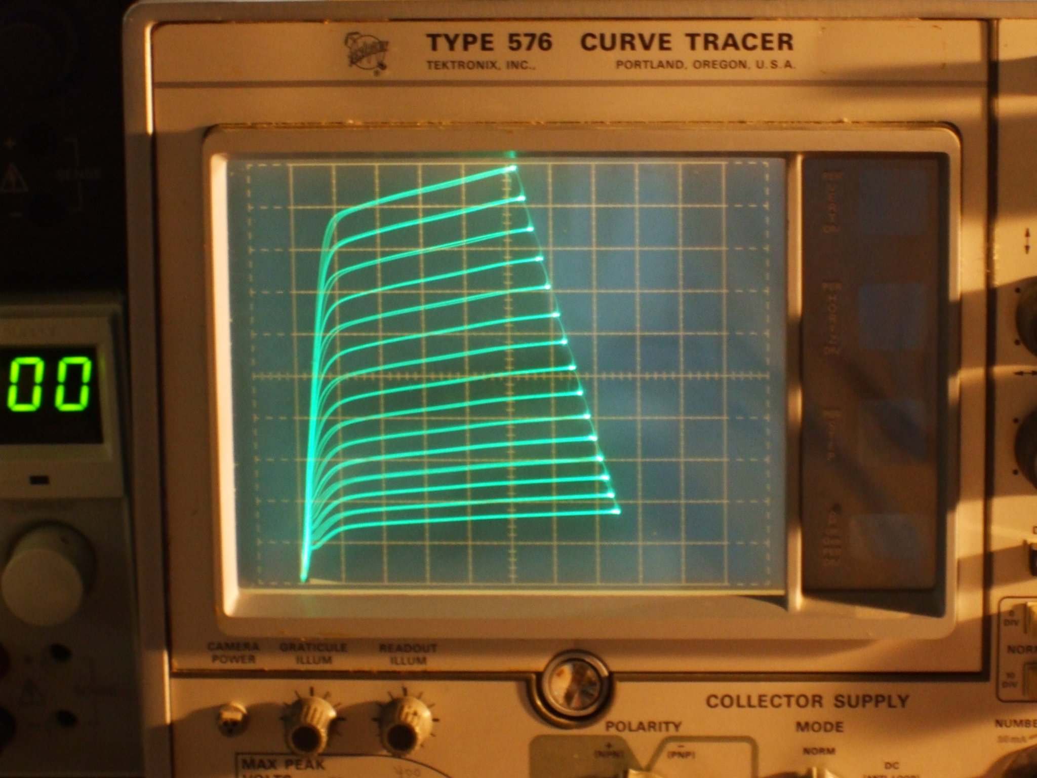

Old thread, but this schematic remembered one thing I built in 2010, almost equal to it.IMHO one solution and substitute for full tube OTL can be the Hybrid AB-class OTL amp , where input voltage gain stage and driver stage remains tubes, but output power devices are modern RF Lateral Mosfets , for example NXP- MRF101 , intented for linear amplification with relative low internal capacitances , it is one very ruged and easy available 182W device .
I liked very much this all-N solution when I first see it at that time, but...
The problem with it proved to be when the output gets in saturation. With every cap coupled high feedback amp, the coupling charges when the output ceases to respond to signal. This plays havoc for some time, making some big thump in the speakers, since the MOSFET goes to full saturation ("pumping"). Tube OTL with feedback also have this effect, but is more gentle, since tubes have less transconductance and not "switches" with low rds(on).
I bet your RF Lateral MOSFET can have better behaviour due to more relaxed saturation of it (I used vertical MOSFETs).
And gate zener protection is paramount here, also due to this.
One solution for it is never using it with low eff. speakers, for not saturating the output.
OTL not having global feedback is inmune to this by design.
