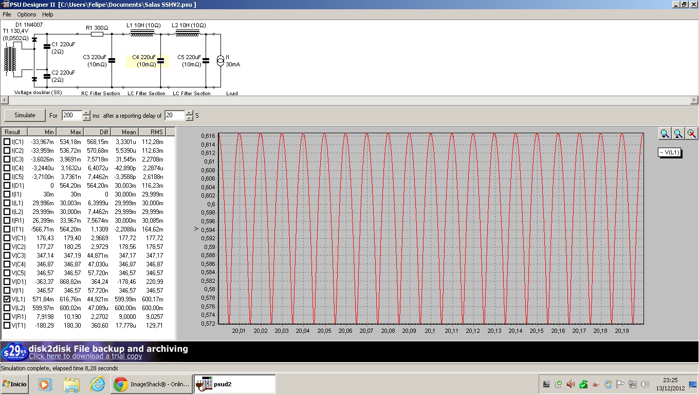

-I tried the voltage doubler because I have a Bartolucci 125VAC 100W that I don't use, your 6V6 tube lineamp uses 340VDC, others lineamp I'm experimentig uses 250VAC, 280VAC & 300VAC that's the reason I tried.
-I used the voltage doubler without the chokes: R/C/R/C 600R/40uF/600R/40uF with the Bartolucci tx and worked OK.
-Before to connect the new R/C/L/C/L/C I verified with a dummy load 15K to adjust the voltage & current working fine without burning nothing, only burned with the real load.
-I tested the wires between the reg & the real load & all wires are OK.

Is the real load referencing to ground, and where is the doubler being grounded? What happens if you don't ground the chain from doubler to reg to 6V6?
You can use two diodes in series where there is one shown, that doubles the peak inverse voltage spec.
Voltage doubler is not connect to chassis gnd, not connect to AC mains earth. Have I to connect to mains earth or to chassis gnd?
Yes, real load is grounded to chassis gnd, also SSHV2 is grounded to chassis gnd.
Thinking about the changes that I have introduced, now I use 2 chassis instead of only one and between both chassis there is no connection of AC earth, can be the issue?
