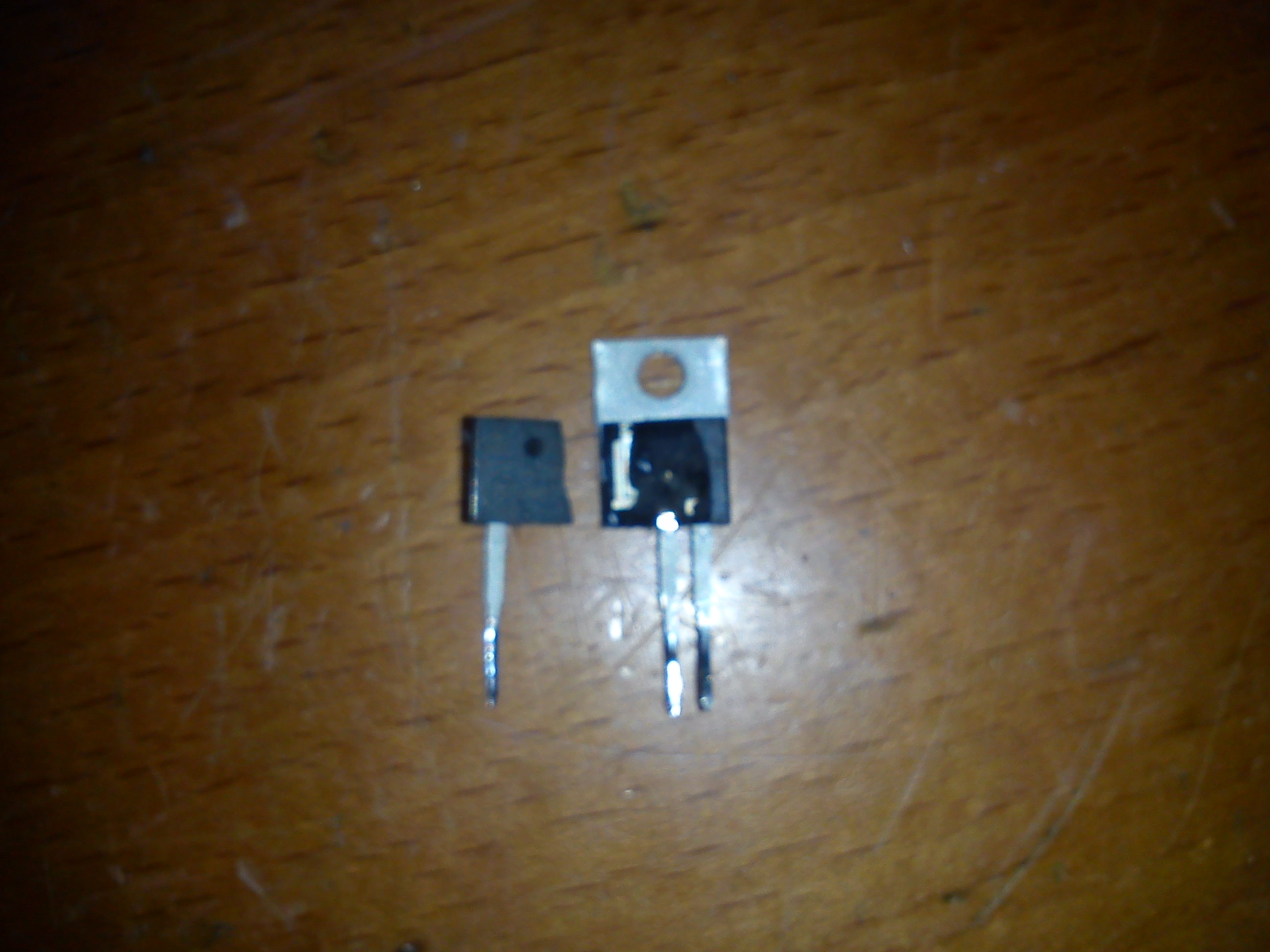

Thanks, this is what has happened to dn2450 heatsinked
That is from when the Caddock broke too?
They are both ecb. What your Atlas say, are the KSA dead or not?
My Atlas is broken
No, later other test with fuses installed and fuses broken also.
Looks like shorting somehow. Was it still on doubler or normal rectification?
Tx 240VAC not doubler, normal rectification.
