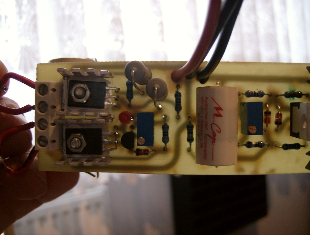

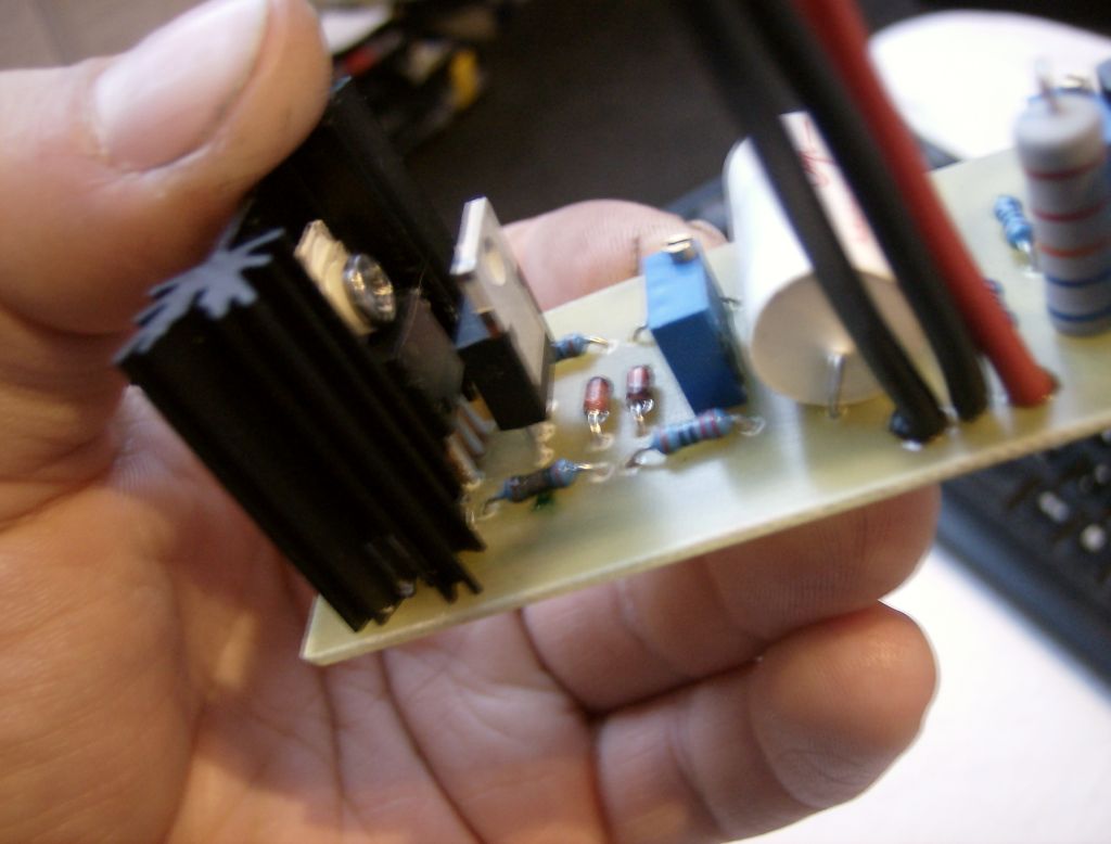

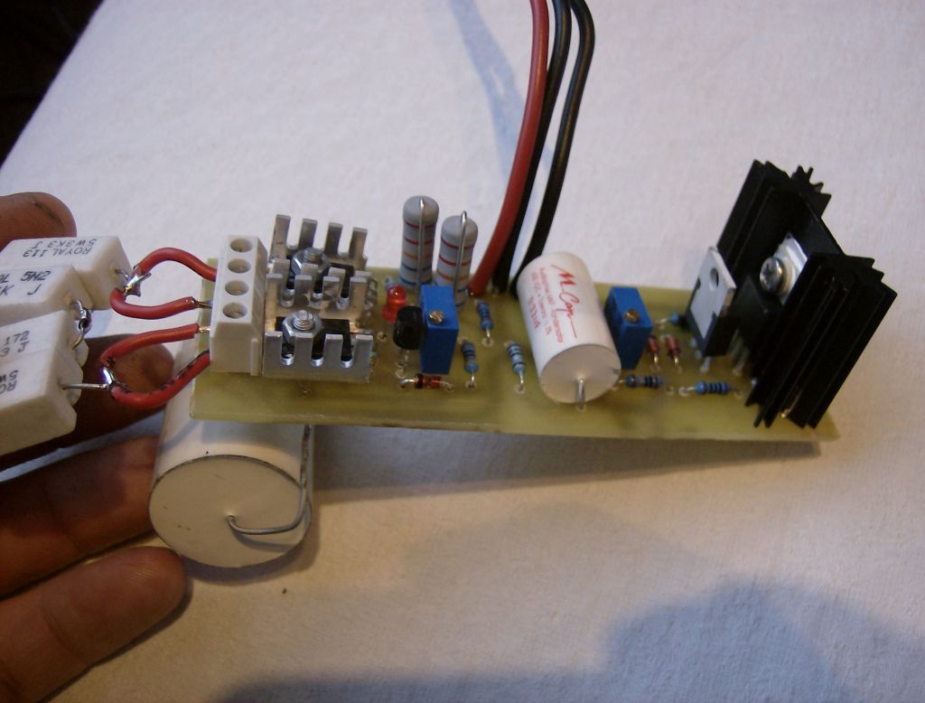

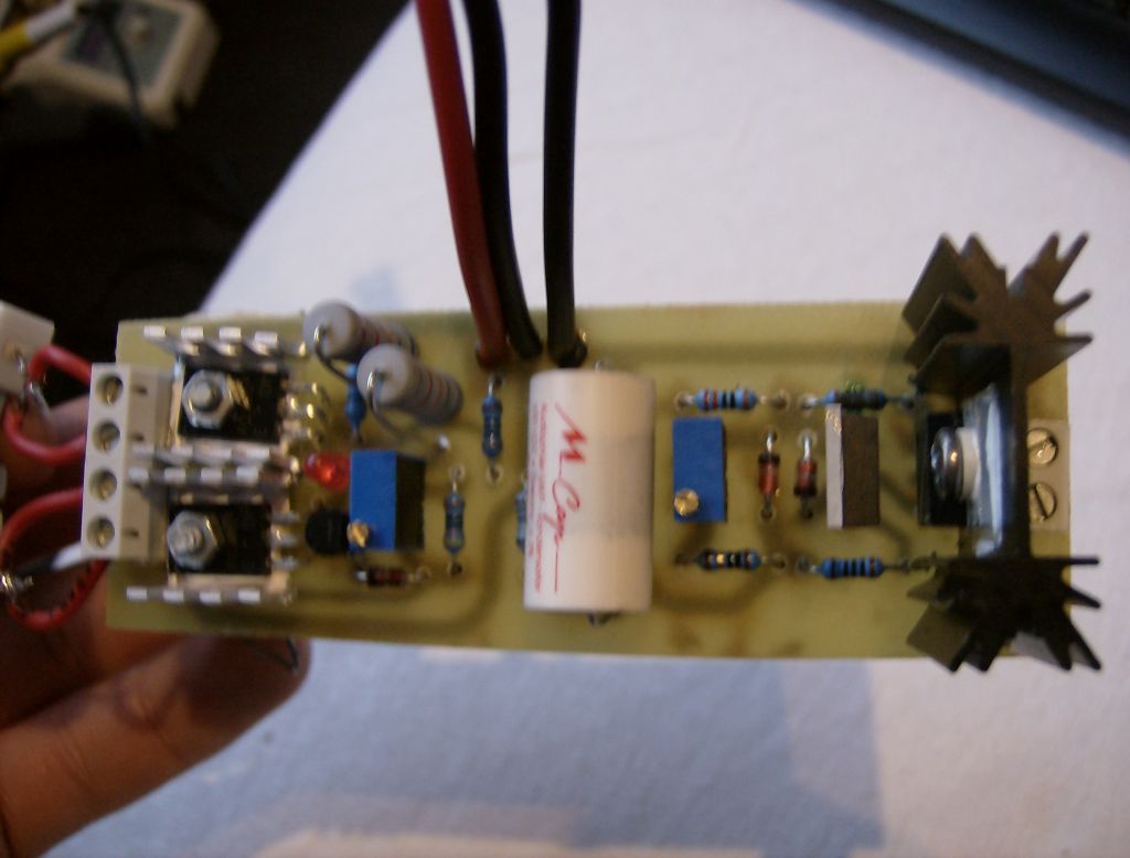

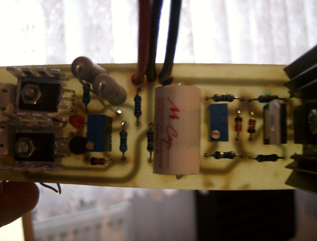

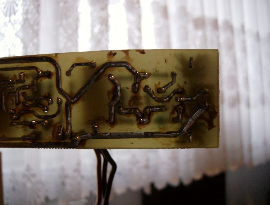

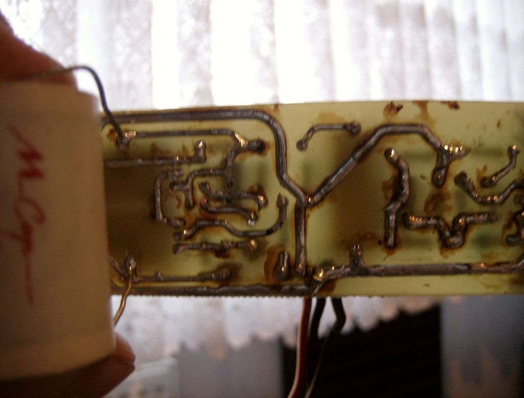

Hi i have build my salas, but i have another board, little smaller. But similiar to the org salas. When I have attached power suply R1 burned, when i mesure the R1 on the board it has 97R, when I measure R1 in another board it have 120R( i have two salas's) i have 280vdc power suply, my target is 260vdc, for now my dummy load is 17k(15mA in 260vdc)What is going on? please help me.A have add zip with the eagle files.
I have search for the bugs, but nothink found. So i add a pictures.
