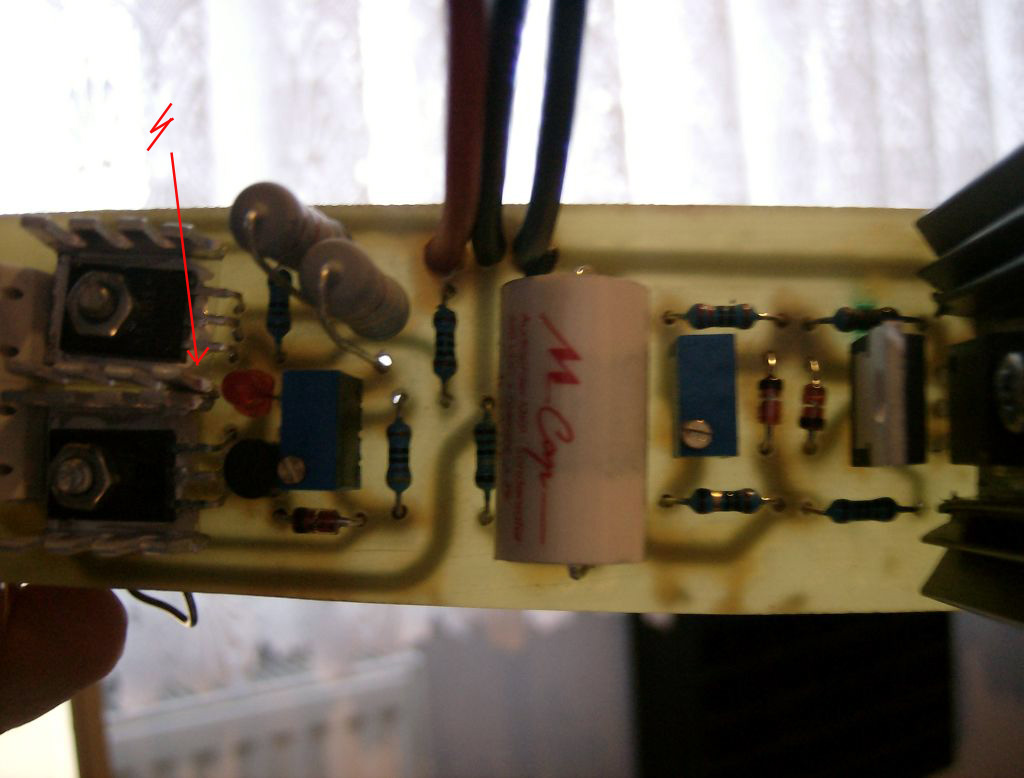

I need your help if possible, yesterday working late and tired, I did a stupid mistake with one working SSHV2 board, I connected my meter probes set to measure on the 20A range, to the output of the board, wanting to measure voltage 😡
Of course this produced a nice small flash on the terminals/probes, and the regulator stopped working. The led is still on, but now I get only around 6,4V on the output.
What I need is for you to tell me in your opinion what should be changed to avoid taking all transistors out.
Many thanks.
Check Vgs and Vbe on all semis to pinpoint broken ones.
P.S. I see MJE350s? Those are not usually fully in plastic and your silver mini sinks look touching. That would mean a short between collectors.

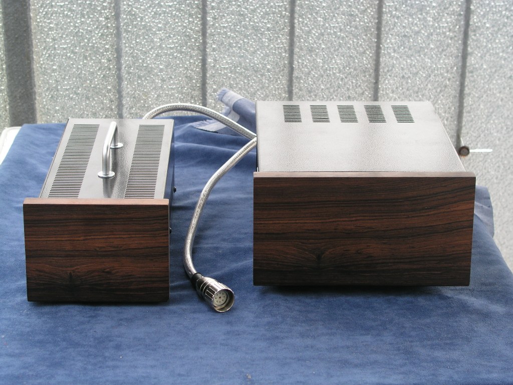

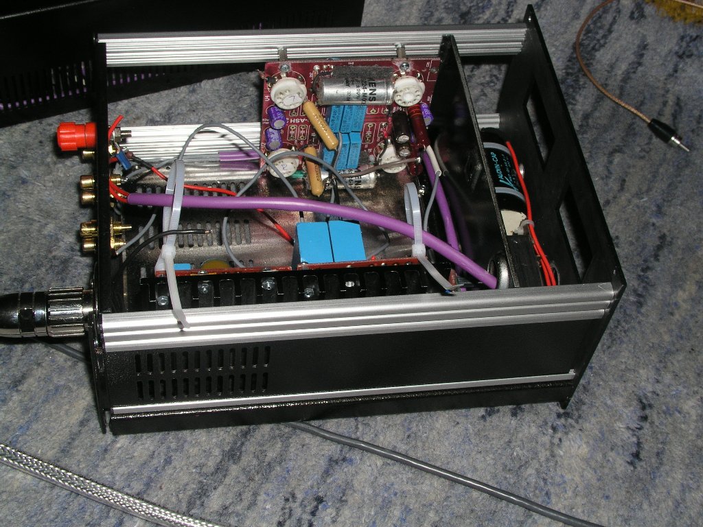

Shunt works fine now after replacing the semis altogether, very good sound with D3a phono/silk stepups, I raped PCB from Quanghao, and built it with different circuit.
Unfortunately my digicam broke, so no pics of the internals of the actual phono stage, only unfinished with SSHV1.

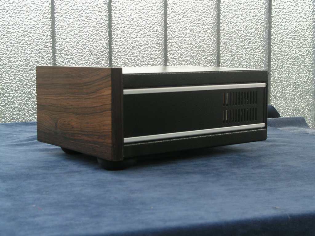

Enclosures are from fleamarket (5€), little spray, mdf, veneer, some evenings spare time.
Sure enough I am going to put those regs everywhere possible, big upgrade everytime I use them.
BTW I bought a Peakatlas transistor tester, very useful to sort out the dead from the alive😎 . Before I had to throw away the suspected semis , now I can check out the actual culprit and keep the healthy ones.

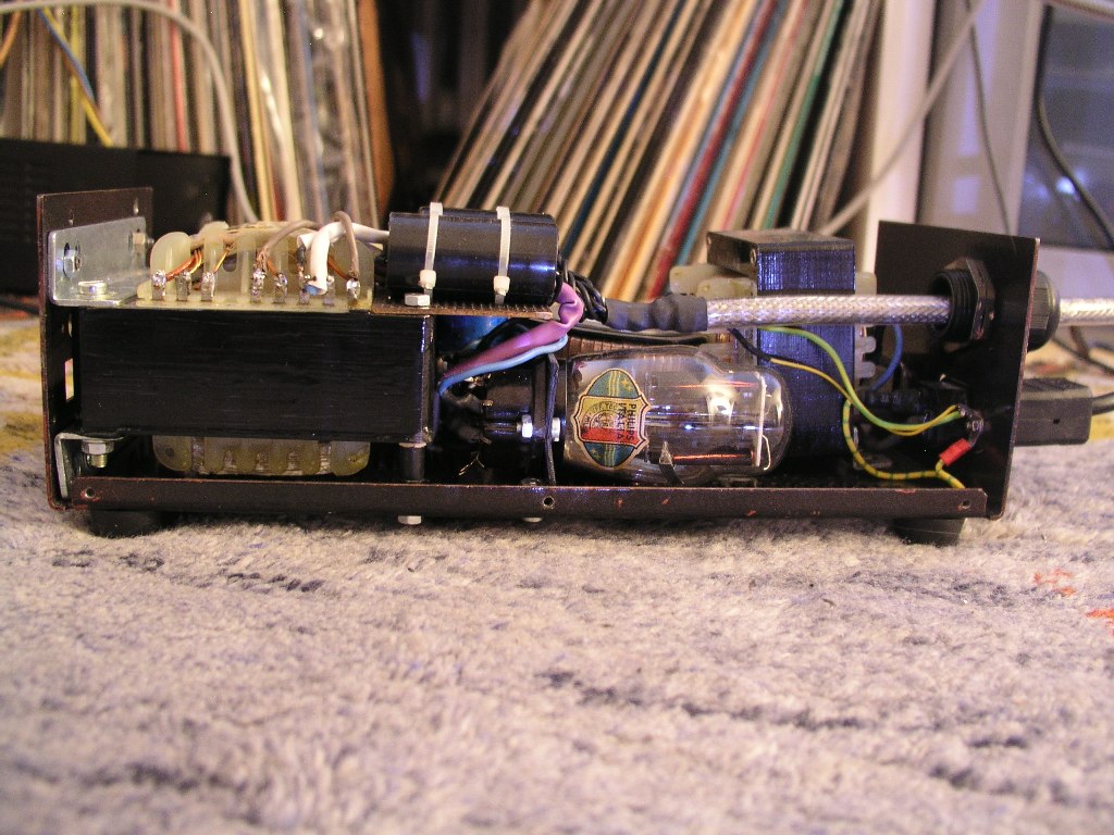

Hi Jogi,
I think old style (nontensioned) direct heating tube and horizontal positioning is very dangerous combination.
At one time, one of my (almost) 90 years old Orion (hungarian) rectifier tilted about thirty degrees ... and immediately died. :-(
Yes, you are right, it is a bit risky, but was the only way to squeeze the tube in. If the filament hangs a little bit too much--bang, short and over. But I bought this one for 4€ because the getter was loose, and have some more different AZ1 for spare.
I would not do this with a WE 300B 😉
