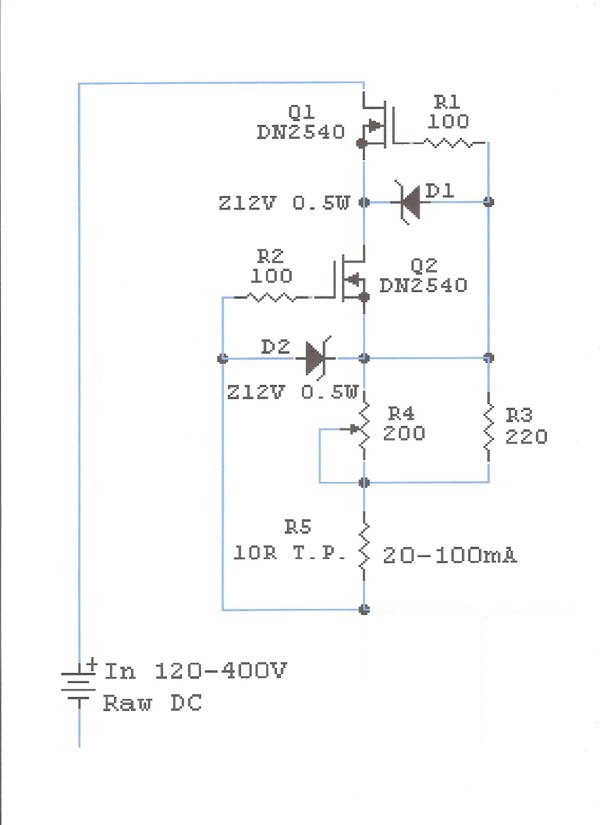

Is it possible to run the SSHV2 at lowish voltage and highish current. Such as 100v and 200mA output?
i think SSHV V1 can run 200mA at 100V
V in = 120VDC
So you can set R current all = 230 to 250mA . ( R1 ~ 7-10R )
And you need 200mA, can try to make it!
thanks
The sinked CCS Mosfet will burn about 1.5W in that case (with ~30mA setting). So a small one like we use for not too hot LM317 situations will do the job.

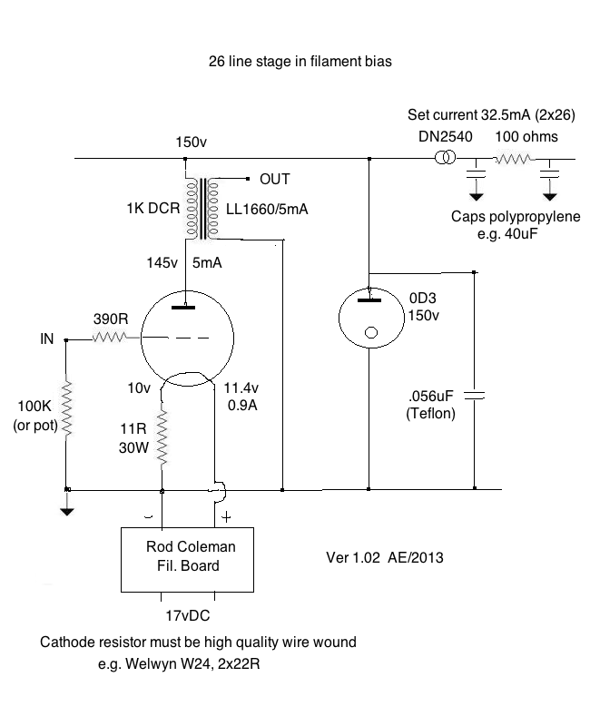

That's a very good news because I prefer to use all the SSHV2 in my #26 preamp
I read VR150 datasheet and said the minimum voltage operation is 180-185V, do you think will operate with 176,25VDC?
Not sure, I have checked some of those only above 200V in the past. Better ask the #26 guys.

But the output Mosfet will burn 3.5W so its sink better be 3x the size of the CCS one.
This one 3.7K/W also?
