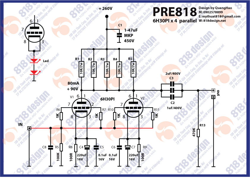

You can se in post 797, In my pre, I use C-R-C =30uF MKP- 470R-30uF MKP for my Pre.
My pre use 80mA one chanel. It is no hum or noise! You can try do that!
And My cricuit Pre818-E

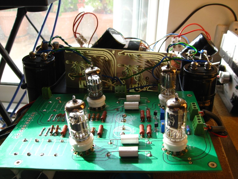

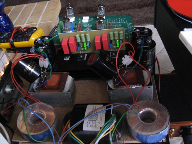

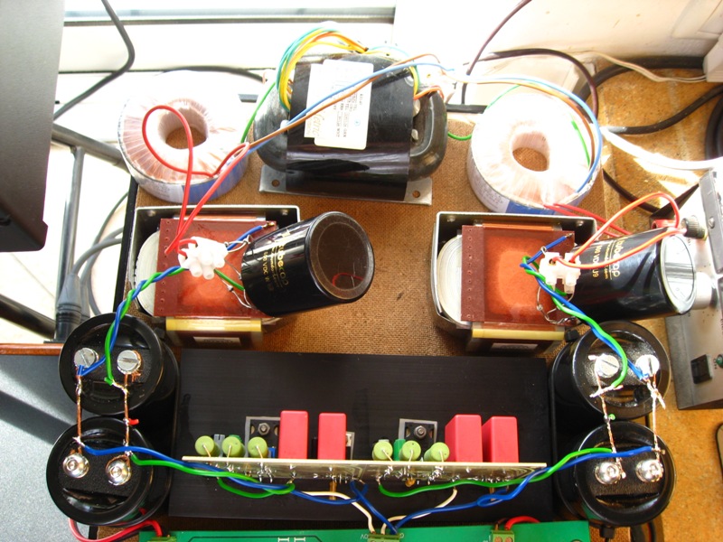

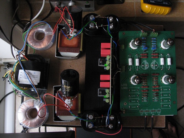

Some more pictures. Dual mono Salas HV shunts implemented.
More focus, better dynamics.
Eatherway, mono or dual mono, the most significant parameter in my opinion is the cable length between the reg out and the audio circuit.
Small changes in the cable length bring major changes in overall tone.
I am not sure about the pre regulator cabling length effect, but until now it seems less critical.
I will let it burn in for a while before i convert it to simpler simplistic.

Two more detailed pictures. Now the sun is up, there' s more light in the room.
I think Your Cap is big, Youc can chage cap MKp 30uf - 470R-30uf.
Don need chock!! the sound is better! You can try do it!
